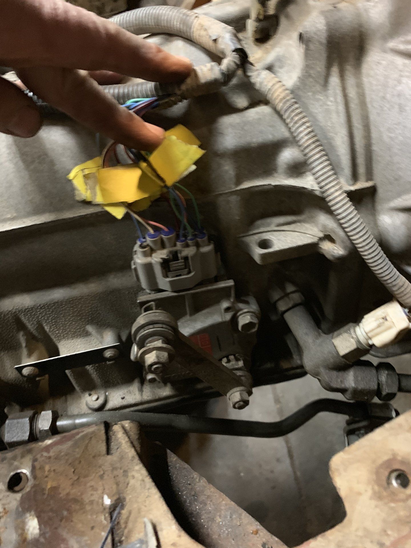

On the transmission, The one I have is from a 2000 Land Cruiser part number 35000–60610 it is A343F.
Looking at a 2000 tundra it is part number 35000–34130.

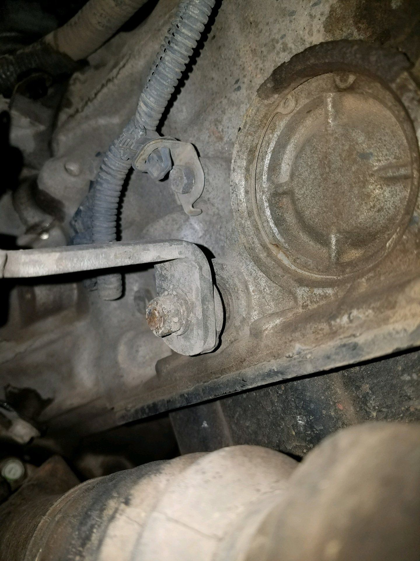

Obviously from the pictures the main plug that goes in the passenger side of the transmission is different. Does anyone know if that can just get swapped?

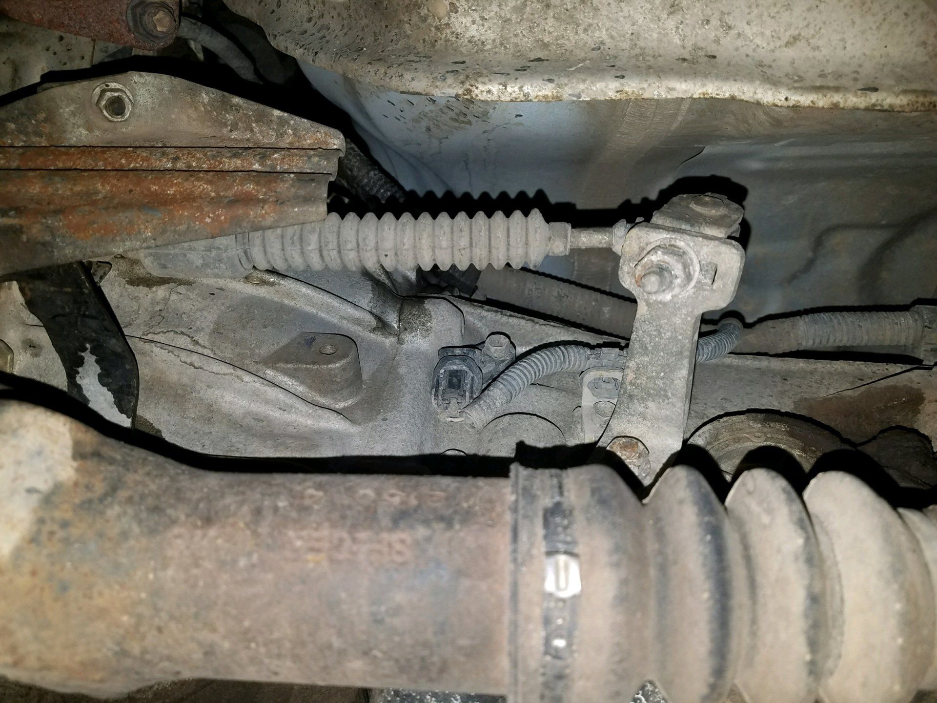

Tank5 sent me images of his tundra transmission and it has a bracket and control rod going to the passenger side of the tranny. Sorry if this is a stupid question, what is that for as the tranny I have does not have that.
Obviously from the pictures the main plug that goes in the passenger side of the transmission is different. Does anyone know if that can just get swapped?View attachment 1884857
Tank5 sent me images of his tundra transmission and it has a bracket and control rod going to the passenger side of the tranny. Sorry if this is a stupid question, what is that for as the tranny I have does not have that. View attachment 1884872View attachment 1884870
The transmission from the Tundra isn't an A343F, is it? Wikipedia thinks the Tundra should use the A340F - I can't imagine that the harness and computer you have will run the Cruiser A343F transmission... even with extensive modification, but I could be wrong. You almost certainly won't be able to just re-pin connectors and have that work. I am thinking you will have to have the proper harness and ECM/TCM from the vehicle that the transmission is out of.

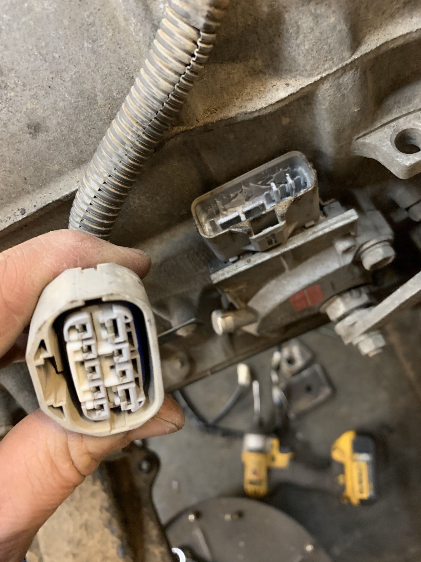

So, what is this part called, and what does it do? Is this just the part that tells what gear it is in?
Edit, just found it ... nuetral safety switch. 84540-30270. LC,
84540-30320 Tundra.
First picture is from LC, second from Tundra.
@cjmoon @baldilocks Can I repin these?

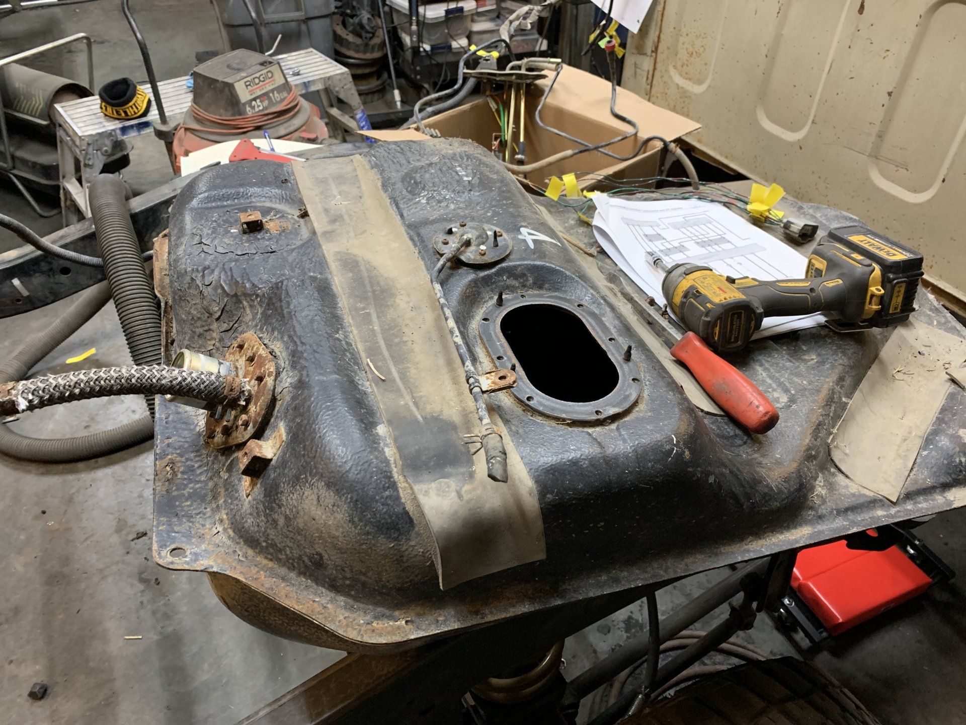

fuel system. I grabbed an 80 tank and it appears same size mount for the 4runner /tundra pump, so swap that in, then figure out temp lines from tank up to front. Think I can use an 100 filter to snap on to the line from engine, then convert to the 80 lines.

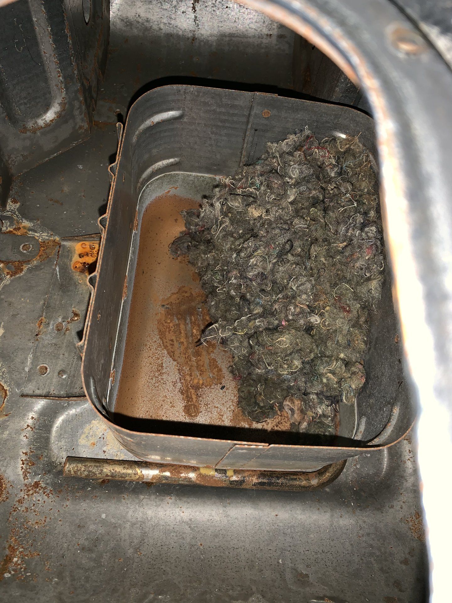

Making progress tonight, first thing was to get the 80 fuel tank set up to use temporarily ... unfortunately I had some residents in the barn. So An eviction notice was filed...
Need to find a converter from these quick plastic connections to AN

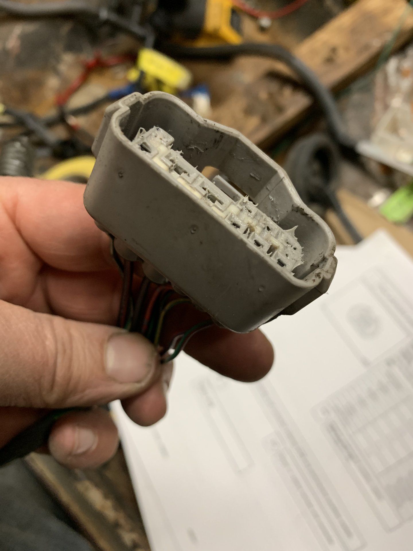

Then onto figuring out the transmission neutral safety switch pin out. I cannot find a FSm for a 2000 land cruiser to find a wiring diagram for what will be the car's neutral safety switch. I found a 2004 FSM; however it is a different pin out. The Neutral safety switch on it is a 8454034270; however, can't find anything on the webz.
Time to have another drink and see if I can figure it out.....

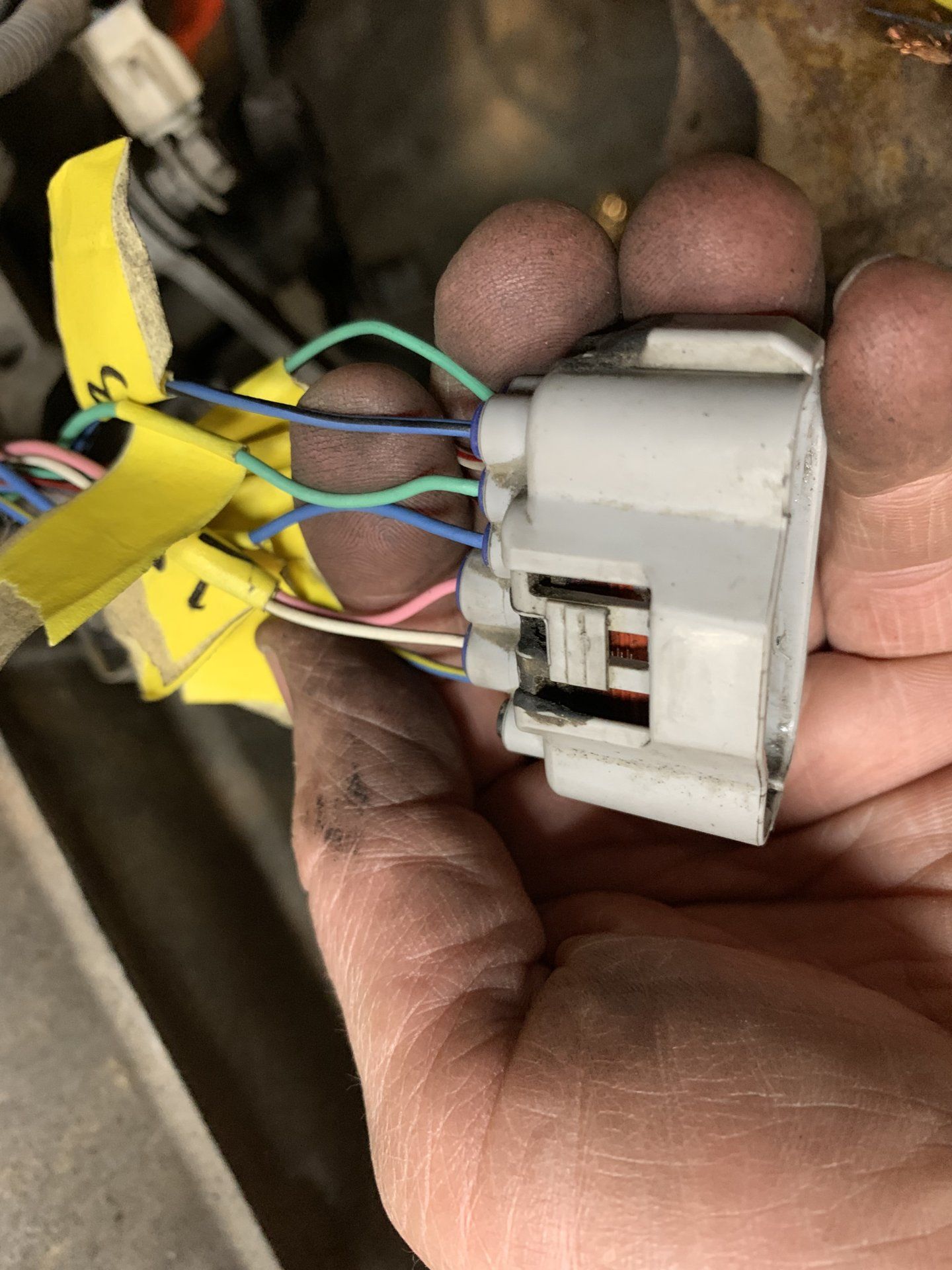

Unfortunately could not find a 2000 Land Cruiser FSM, but was able to test continuity and got everything figured out except for these two lines. Black with a red stripe and black with a white Stripe. They are to go to Pin six and nine. Just not sure which one is which. Anyone out there have a FSM?
So if anyone wants to do this in the future, here’s the pin out. First pic is Using the tundra pin alignment,( see the post above going to this land cruiser plug. I can’t tell which one should be six or which one should be nine, however it appears they just need to have continuity and park and neutral, so took a guess.
Here is the color wires and alignment into the new Land Cruiser plug
