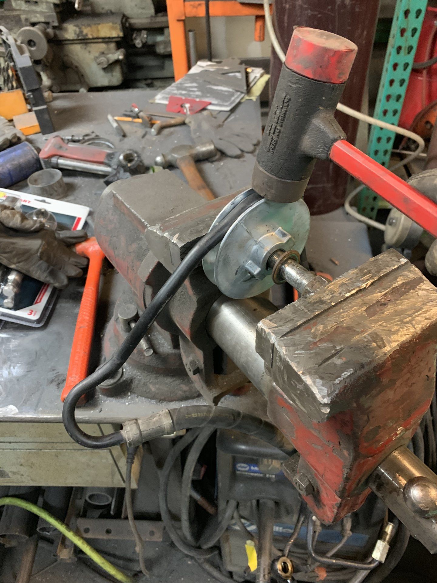

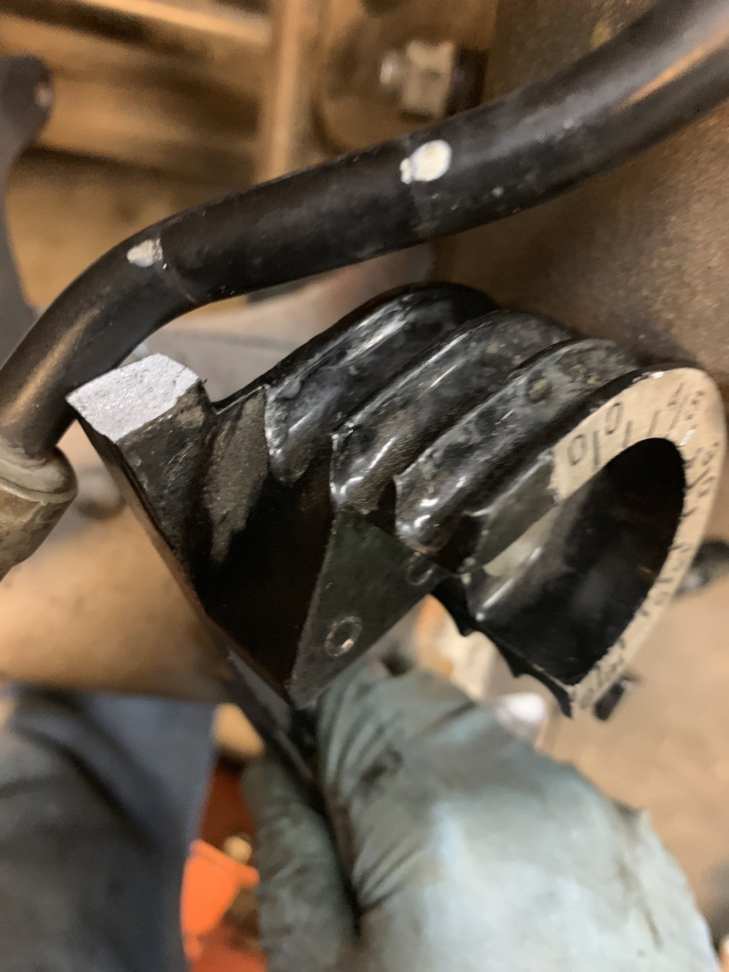

Not much done last night, I did buy a pulley at tractor supply to be able to try to straighten out the power steering line, worked pretty good. Here’s the line before I started working on it. Recall that original 4runner would have rack and pinion behind the wheel where I’m using the 80 series steering box mounted on the frame driver-side:
I also use the harbor freight line bending to tweak some areas, I may have exceeded its usefulness....,
With that, plenty of length to get over and screw into the steering box, then put a temporary return line in

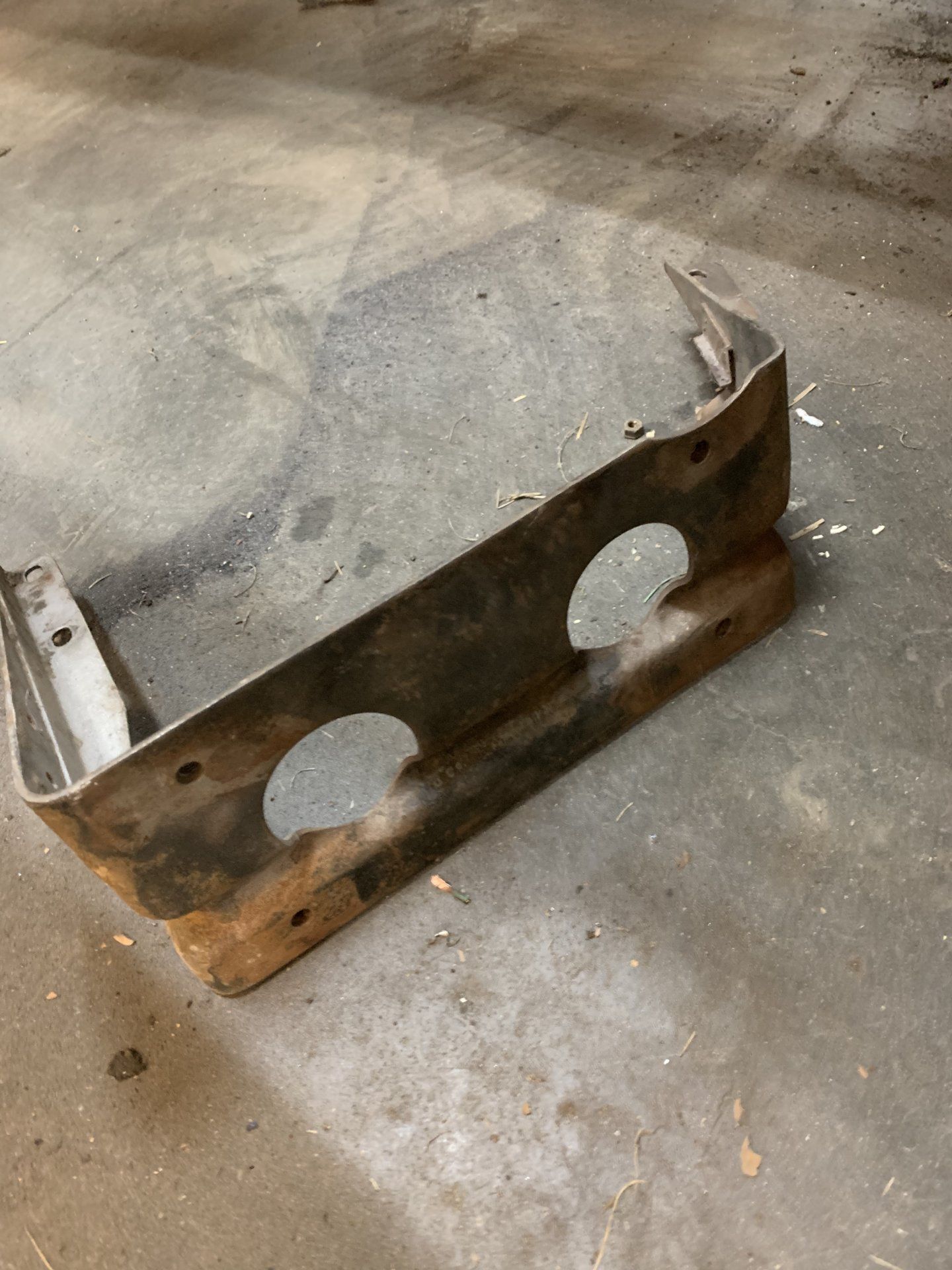

Then Mounted a temporary battery tray

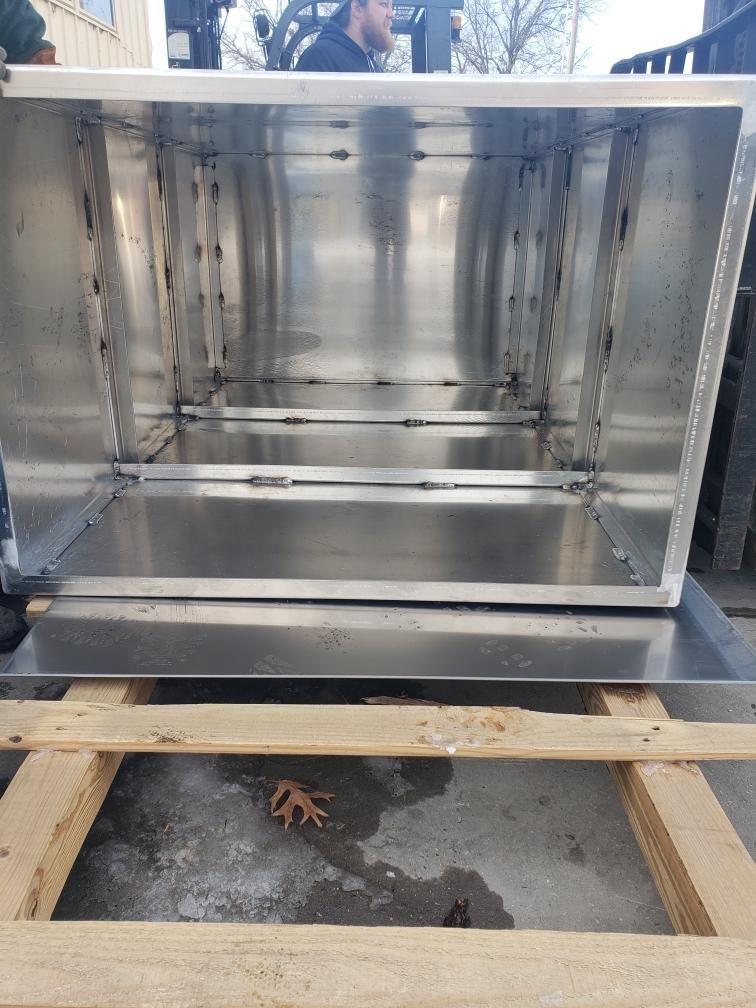

2fpower's going to build a camping trailer
4' wide 3' tall and about 6' long. all 3/16 aluminum.

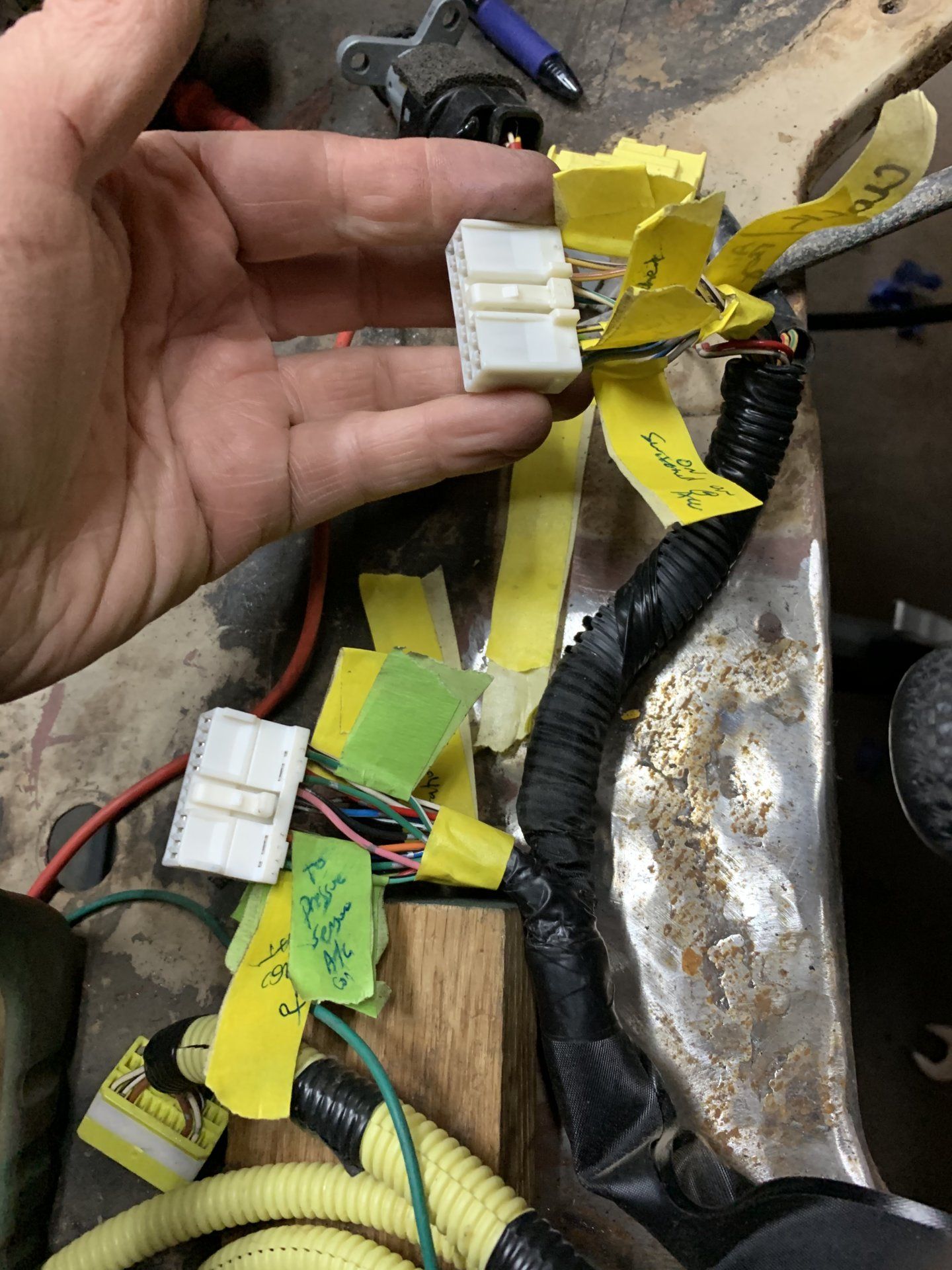

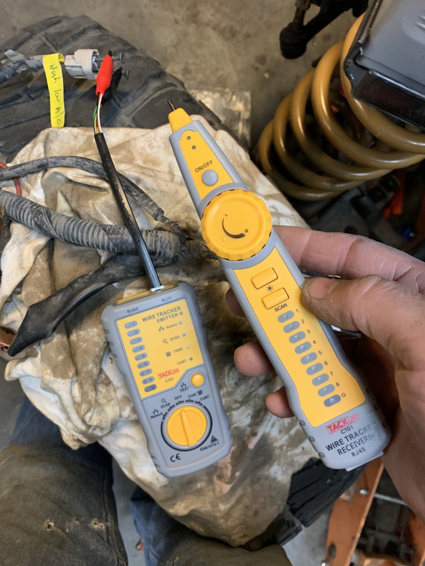

Made some progress last night, found some cool fuel quick fittings from and not sure why didn’t think about it before but use my cable tracker to chase down wires.
This is the bundle of wires that plugs into the center of the dash that has the hazard lights cargo lights air-conditioning, and other things
Got most of those wires traced

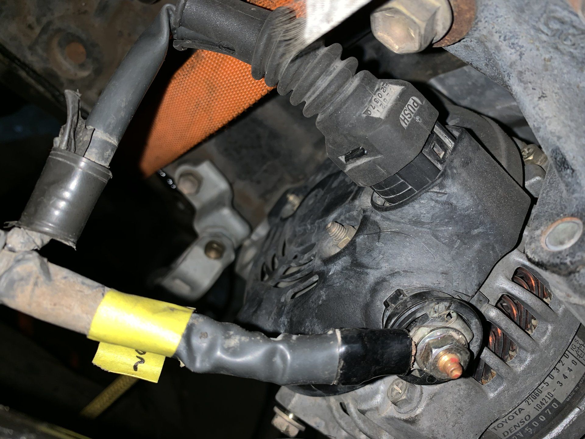

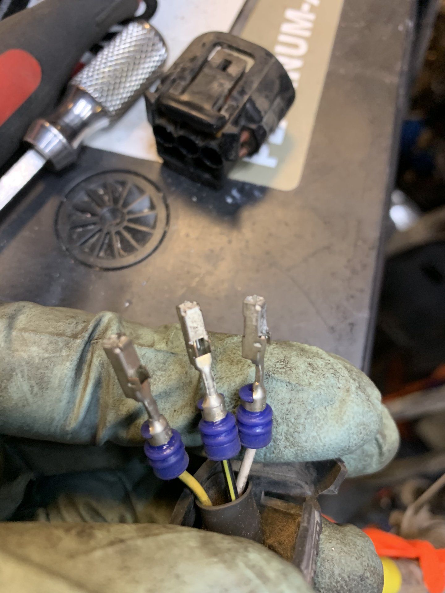

Well, today decided to get things buttoned up, first was the alternator, second was fuel line. Was able to use the harness I got from the 4runner at the junkyard and switch out the plugs. DONE. Fuel line was not as good, as I couldn’t get anything to work with the parts I got..... so, jumped in the truck and ran to the junkyard was an hour and 10 minutes before they closed. Was able to pull more fuel lines and fittings, took them home and finally got it together

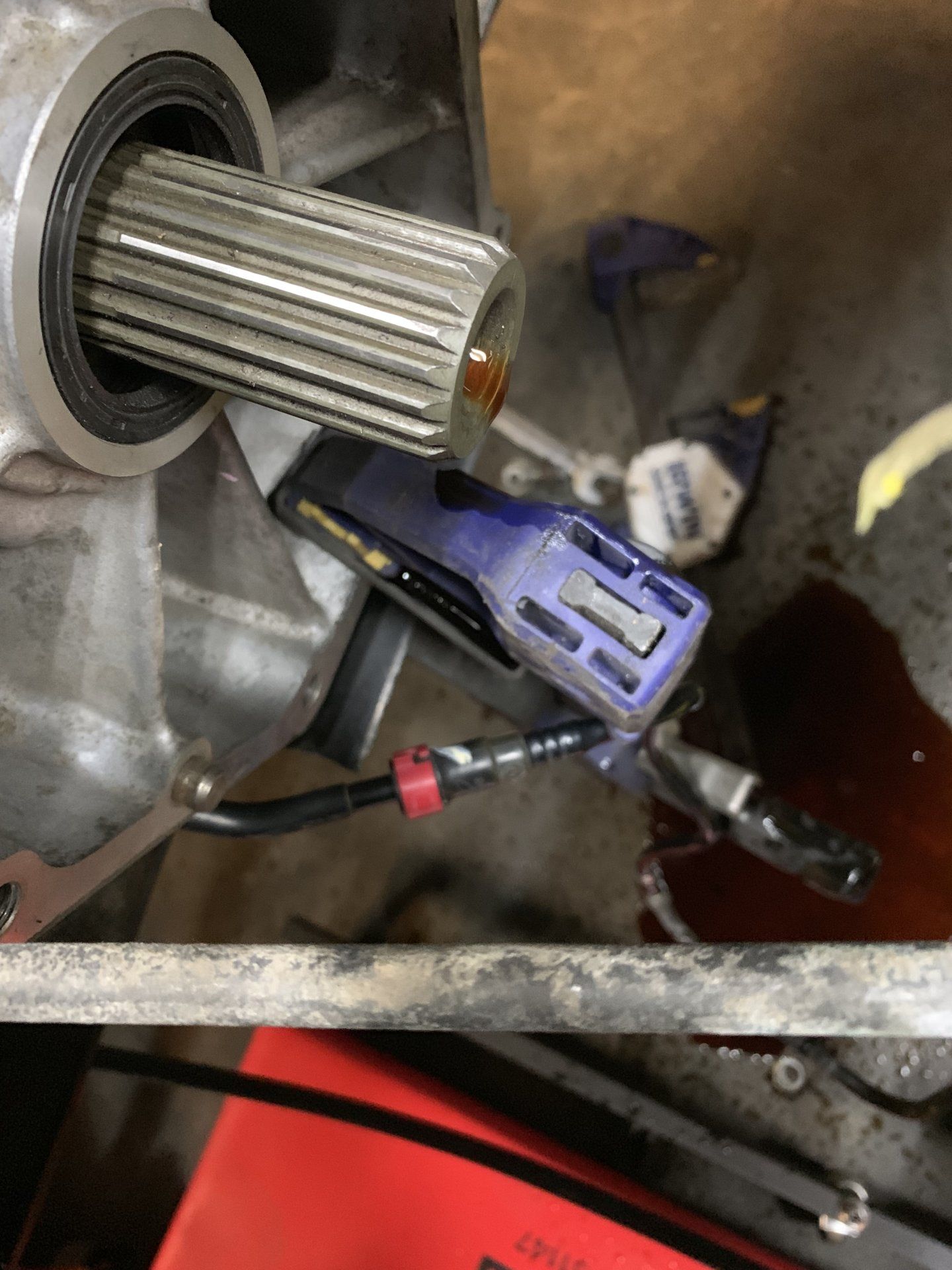

After I started it, saw fluid coming from end of tranny. Is it normal for tranny fluid to come out of center of output shaft? I thought transfer case used heavy weight oil.

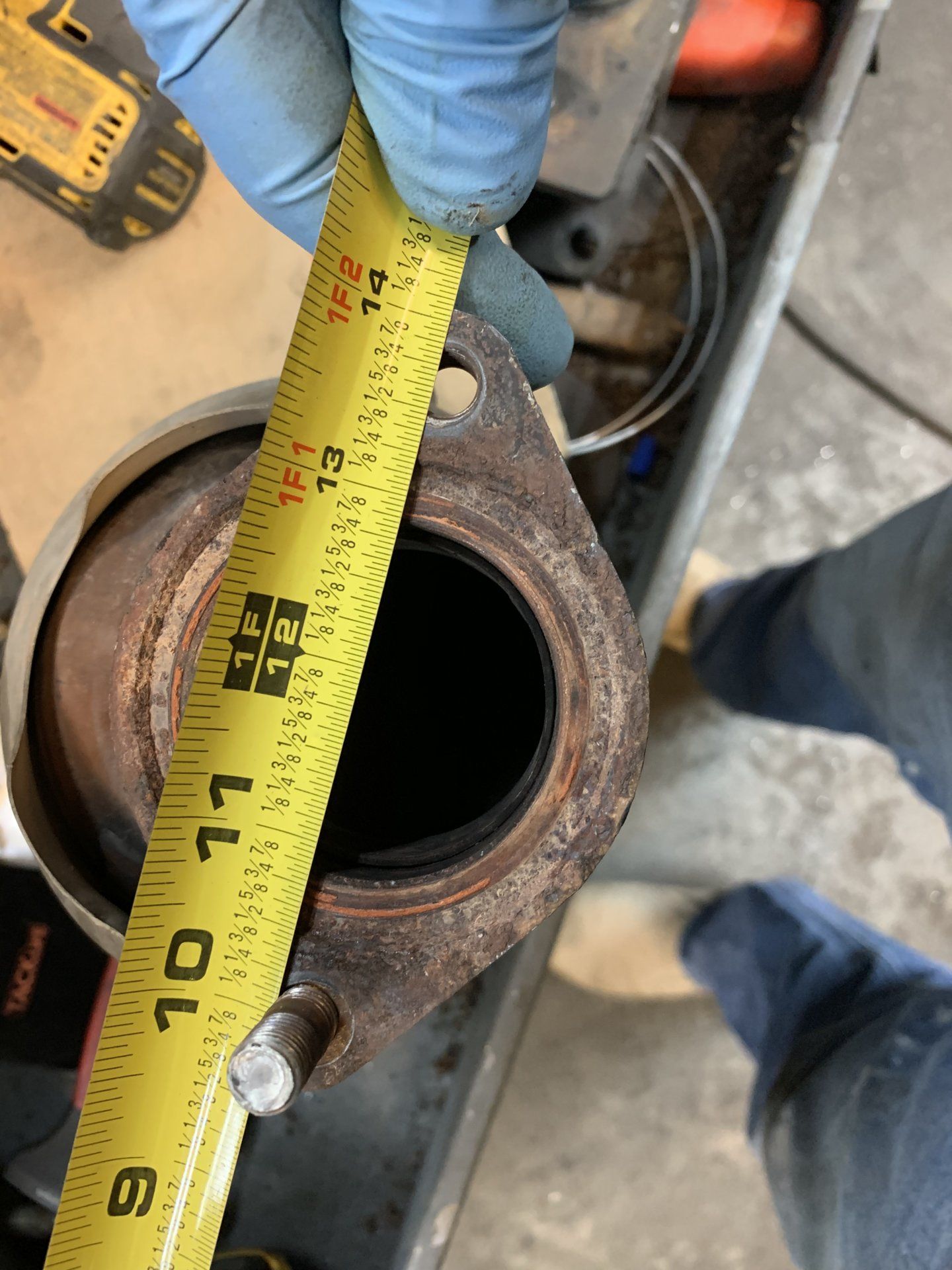

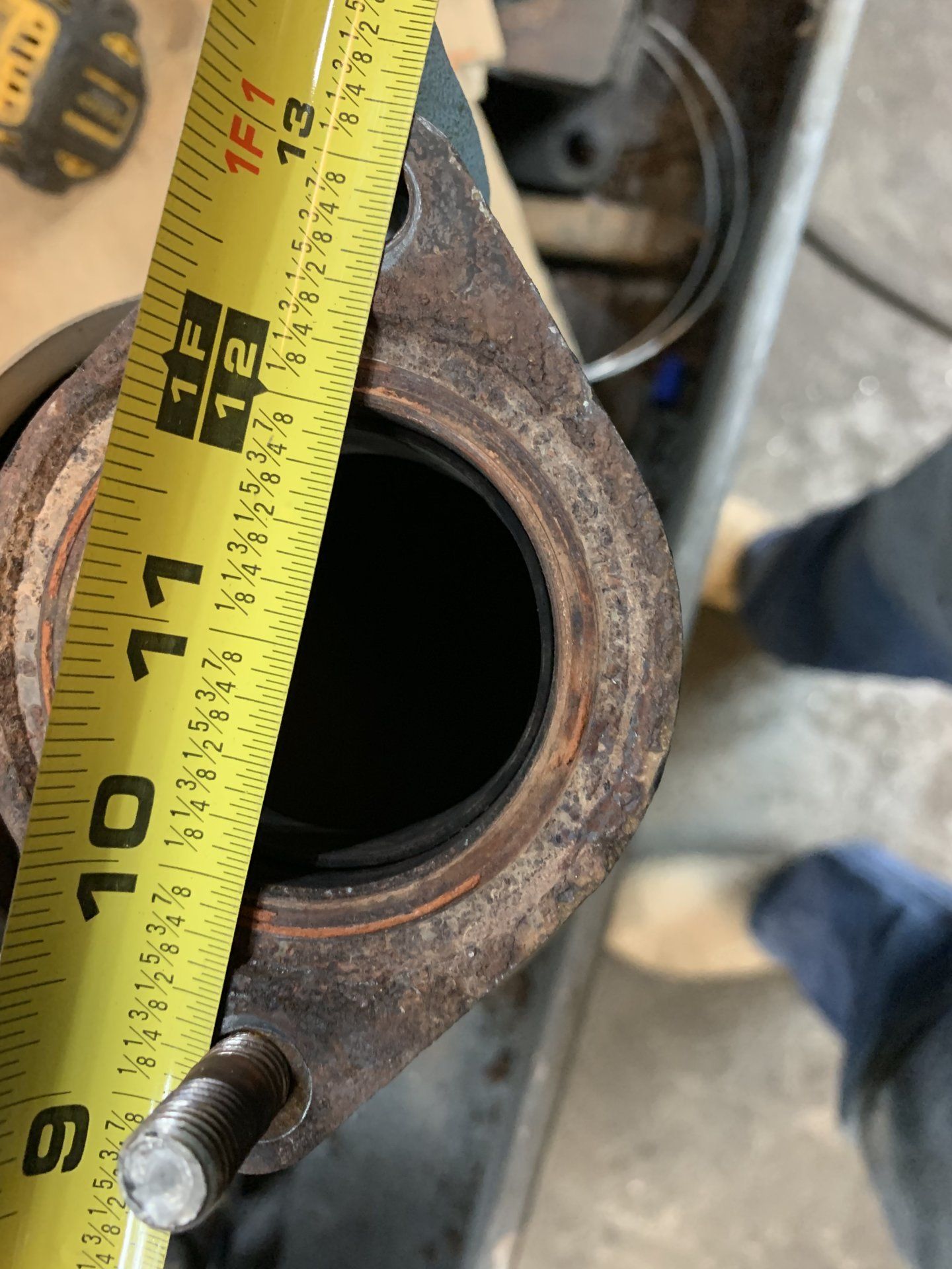

And Second question for the day, where would I find the mating end for this in stainless steel? My plan is to weld the catalytic converter’s back in about where they were then start bringing them back with 304 stainless mandrel bent pipe
After I started it, saw fluid coming from end of tranny. Is it normal for tranny fluid to come out of center of output shaft? I thought transfer case used heavy weight oil. View attachment 1891113
And Second question for the day, where would I find the mating end for this in stainless steel? My plan is to weld the catalytic converter’s back in about where they were then start bringing them back with 304 stainless mandrel bent pipeView attachment 1891128View attachment 1891129
When I was doing the exhaust on my 80 series I found universal 2 bolt flanges on Ebay. Used a whole bunch of them at strategic areas of the exhaust to remove sections easily for service work. U may want to consider headers and hi flow cats to increase efficiency/power. The stock exhaust manifolds are known for developing cracks.
I found these on ebay, but are not stainless.
Straight Round Cut Exhaust Flange Pipe Replacement Kit 2'' ID | eBay
just saw these... maybe these will work. will email to see spacing of holes.

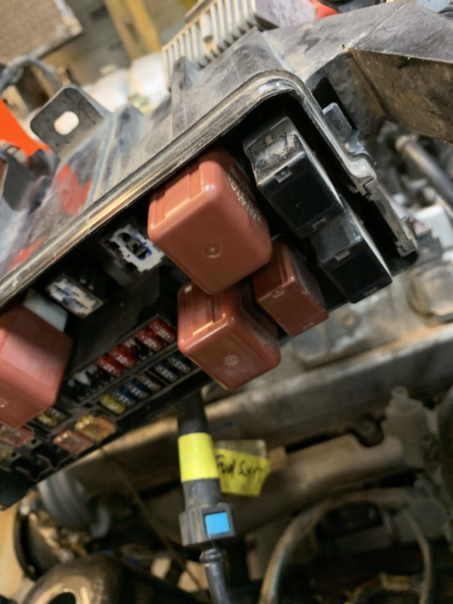

Fog lights took a little bit more thinking, first off realized that the fog relay was missing. It is on the top right side - red. Stole one from an 80 harness.
Then the original design is that the fog lights would only work when the headlights were on -- it appeared in the wiring harness, so I just isolated the wire -- green with red stripe -- near the dimmer circuit. When I put power to it, you hear the relay click, and we have fog lights. I will connect it to a switched hot power and that is done.
