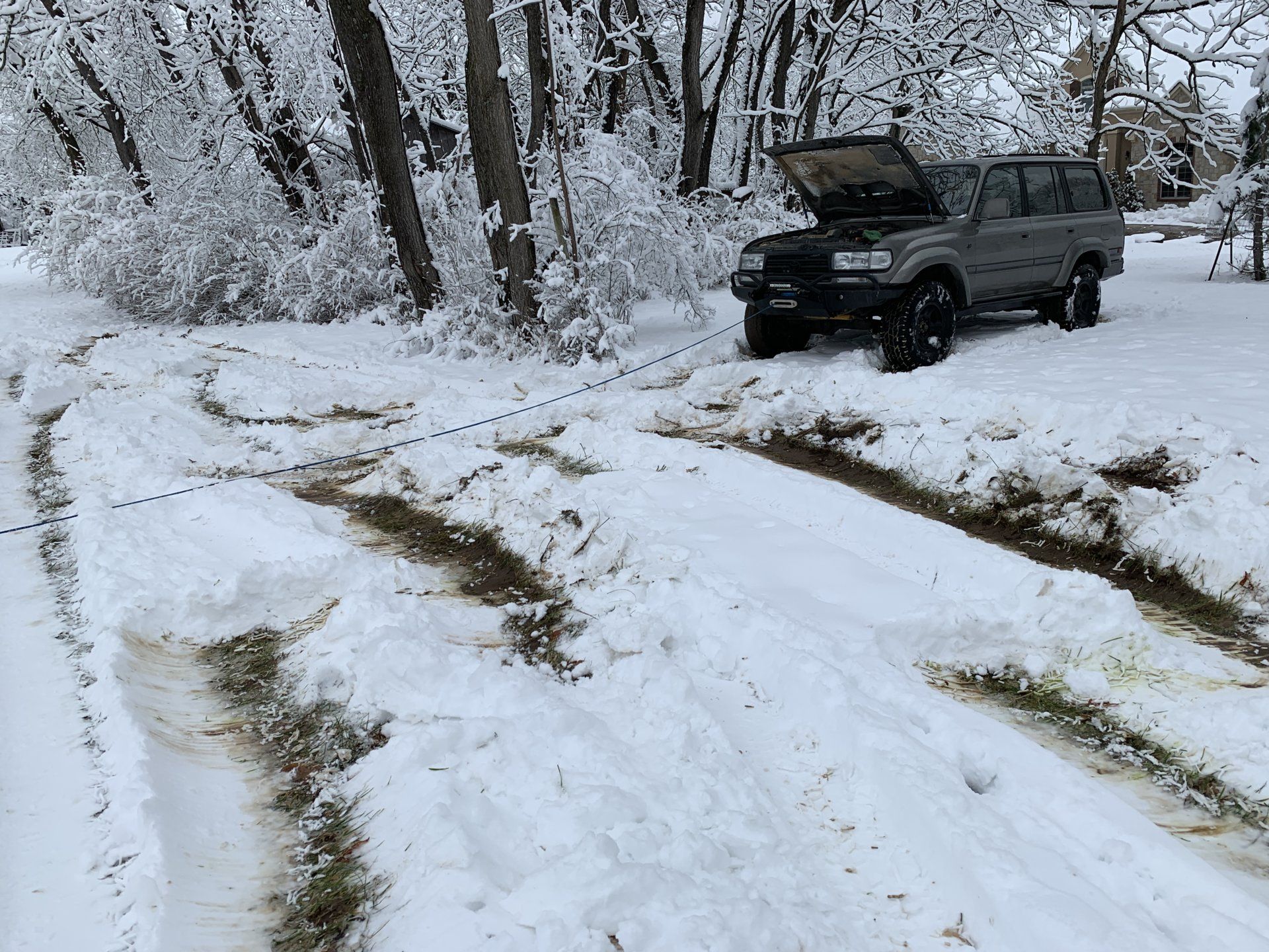

We had about 8 inches of really wet snow here in Kansas City over the weekend, I Decided to drive down the barn so I didn’t have to walk through the snow, not a good idea...
Had a winch three times, but finally got out.
Had not seen a snow like this for a long time....this is a half inch cable line going to the building with about 2 inches of snow around it.

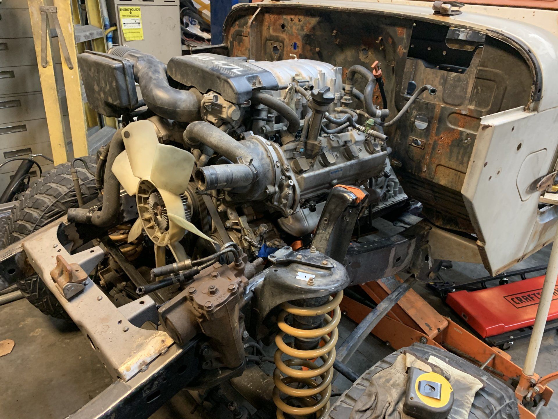

Little cut—grinding —welding the new plate to move the engine back about 2 1/4 inches.

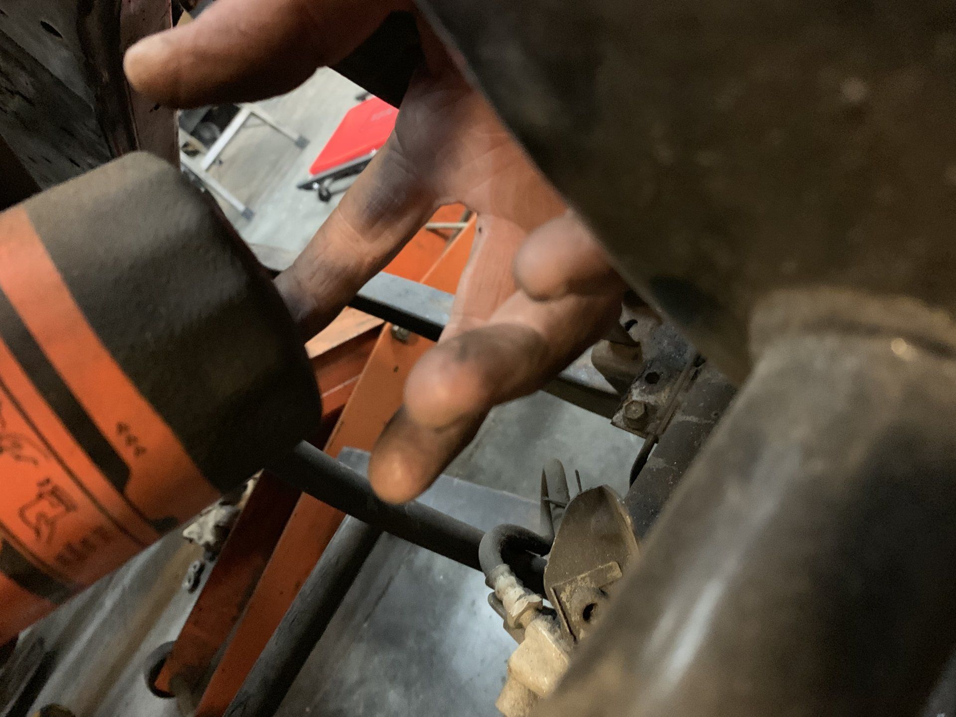

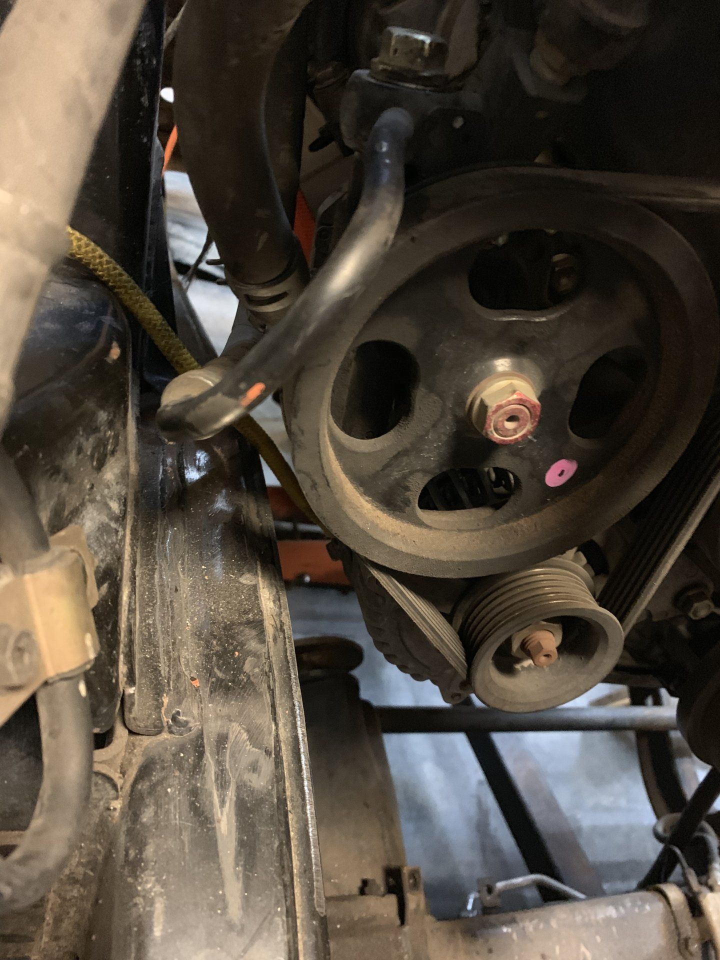

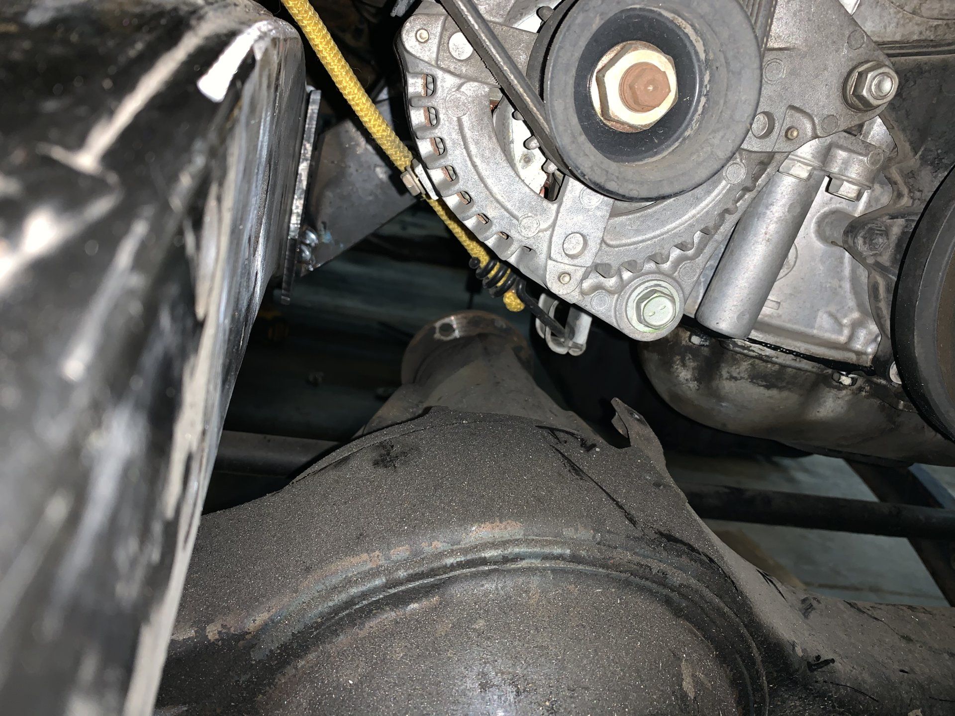

Pulled the AC line off, did some bending on the power steering lines, and got down to exactly the same as the stock 80 angle!!

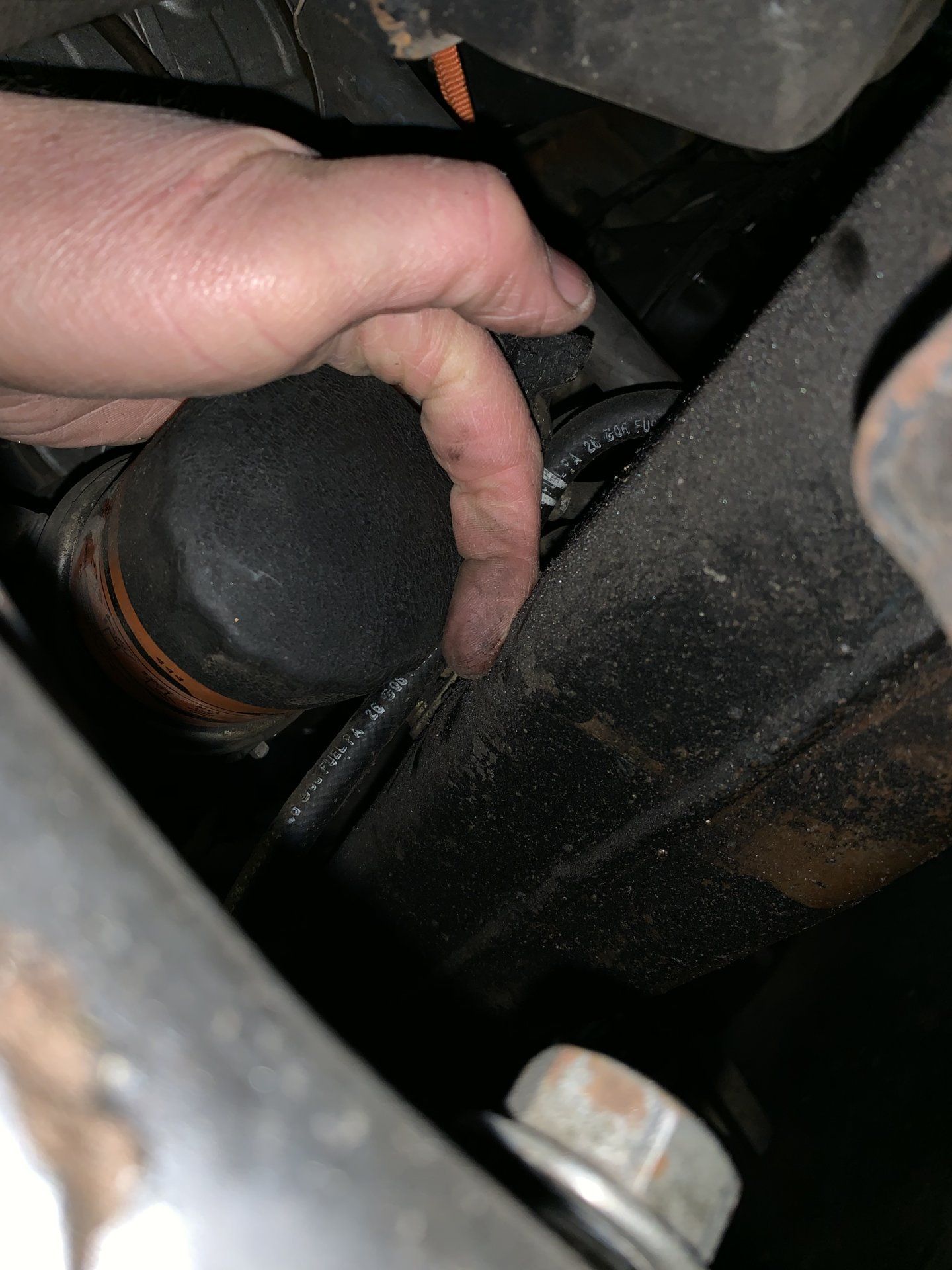

And now the oil filter is easily accessible....

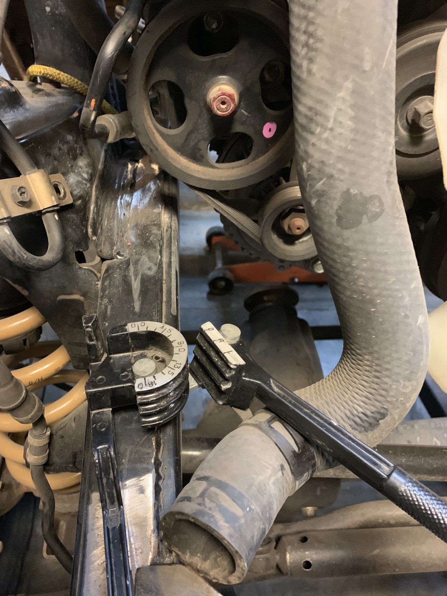

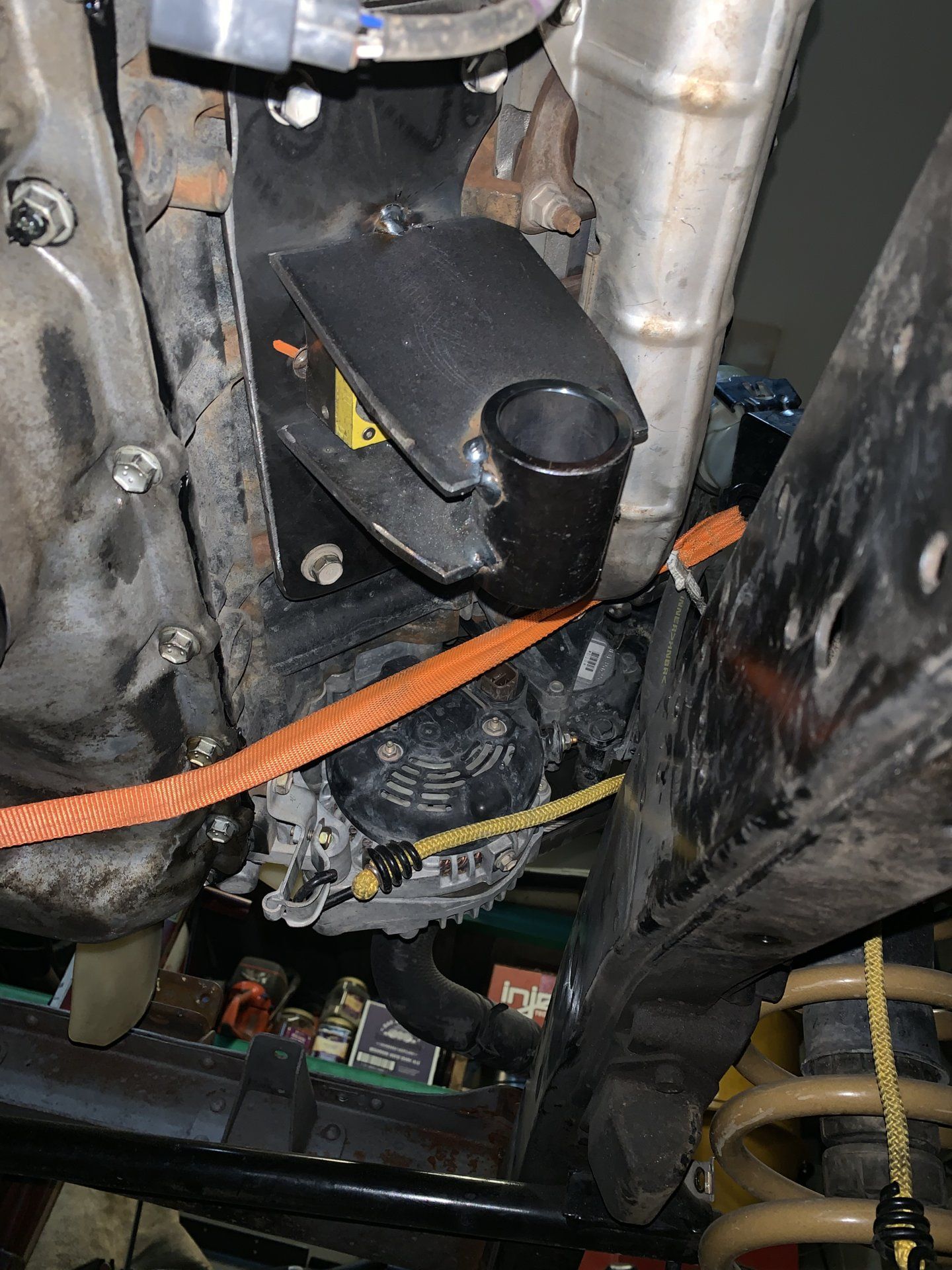

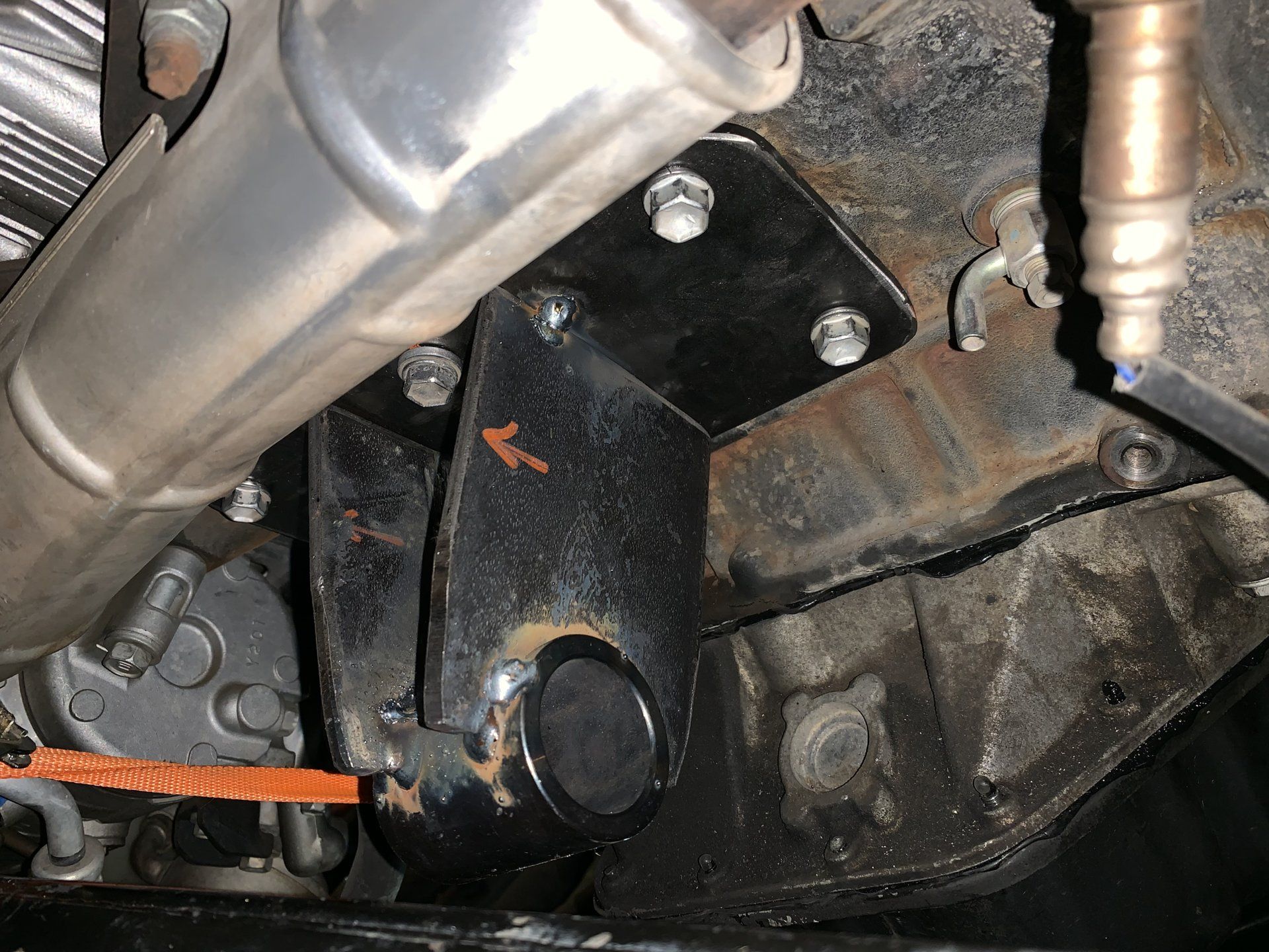

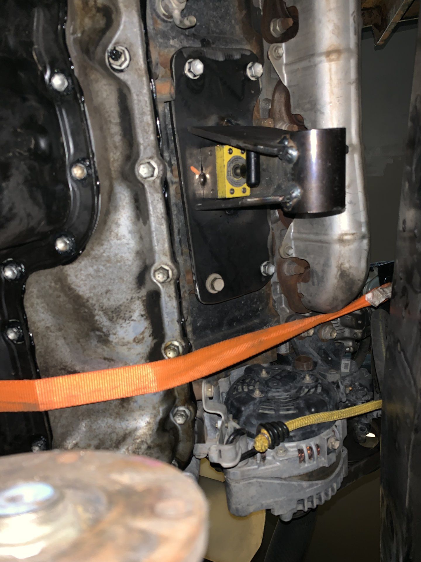

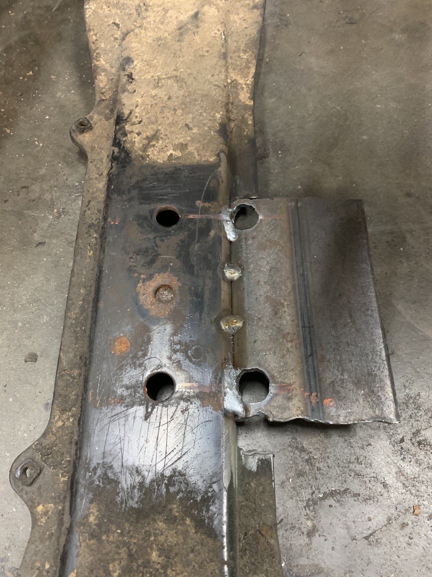

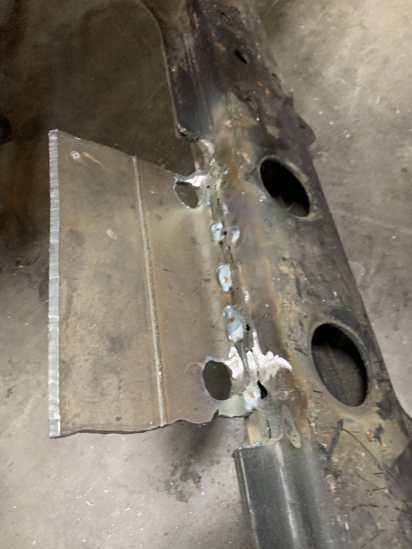

Then work on the motor mounts. Never did this before, so my goal was to get the mount at the same angle as the frame of the car and parallel to the frame. Used my digital angle finder and was able to nail it in pretty close
Then I clamped them down to a copper bar to help heat dissipation, as I’m burning those in pretty hot . I smart person would probably tack these in, but I’m not that smart!! Too excited to see this together. Anyway, the frame side of the mount will be adjustable, until it gets burned in.

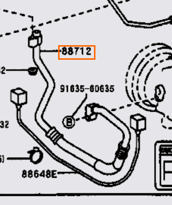

called Toyota to see if they had a stack of hoses I could look at... Kyler had the idea to run the first 5 numbers of the tundra part number to get more hose options. Found about a dozen, so I went and found images, and here are the ones that appear to have right angles at the compressor. Don't know diameters, but this gives me a target of what to look for now.
01/1995-08/2004 TOYOTA TACOMA RZN161,171,VZN160,170 part 8871204050
found these might be options.
88712-06150 (HOSE, SUCTION)
02/2006-08/2011 TOYOTA CAMRY ACV40,ASV40,GSV40
Part 88712-16570 (HOSE, COOLER REFRIGERANT SUCTION, NO.1) was found on the following models:
09/1994-06/1999 TOYOTA TERCEL
08/1995-06/1999 TOYOTA PASEO
Toyota Corrola 92-97 similar 887121a150

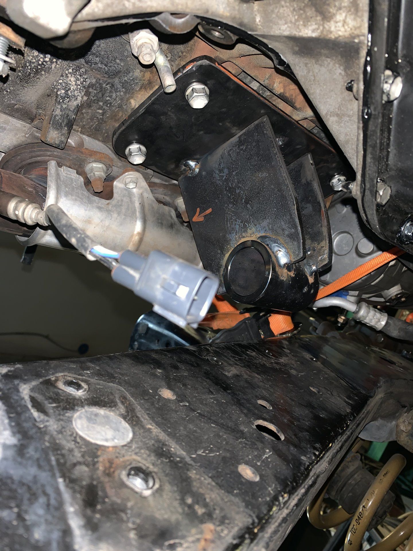

Motor mounts are tacked in place.

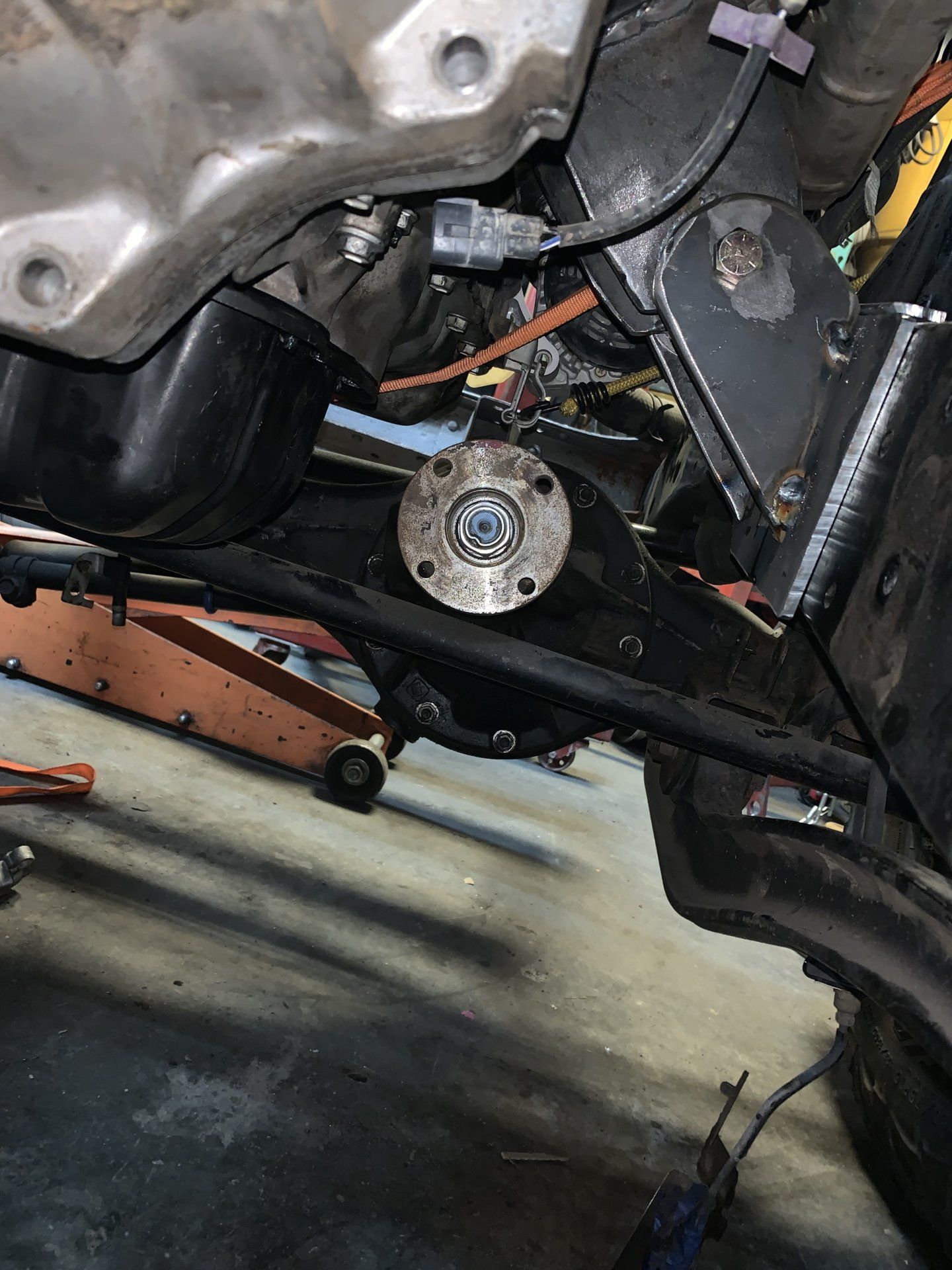

Then I pulled out the springs and put Vera in full drop. Oil pan clearance looks good
Oil filter still has clearance at full drop

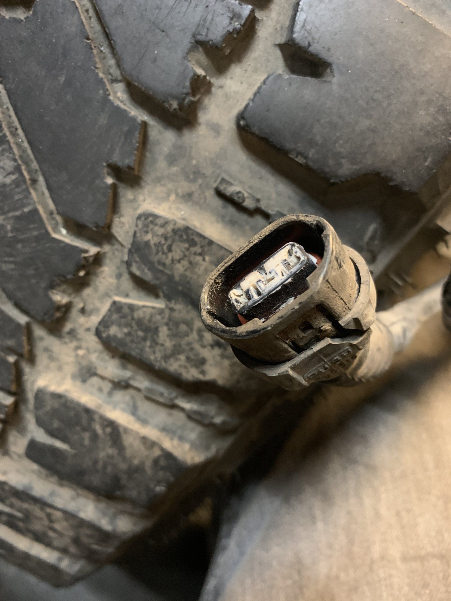

Went to plug the first part of the wiring harness in, the first connection, and it’s different. This is going to suck!!!! Alternator plug.
