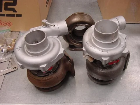

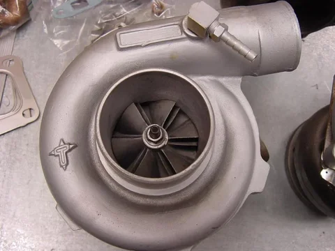

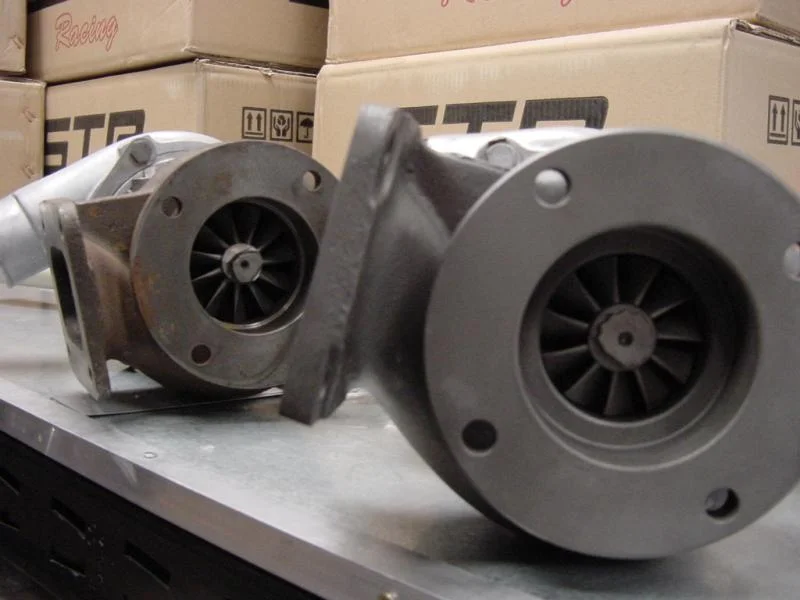

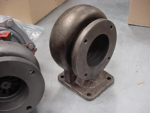

Got a couple turbos back today with fresh rebuild and some interchangeable housings that I plan on testing out. Also got the AEM gauges and pod. Got some stuff to do this weekend:)
Going to install the Turbonetics 60-1 first with the swapped 58 trim on the back side. Should spool up 1000rpms sooner. Can't wait!
Over the weekend I installed the Turbonetics 60-1 with the 58 Trim Exhaust Side.
I noticed a much quicker spool up right from the get go. Also installed the newly redesigned AEM Wideband/Boost Gauge. Has complete data logging for both boost and wideband read outs. Also installed the AEM Water Temp Gauge on a dual pod on the drivers pillar. So far wideband sits in the 14's most of the time. On about 60-70% open throttle, goes to about 11.5-11.9. So took it out on the freeway to see what happens. Was traveling 60mph (showing on Speedo). Figuring it must be about 65mpg with the 35's. Traffic starts to lighten up, so I Punched it. As soon as boost comes on, AFR drops down to 10.2-10.5. Got up to 100 and let off. I was probably getting close to 110 actual mph. Tried it about 3-4 times before exiting and every time the numbers were the same. The sound is freaking awesome. I have not been listening to any music since this kits been on. You hear nothing but the hiss of boost filling the manifold behind the firewall. Let me tell you that this thing has never come close to 100. Well, maybe once when I was going downhill. It did not struggle at all. I will try to make a few videos showing WOT with boost and AFR readings. So far Very Very satisfied with the results. This is with Stock ECU, no fuel mods or piggy backs.
