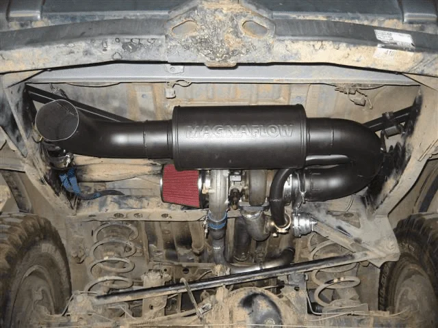

pics for fun. I have 70,000 plus miles on my system. Here is the intake/ remote snorkel I built. It was the first time I worked with fiberglass. Fun but, had 40+ hours in it. (Just the snorkel).

Mind showing us whats underneath?
