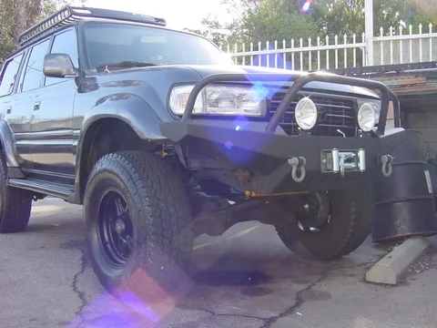

By the way, I realized that our rigs are starting to look very similar.
Same wheels, same bumper, I was about to get Seans bumper, but you beat me to it. Looks like 4x4Labs it is. Great taste in style.;)
Ha they sure are! I noticed that when I saw your pics in somebody's suspension lift thread. That thing looks bad ass! But the difference is yours is fast and mine's about as fast as a riding lawnmower :flipoff2:
