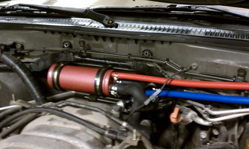

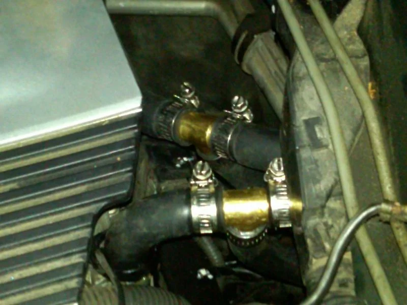

Our kits do include two new 5/8" (or 3/4") brass t-fittings. Traditionally they are used to tee into the hot side of your heater circuit and again into the cold side of the circuit. However, I went right from the hot side of the motor, into the Helton and then back out into the factory plastic tee. I put new factory plastic tee's in when I did the install, if we wouldn't have been out of stock on the brass ones, I would have gone brass.
