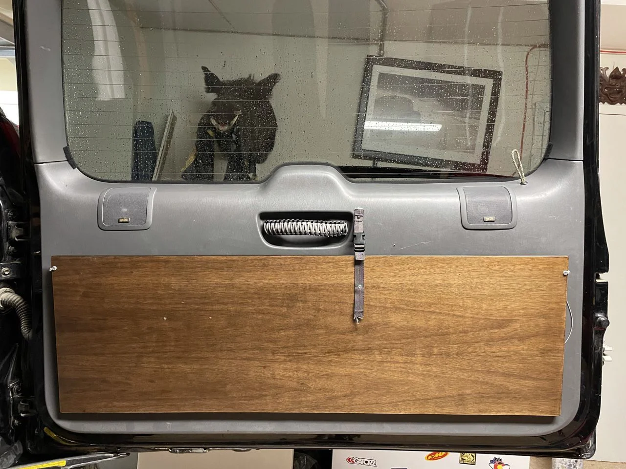

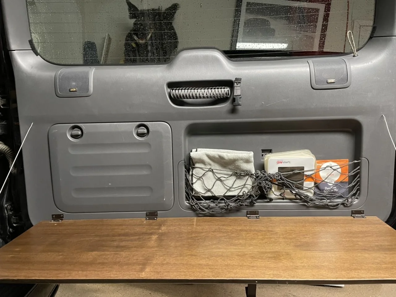

I know the general topic of fold down tables has been covered a lot, but I have a question specifically for the GX470. Planning on doing a simple continuous hinge and 1/2' ply, however any other type of supports/reinforcements, such as a sheet metal, or extra wood required behind the rear plastic door panel to make it sturdy enough? Or can I just simply drill holes through the plastic, and either tie knots in paracord, or solder something to steel wire behind the panel? Heaviest item I will use this for is a double burner stove. What did you guys do? Any insight appreciated here.

Didn’t end up using reinforcements. Just use steel cable with wire clamps behind the plastic door panel and 4 little hinges securing the table to the panel. I just screwed the hinges into the plastic panel and then used super glue on the back side of each screw. I think the 4 hinges look a lot better than a super long continuous hinge and also this way I didn’t have to drill 20+ holes in the door panel. Tables definitely strong enough for my use, mainly just use it for preparing meals and coffee, and occasionally for other stuff, but I never put anything super heavy on it. Even if you did a reinforcement plate you still wouldn’t want to use it for anything really heavy because the plastic panel itself is mainly just held on by a bunch of pop in clips.
