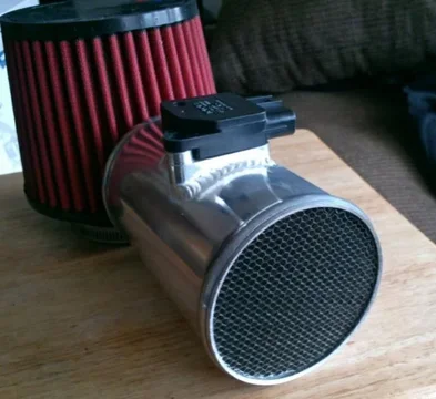

Just get a 3.5" pipe with the correct MAF flange on it for whichever MAF sensor you want to use, insert an air straightener pre-maf inside the pipe, and you'll have plenty of MAF resolution to tune with There are Toyota sensors that fit both of the following flanges and have the correct connector/plug on them:
Here are two commonly used ones that already have the flange welded on:

Which one of these pipes is needed for the 22204-21010 sensor? 1.23" or 1.02 inner hole?
I'll be back at the shop Monday and can measure one to let you know. Or if you have it there with you just measure the diameter of the round part where the oring is.
Ok, sensor and 3.5" MAF pipe ordered!
Get the air straightener too. For anything over a 3" housing I highly recommend running a straightener before the maf sensor.

? New housing and sensor looks like it should be able to go where you stock MAF Housing is, you might have to shorten your 4" intake tube and use a silicon reducer. But looks like it will work fine. The air straightener just going inside the tube. It helps even the air flow out so that a bunch of air doesn't rush under the MAF sensor creating an unbalanced reading.

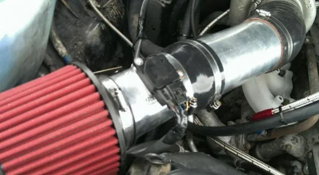

Parts are in. Will report on results later tonight.
Ok problem solved with new maf setup.
Here is a wot 1st gear pull. You can see the maf values peak at max boost then slowly slope downward after the peak torque. The afr is still too lean for me even in the lowest gear/load (high 11s low to mid 12s). 450cc injectors will be here on Tuesday and at the power level I think they are required.
No changes were made to the current fueling with the new maf. Long term fuel trims after a 15 minute drive were at 20.
The footprint was nearly identical to the stock maf. No cutting needed.
The honeycomb fit tightly into the maf pipe. Even without epoxy I don't think it will ever move. I had fears about it getting sucked into the turbo, but that thing is in there snug.
