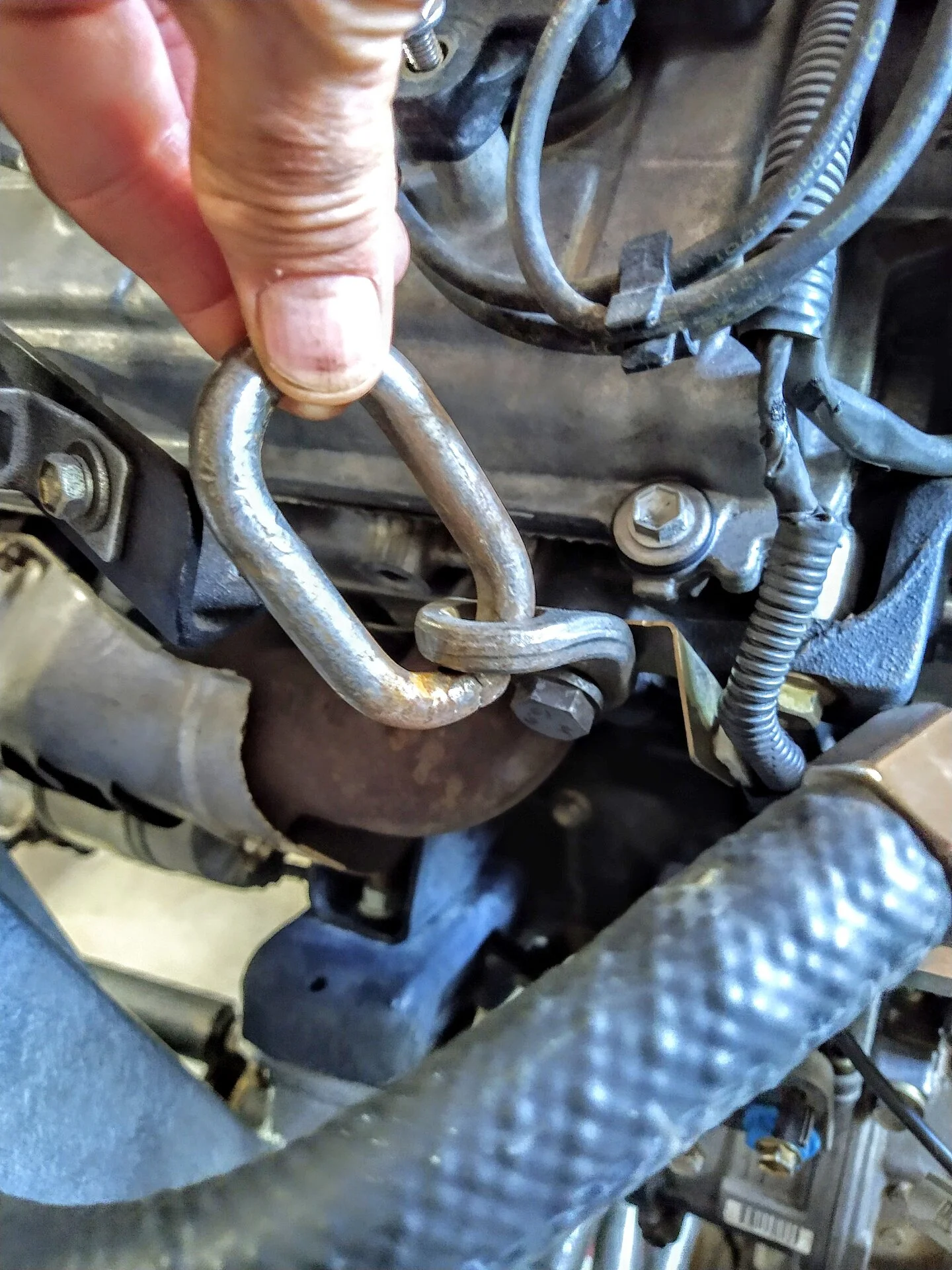

Finally, I know Toyota makes a lift bracket for the passenger side of the engine. Is it a good idea to get one of these?

I used a lifting link on the passenger side and pulled the two coils off to avoid the possibility of the chain breaking it off.
