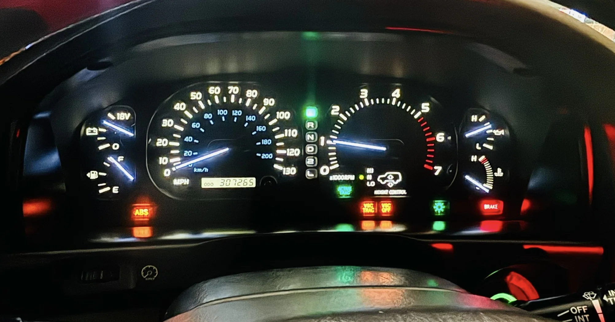

Ok, 2001 Lexus LX470 w/ 307K+ miles, after being parked indoors for two weeks, displays these dash lights with no CEL. Vehicle drives great. No brake booster alarm. No brake line leaks and all fuses seem/are good. Don’t have Techstream so was wondering about y’all’s experience or opinion? Is this a wheel speed sensor issue? I suppose my area Toyota Dealership can run a TS diagnostic? TIA!
Use an OBD reader with ABS readout capabilities to get more information on what the warning lights are about.

Used three (3) different OBD readers and got zero returns. I guess TS is the only option…

Tried three different ObD readers, one high end, and got zero returns. I’ll be visiting Toyota for the TS… 🥺

If you're low on brake fluid, it will disable the abs and vsc. Check your brake fluid reservoir and add up to the full line, but more importantly, check for where it's leaking from. Pump the brakes a bunch of times and look for wet spots.
