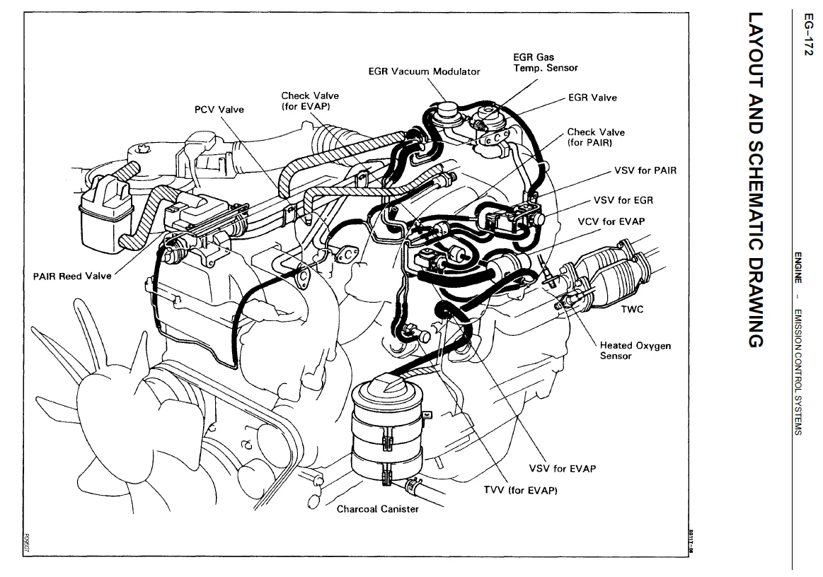

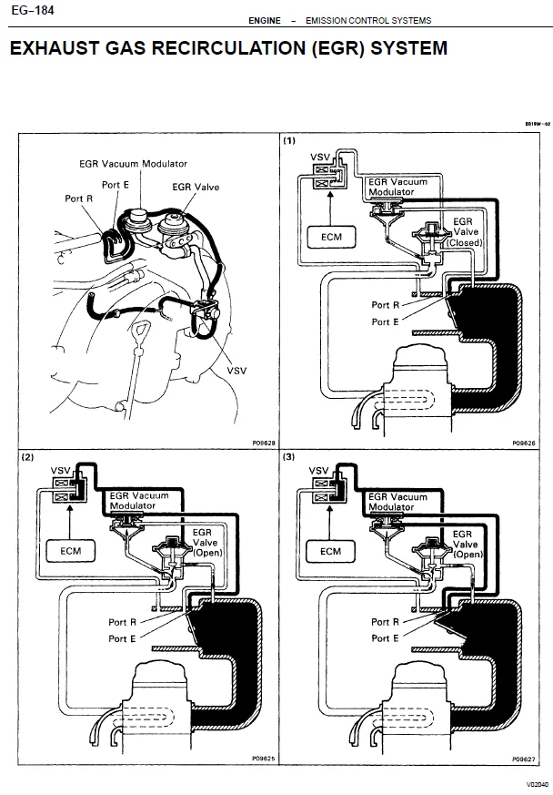

The electrical components to the EGR system, are the gas temp sensor on the back side of the intake and the VSVs, IMO, there's no reason to disconnect the battery, but the service manual does indicate that's the first step. The cleaning procedures are listed on pages EG-185 through EG-191.
FWIW, the reason I wrote my first response the way I did was that the VSVs and gas temp sensor usually aren't the primary failures point s of the EGR system.
As far as the ECU "learning", it doesn't. It just reads sensor inputs and stores them. The map is written onto the IC and cannot be changed without changing the chip.
If you disconnect your battery and your truck runs poorly for days, you have a problem.
There are no electrical components to the EGR system, other than the sensor on the back side of the intake (I'm discounting the VSVs, since they're peripheral to the EGR system). There's no reason to disconnect the battery.
