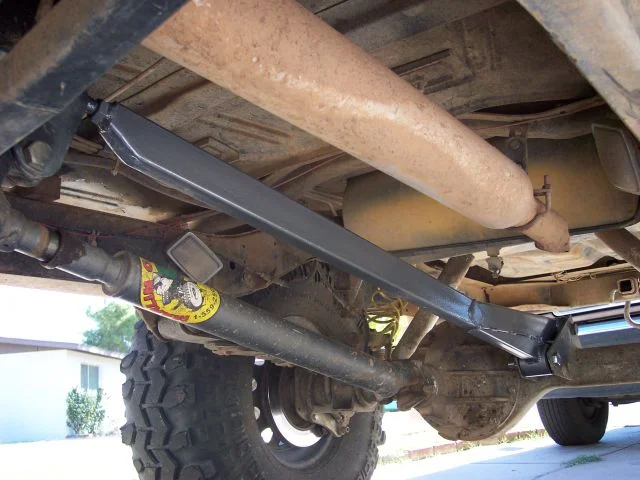

If anyone has used the radius arm off an early Bronco for an anti-wrap bar or even tried such a thing could you please post up and let me know how it worrked or if I'm just going to be wasteing my time.
bill i dont have a link but there have been a few through the years they work just fine but short IMOP. what 2 bad and i are posting is pretty much the same design principal.
mine has served me well for a few years now, the bend is to keep clear of the airtank.
