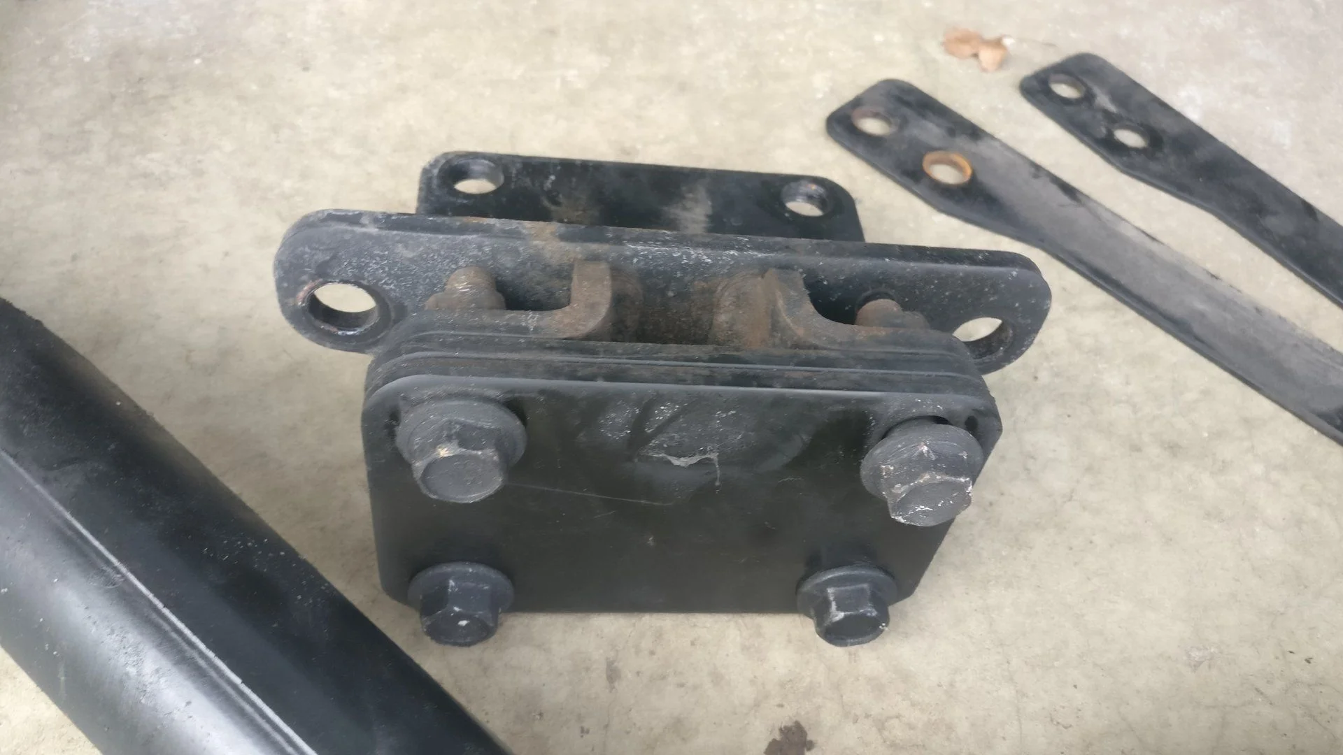

Got a picture of it? I have removed the hitch on my truck several years ago and remember there being like a sandwich plate in there but what I currently have is more of a pintle plate... Also could you get a measurement of it's thickness?

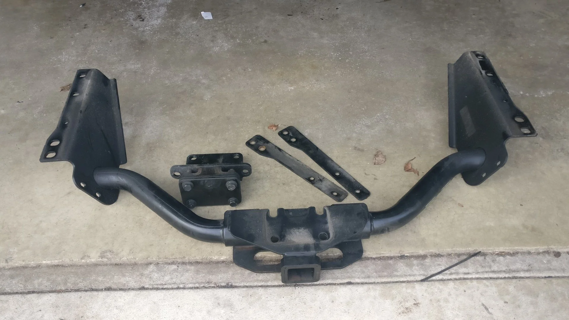

Not exactly sure but the GX version comes in 5 piece.
  1. Main hitch
  2. Center support
  3. Spacer for each side rail
  4. Spacer for center piece.
I was wondering why would it come with 3 piece spacer. What I am thinking the main 3 piece are the same but the 4runner one does not have spacer.

You may just be on to something. The GX has a different body and the bumper skins may hang lower than the 4runners

So after some more research and talking with someone with a lot more parts experience than myself we determined that the reason for the difference in part numbers is simply the hitch cap, the 4runner one will have a Toyota logo, and the GX one will have a Lexus logo... Other than that the parts are the same, they all have the same spacers. So I'm saving $200+ and buying it from Toyota. This way I ensure I get everything I need. And for the same cost I'd be able to pick up a class III hitch for from U-haul or Curt.
someone posted a pic above of it, they titled the pic rear cross member adapter. Mine is just new is all
You can just get a 4runner/gx pintle hitch(support tube type) and put it in place of the rear cross member adaptor.
