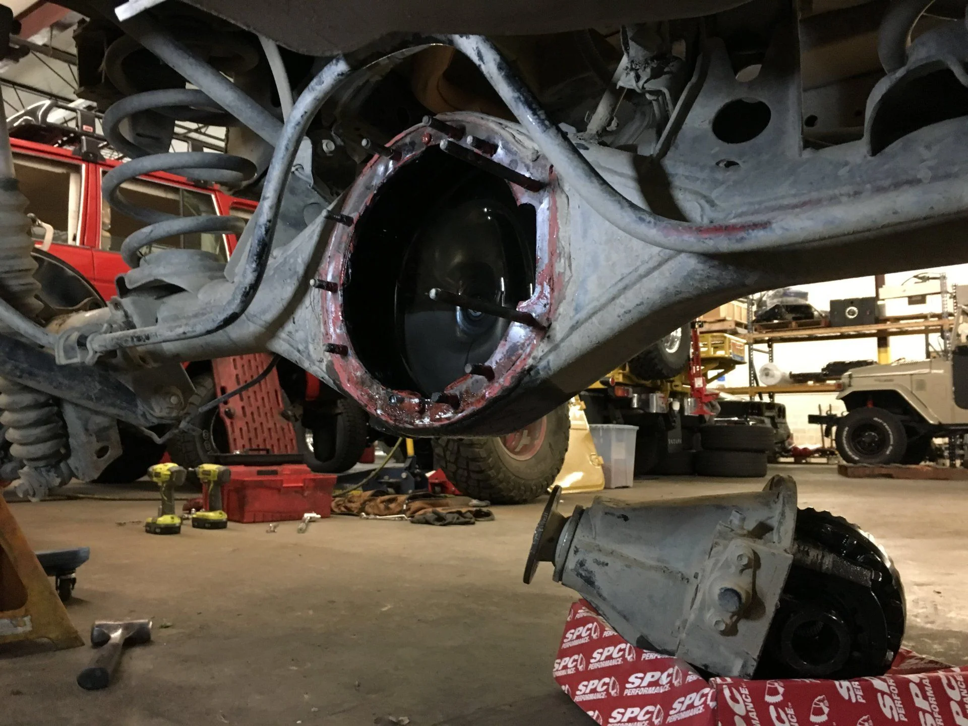

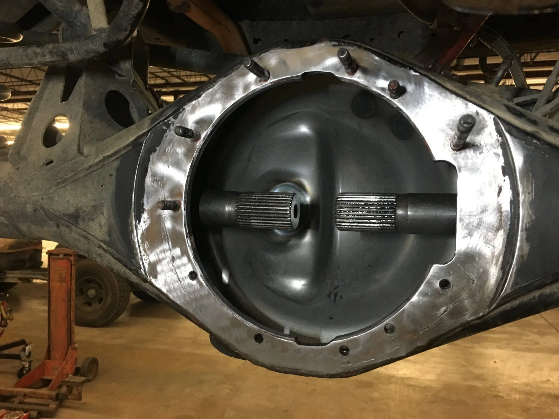

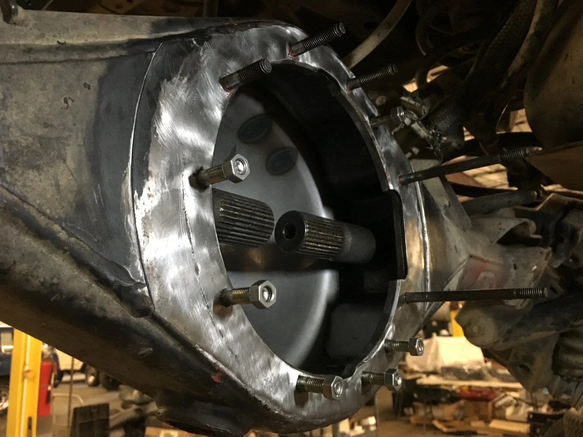

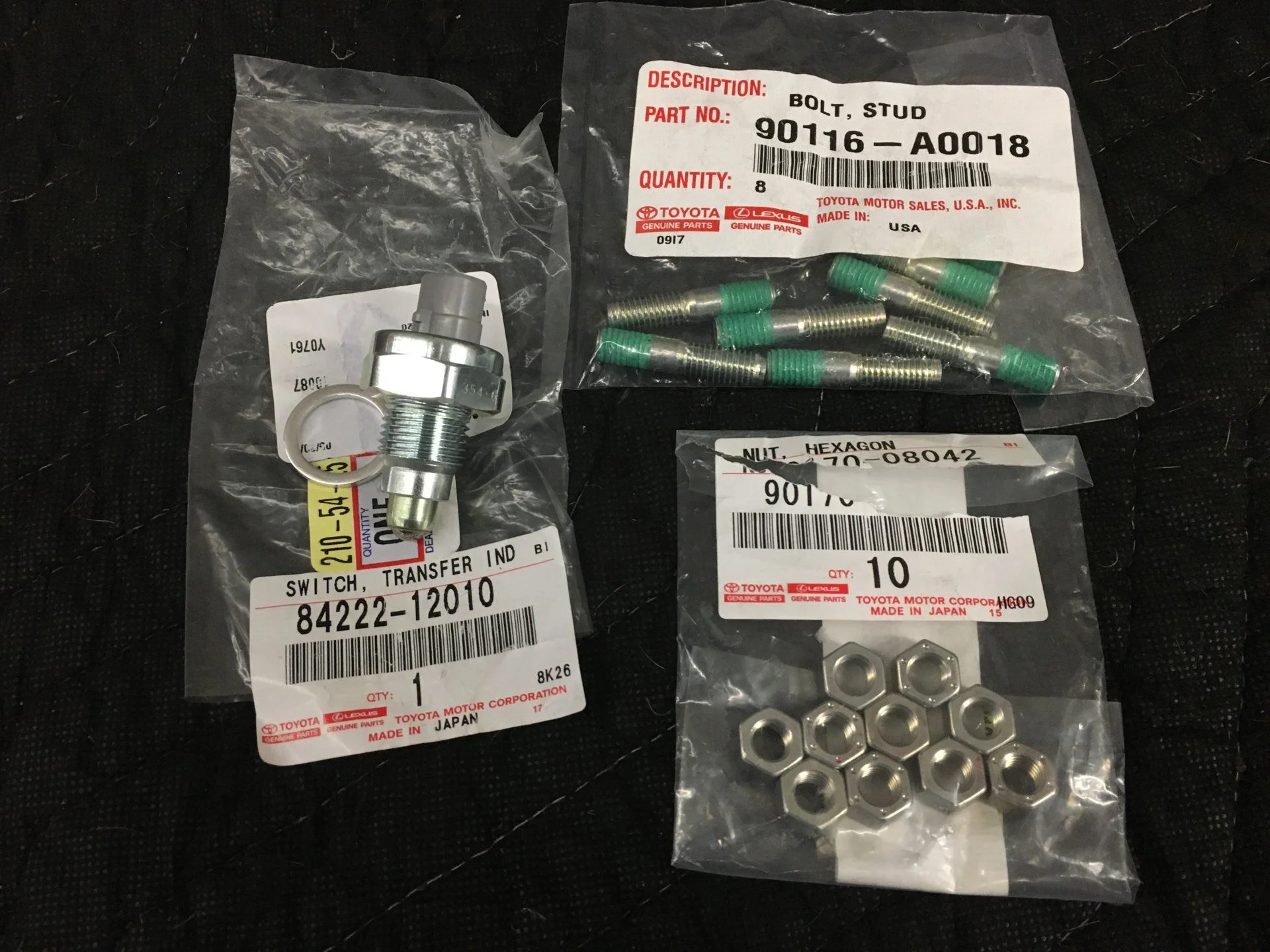

The little M8-125 studs with 12mm nuts that hold the third member in the axle housing worked loose and I popped one trying to re-torque it. GAhhhhhh! No doubt it was compromised once the nuts backed off and there was enough flex. I attempted to drill it out, but the little f'ers are hardened (these may have been ARPs in fact). So that meant I had to pull the 3rd to extract it from inside the housing.

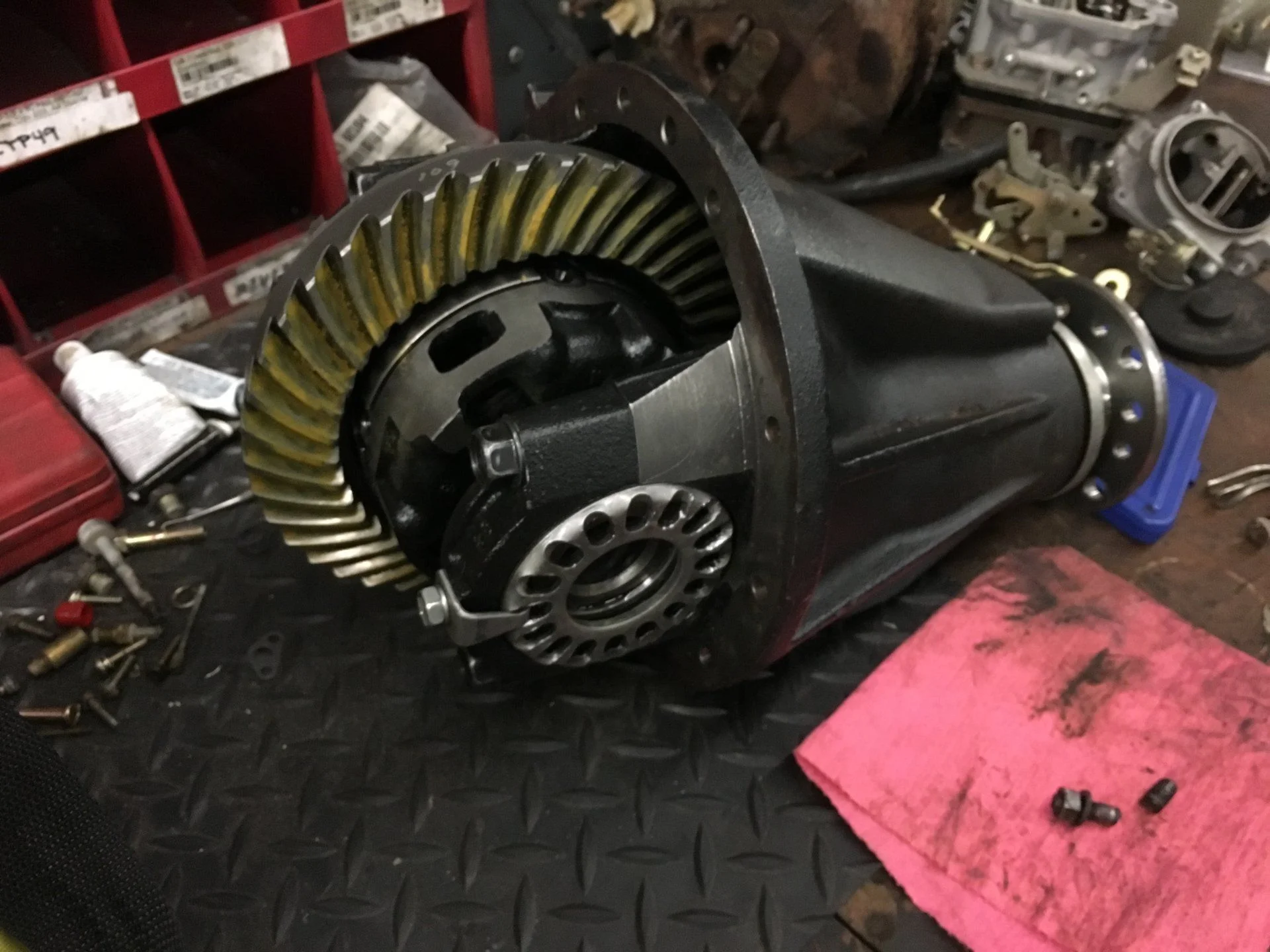

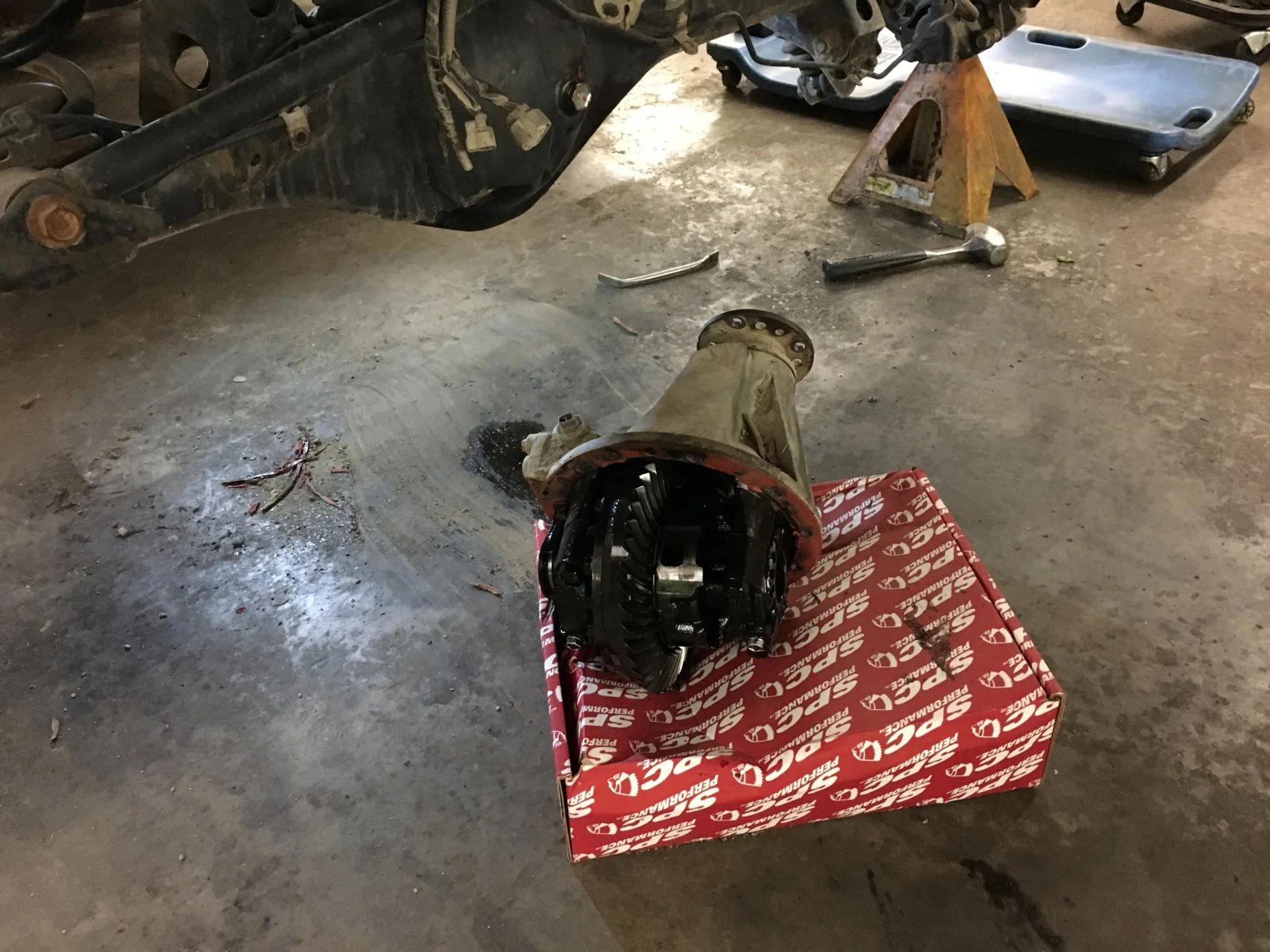

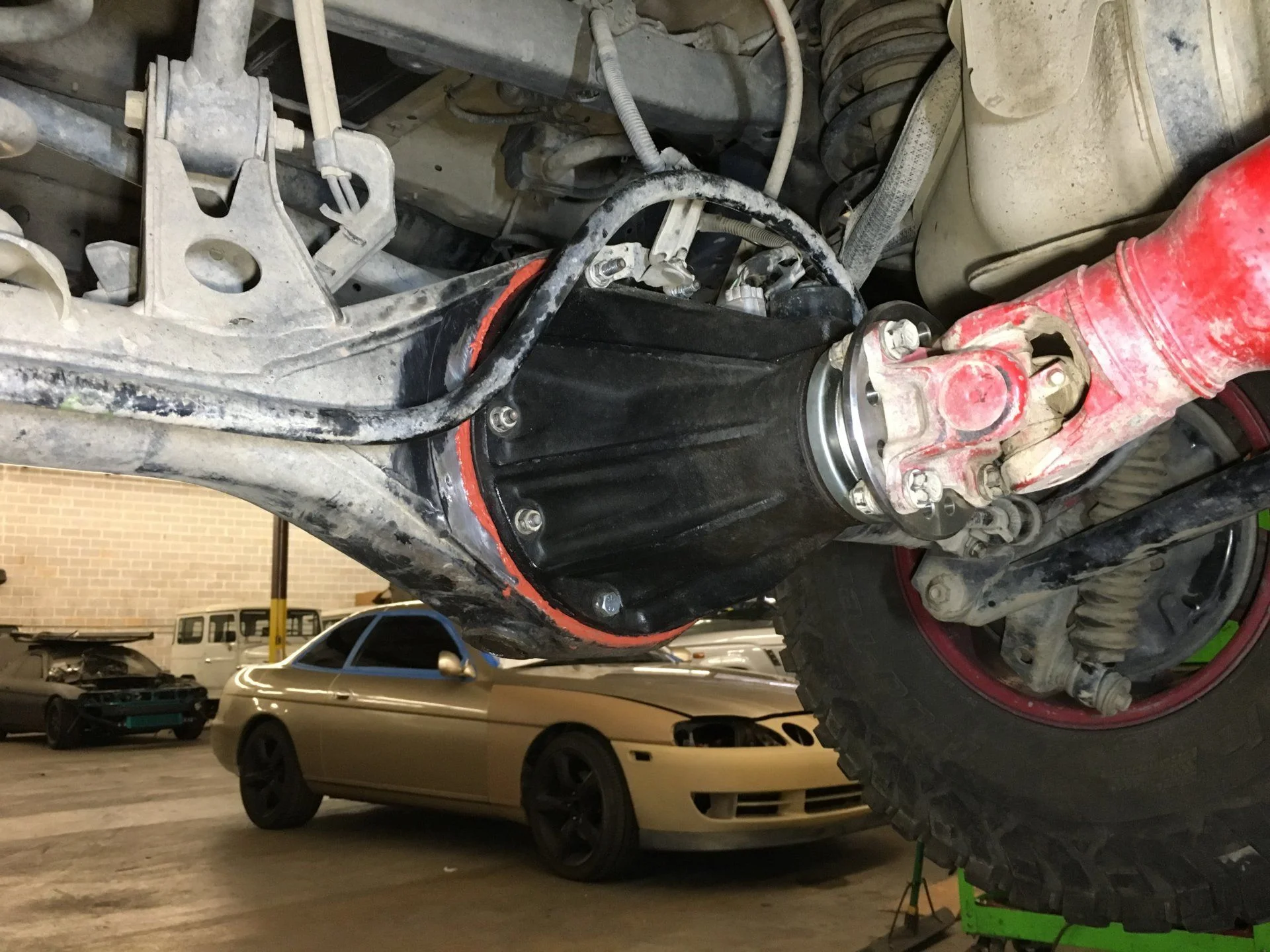

Luckily (or is this some corollary to Murphy's Law?), I had just finished rebuilding my "spare" third member. I just hadn't planned on installing it this soon. But since I was going to have to pull everything anyway, I decided the fresh chunk should go in and the old one would become my trail spare.
