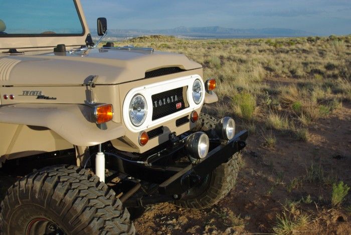

A few sexy calendar shots. It drives pretty good, but I did find myself holding up traffic. A race car it's not.
  • Love the tractor engine.
  • Love the low range on the Mark's gears, though I wasn't able to really test them.
  • The Mark's gears are noisy (whine).
  • The driver's door is loose and rattles. Should be an easy fix.
  • The rear tire rack is not as steady as I thought it would be.
  • The rear locker tosses the truck around when letting off the throttle.
  • I came back Unser and never went over 2000rpm @ about 50mph. The engine is really happy around 1500rpm.
  • The only serious issue was I noticed it was puking PS fluid.
  • Lots of heat off the floor.
  • I need to get fish-eye mirrors on the mirrors.

I think the PS leak was a loose/stripped clamp. The clamp on the gear box return line would not tighten down so I replaced it. I'm going to take it for a putt this morning and see what happens.

I wonder if your PS fluid will overflow out of the res a little bit until everything had a chance to get warm and expand? I see that you found the source of the leak but keep an eye on the level.

That truck is beautiful on the street (I can't imagine what it will be like on a trail). Especially at night it was pretty cool seeing it running along near us. Your turn signals on the back were especially cool when they came on.

Were they bright enough? I was concerned because they don't look like much during the day. I'm looking at a LED lamp with three bulbs.
At night they absolutely are.
not sure about during the day. My red LED brake lights are much brighter during the day than I thought they would be, and I'd suspect your amber turn signals also would be.
Dan
If your running ovals (looked like it from the pics), might even check out the 48 bulb units. Our club members say they have no problem seeing my rig through the dust. In fact, I even had a complaint about how bright the brake lights were.:lol:
