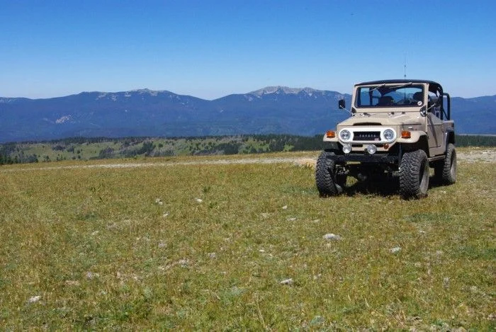

Not exactly trail, but good enough.
1) On top of Elk Mtn with the repeater.
2) View on top of Elk Mtn.
3) On the way up.

Sunset? Now you get to *drive it*!
Two inches front, two inches rear.

How did you get the 2" front and rear? I re-drilled the spring perch on the rear axle of my LX for 1.5" longer at the rear and it made a great improvement. I plan to do the same to the front.
Cheers,
Josh
I have Alcan springs. I told them to place the axle bolt 2" forward/rearward, and make the springs 2" longer.
