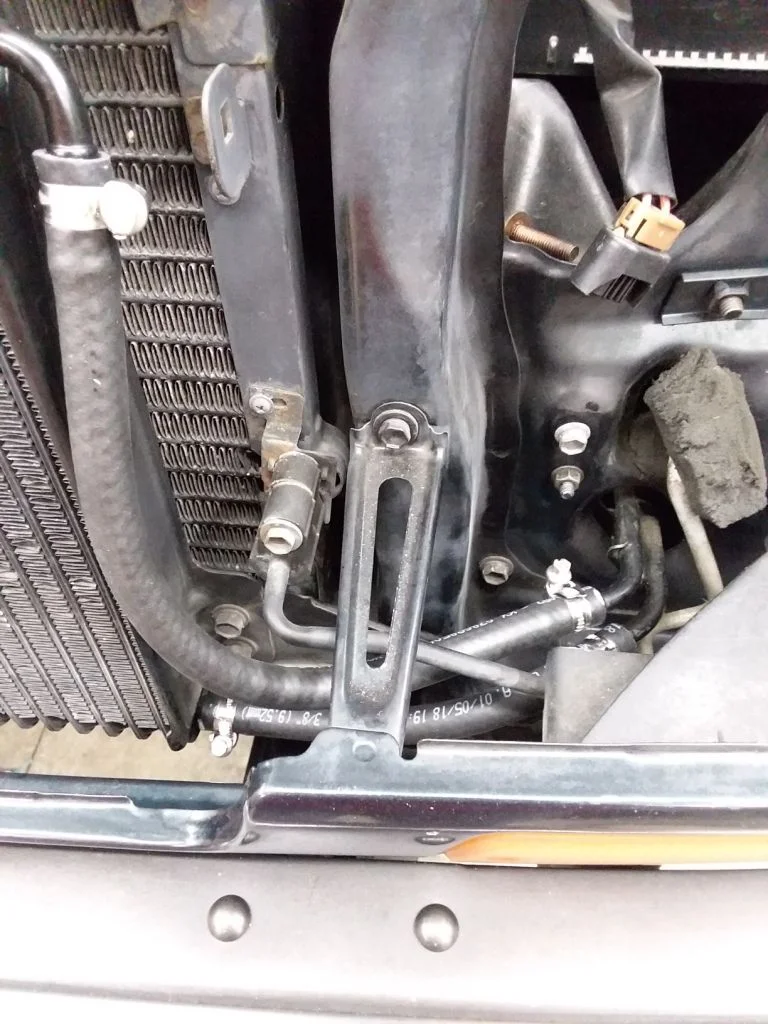

Well finally decided on the power steering cooler, i'm going to use the factory A442 trans cooler. This thing is an absolute beast!!

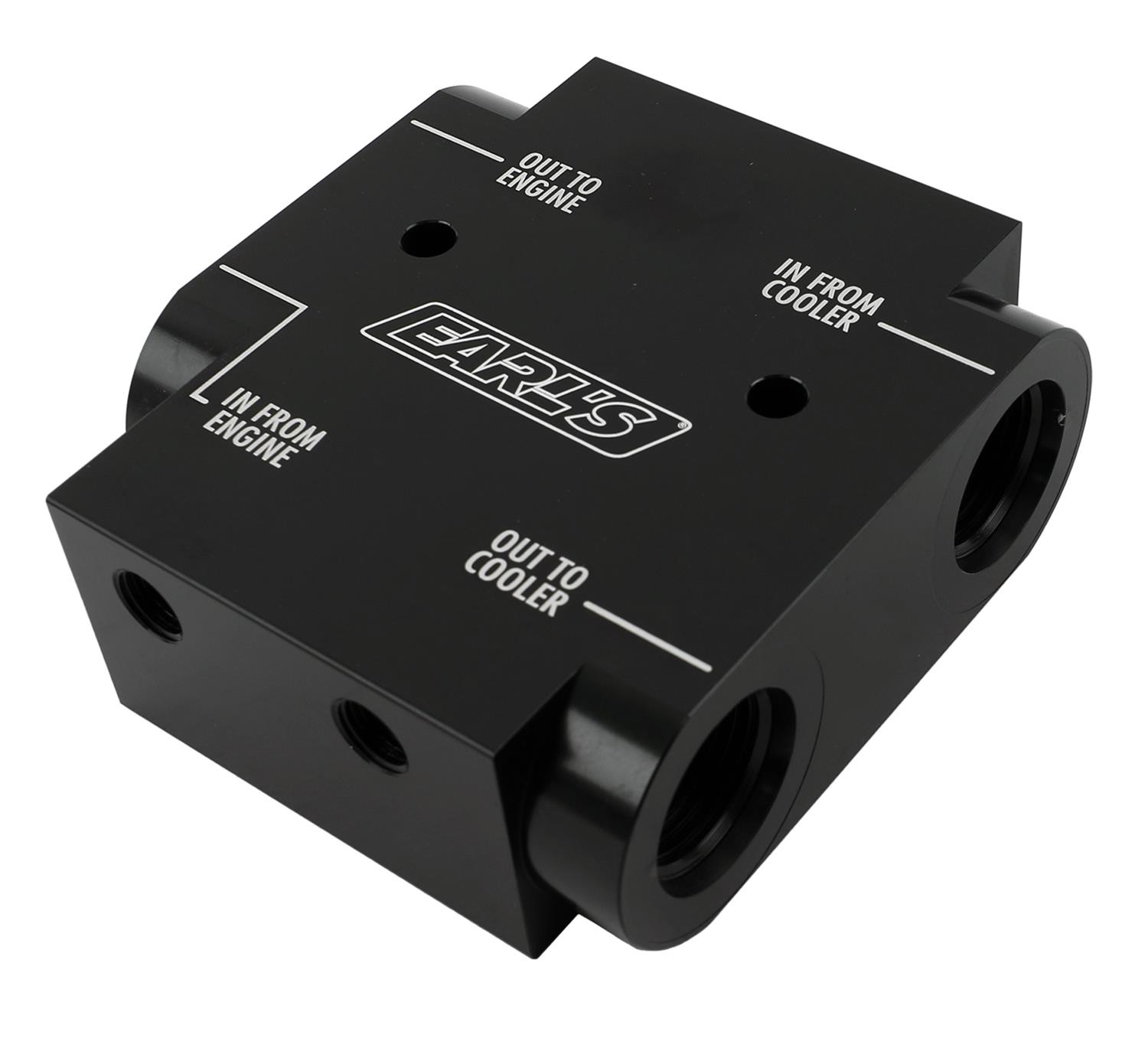

I found a device to help control fluid temperature so the fluid will still be able to get up to the correct operating temperature.
Mr. T did a really nice job designing the mounts for this cooler, there is a reason these rigs last so long!
I used some high quality hose from McMaster Carr, its rated to 50psi. I think the return circuit on the power steering system is well below this value, can anyone comment? The hose is made specifically for petro based chemicals so hopefully that will not be a problem. Some stainless hose clamps top everything off.:cheers:
For those intrested you can find the thermostat here
I figure if it can work for engine oil then power steering fluid shall also be ok.
When do you sleep??? What really cracks me up is when you ask for advice or input and we are like looking around, like "What??? From me???" This is a Master Class in innovation, creative engineering and mechanical ability, all presented in a down to earth, easy(ish) to follow dialog. Really digging on this!!
