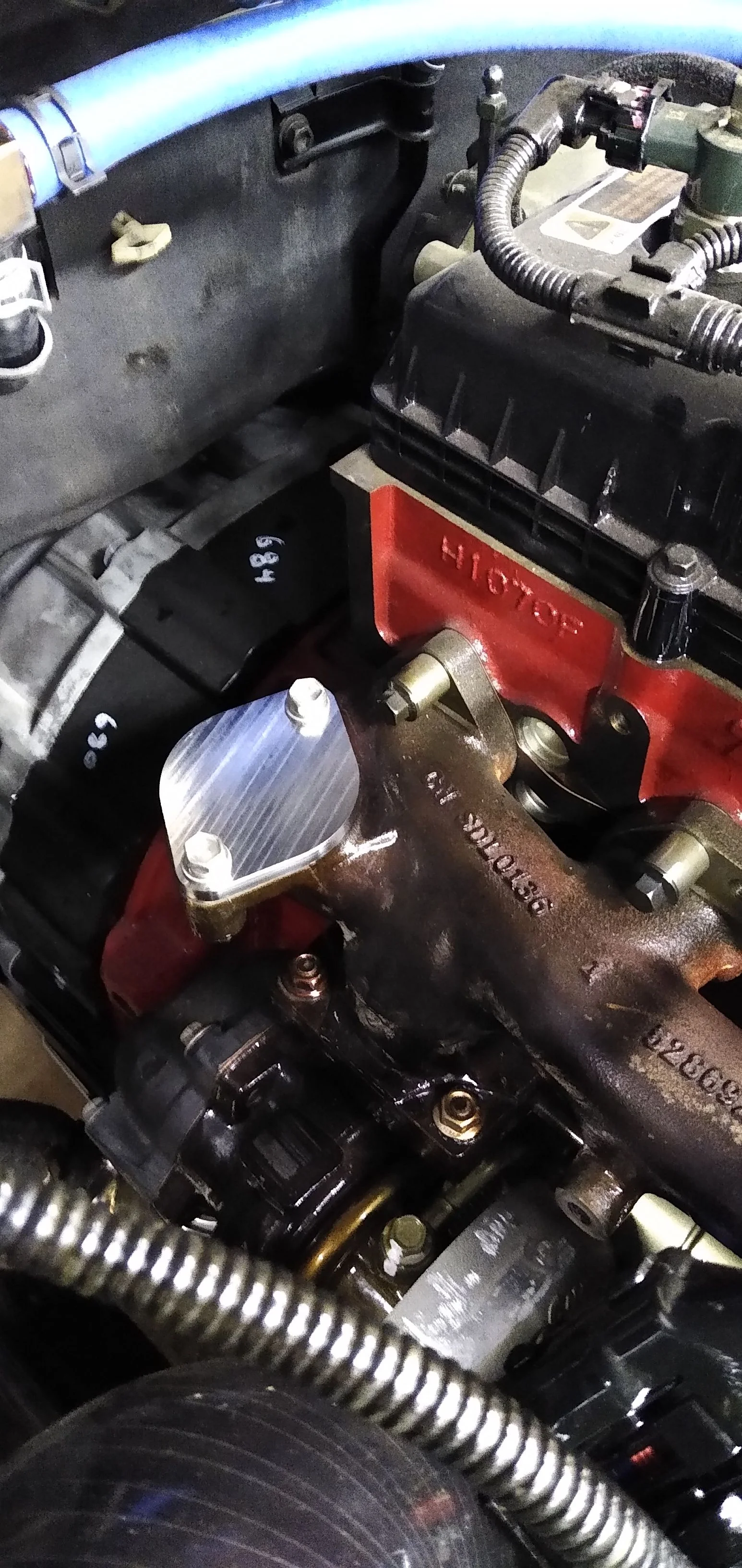

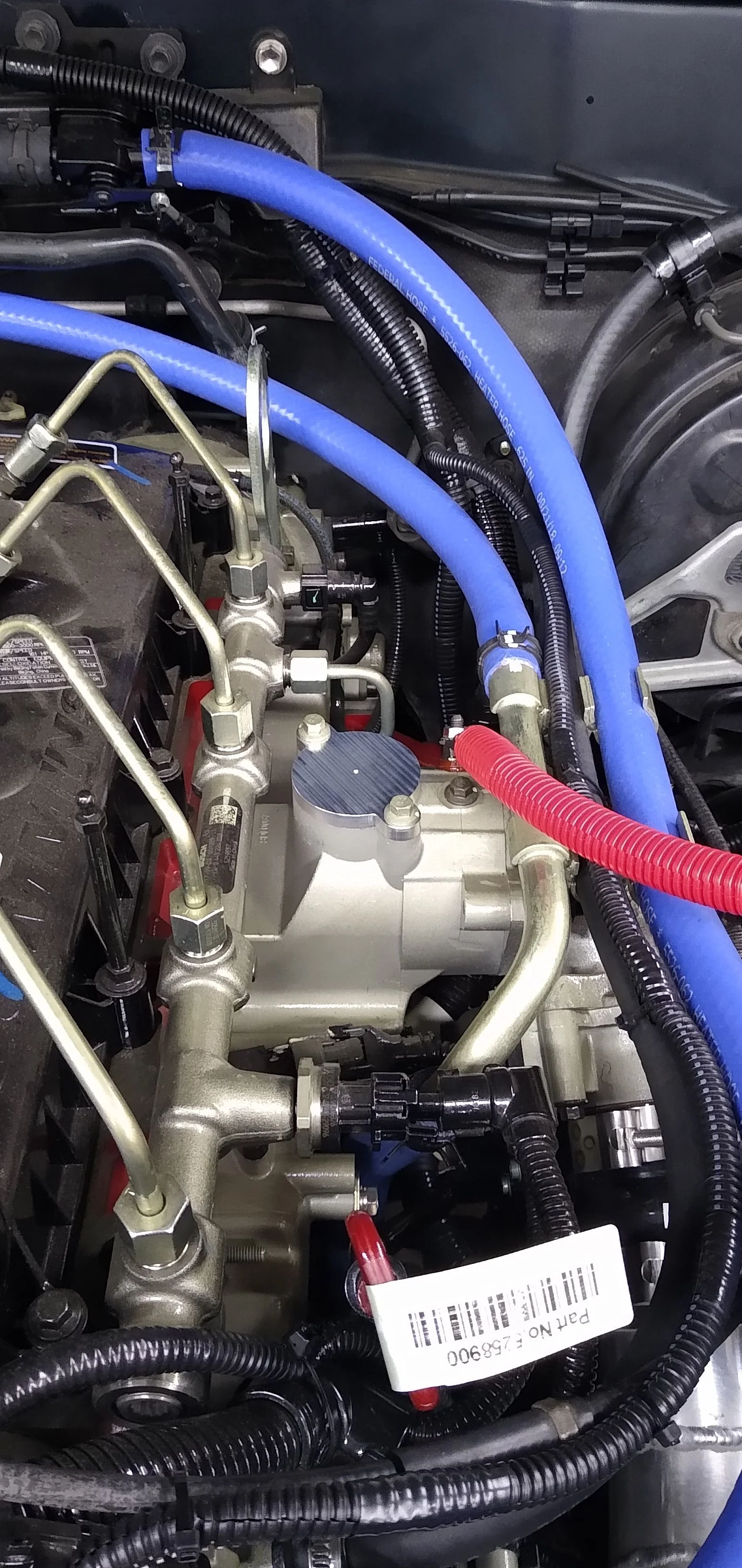

I am working on a desmog setup for this engine. I just have not been able to get the custom intake to play nice with the MAF sensor so the s*** is coming off. Just to recap, the MAF basically controls EGR input and that is what makes my engine run like s***. There is a pedal dance procedure that cummins has outlined to re-calibrate the system, but with my custom throttle setup it does not work, most likely that is my fault due to my custom throttle setup. Truth be told I swapped back to the cummins pedal assembly and it still did not work, I even moved the TPS with a screwdriver and bad my wife count off with a stop watch. I bet I took 50k miles off of my engine by having it hit redline before there was oil to the bearings, what a stupid ****ing idea.

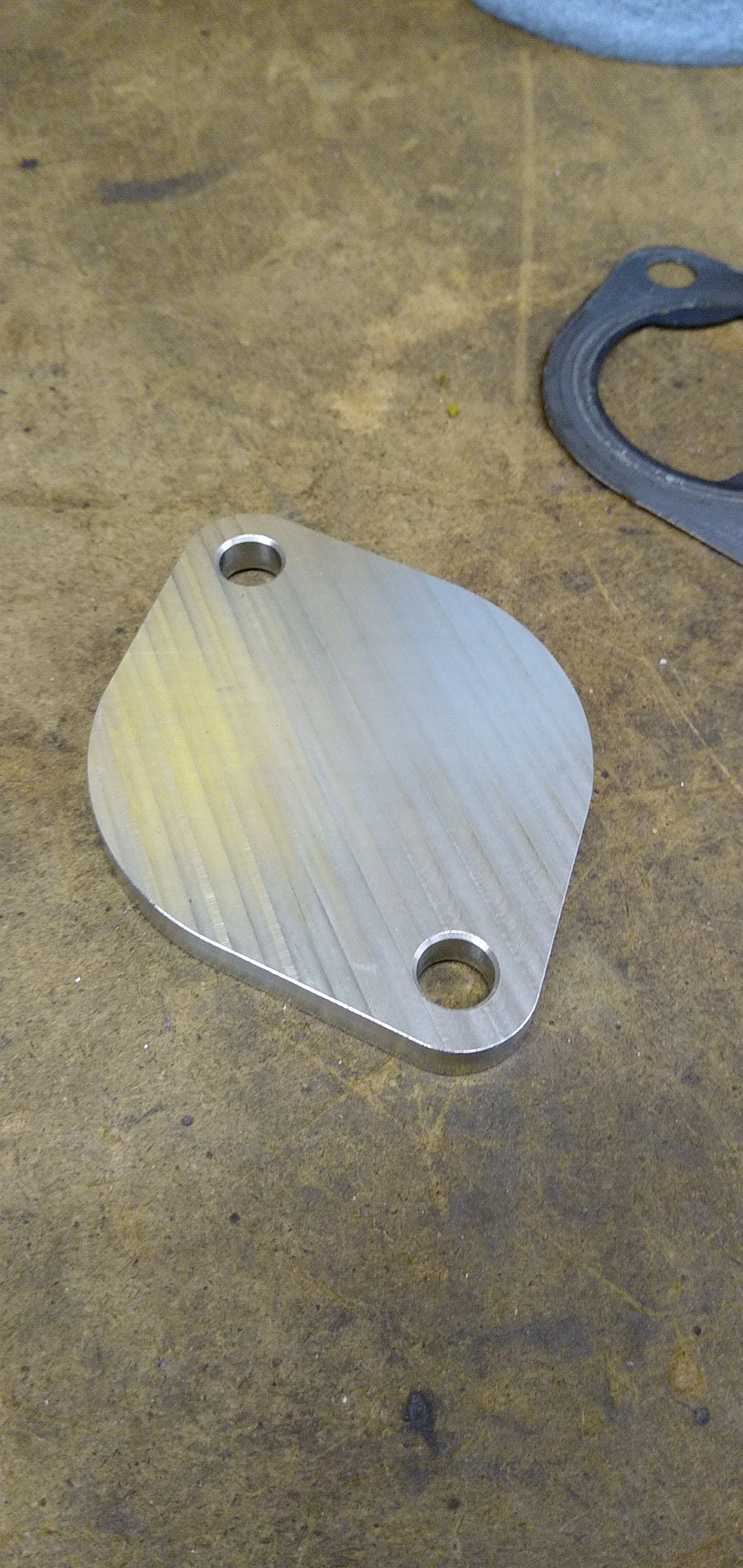

I am working with a local tuner who currently has the ECM and is doing some tweeks as we speak. I designed some nice block off plates to allow for the removal of this god awful mess. If you remember back to the beginning of this process, it was the EGR that ruined the installation of this engine in the 80 series. They literally could not make it worse than they did, I suppose it would be great for a cab over style truck but not for a normal vehicle.
Had I done this initially I could have moved the engine back another 1.5'', then the adapter would look much more presentable.
Here is the intake block off, I designed in a little "dot" to serve as a guide in case someone wanted to drill and tap it for a boost gauge. This is 6061 Alum as you can prolly tell.
On the exhaust side I used some 0.25'' thick 304 stainless. Just look at all that new real estate. What an improvement. I should have done this months ago, but many searches turned up nothing for R2.8 tuning. I know I will get the "I told ya so" speech from at least one member on here.

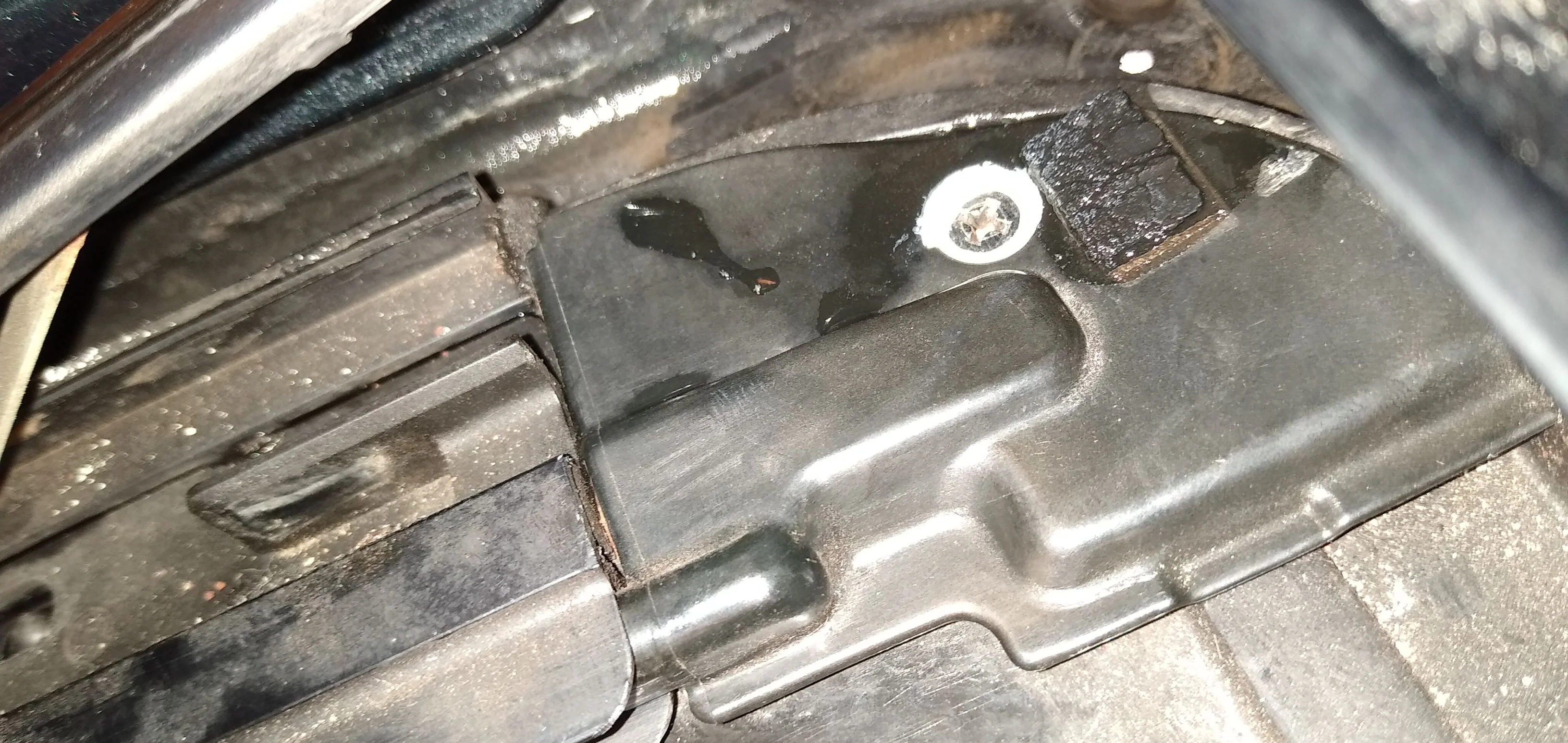

Now I have a non-powertrain problem for the experts on here. Even before I did the swap I had a leak somewhere in the sunroof, right over my head to make it worse. The headliner would be wet between the edge of the sunroof and the grab handle above the drivers door, then it would run town the A-pillar to the other grab handle.
Now being October in Michigan we are getting lots of rain. So today I got curious and tried to figure this out. Before anyone asks I did already verify that the drain tubes are free and clear.
Here is a picture of the main affected zone
I made this little video while sitting in my driveway during a nice soft rain.
Here is the Northwest drain tube connection

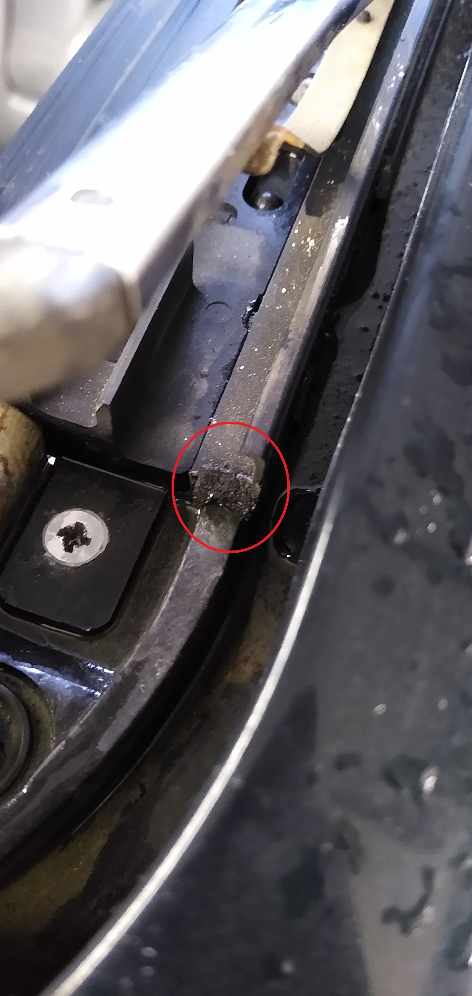

I took a gallon of water up topside when the sunroof was open and played around a little.
I found this little squishey foam thing, it appears to be the source of the leak, allowing water to flow from the exterior part of the tray into a non waterproof area where its free to drip down onto your head.
For clarity i'm talking about the thing circled in red
I cannot seem to repair this with the sunroof in the vehicle, does anyone have any tricks?

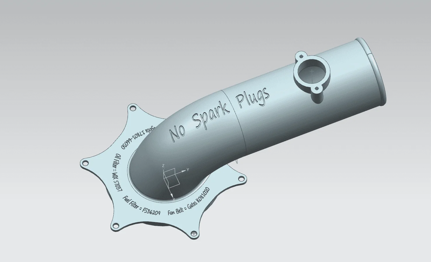

Having to take a bit of a pause on my build due to some job relocation issues. I have been working on a new intake design that should fix my MAF issues since I have no choice but to keep the emission crap.
Be warned, do not purchase EFI Live Cummins HD tuner, it will not allow you to modify these things. All in the name of helping me to follow laws in a country foreign to EFI Live. Sure glad a requested a demo file first, what a joke.

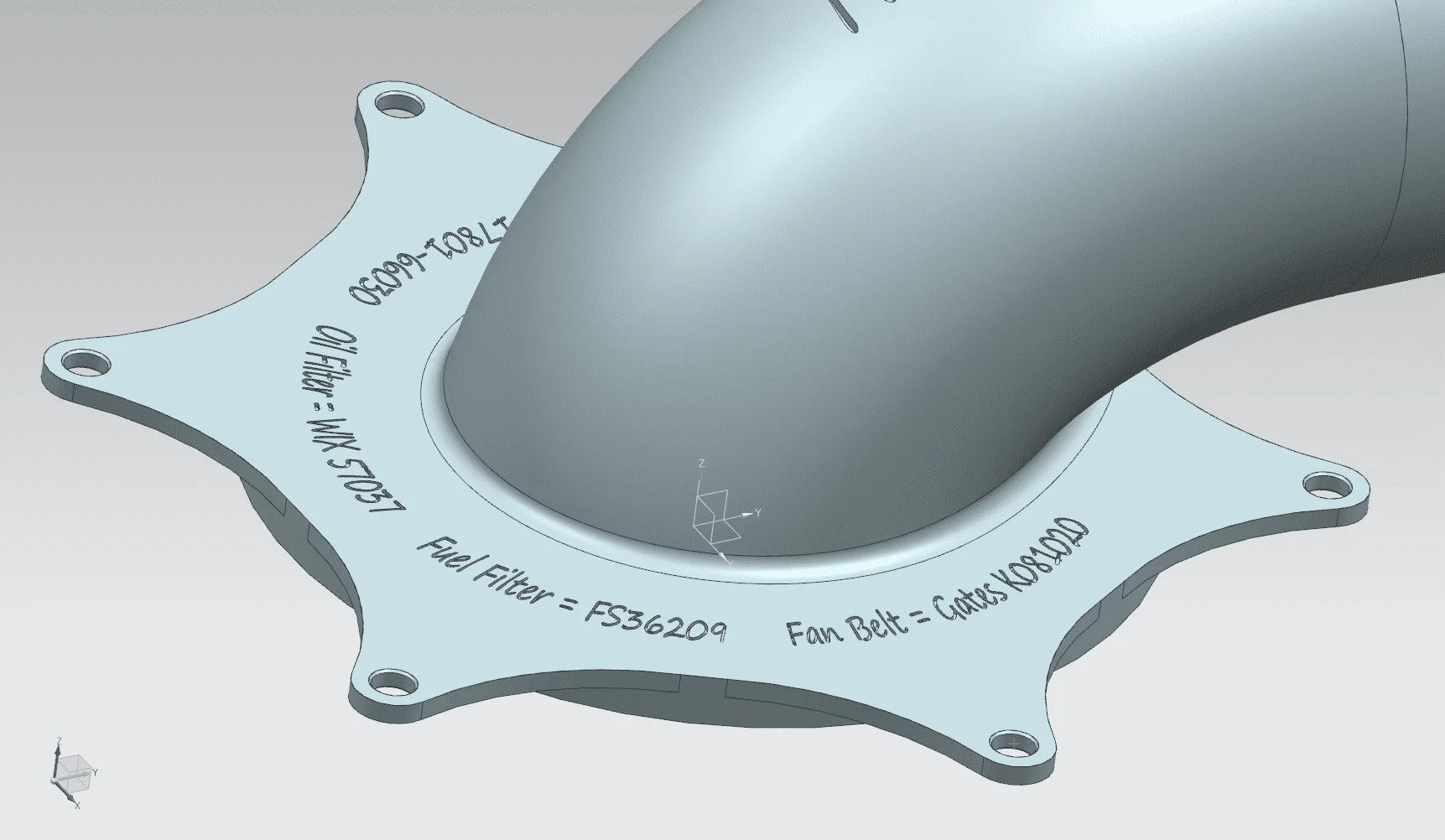

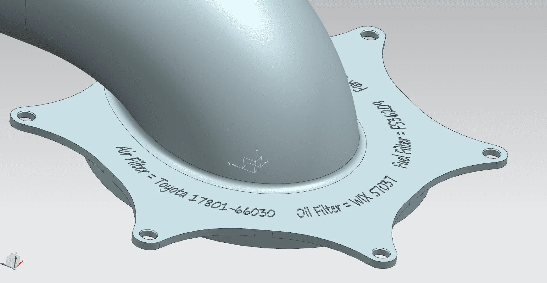

I cooked up this little part, and put the common filter and belt numbers on it so they are easy to find in an autozone parking lot.
What do y'all think?

That’s a really cool reference tool.
Why did you choose 17801-66030 vs 17801-61030 (beyond any economic factors)? Or, 17801-68020?
I get the feeling like you know something that I do not. I believe the number I put one my intake was the number that came up on japan-parts.eu.
Spill the beans!
