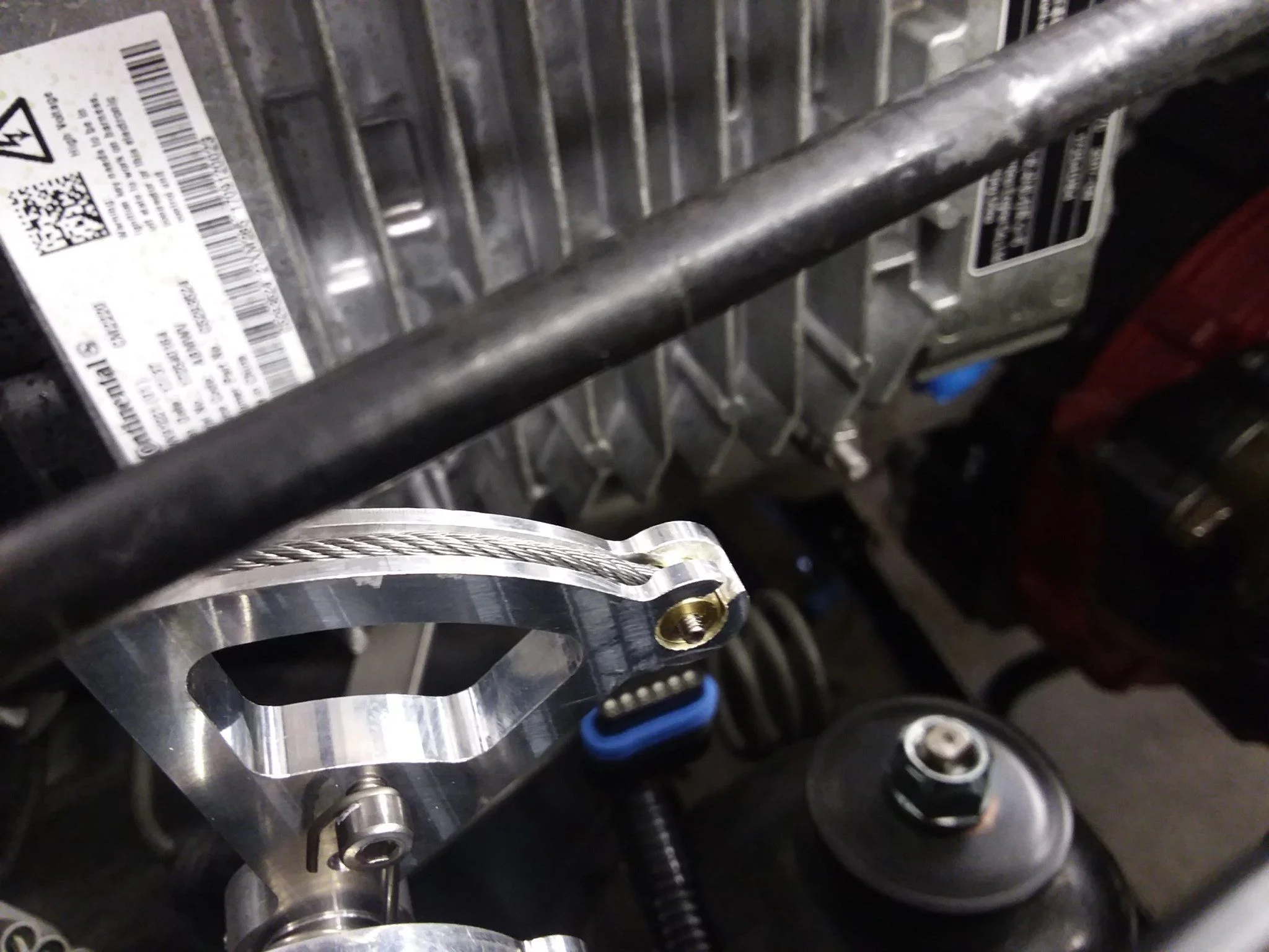

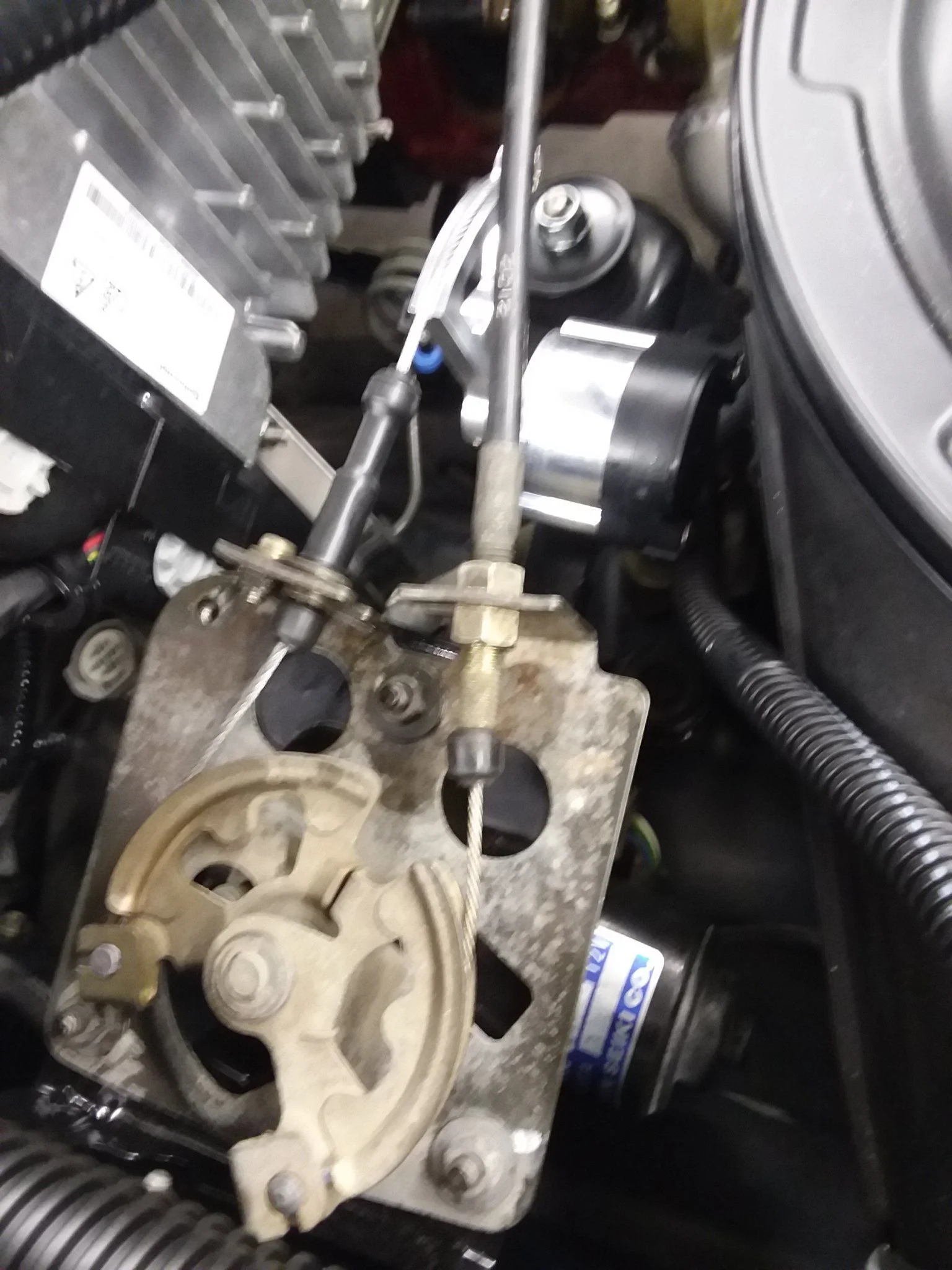

I only got one thing done with my free time during independence day. I finished my modified throttle cable setup.
I still would like a stiffer pedal, I might have to play with some of the springs in the cruise control actuator to get it just how I want it.
I made a little bronze part to act as a removable cable end, a set screw grips the cable. I hope this lasts....

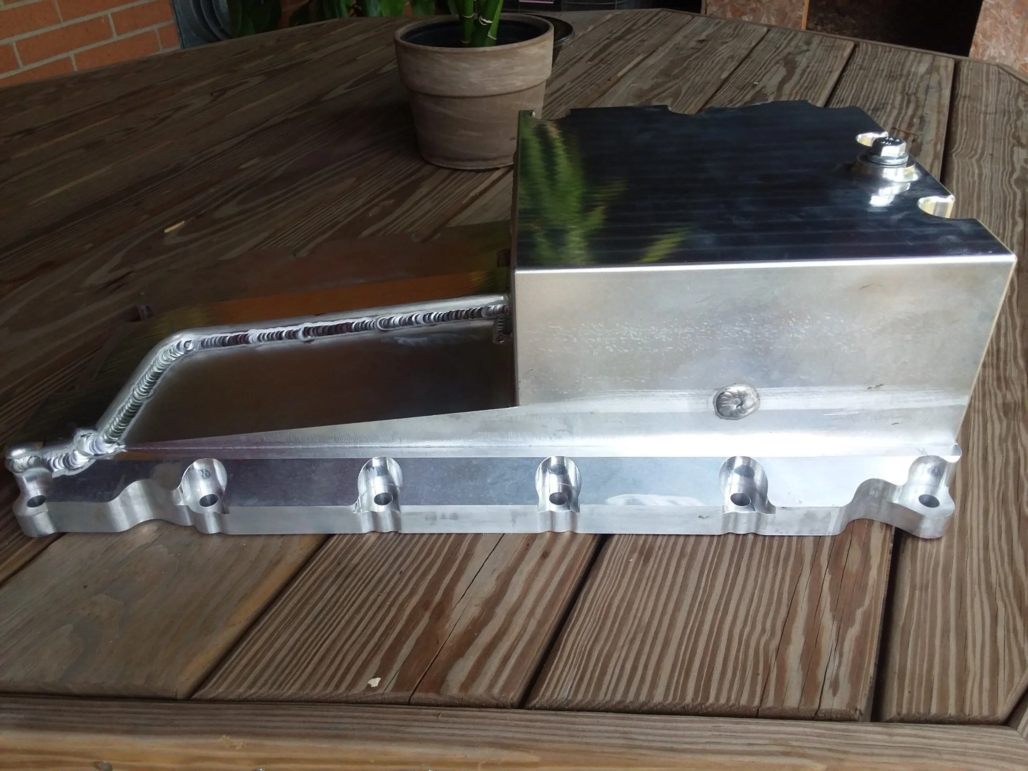

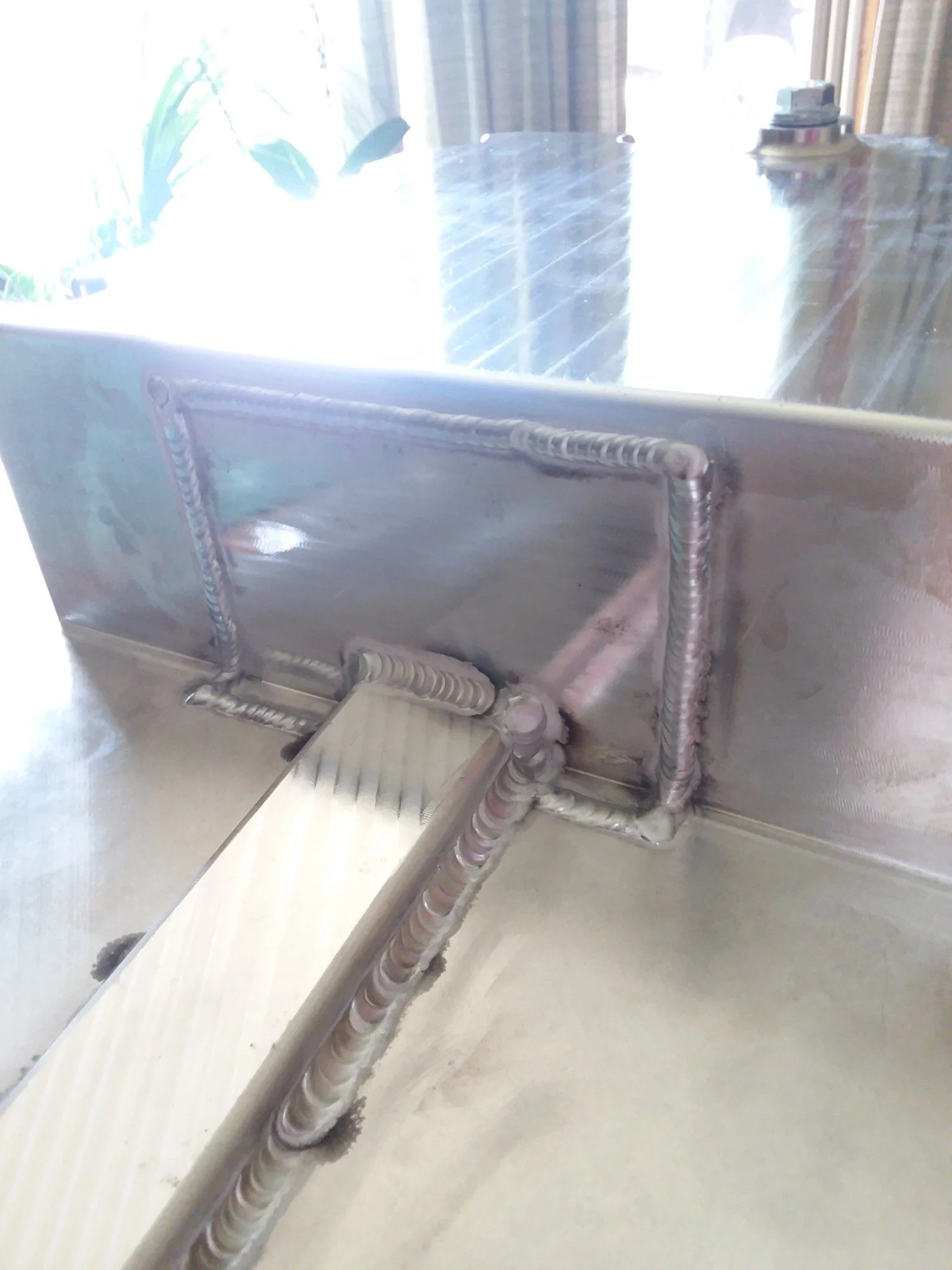

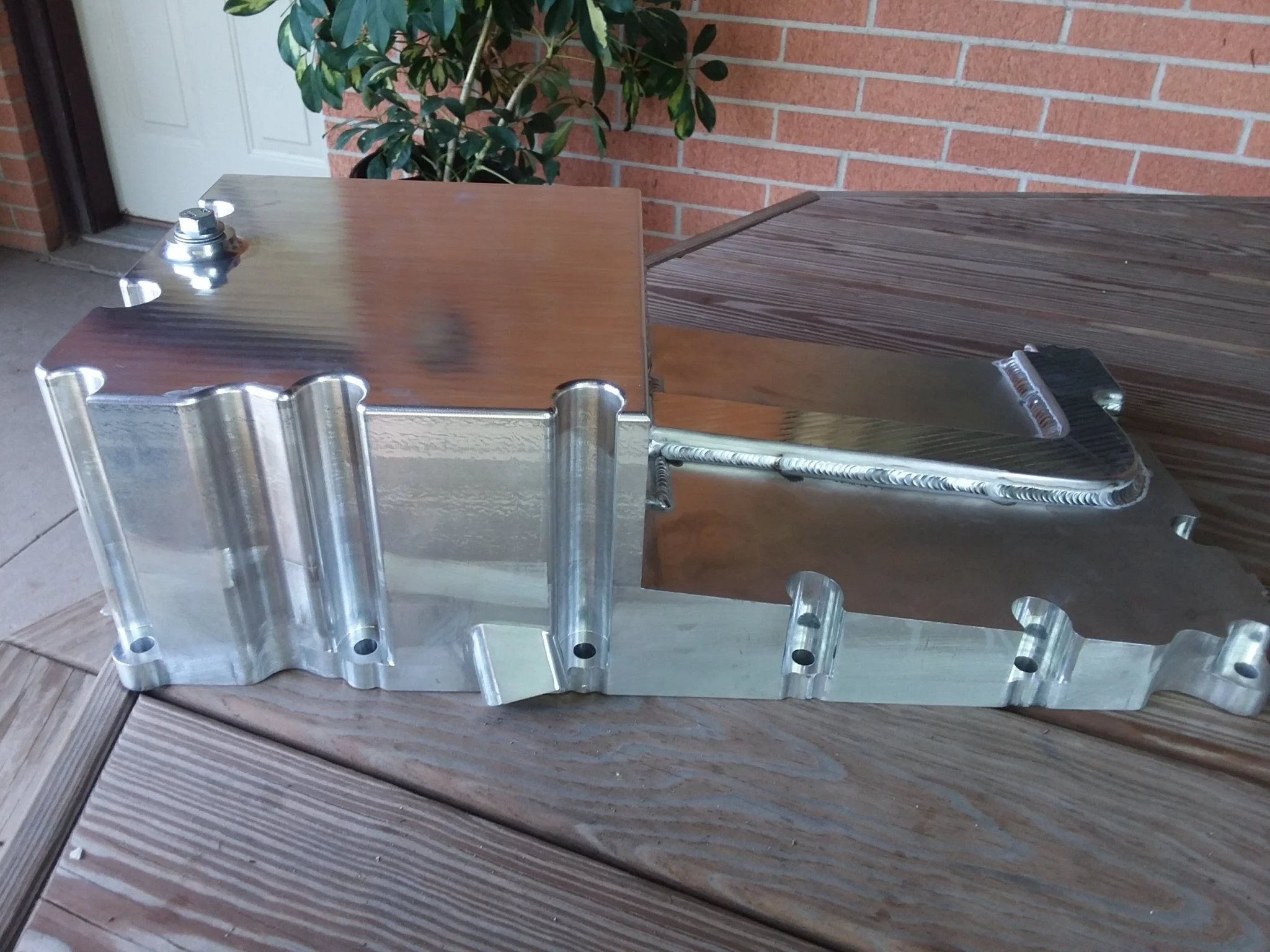

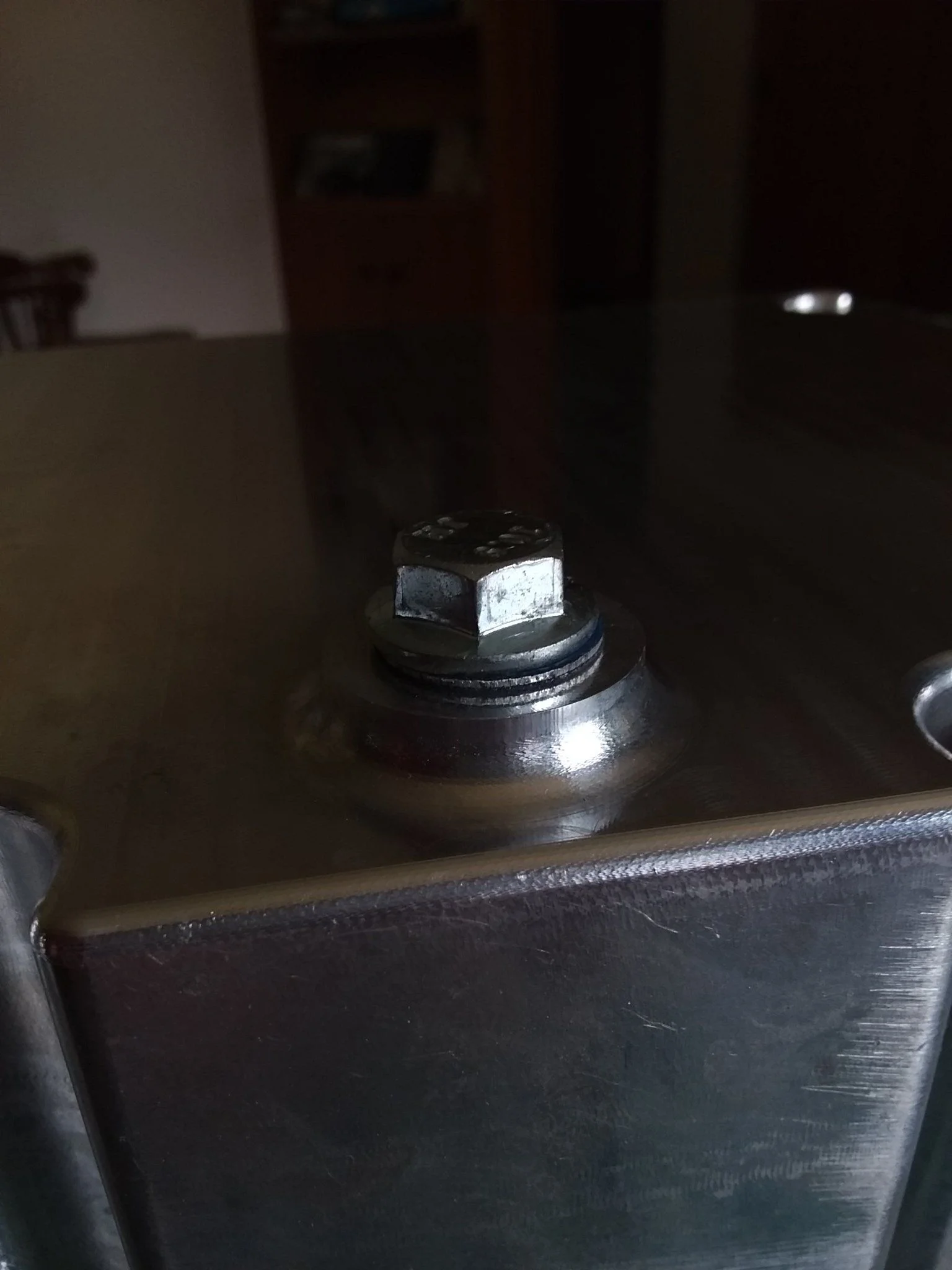

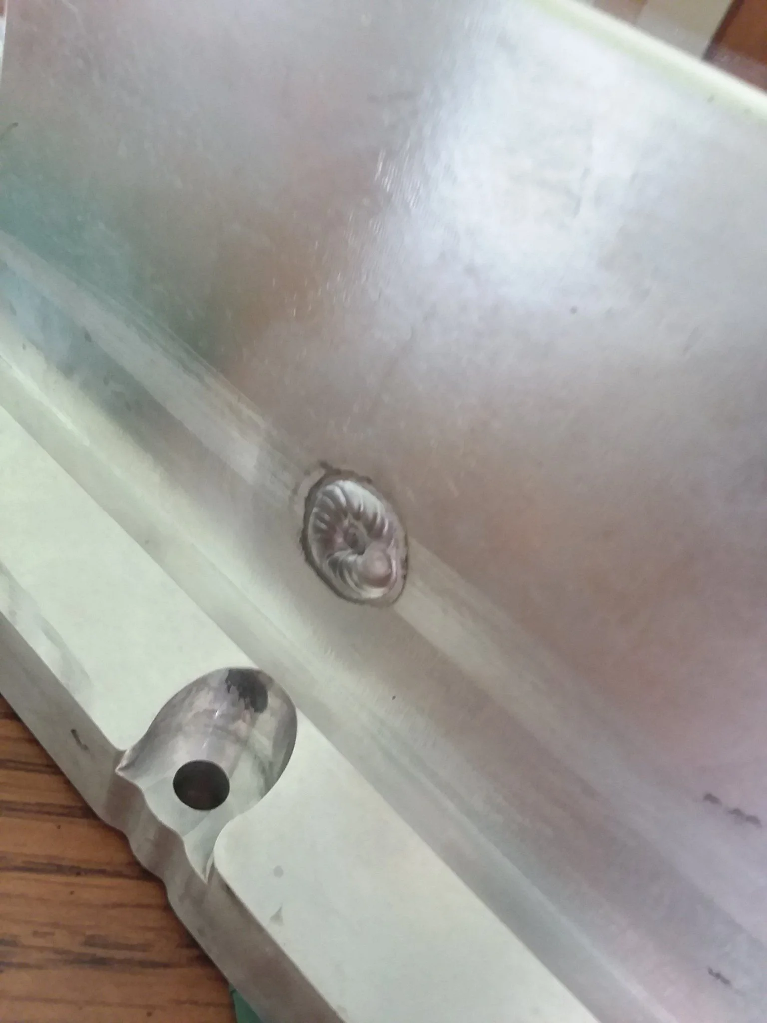

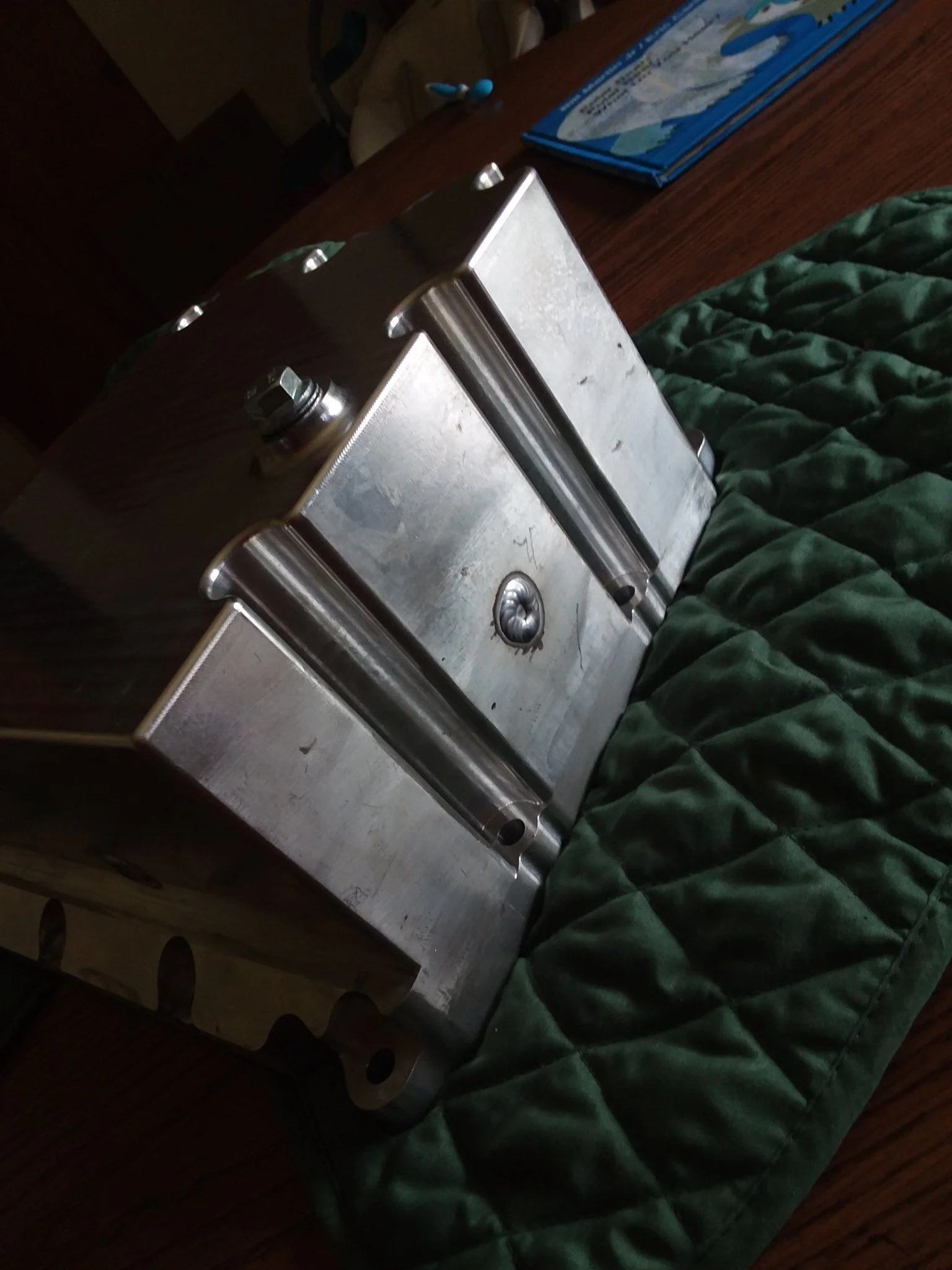

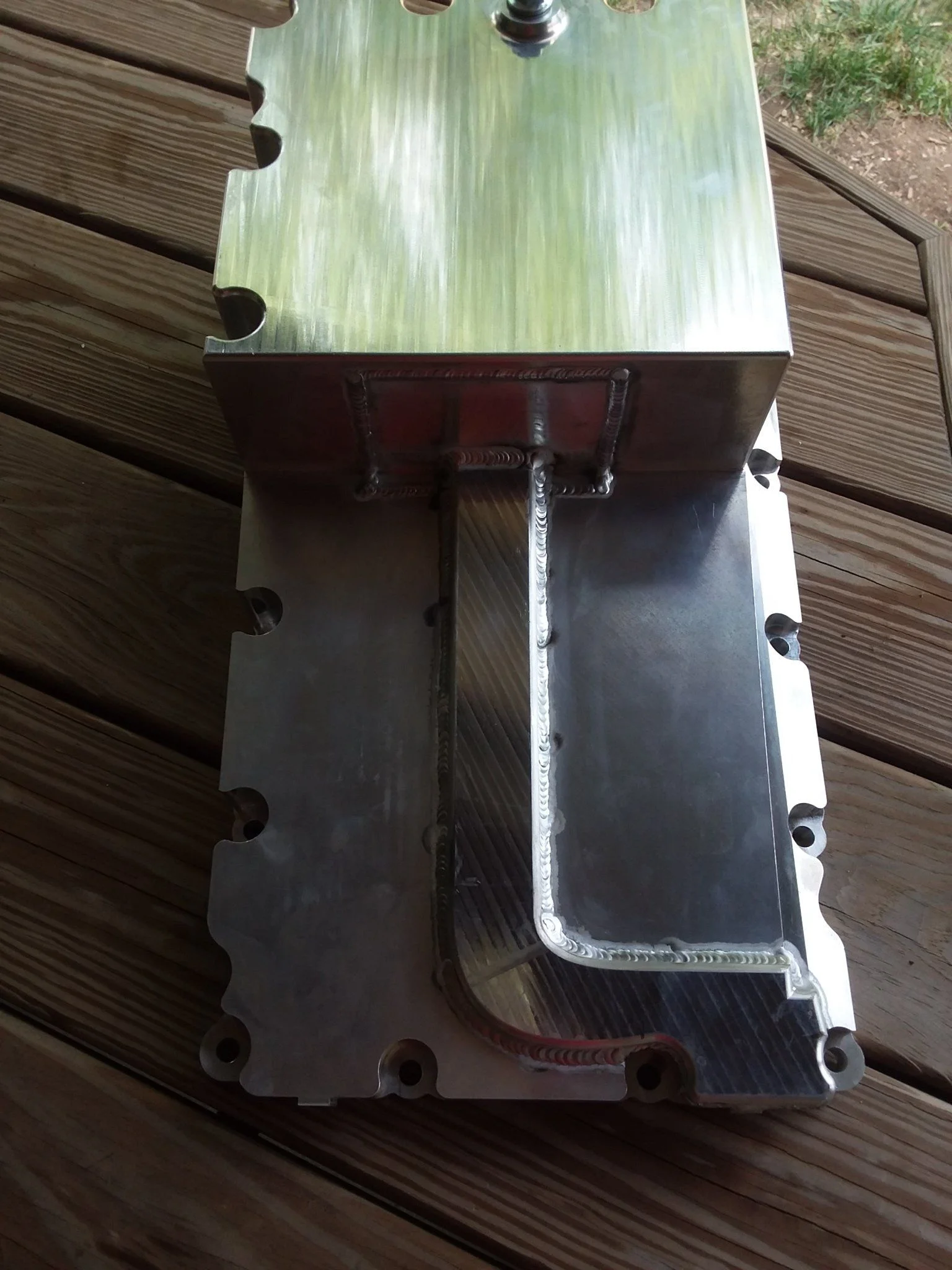

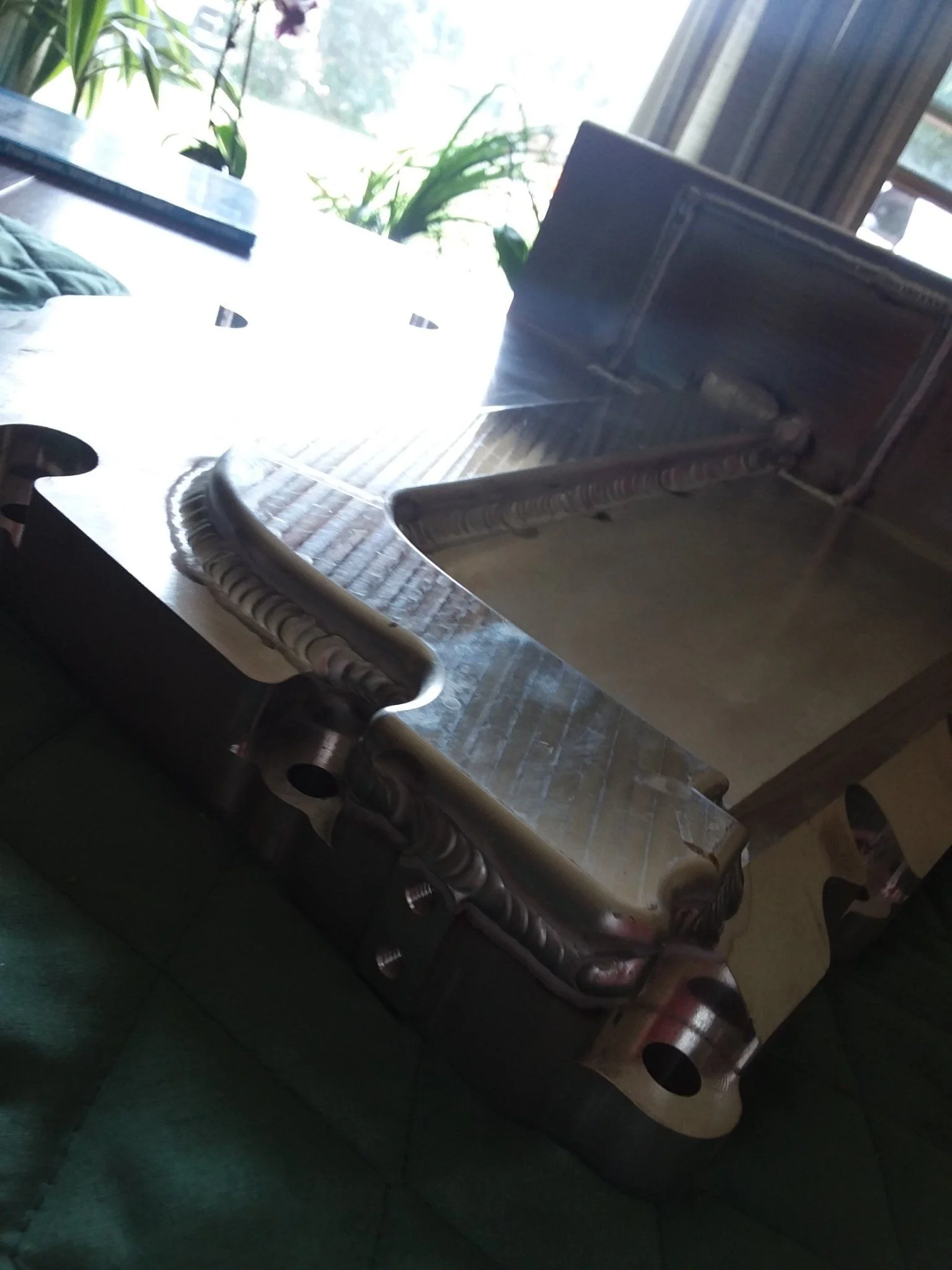

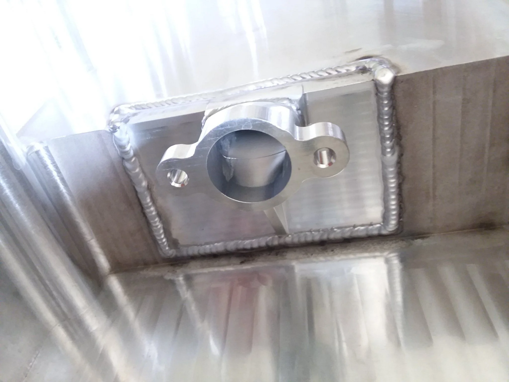

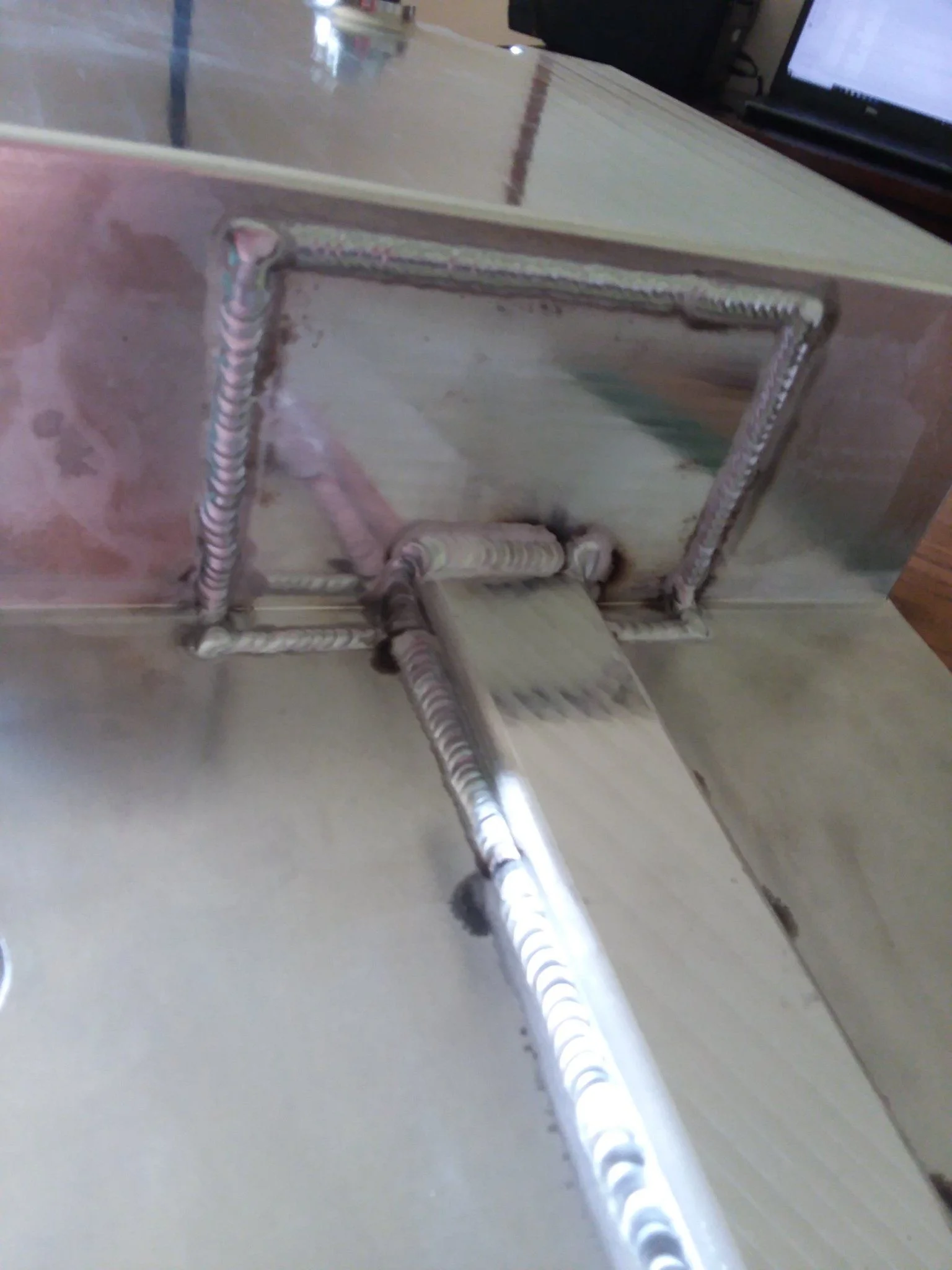

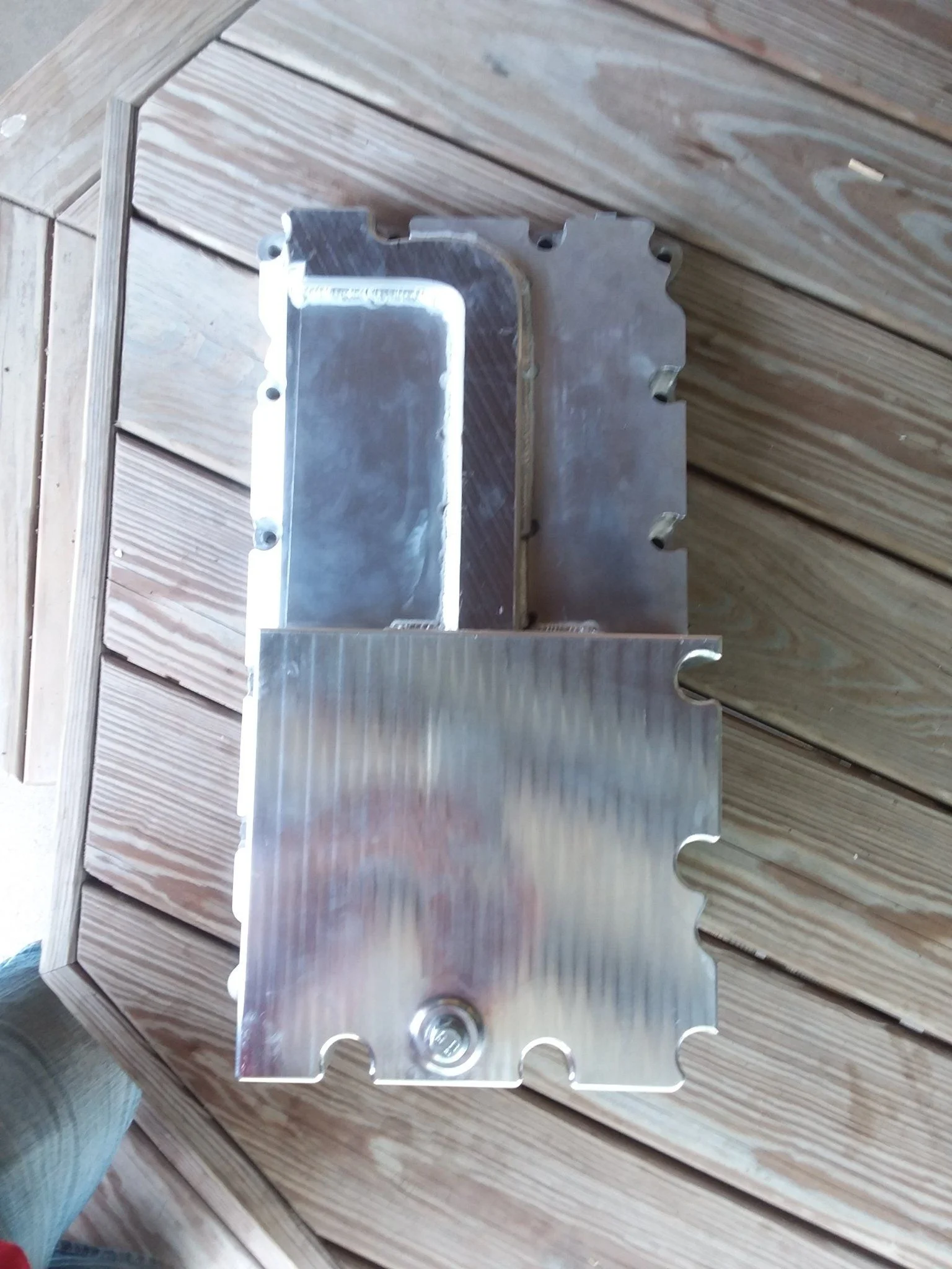

With the exception of my oil pickup tube my custom oil pan is complete. I went down to Diversified Welding in Toledo Ohio to have it welded professionally, well worth the trip!
I am not sure how many people read this thread who live in SE Michigan and NW Ohio but if you need some welding done these guys can help you out.
This first batch of pictures does not have very good lighting...
A few more pictures for you...
I am very happy with the welding and more importantly it does not leak. It was checked at the welding shop!
Next up, the oil pickup assembly!

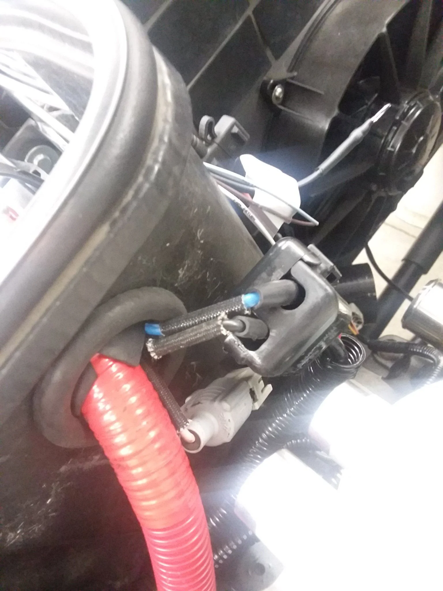

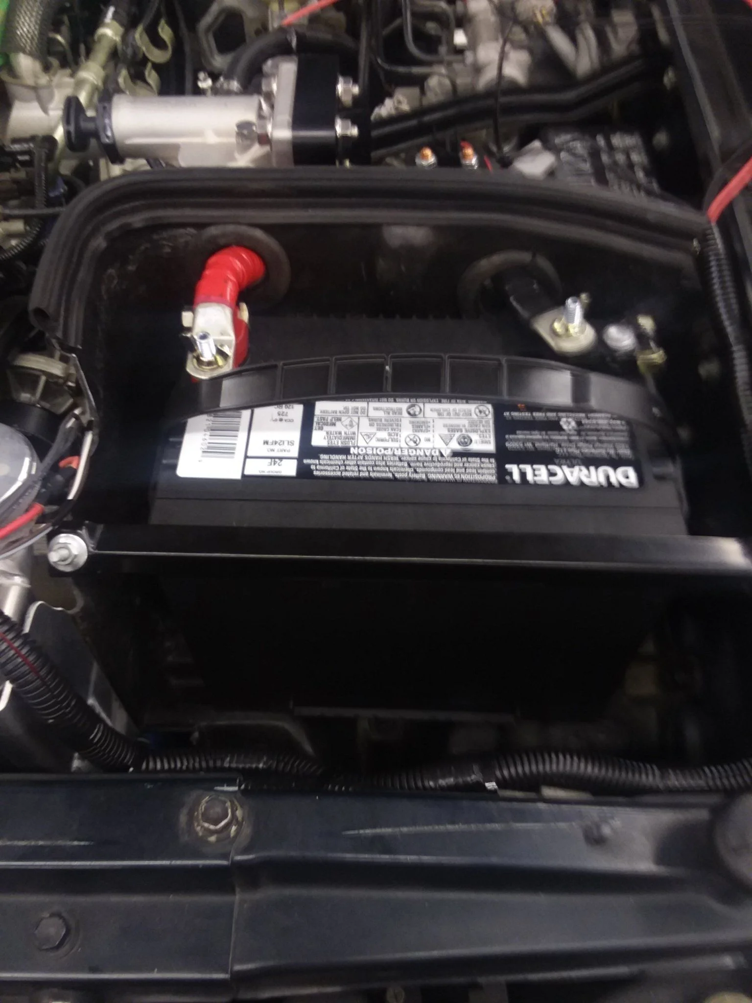

I went with a factory sized battery, its a duracell. They work great in my 24 valve so I hope they will work equally well here.

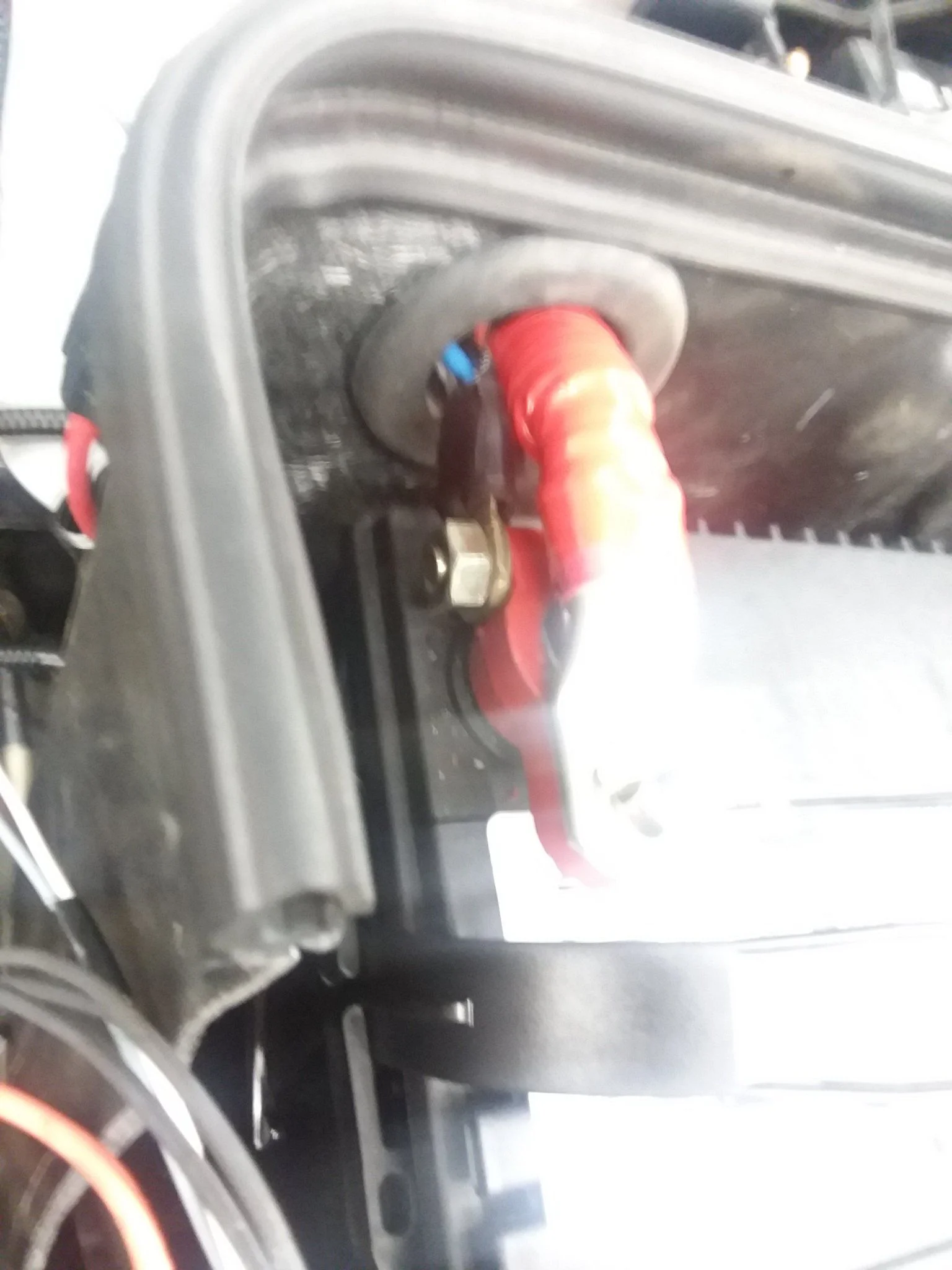

Here you can see my favorite method of securing battery cables to the battery. I like the removable marine terminal lugs, that way when they get all screwed up you can simply replace them without doing anything to the cables.
The double ought cables are a little too big for the 80 series, they take up almost all of the openings in the battery boxes. The fusible links barley fit through the remaining space.

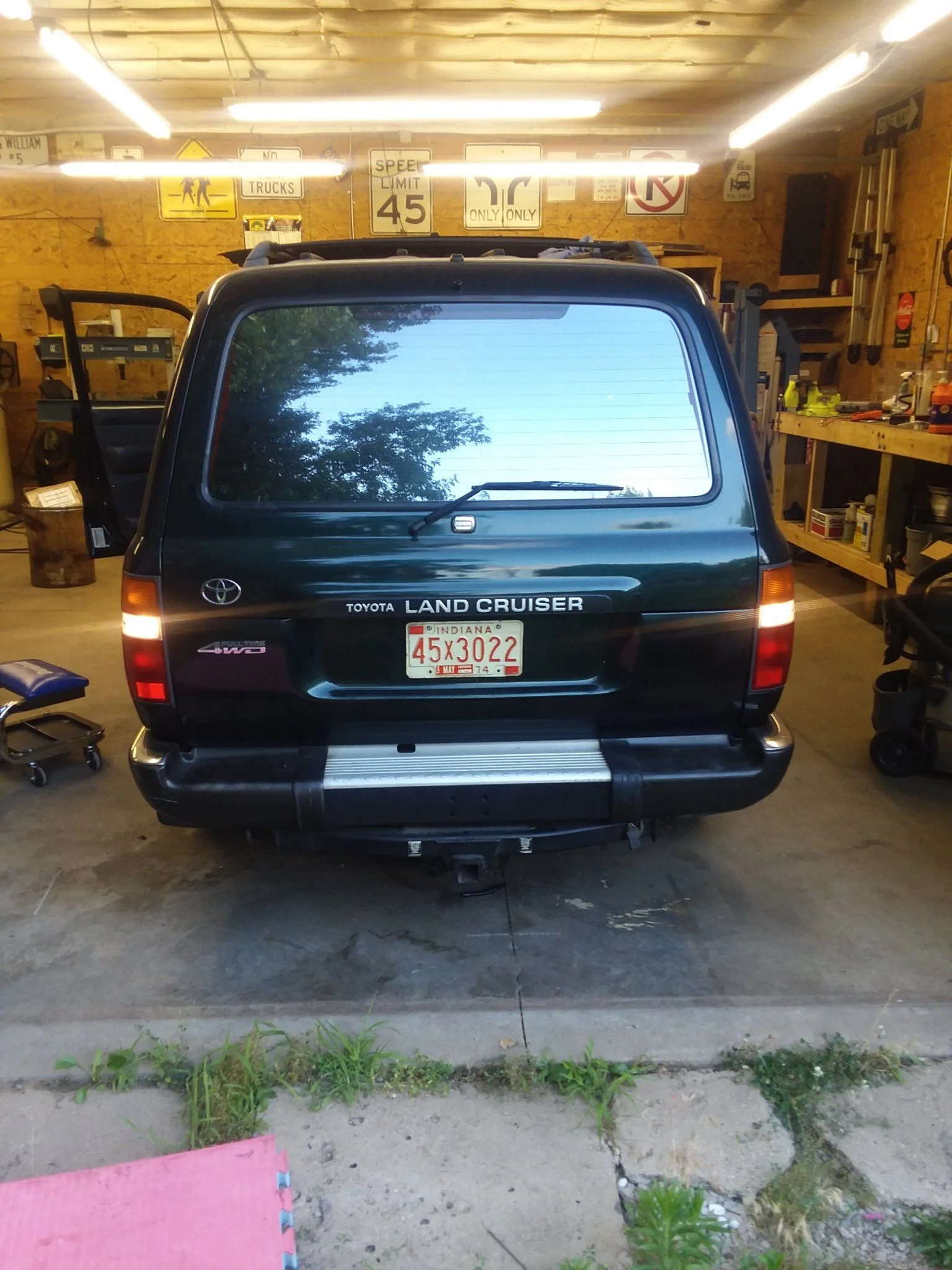

I recieved a package from Toronto today, this really ties everything together and makes the interior look done. Many thanks to TurboDennis! I have been waiting for one of these to appear for a long time!!
And just to prove that i'm not insane about my wiring, here is proof that the reverse lights work!
