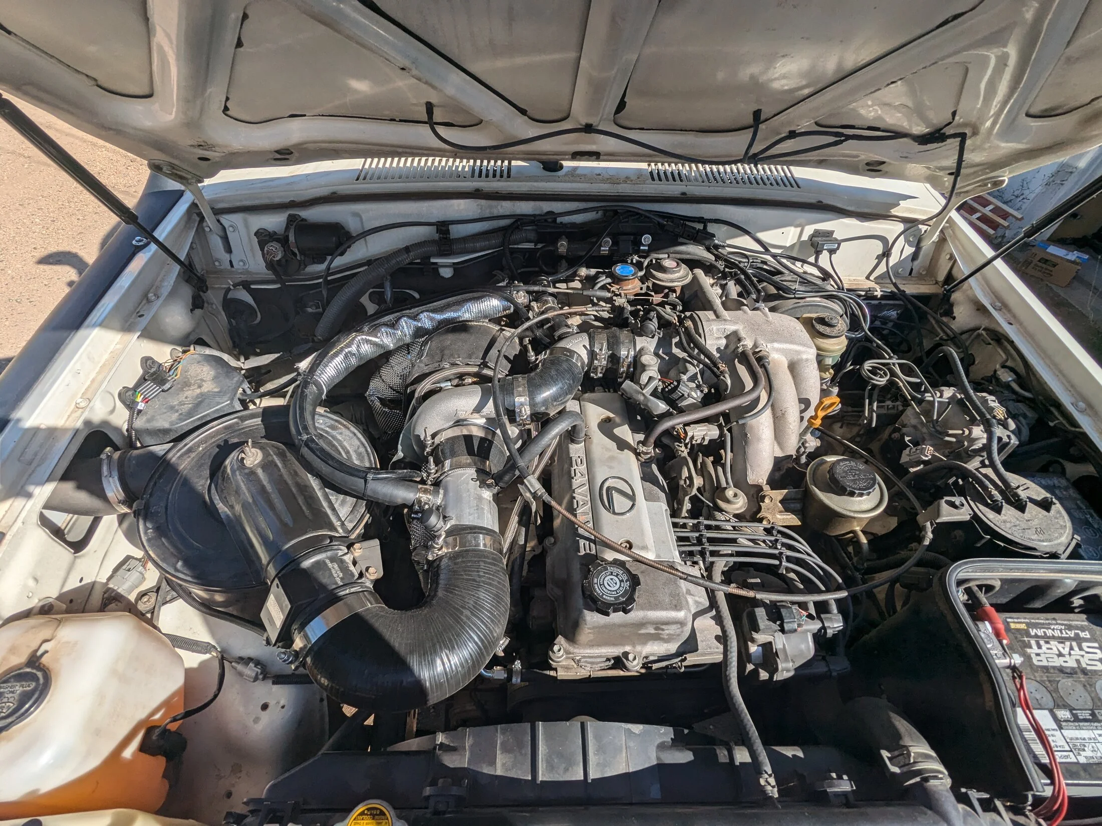

oh and obligatory turbo pic:
Thanks for coming by @DHwreckage and stoked you were able to finally get this going!
For all those wondering what cats has to do with this, DHwreckage stopped by for a sanity check after getting this all on the truck.... He was developing no boost even though it is all plumbed correctly. Came by, went for a ride, listened to it and was like hmmm weird, definitely no extra power... So we unhooked the downpipe from the exhaust, unplugged the front O2, wedged the vband in between so we had a massive air gap and then took it for a rip.
No restriction, more power haha Found the lost power and built 7 lbs no problem.
Moral of the story clogged cats or clogged muffler some how. By unhooking the O2 we send the computer into open loop and makes it safe to drive without the rest of the exhaust hooked up. So if anyone else gets to this stage and has problems with building pressure go ahead and give this a go!

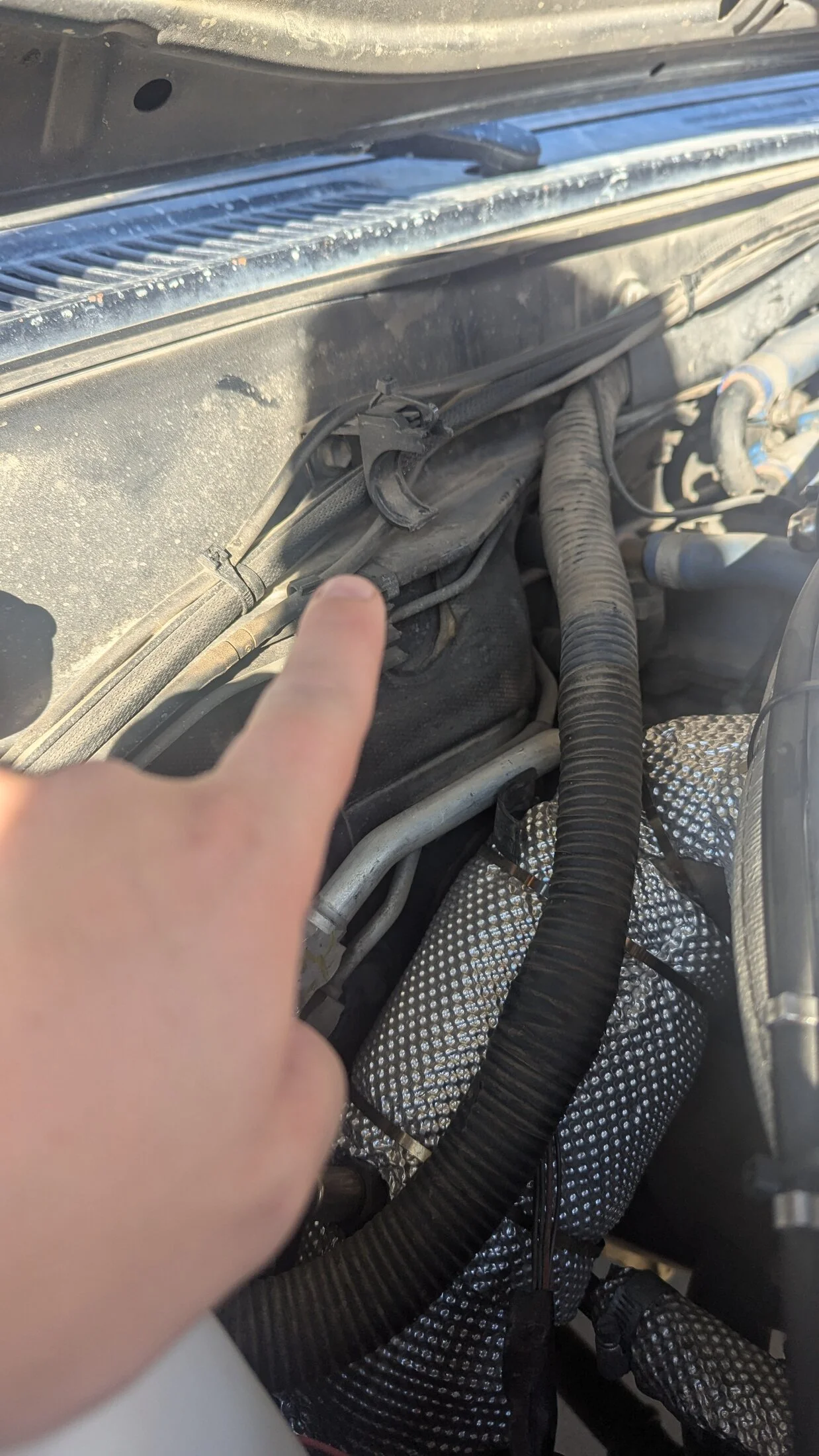

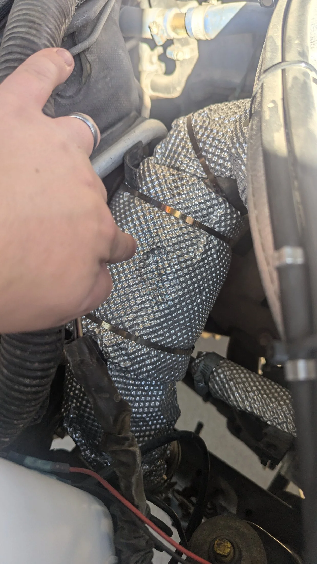

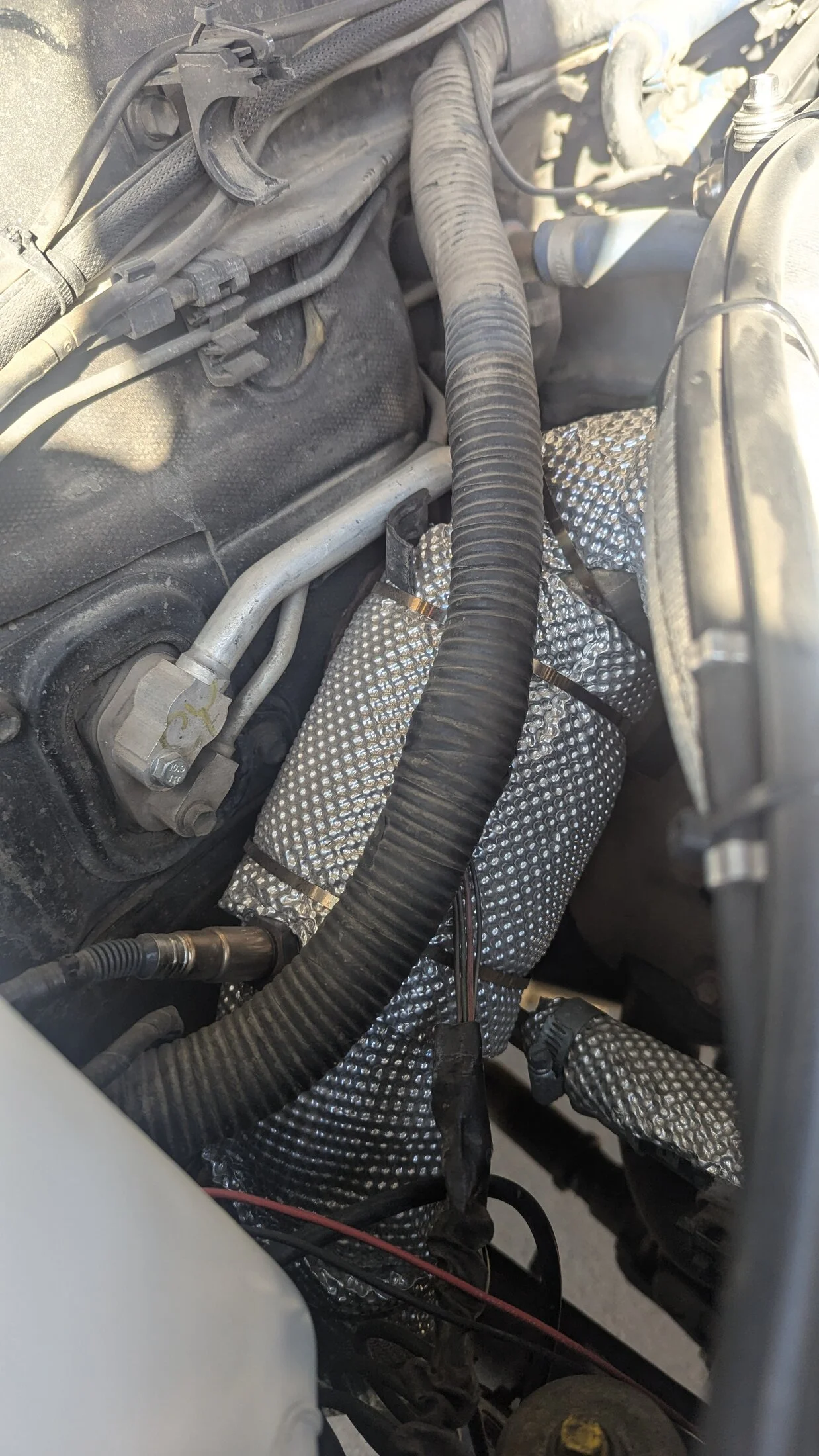

So I know somewhere in this thread we went over the wrap that is included in the kit and to say the least it is legit... Proved that again today on the test mule. I discovered while grabbing a photo for a guy doing a turbo install this weekend that the clip that holds the main engine harness trunk to the firewall had failed on my cruiser and the main harness had been laying on the downpipe for only god knows how long..... The harness is a little crispy and had clearly gotten hot but it isn't melted at and it is clear that it had been laying there for awhile as it had started leaving a divot in the heatshield armor. This is a PSA to check that clip before something bad potentially happens!

Guess I'll quit wondering about the AC lines being so close to the down pipe....
Zero problems to date with those lines and AC blows as cold as it did before!

I wrapped my harness with heat wrap insulation to prevent this.
Also have the down pipe blanket.
But laying on the down pipe directly will probably be too much heat long term anyways.
I also, over time, had the a/c line fail, even with insulation wrap.
I ended up with a custom line re-made with higher temp properties, wrapped in a foil type wrap, & further wrapped in a Velcro heat sleeve.
I haven’t had an issue with the new a/c hose & double heat wrapping so far.
Others have made the same observation but still found damage when the harness was opened up. May not be a problem today but you could have an issue later with bare wires because that heat will make the insulation brittle and fail.
Oh I know, we replace a few harnesses every month at C&C. My harness has 378K miles on it... its on borrowed time regardless lol
