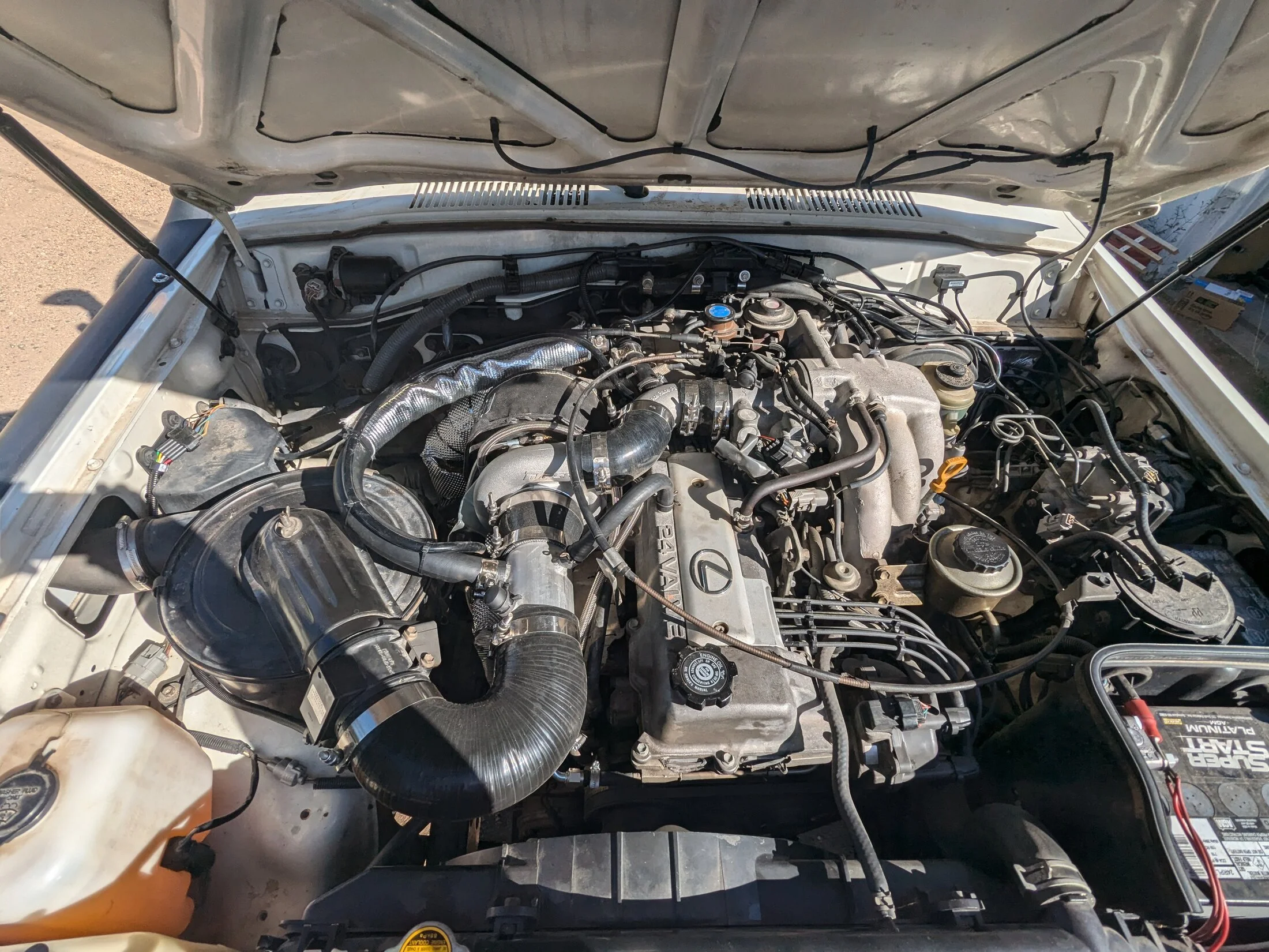

Hey Wes, kinda depends what all is going on haha seems like every truck is different that we've done installs on but one solution that we have used with great success is attach a rubber square block hanger with rod to the first body mount with an M10 nut and bolt in one of the existing holes below the body mount and then attach it to the exhaust pre cat. I'll add a photo on Monday but here's what I'm talking about. Available at most auto storesHey johny, how do you support the downpipe or exhaust before the front cat? The factory y pipe has that support that bolts to the side of the tranny. But that gets cut off when you install your down pipe and reattach to the factory exhaust. Just curious? Thanks Wes

Just to add to this, my exhaust is pretty solid with no support by the downpipe. I got a 90ish welded in front of the first cat and it is connected with the supplied vband to the downpipe. my muffler guy did add a support down by the muffler on the driver side in case the bellow/flex joint would have caused it to move around a bit more but currently its not going anywhere!Hey johny, how do you support the downpipe or exhaust before the front cat? The factory y pipe has that support that bolts to the side of the tranny. But that gets cut off when you install your down pipe and reattach to the factory exhaust. Just curious? Thanks Wes
