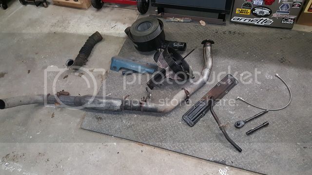

Removed aircleaner assembly then the blowby cover.
Shrapnal pile...

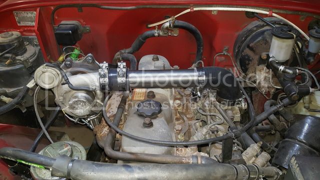

J pipe installed
Here its about 80% all completed
IT honestly took me 3hrs to get to this point and im by no means a skilled wrench turner. I took my time and double checked everything as i went.

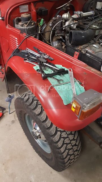

I got tired of using my fenders as tool storage so i treated the garage haha

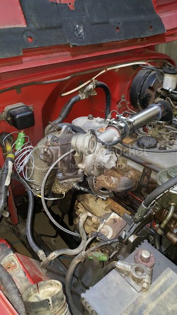

Then i retarded my IP timing as suggested by the kits builder. This was tricky and a crude way to do it but its all we have to go on. You have to loosen several bolts then pry the IP a bit till you have about 1-2mm difference in the casting marks.
Next i made sure i was getting oil to the turbo from the low oil sensor hole. Turned it over a few times and bingo!
Here is the money shot!!!!!
Running a bit rough from not being started for almost 7 weeks but you get the idea. Still have no exhaust on it but its surprisingly quiet
