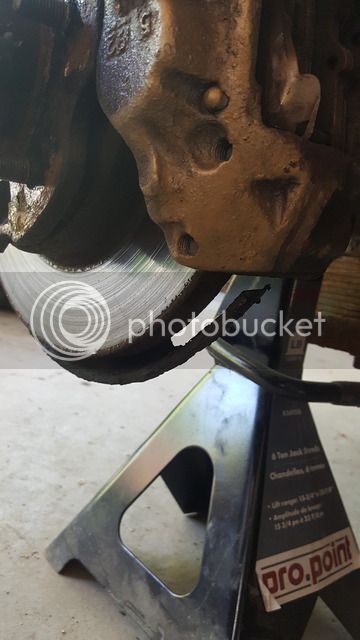

Realized my backing plates are shot!!!
I know they are "unobtainium" now so not sure what to do.

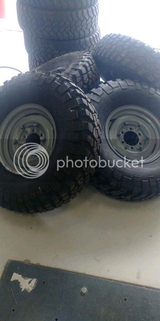

My tire guy just sent me a teaser pic! It literally took him an hour to remove old tires and mount and balance the new ones haha. If i knew it was gonna be that fast i would have stuck around. Ill go grab them tomorrow.
BAM!!! we rollin on double 3's
