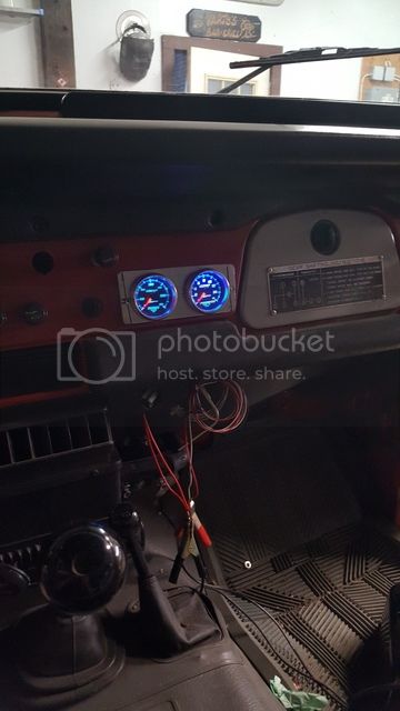

Not saying im a fab master more a leaner hah but im pretty happy how this is turning out lol! I even put a slight bevel on the inside of the opening so i could angle the gauges just a little so they face the driver more.
THe gauges arent hardwired yet i just wanted to see the light!
Im thinking of just running power from the invertor thats under the dash already. Its on a switch but i switch it on daily to run phone charger etc. Just trying to KISS. haha
relay the inverter so it turns on when you start. Most if not all bosch relays are rated 12 and 24v, The ones I like are the fan relays off the ford crown vic's nice little box with its own bracket one 80amp and one 40amp, so long as your inverter dosen't draw more than 40amps at 24v the 80amp would work great.. will try and take a pix of one and post... really nice find on the bj40... yes cruiser karma works,
The inverter in it is a pyle 30A 720W
This should be enough to run 12v to liggter outlet and the power to my egt and boost gauges correct?
Rookie question here but if i run my power to egt gauge the + am i ok to run the ground to the 24v - terminal? Or does it have to go back to the inverter.
P.s i hate electrical
30amps will power a lot more than that, 5 amps for the lighter and maybe 3 for both gauges.. I haven't done it with an inverter setup like that but ground should be the same 12 or 24, test it with a meter, to make sure you have a good ground.
Ive always been told to run s dedicated ground right to batt for egt probe

For the record electrical work terrifies me!!! That one thing im more then happy to just throw money at till its fixed or done. Had a buddy stop in tonight and he does vehicle electrics for a living so he hooked up my 24v-12v step down so i could power my gauges.
