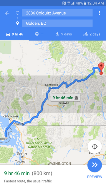

So this wraps up day 1. Not too bad 800km traveled. Fuel consumption was 77L for 648km driven. Whatever that is in MPG

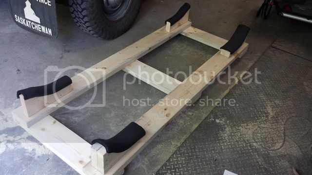

So after unknow amout of years (i say 15) im gonna take the hardtop off. First ill build a holder for it as my garage right now wont let me fit a ceiling lift for it.

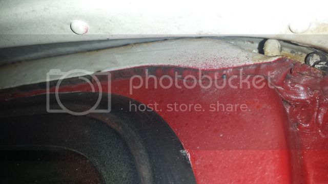

Now the scary part of this is the windsheild frame top. One of the PO decided t oseal the crap out of it with caulking or mastic. Its still playable but rubbery. I have no clue how hard its gonna be to get the front of the top off this. Is it a good idea to heat it with a heat gun in hopes it softens enough? Got a few buddies coming tomorrow night to help lift it off. Would like to be ready for them haha. All the bolt came loose nicely so im happy about that. Just the ambi doors tomorrow which i dont see being an issue.
Hopefully they glued it after they put it on. I've had to use a sawzaw in the past to get some off. Ruined the rain gutter doing it as well.
Oh wow lets not even go there.... Do you think a heat gun will soften it up?
The way the bead looks it might just have had a bend up on the lip then the gap was filled. Fingers crossed.
Nice roof cart! Hopefully a heat gun will work. Lisle makes a razor scraper you could maybe push up in there to lessen the hold.
Another time consuming option would be a dremel EZ Lock cutting disc. Looks like you could carefully slide it in there to slice some of the caulk.
One of my favorites is to use MAP gas to turn a metal object(screwdriver) glowing red. Use the tip to melt the caulk.
:cheers:
Thankfully it only seems to be a thin bead. I heated and ran a sharp knife down it and it seemed to work at freeing it. Got all the bolts out and only snapped 2 haha. Still seems stuck along the window frame. i got the 2 acorn nuts on the corners and the 2 screws on each of the backsides of the window frame. The rear is loose and should be too hard to lift. Am i missing anything along the frame? I got the 2 ontop beside the washer sprayer.
Well got it off! Took some serious heat to get the caulk soft but a little pring and some brute force we got it lifted on the front. Man the top is awkward to flip on it back haha.
