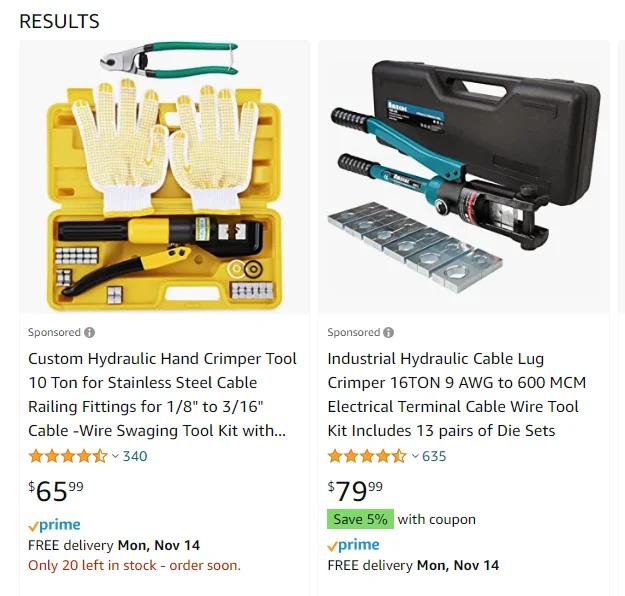

For hexes, I see two common types of hydraulic chinese hex crimpers that may suitable for electrical connectors, they look like this:
the yellow one goes to smaller sizes, the teal one to bigger ones. I use one like the former. It's OK so far. I don't think that is a high quality tool, but it works. It can do smaller connectors - I think the usual range is from 4 to 70mm2 from memory, that's 12AWG to 2/0 I think. Check the specs to see if that'll do it for you. They can be had for less than the above (that's just a random pic, not recommending these specific ones). There are of course also fully mechanical hex crimpers, but I do like the control I get out of the hydraulic ones, I can fine tune the crimp size. One drawback is that the tool pressure is so powerful that the copper connector barrel material may flow through the gap between the dies, giving you "wings" on two sides. But easy to remove. Or I rotate the connector a couple of times in the dies to even it out and/or reduce/crush those wings.
I also have a "Tricrimp" mechanical crimper with changeable dies for smaller stuff. One of the dies has some hex openings (for coax crimping) but only 3 sizes or so I think, so that's a bit limited for hexes, but it does cover several other types of crimps. I use mine a lot for Powerpoles. And I think those dies will do reasonably well with MC4s as well. It also has dent type dies like the Haisstronica above and some squishing ones for insulated end connectors. I'm happy so far with it.
