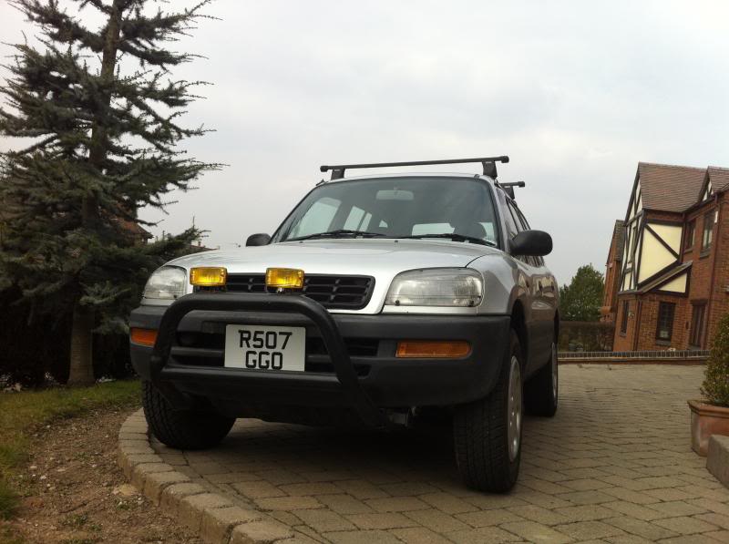

I've already picked up a bullbar with a pair of spotlights (still need wire these to the car though), as well as a pair of genuine Toyota headlight protectors and put in a pair of brighter main beam headlight bulbs I had laying around, which were all fitted tonight. Photo in the light tomorrow!
Went and picked up some Thule roofbars today. Was going to get genuine Toyota ones but the mounting points for them are far too close together. Painted the bullbar and spotlamps black, still needs another coat or two, spotlamps won't be staying for long, can't stand the blue lenses, but will wire them in soon anyway. Headlight protectors fitted too.
Most of the update, pics are a bit here and there, sorry!
Switched the spots that came with the bullbar for some yellow lamps.

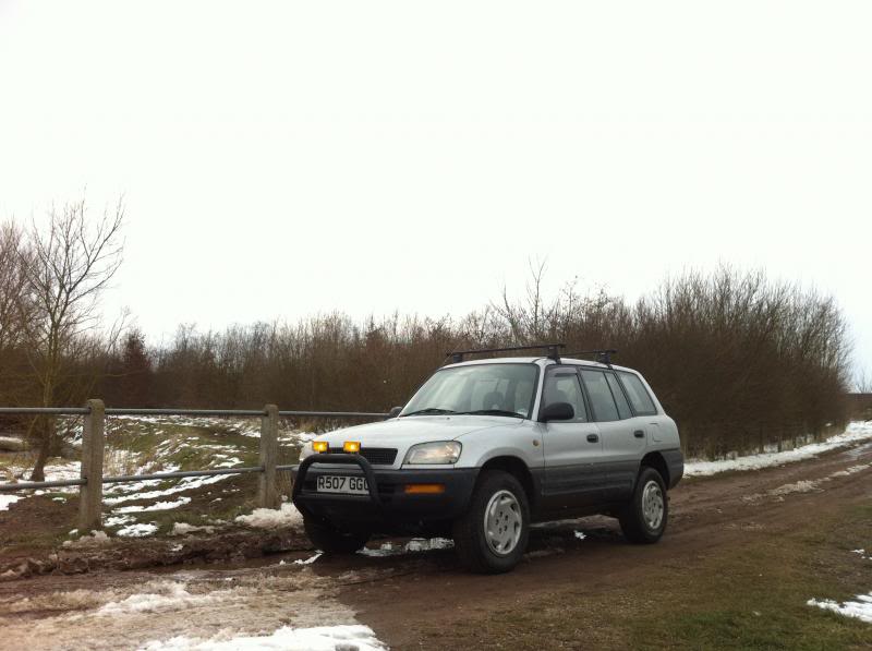

Did well in the snow for work

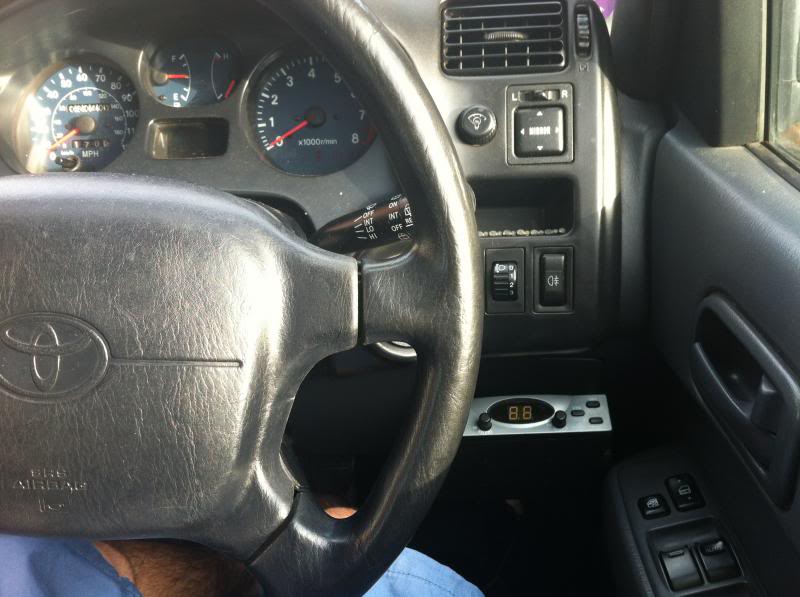

Relocated the headlight level switch from below the storage slot (see last photo) to by the ignition (like in the Yaris)
Removed coin holder and relocated immobiliser LED and replaced with blanks
The messy fascia, soon to be JDM double din

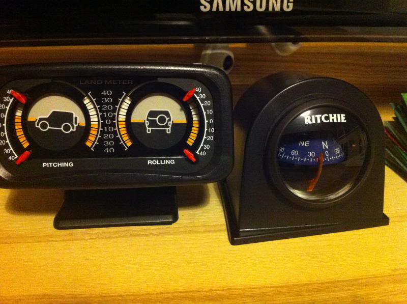

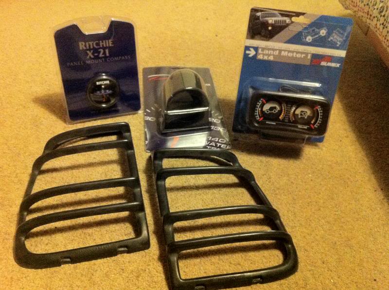

Got a few bits and bobs I bought last week in the post today; genuine Toyota rear light guards (but the flipping guy hasn't send the clips!), Ritchie X21 dash mount compass, 52mm gauge holder and incliometer.
Will get them fitted up in the next few days. Both are illuminated, so I reckon they'll be wired to the sidelights.

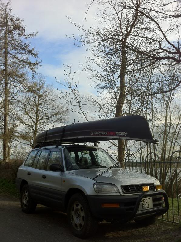

Also, off to pick up a canoe from Chester this evening!

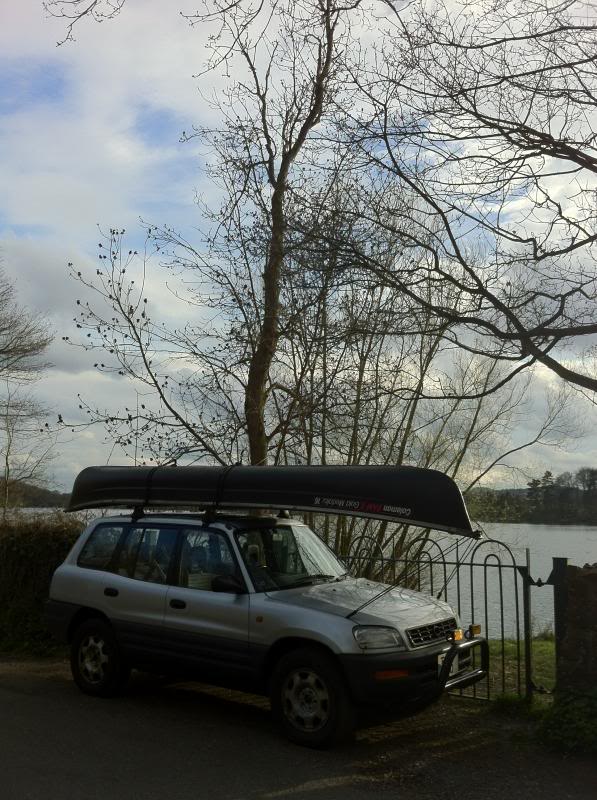

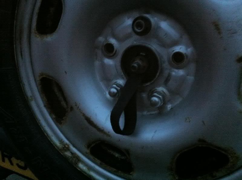

Spare wheel canoe mounting strap

A couple of photos from the maiden voyage of the canoe

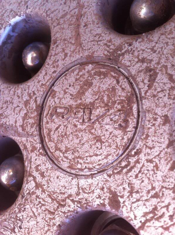

Painted my wheels last week, accidently bought gloss instead of satin :/ I'll give them a top coat of satin. Spare wheel needed an angle grinder to clean it up, it was that rusty!

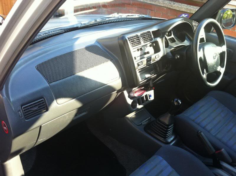

Few photos illustrating the interior
Seat bottoms are plastic, so when they're folded up you won't rip them
Bed anyone?

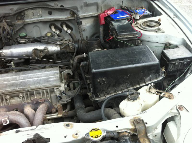

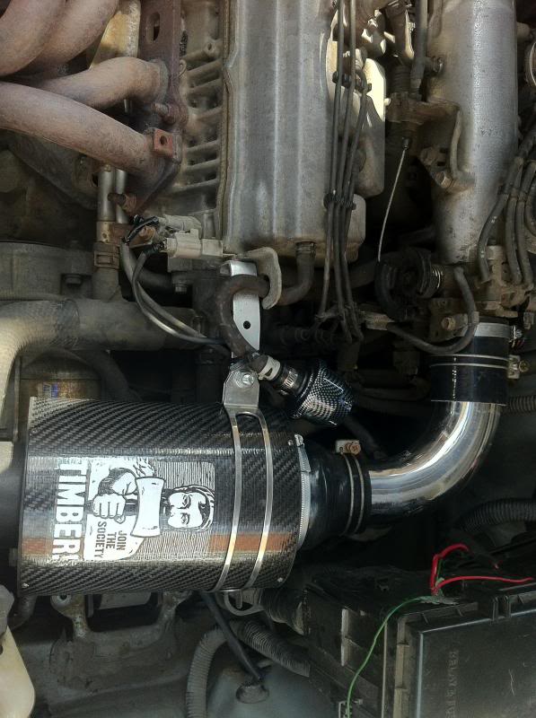

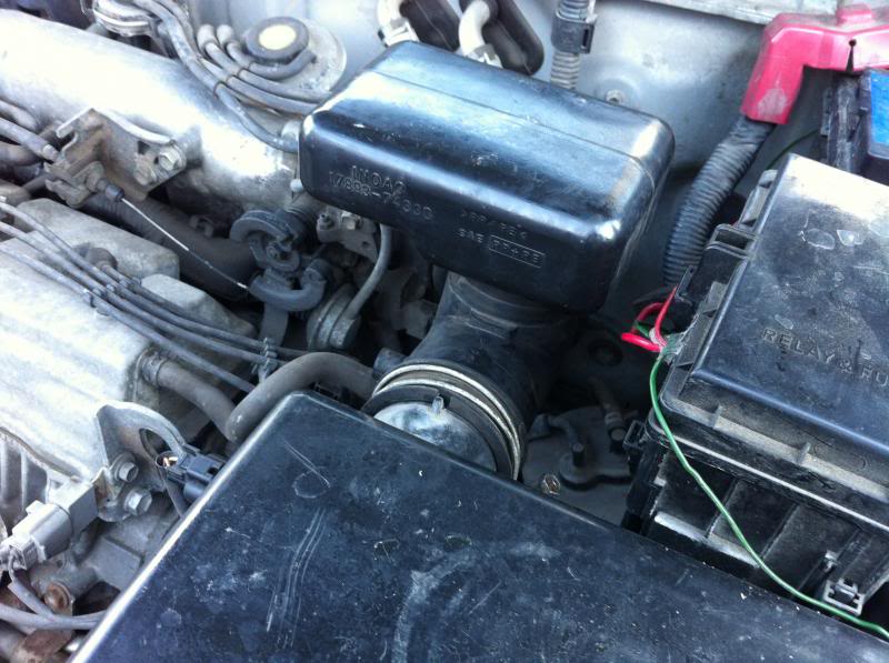

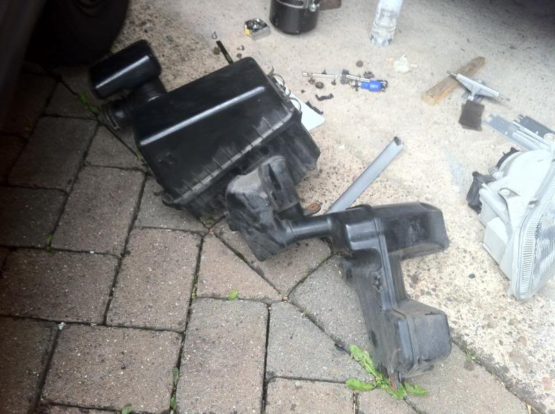

For starters I had removed the small resonator chamber off the airbox to throttle body pipe, then I found there was an even bigger resonator hiding under the bumper/behind the headlight, so I removed that too. Pics below shows the whole standard intake system.
Then came a BMC CDA (carbon dynamic airbox), along with a few bits of pipe and hoses, and a breather filter that kind of matches. In the long run this will be connected to a snorkel on the passenger side. A few people have said it sounds like a boxer engine now, not sure if that's a good or bad thing. Either way it sounds lovely! I will get a few videos soon.

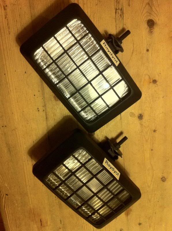

Bought some Raydyot 55W spotlamps for the rear of the safari rack.

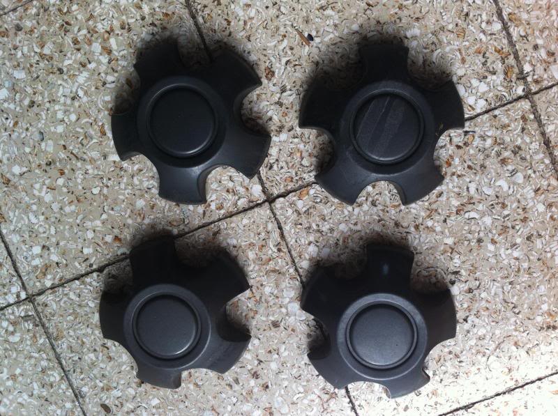

Got a set of centre caps for the wheels, got another on the way for the spare too.

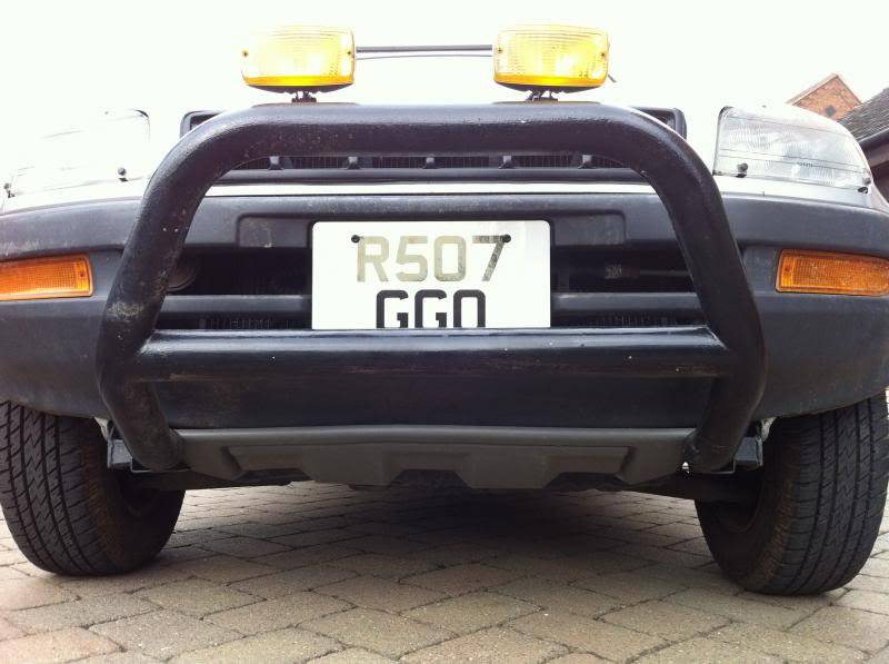

Not a huge update. Re-did the grill badge black and refitted, did the RAV4 and Toyota badge on the rear black, and removed the GX badge. Made a non-slip mat for the dash. Tried the spot lamps without the grilles, but they look stupid! Gave it the first decent clean since I bought it (not that you can tell now!) and bought a genuine Safari snorkel from a 90 Land Cruiser

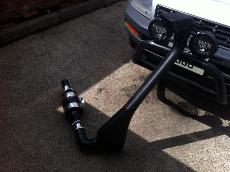

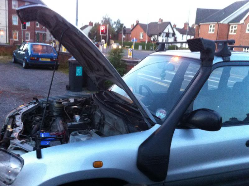

Here's how the snorkel will look.

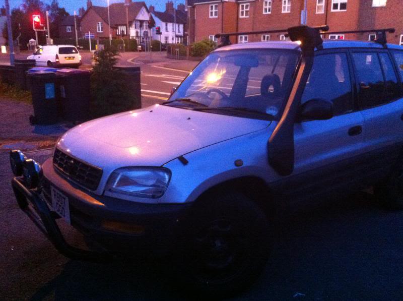

Snorkel is fitted now. Battery has been relocated to original airbox position. Got a few little things vibrating to sort out, but I'll get a video soon Got my Toyota double din fascia fitted too, no pic though.
First pic is the entire stock intake system, below that is what I've replaced it with.

I've repainted the bullbar and the back of the spot lamps (previously chrome) matte black, started to tend to the underside of the car with stone chip shield. About to redo the wheels matte black too.

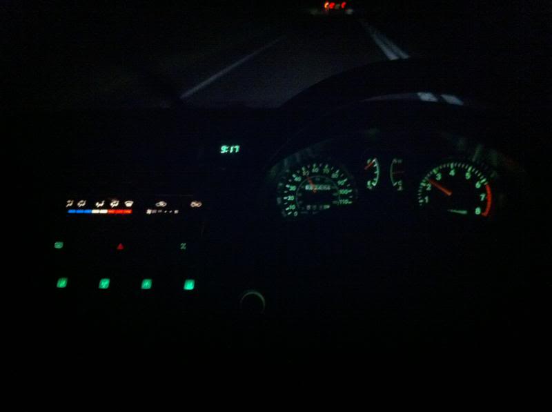

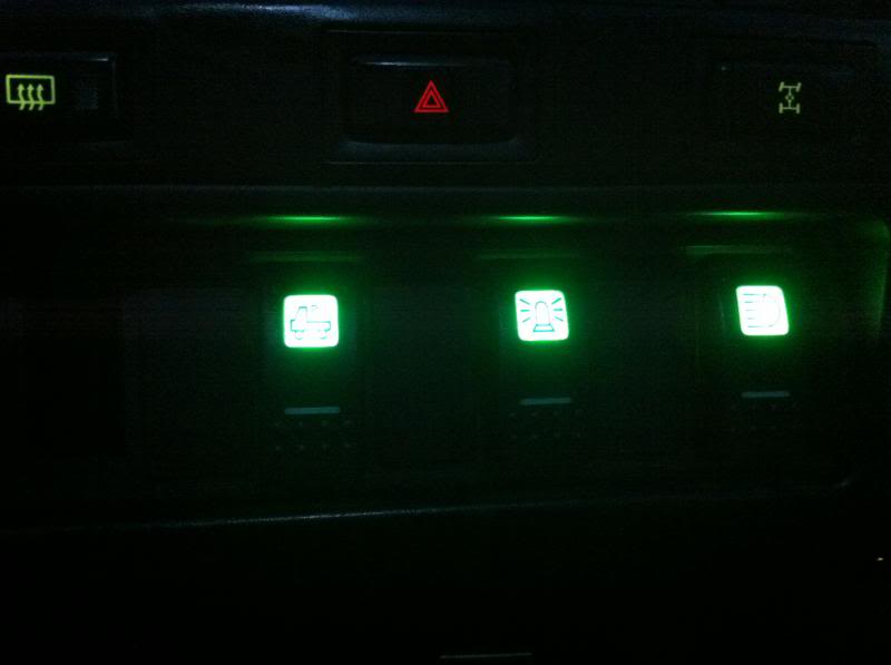

Found out about Carling switches, so bought a few of them, some surrounds for them and a few blanks.
Which came together to look like this.
The green LED were a bit bright at night, so I used some red tinting film between the LED and the switch to alter the shade of green a little and to reduce brightness.
Before.
After.
Headunit has been relocated to make room for the switch panel. Interior as it stands now.

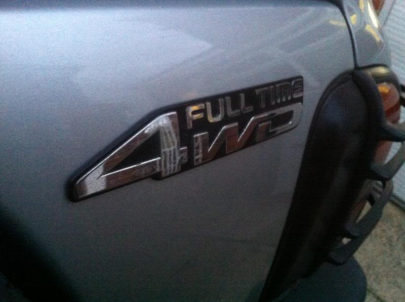

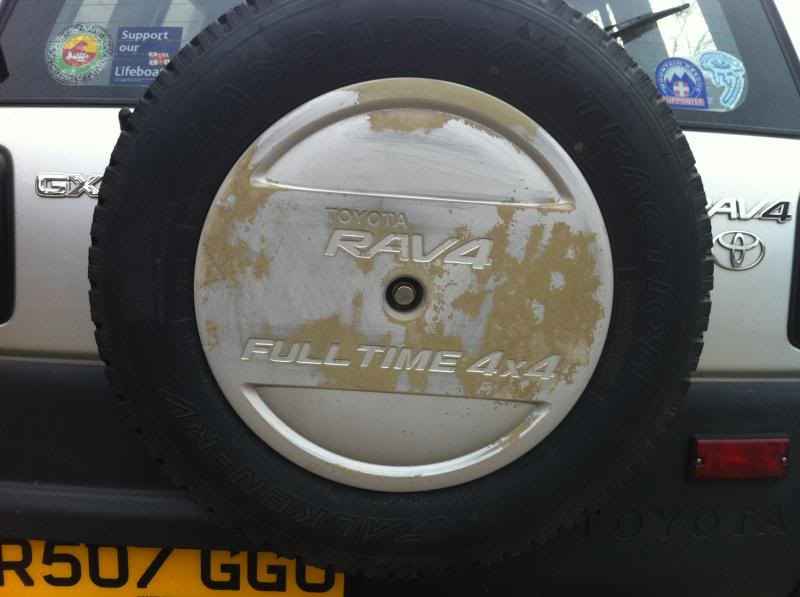

Bought a pair of orange 5000kg TRS tow straps, a CNC stainless steel snorkel grill and a fulltime 4wd badge from an old Land Cruiser. Removed Toyota logo badge and moved the RAV4 logo badge too.

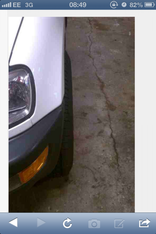

Bought the 2" lift spacer kit. Front spacers were actually 48mm and rear didn't fit inside the springs...

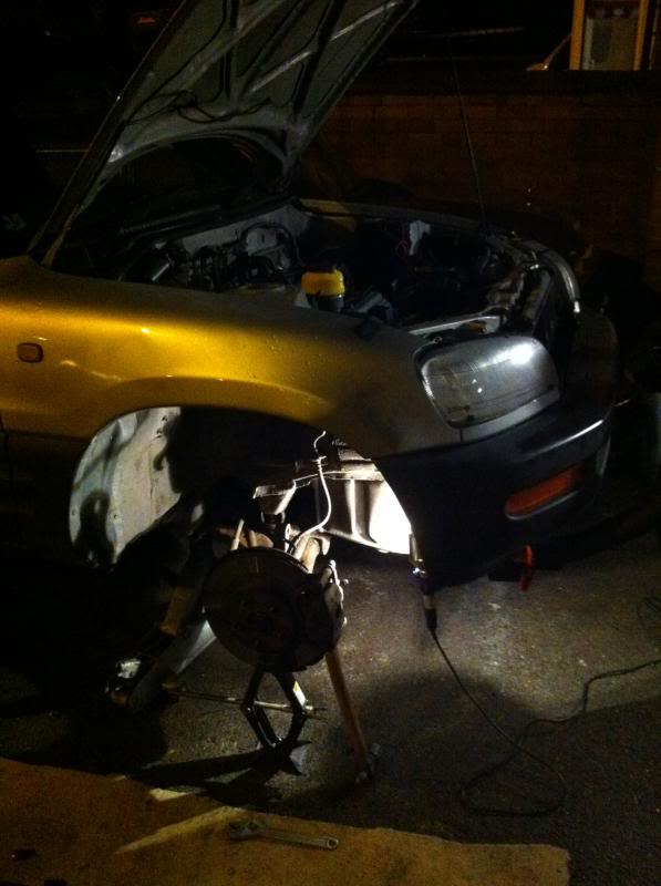

So I just fitted the new shocks and springs. Springs raised it up by 30mm, they were facelift model spec (slightly higher than pre-facelift and my old springs had sagged too).
Hub to strut knuckle looking like the creature from the black lagoon
New front springs weren't so easy to fit to the shocks, as they had a lot less coils than the stock ones :/
