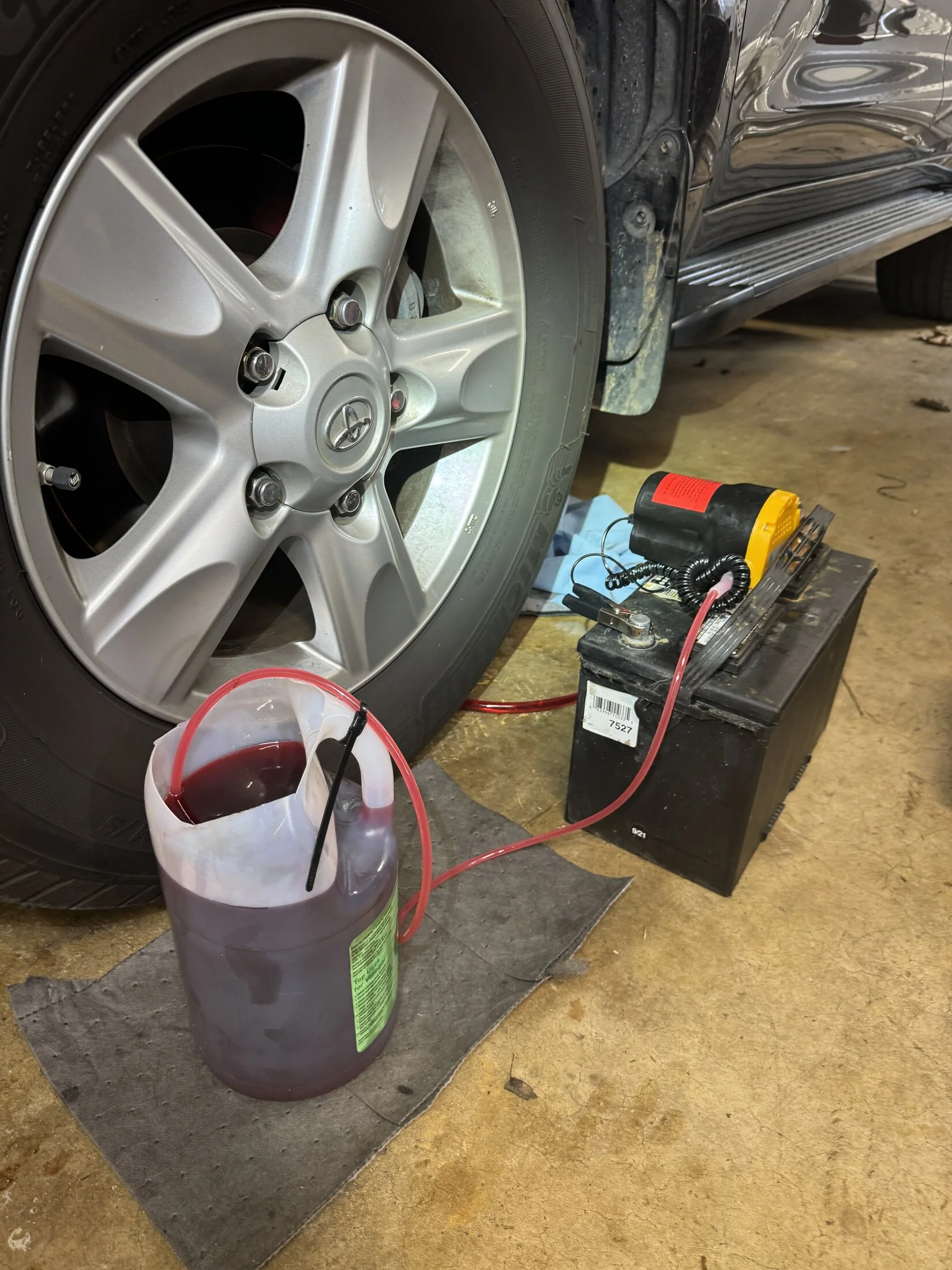

I know it isn’t needed, but the right pump can make this job quicker and easier from under the truck. I’ll attach a picture of the cheap pump I used… it was much quicker than letting the fluid drain into the transmission via gravity. Also easier than snaking a large-ish hose down along the brake lines and frame, while avoiding the hot exhaust manifold.If you follow the video and fill from top of engine bay you don’t need a pump.

The only quirk was having to run jumper cables down to the area because the 12v cord on it wasn’t long enough to reach the battery.

I'm glad you had a good one! The one I bought (on your earlier rec) got to me DOA. Too bad. At least amazon took it back without any issues.I know it isn’t needed, but the right pump can make this job quicker and easier from under the truck. I’ll attach a picture of the cheap pump I used… it was much quicker than letting the fluid drain into the transmission via gravity. Also easier than snaking a large-ish hose down along the brake lines and frame, while avoiding the hot exhaust manifold.
