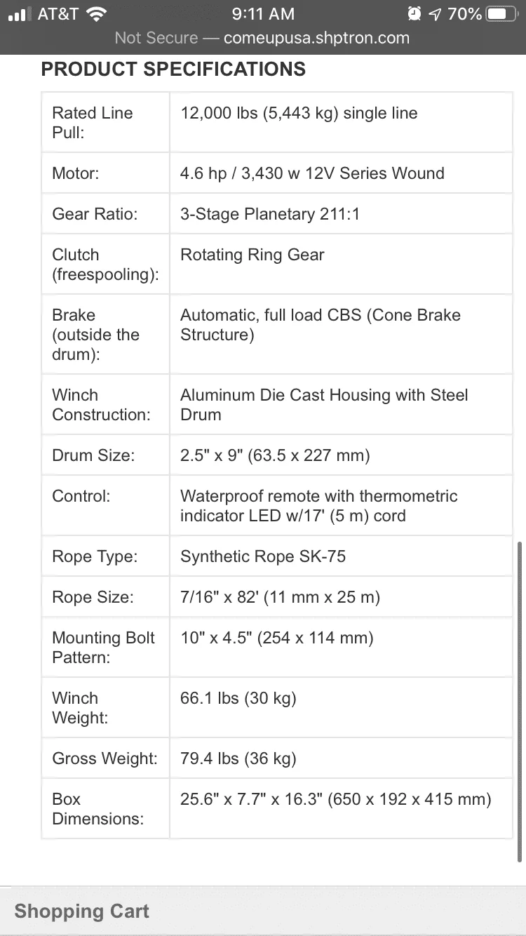

Anyone know the differences?
Here’s the Gen 2 12.5 rs
Here’s the DV 12s
The Gen2 winches are the next generation of ComeUp winches. Durable black exterior finish, wireless controller and slightly lower gear ratio with the Seal Gen2.
