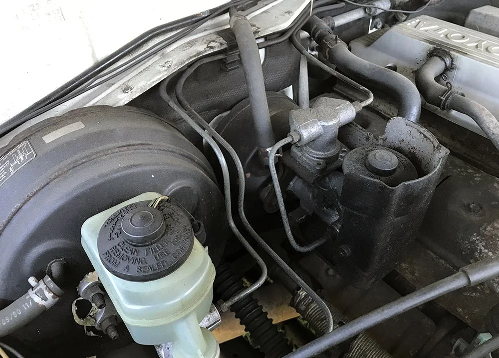

I'm swapping this 1HDT/H151 into my FZJ80 and am mapping out the RHD to LHD aspects of the clutch etc. I have never seen the Vacuum Clutch Booster like this on a manual before. Based on some minimal research they were JDM only? But not totally uncommon?
Are there advantages/disadvantages to them? Should I keep it with the swap or put in a non-boosted reservoir/cylinder setup?

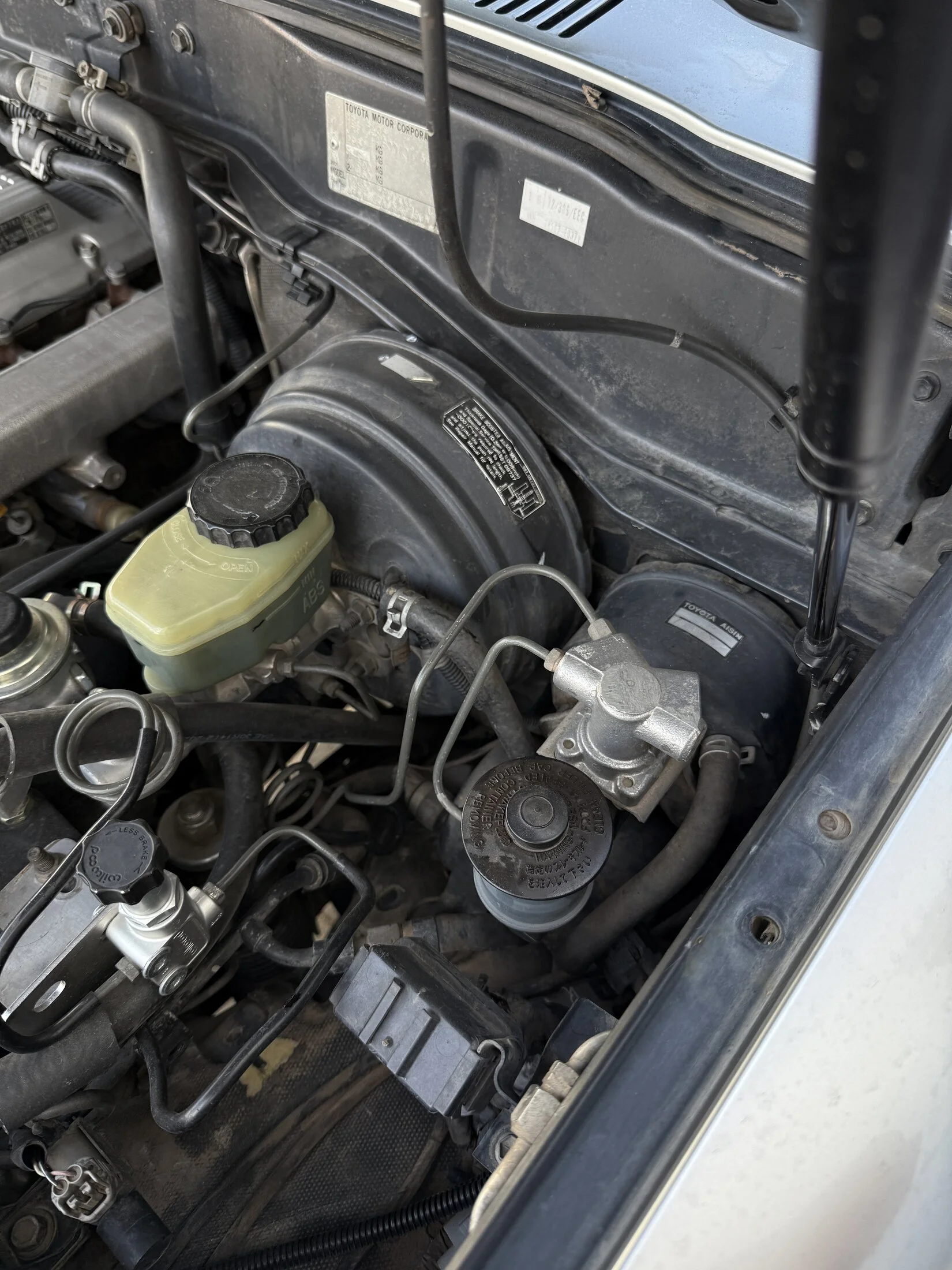

I have a LHD HDJ80 with the clutch booster but I feel it is on its last legs. Its squaks like a banchee when hot and the clutch feel Isnt awesome. I know the later FT / FTE 80s dont have a booster and just have a traditional clutch master cylinder.
Does anyone know if these are a direct swap? The Clutch booster is NLA, nor are the rebuild kits from what i can find, however the later model non boosted ones are. Id also love to delete that accumulator that has lines going to the clutch master and brake booster if possible.
