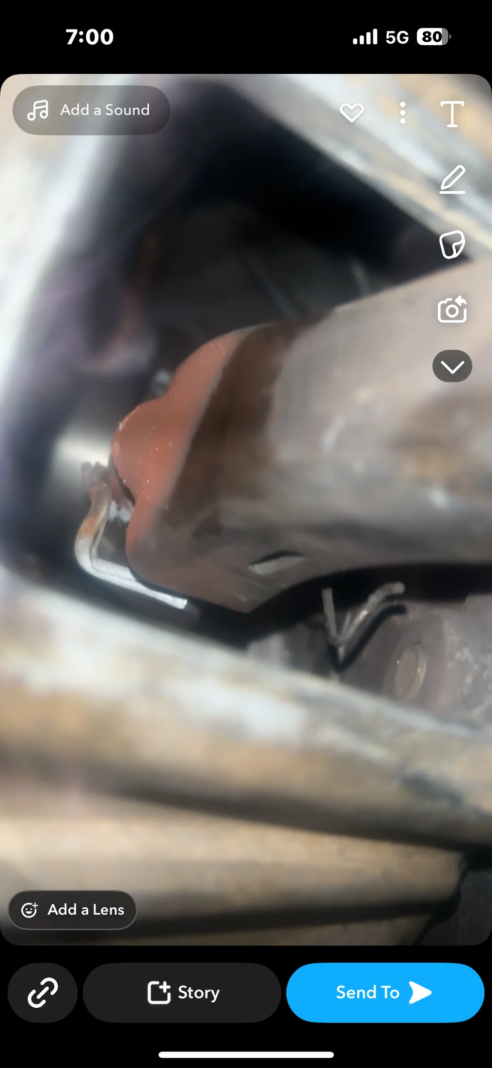

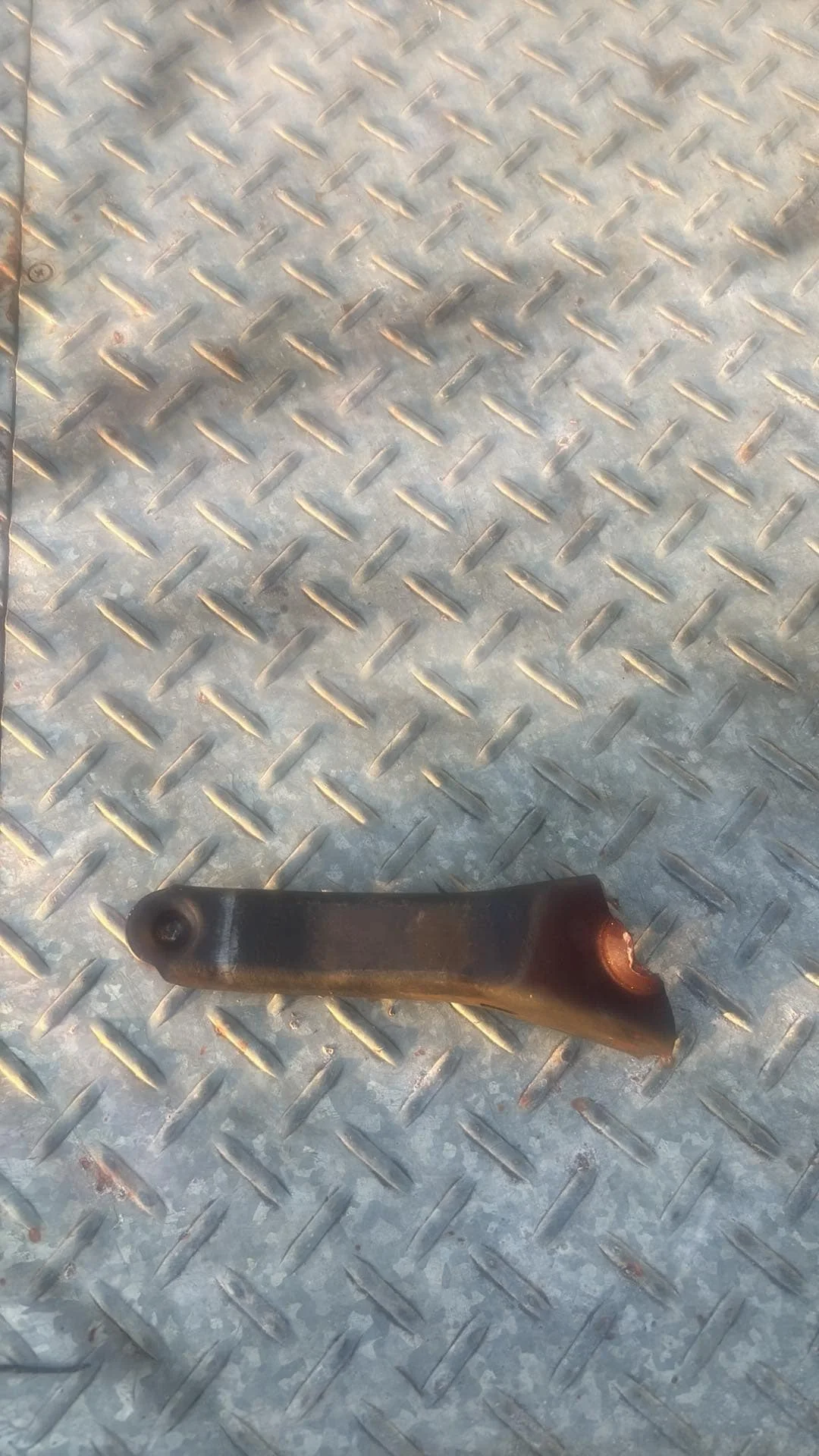

Nevermind gents found the issue, clutch fork was fairly rusty and my heavy duty clutch finished it off snapped it. Joy…
Good find. Looking at the fork, does it look like the pivot point wore over time, weakening it? It would be interesting to know how it failed. Were there any symptoms leading up to it?
Rust + a heavy duty clutch, the clutch fork wasnt replaced when clutch was done so it became the weak point as its probably really old, potentially even the original.
The pivot bolt seems fine to me in all honesty, the clutch fork boot has been torn for a few years, so i think a combination or age and a bit of water getting in caused the fork to rust on its weakest point.
There wasnt any symptoms leading up to it, clutch pedal felt fine and then just cruising through a roundabout on the way home, i went to downshift and couldnt get it back into gear all of a sudden.
