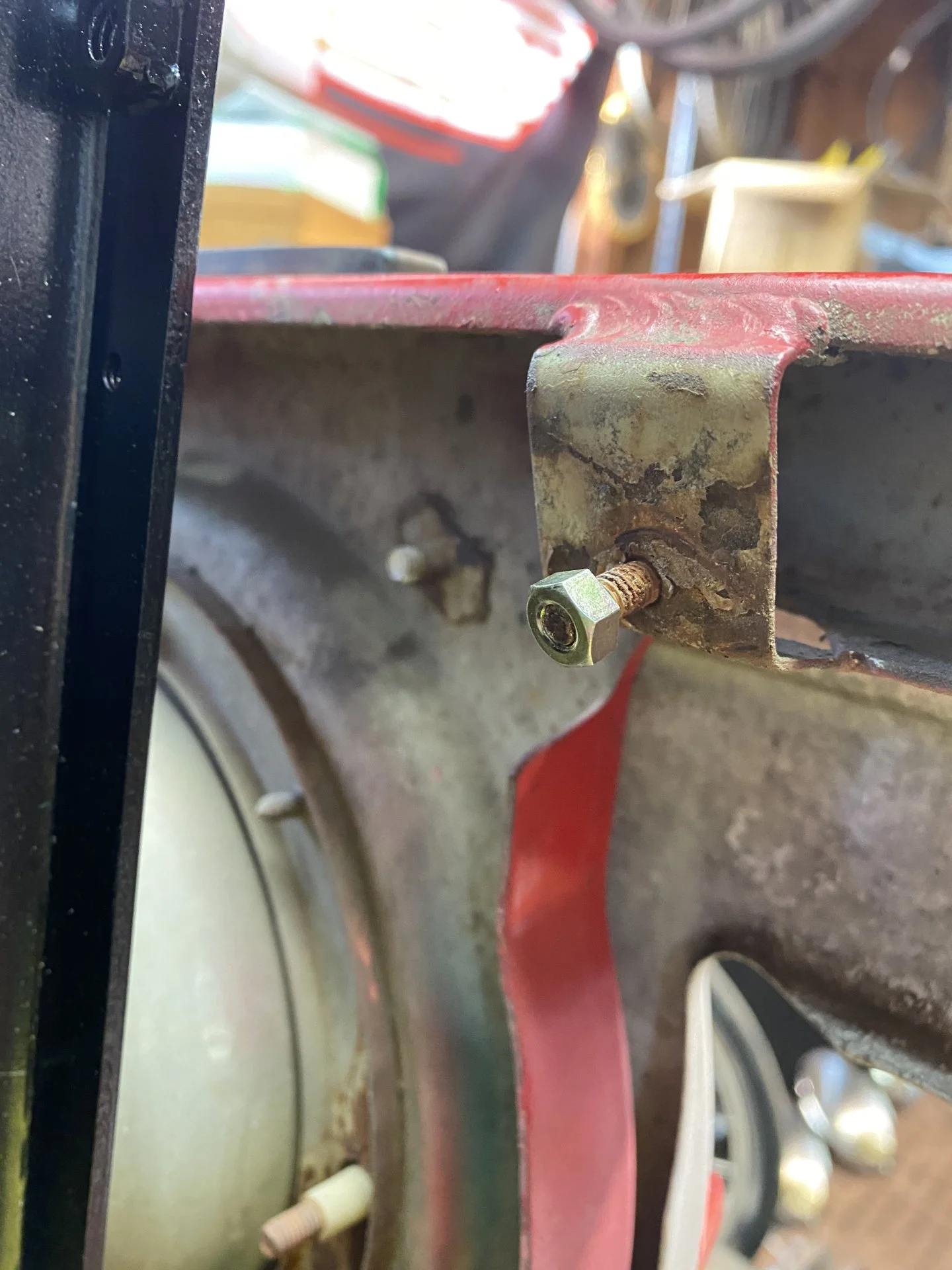

If I recall correctly, the front splash guard bolts are M6 x 1mm pitch. As for the radiator shim, the stock setup are the fiber mat pieces. The part number for the fiber mat pieces is 90950-04010.
The early Cruisers used the pictured screws instead of bolts, what the OP found is correct. M6 hardware is both wrong for '65 and won't work without drilling and fiddling with nuts
Interesting! I am guessing the screw on the left is the correct one?
From ‘65 parts book:
For radiator support:
52321-55010 shim (for radiator support) qty 2
For cover sub-assy, engine front under (51405-60010):
93540-15014 screw, tapping qty 4
94511-00500 washer, spring qty 4
94612-10500 washer, plate qty 4

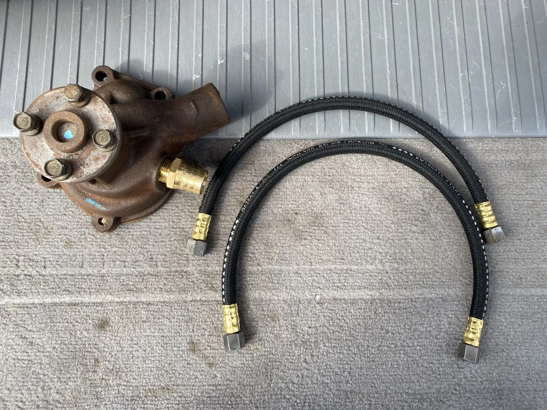

Just got the new oil filter lines back and a new fitting for the water pump bypass. Great local Marine/industrial hose and fitting place. Whipped them up in an hour!

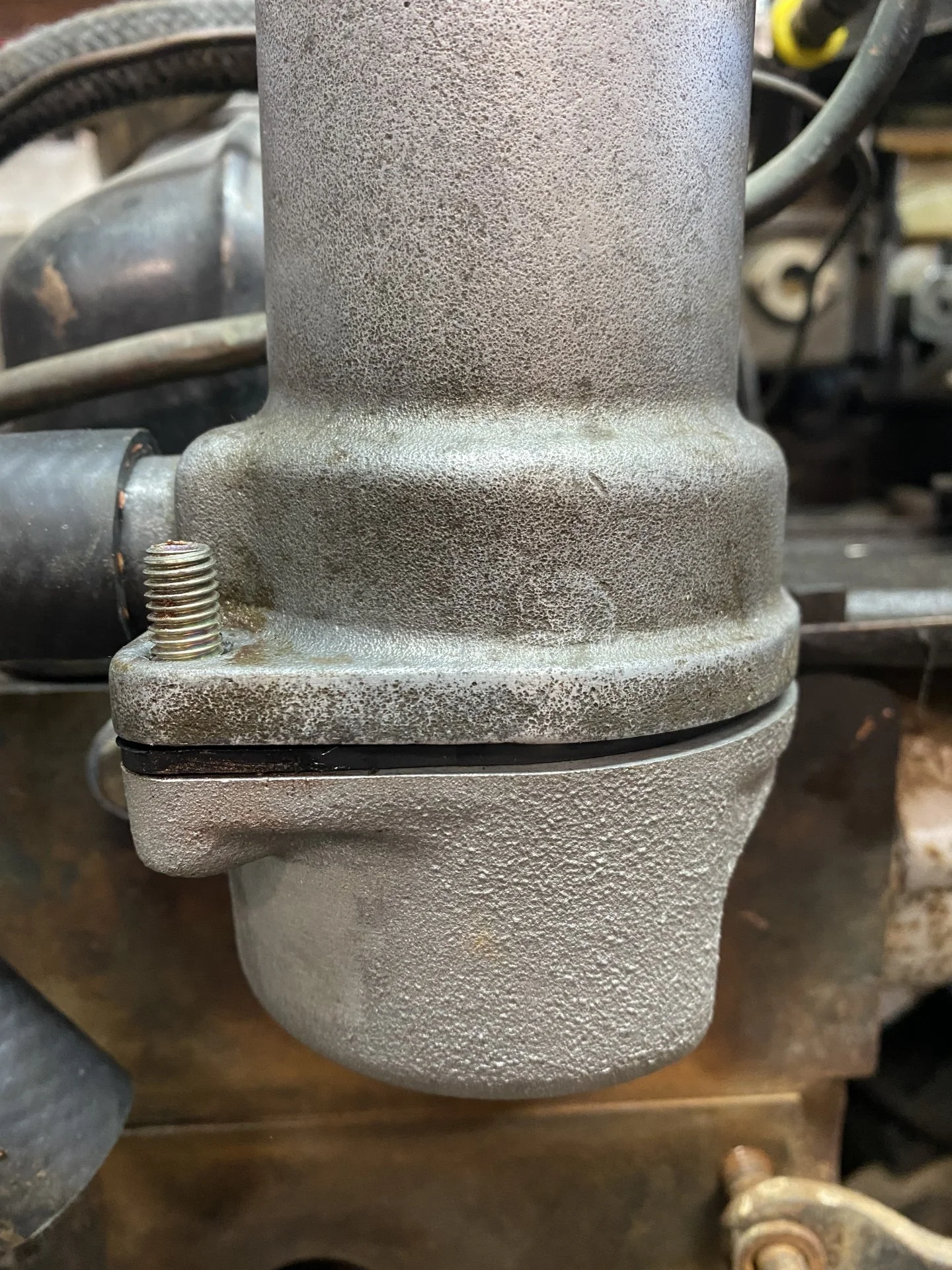

Chase's SD40 is in beautiful shape, just has the usual bow in the site glass gasket surface. Initially while on a surface plate, I measured a 1.68mm bow on the face of the sight glass. After some heat, bending the mounting ears back and a light amount of sanding with 2000grit, again on a surface plate, I got the variance down to +/ .15mm around the entire perimeter. Pretty happy with the outcome....now we wait on the rebuild kit to arrive.
Before (1.68mm bow)
During
Almost done
And done

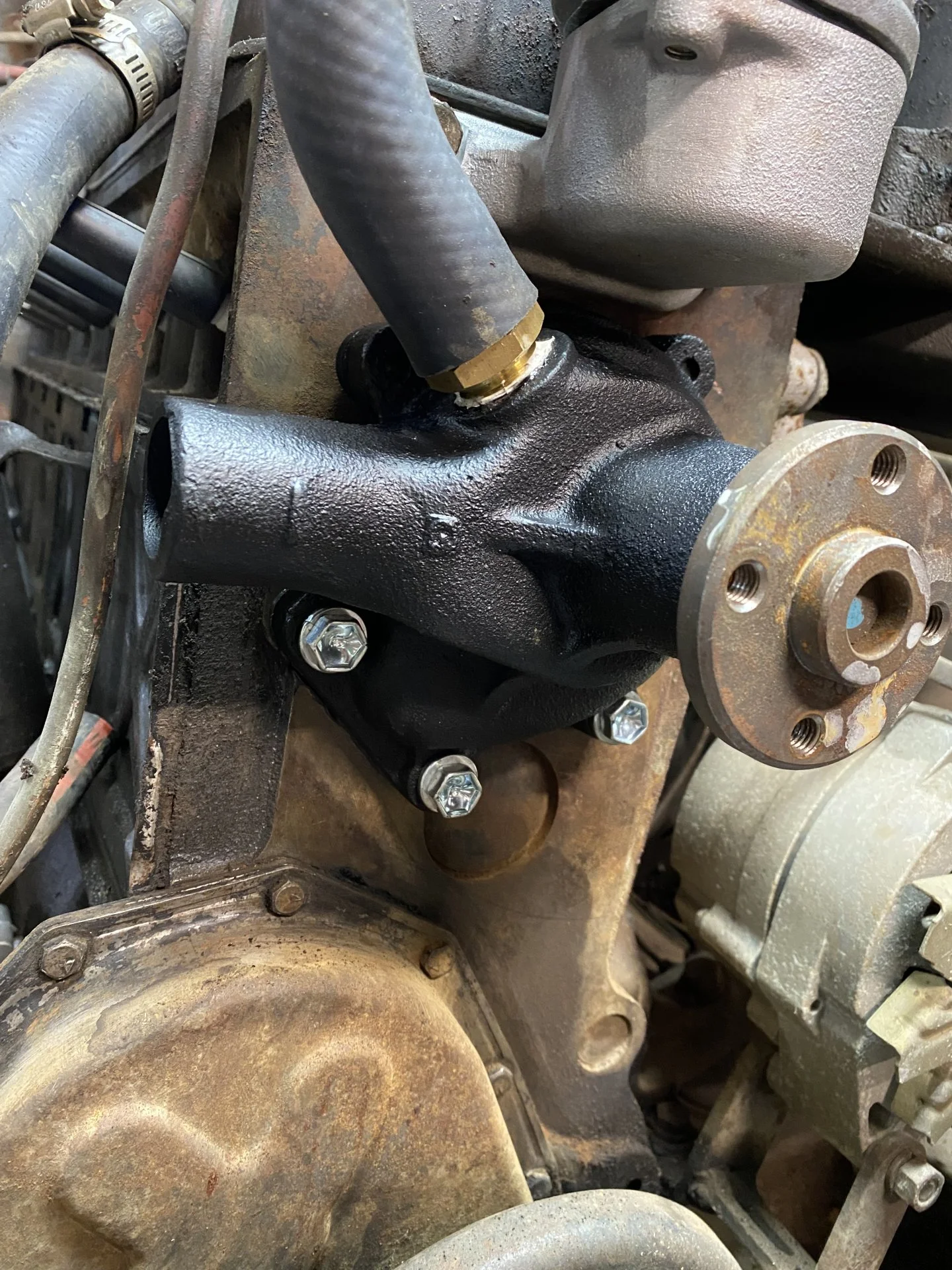

Finally got the water pump installed and some new turn signals mounted. It would be nice to paint them red to match but this paint is so old… that could be tricky. At least the pewter is a good color.

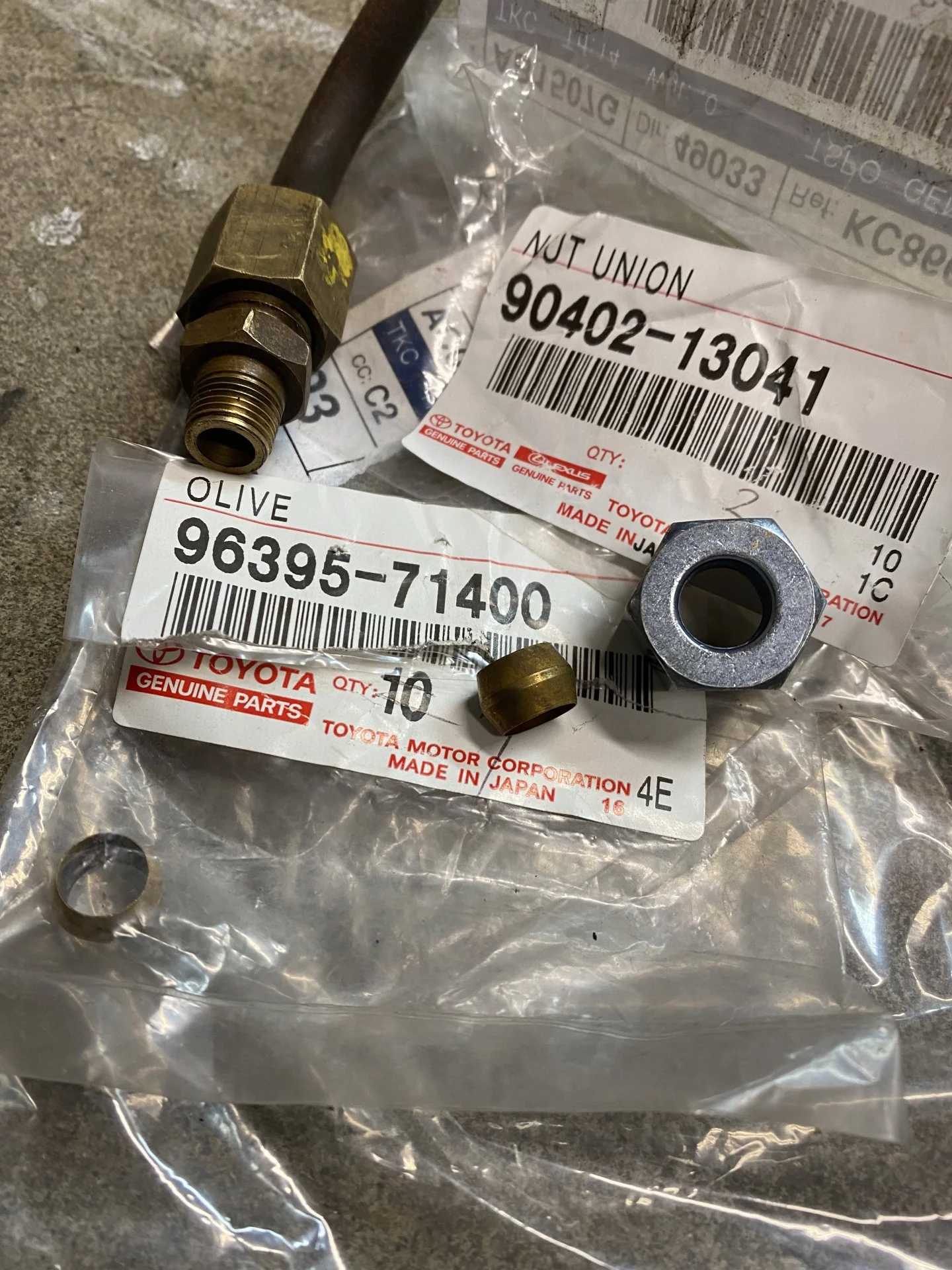

Swapping in a better condition fuel line. Good time to replace the sealing olives.

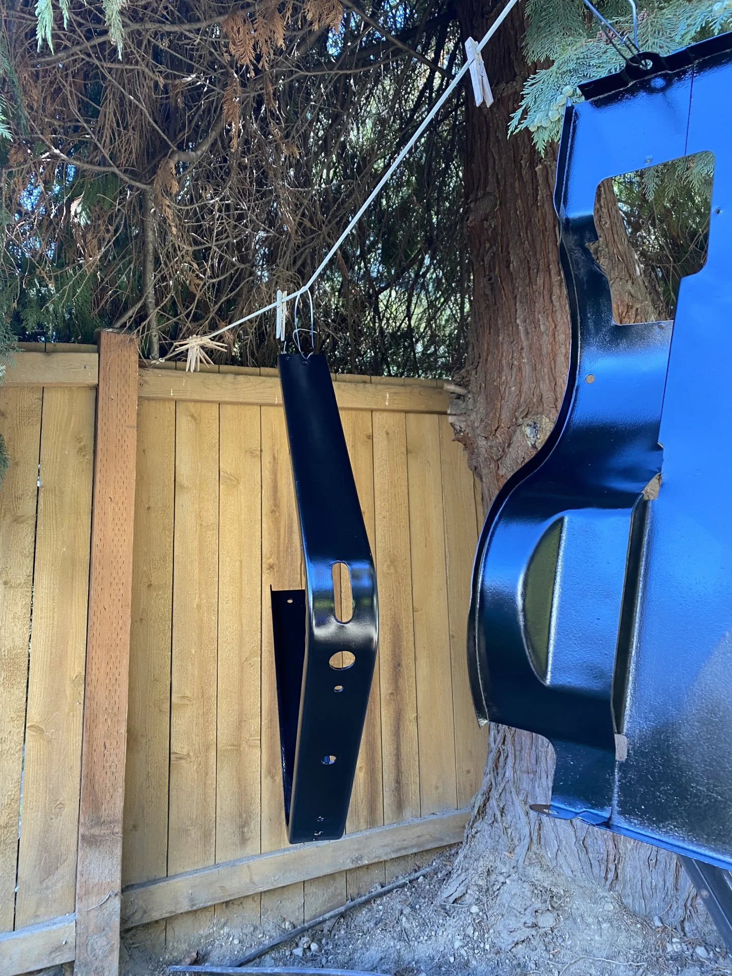

Painting associated radiator parts and waiting for hardware to come back from zinc plating. :)

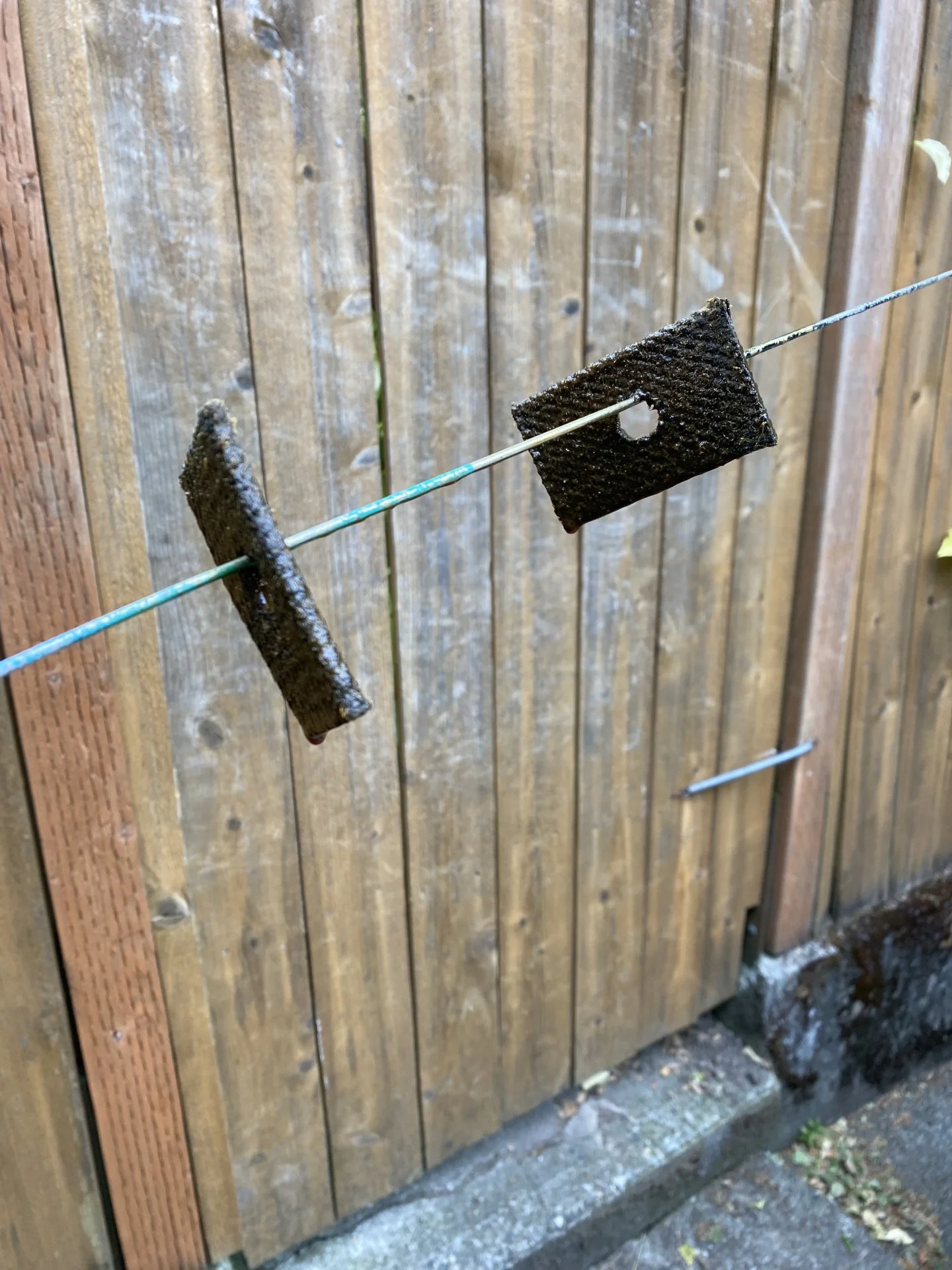

Also, decided to soak the canvas pads in cosmoline before they go into service. Hoping this prevents water absorption.

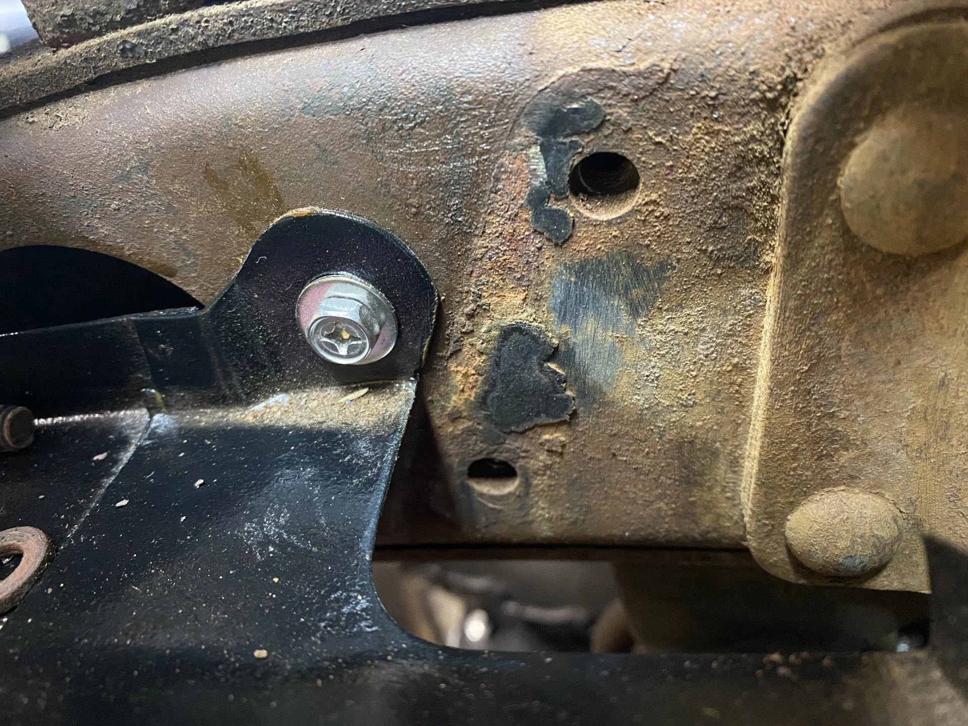

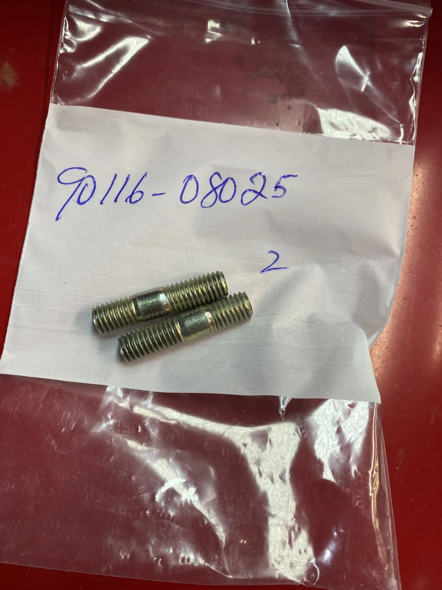

Happy to find metric screws that look and function the part for the front splash guard! Also M5 x0.9 mm yellow zinc bolts for the grill. Belmetric with the goods. Yes I will chase the threads on the M5 studs :p I love finding the right JIS hardware for the job. The little things add up!
