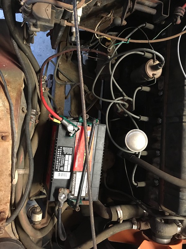

So the battery hold down on the rig right now is some weird custom job that is too large for a group 24 battery and is too tall to even bolt it down and the battery has to be bungee corded down. hahaha
I was thinking of replacing it with a generic top holder. Anyone ever do that? This is a stock early 40 holder so its a different configuration than the later battery holders.

I personally like the updated stock holder and holddown. Just put a fresh pair in the Karma cruiser a couple of weeks ago. It has the advantage that the holddown is nowhere near the terminals.
Even though I was lucky enough to buy an early NOS holddown for my 45 that I restored in ‘93, the proximity to the terminals made me nervous, and I ended up trimming part of the holddown.

Funny you mention the proximity to the terminals. In the picture you can make out a little electrical tape I put around the current holder for that exact reason. It was sketchy. I was thinking a different holder would solve that issue but that is probably wishful thinking. :slap: I think you and @Fourrunner are right… just get a all new holder.
