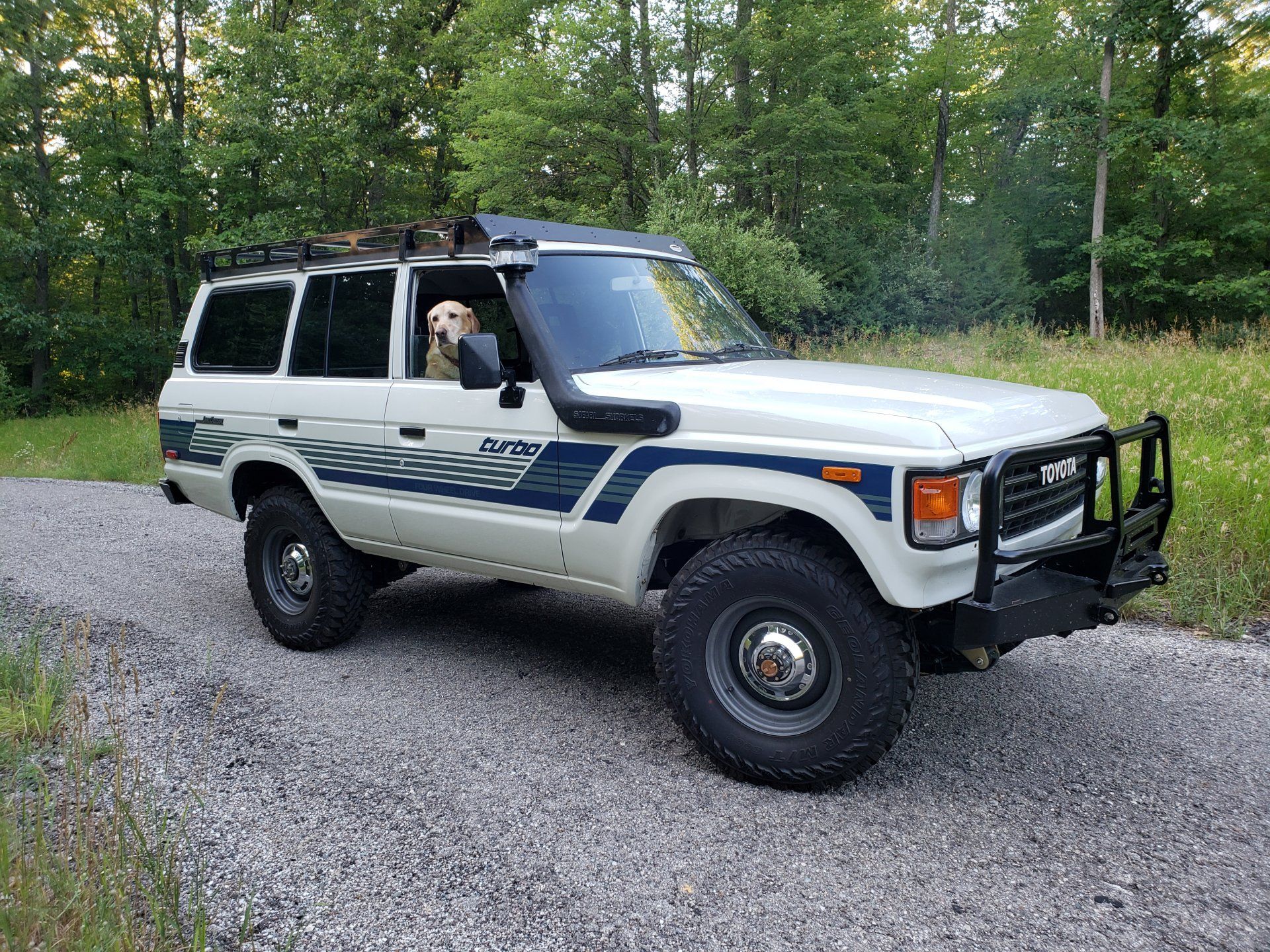

Man, those stripes look awesome!
Take a deep breath and repeat after me:
"It's not just good. It's good enough!"
Trying to get the stripes right on Chunk has been a serious pita!
I was going to go with a totally new color scheme and that was a disaster, both color and the quality.
Back to blue and grey.
The new shop that did these stripes did a pretty good job quality wise but the grey is off. I am out of time for this, so calling it good until winter most likely. I do like it though, just needs some adjustment
Sooooooo gooood!
Thanks all. They grey came out with a lot of green in it, kind of a wet concrete kind of grey. The shop that did them will make me a new set but I am thinking that will be a winter project.

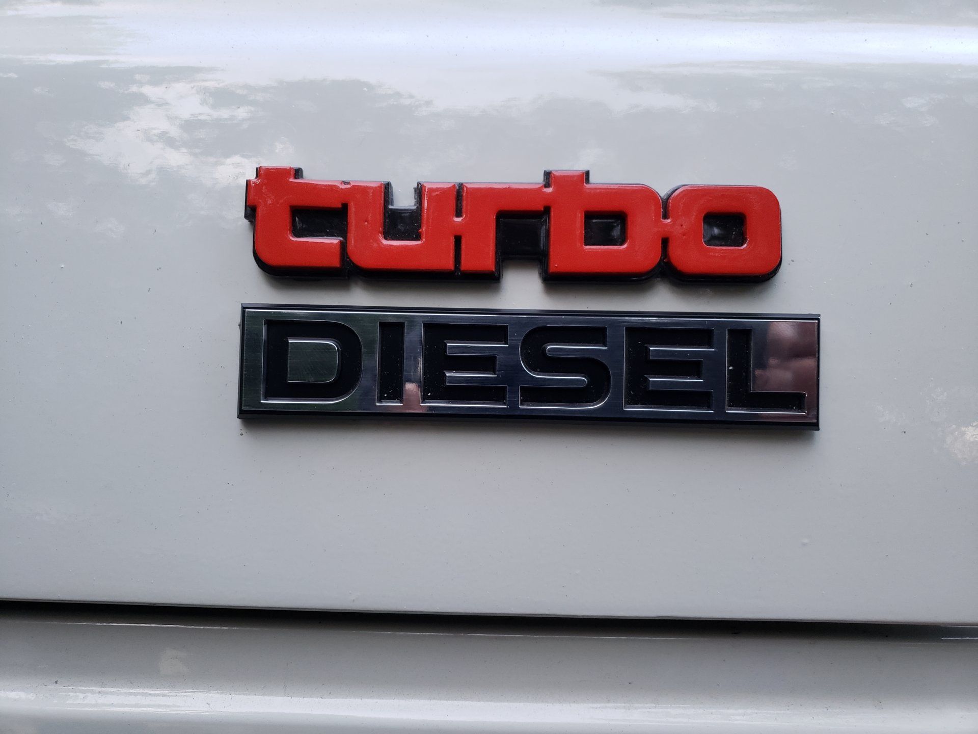

Instead of the "turbo " decal on the rear hatch, I went with an oem diesel badge and one of my turbo emblems. I still need to make brackets for the grille and then I will repeat there.
The "fj60" plate is sort of wrong now! Soon getting replaced with historic plates anyway. Much less $$
Looks awesome, Pat! Buddy looks pensive...probably wondering why you guys aren't driving somewhere!
He'll sit in there all day if I let him

Pat, that truck looks GREAT! I have been seeing more and more trucks with the striping, and whereas I never really gave them much consideration when the trucks were new, I have a newfound appreciation for them.....so retro, they're COOL!
Also, is that Line-X or some similar material sprayed on the underside of your truck? It looks so clean and durable! Did you pull the body off the frame to do that?
