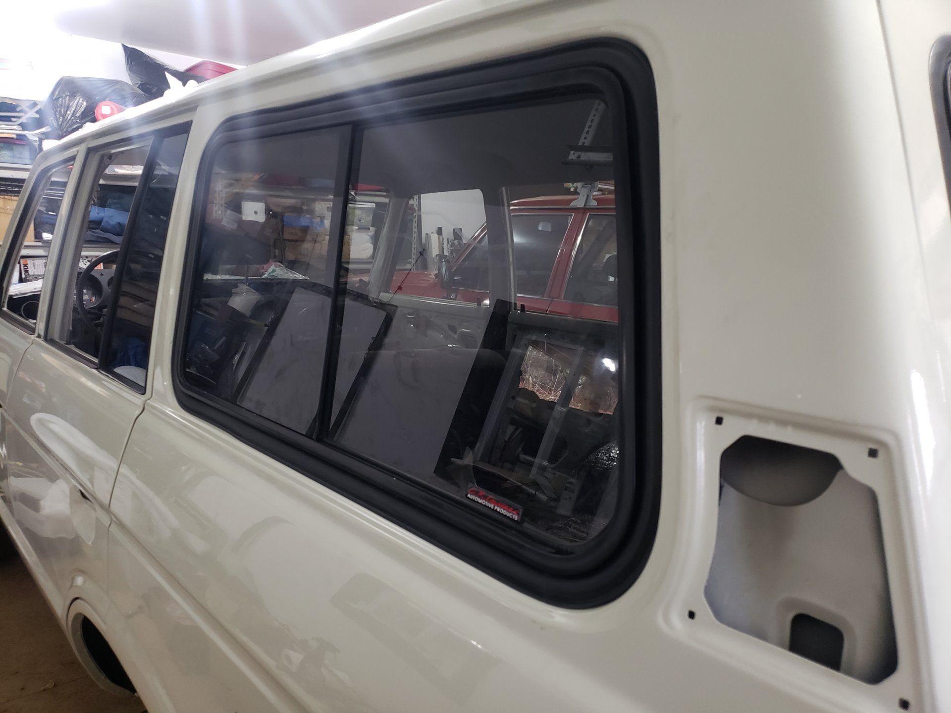

Here's a big win- I got a set of SOR sliding windows with my new to me red 60 series and knew right away they were going into Chunk. I will say they are TOUGH to install. I had to beat the window opening lips back to take the curve out, that was unnerving. A hammer and a wood dowel did it pretty easily really and all paint marring is under the gasket. My daughter Lizzy leaned on the window while I roped it in. I'm pretty wore out but it looks pretty good. It will need a little headliner fixing up but it's not coming back out!
Also I am doing the stainless trim delete in the windows so the gaskets are from Cruiser Corps
Also I am going to have to get the lower trim in ex post facto because it was such a challenge getting the window in that I didn't want to fuss with the trim too

Small chunks on Chunk. I powder coated the strips between the rear functional and fixed rear windows. Now on to the install. Also putting in the outer weatherstrip for use without chrome trim.
Lizzy helped me get the other side window and rear window in today
Nice! I think my wife and I took about three tries to get the back window in correctly. It kept sliding as the rope was getting pulled. :)
I think I lucked out getting it first try. After those sliding windows it seemed like a piece of cake!
Those windows are killer Pat. Can’t tell you how many parts I’ve robbed out of other cruiser purchases for my main blue 60. Can’t wait to see it this August.
They're a little weird because the opening part is in the forward part but I think I can still reach into my fridge ok.
