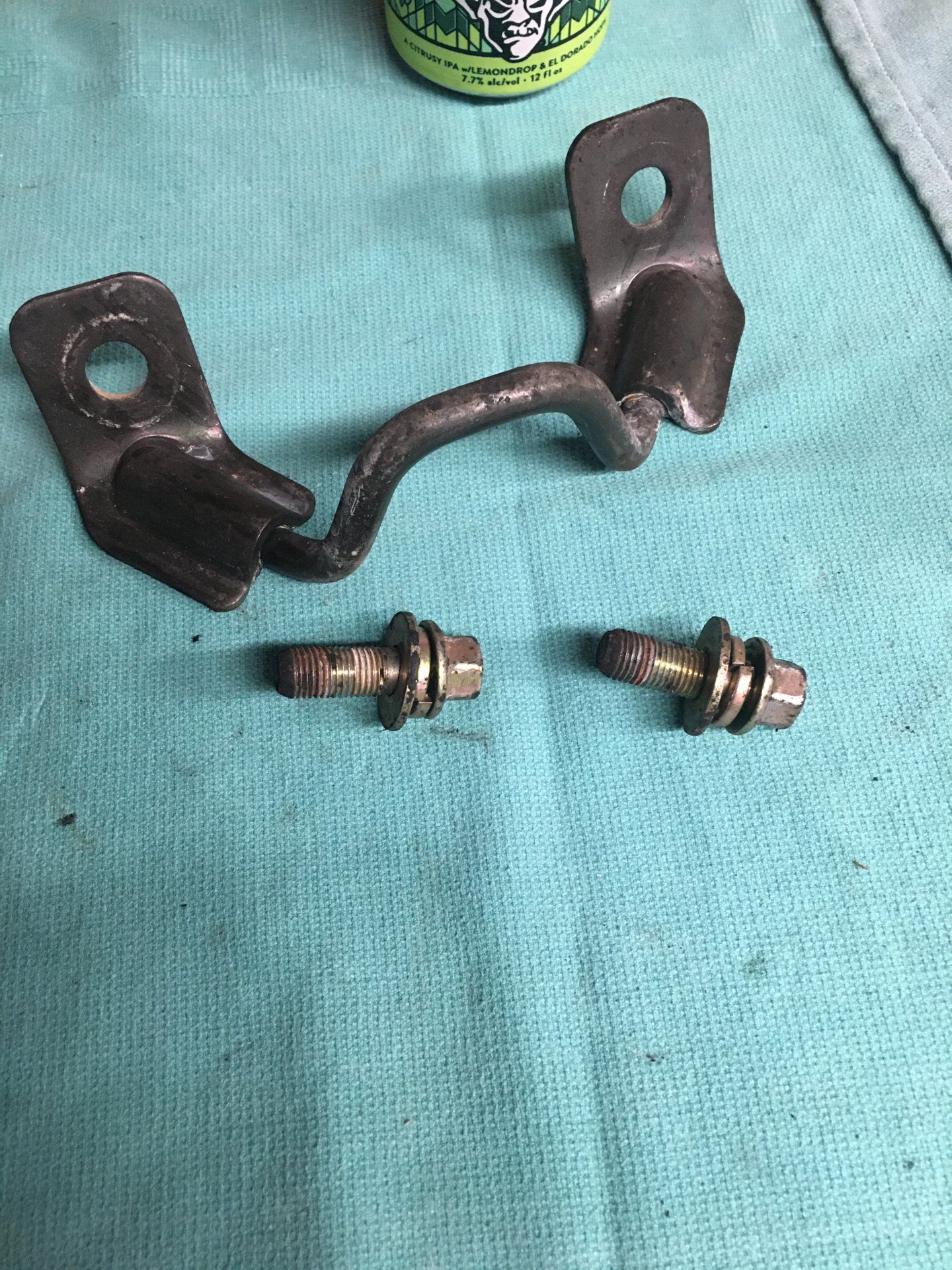

I don't know much, but I'm pretty sure Mr T didn't use wire nuts on the wiring so I grabbed a new assembly off of the parts 60.
Still needs the little metal pieces in the slots.
The gaskets and housings cleaned up super nice though

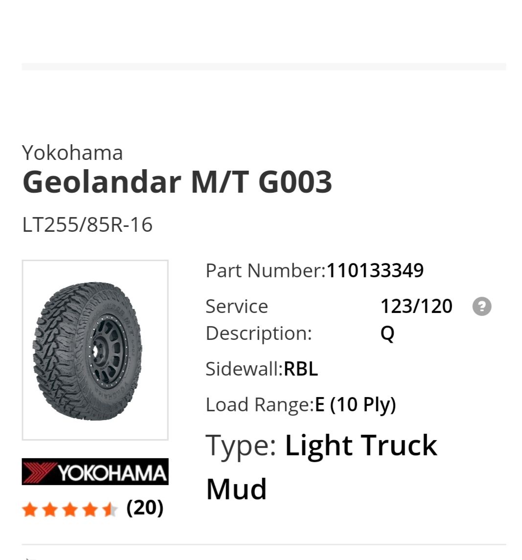

Tires are coming. After lots of thinking and indecision, I made the decision.
Yokohama 255/85r-16

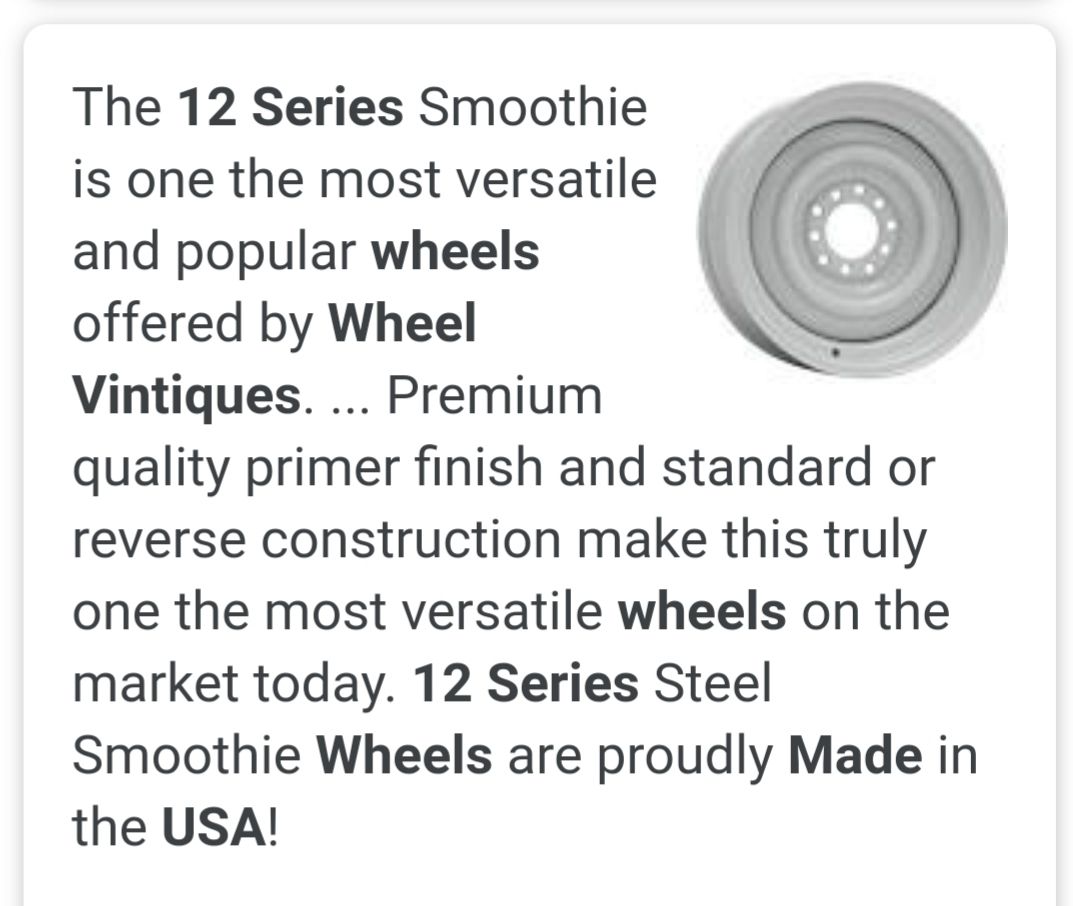

I’d go with either of the Japanese wheels, not the made in China Vintiques.
I’m I like theJDM wheels, you don’t see those much anymore.
Didn't know the Vintiques wheels are made in China. They are beefy wheels and I have had them for a while and like them. Still the China thing does kinda suck.
The stock aluminum wheels on my wife's 2013 4Runner are stamped China.
Found this on the 12 series wheel (which mine are)

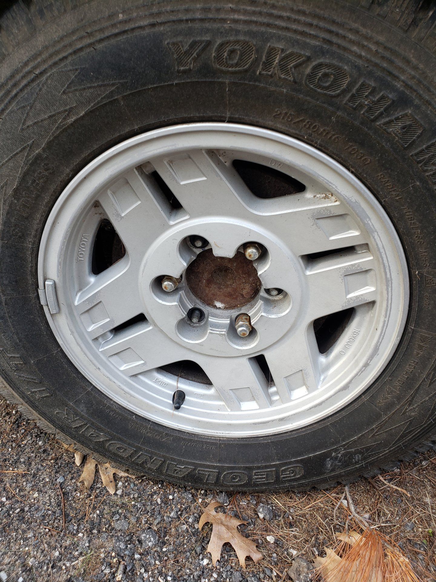

JDM's are hi lux and 4 runner wheels, no ??
These came from a 70 series out of Japan.
16x6 but they look like the 15x6 US 4runner wheel

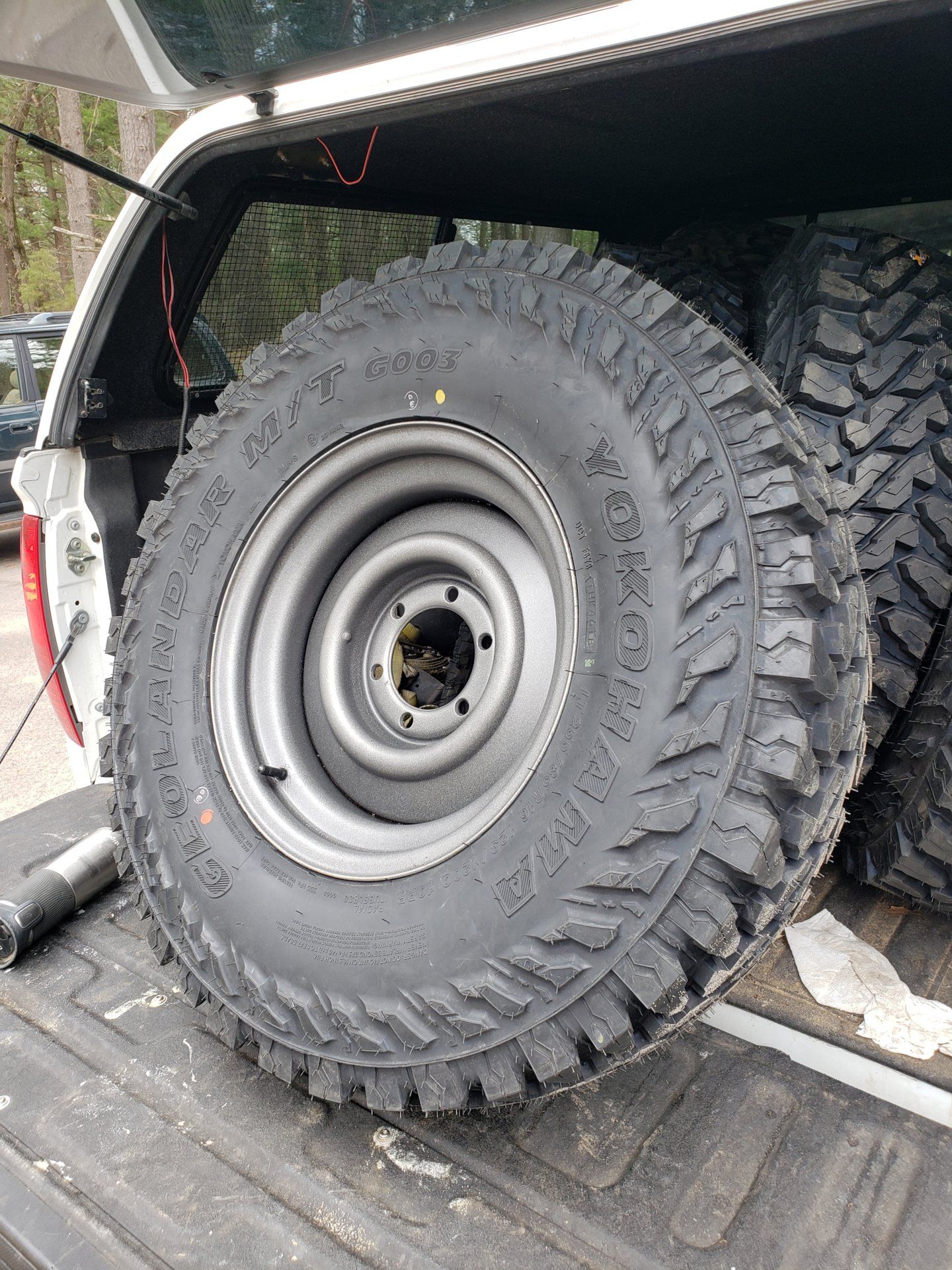

I got my new Yokohama 255/85-16 tires in a couple of days ago and got a chance to powder coat my Wheel Vintiques 16x7 wheels and mount the tires up.
This is Prismatic Powders "Kingsport Grey" basecoat
And Prismatic "Matte Clear" topcoat
I threw the wheels on and pulled Chunk into the yard for a quick photo op. Still riding way high on the back but lots of weight to add too so we shall see how the springs end up.
I did pictures with no hubcaps and with caps
I like both about the same, really.
It looks awesome Pat!
Thank you. I needed to get those wheels on there to keep me motivated. Those little donuts on there were killing me!
