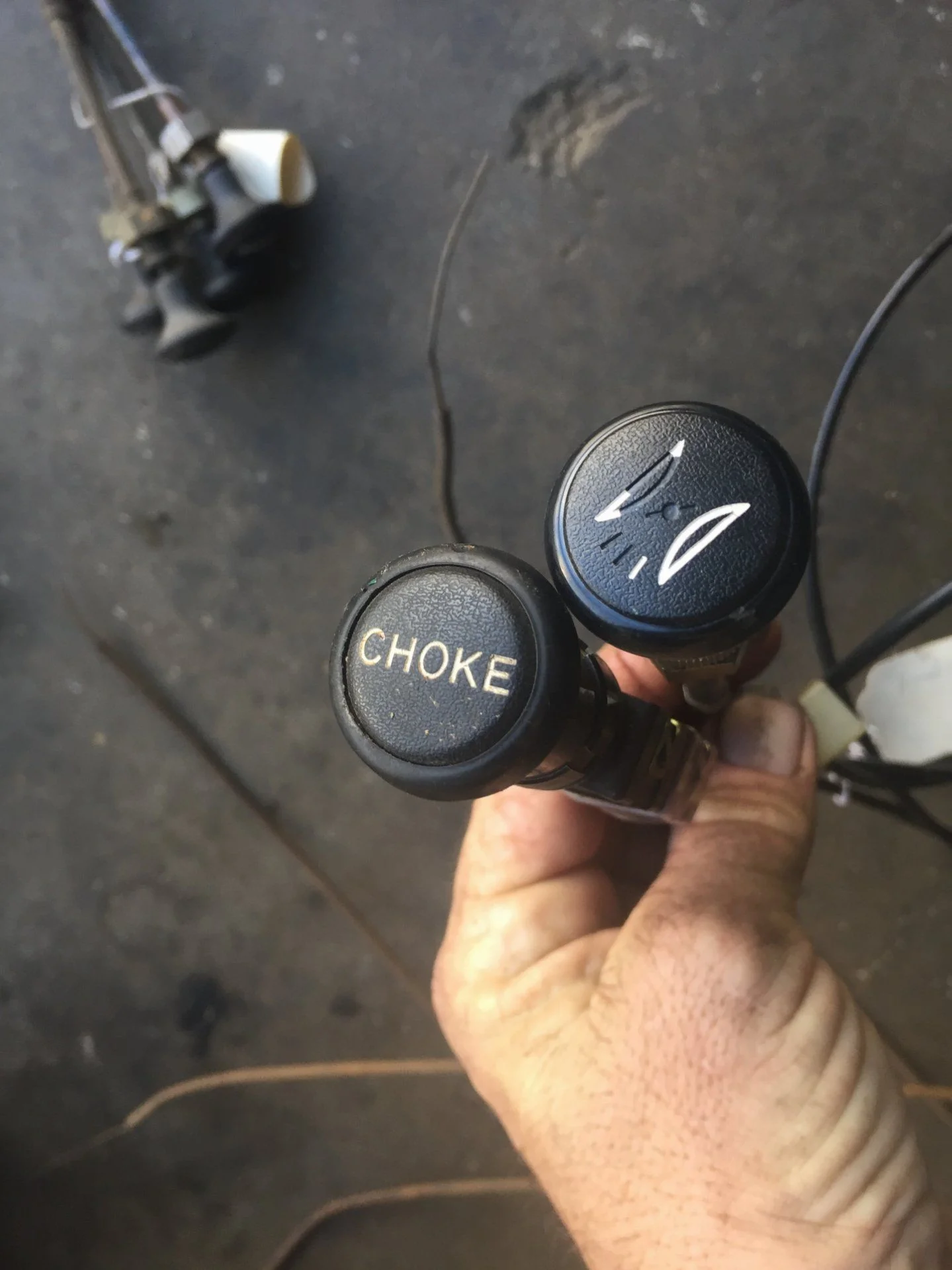

First up we have the early thru 1966, no dash pad variety. Marked by a large smooth,domed head and lettering. Bare spiral sheath, solid core
Second are the 9/66-7/70 variety, marked by the large unframed choke butterfly inside a recessed head. Bare spiral sheath, solid core.
The 7/70-9/73 variety had the same choke butterfly symbol, but it was put inside a rectangular box, again inside a recessed head.
The FJ55s of this era had their own cable, with a smaller domed head and a slightly different version of the boxed throttle plate. Bare spiral sheath, solid core.
The 9/73-7/80 cables all look the same from the knob. Beveled and tapered head with letters. The earlier ones were bare spiral sheath with solid core, while the later model had a vinyl clad sheath and stranded wire core.
Additionally, these cables had detents. One version had a single detent; the other was multi-position. I could use some help in identifying which was the earlier, and which was the later. The FJ55 version was apparantly a few inches longer than the 40.
Lastly, I have the FJ60 cable, which incorporates a switch for a warning light. Vinyl clad sheath, stranded wire core, with a trunnion end at the carburetor.
It is my understanding that the FJ40 version for this timeframe shared the trunnion feature.
Early FJ60 cables did not have a switch for the warning light. Don't know when the choke light was added, 1983 maybe?
Do you think that is the other cable pictured, the one with the symbol?

I don't think the other one, symbol only, is a from a FJ60. I've only had a few FJ60s pass through my hands, '81, '84, '85, and '86, and all had CHOKE on the knob. The '81 was the one without the choke light, all other years had it.
82-84 40 series choke knob was illuminated when pulled.
Believe the "earlier" 60s had this feature as well, until 1984

My 10/73 has the same knob with the word choke as Johnny C does (75-80 pattern). It also has the fresh pull, warm pull, wiper marked knobs of the period. Of course it also has marker light holes in the bib with out marker lights which is not correct for its vintage...

FWIW, I seem to recall the heater switch knobs changing over in '74, which is in line with what you and JohnnyC are saying about the choke cable.
Interesting. My 6/71 build date fj40 has a choke cable with the butterfly in the box that you indicate was 73-74. I would've thought that my choke cable was stock for my year.

I'm sure that many Cruisers have had the choke cable replaced over the years. My 2/71 has an early choke cable installed. No idea which PO did it. It wasn't my brother or me.
