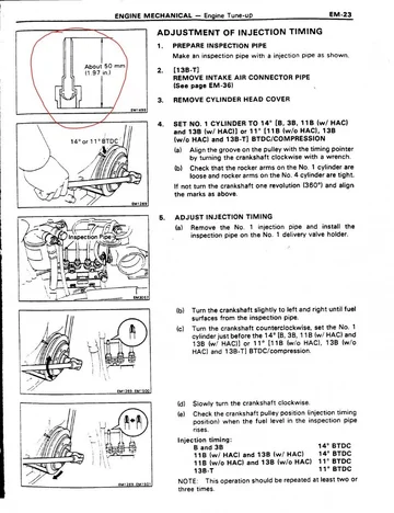

I'm going to step back and re-check the vavle clearance (cold) and injection timing, I'll need to make an 'inspection pipe' per the FSM.

Installed the new glow plugs, checked the injection pump timing (cut a 50mm long section of line, attached to #1 injection output off of pump, fuel squirts up out at 14 deg. BTDC) per the FSM and that checked out.
