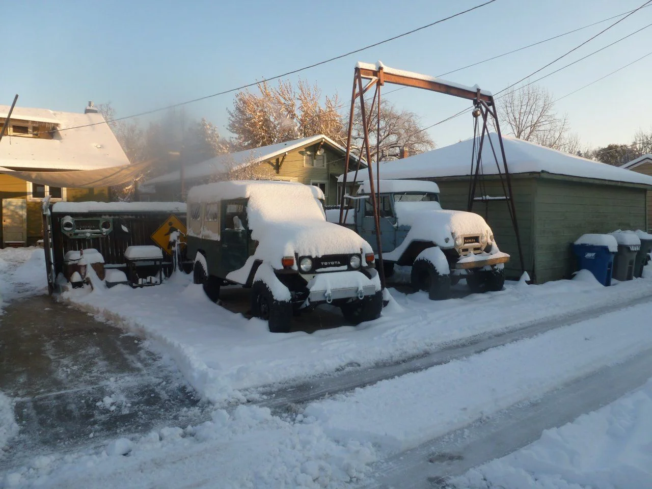

Not much progress, tore the donor wiring harness apart, pulled out the starter relay, glow plug relays, resistor, EDIC relay and all the mating plugs...then the it got cold; 9 deg. this a.m. supposed to be -5 tonight.
I need to stop working on cruisers and build a real garage.
Sure looks cold there Owyhee!

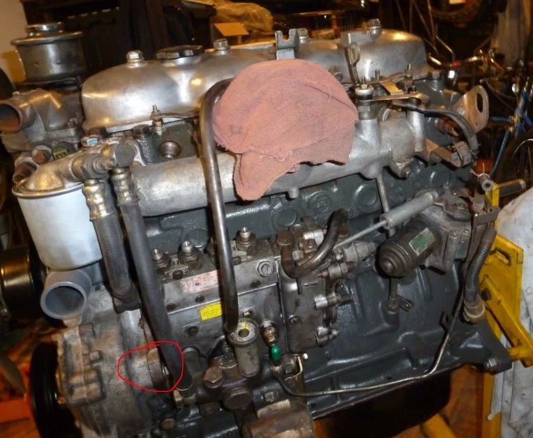

EDIC seems to be operating properly. cycles to over-injecion when starting, run when key is in 'ON' and shuts off when key is turned off.
Gear assembly photo, marks look right to me.
And injection pump alignment mark.
Certainly looks correct.. needs confirmation of correct operation through a manual timing check... then a compression check.
