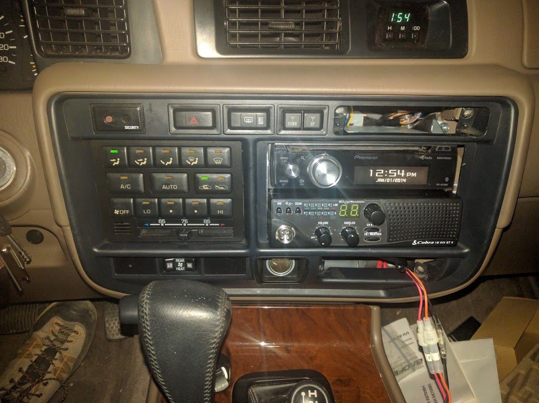

If you're looking to do a double-stack, you'll want a CB that's a single DIN mount. The Cobra 18WXSTii is single din, enclosed, and has a front-facing speaker. It fits quite nicely.

I have the Cobra 18WXSTii . The only thing I don't like about having it in the lower socket under my new stereo head is that the mic cable is a bit close to the shifting knob, at least with my size hands on a 1994.
I wired it the same time I did my replacement subwoofer and when I got my slee rear bumper. There's some pictures of the whip antenna and spring mount thing here: slee cb antenna mount - fixing the swr problems
