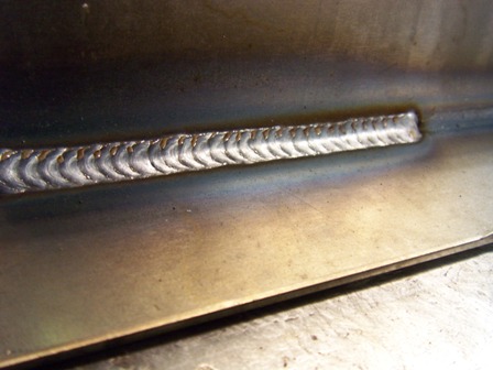

Your welds are too cold and/or you were moving the wire too fast. Grind them down and have someone redo them because running gear is not where you should be learning how to weld.
Thanks for the feedback. It's a Lincoln 125 and it was on the highest setting for heat. I think I had the wire feed set too high and I was in a hurry.
Wire feed was probably fine... If you had the heat cranked, then you were just moving the arc too fast. Move the arc in a circular pattern as you move down the seam you're welding. Your bead should look like this:
Use your ears- correct heat and wire feed settings will sound like bacon frying. If the arc intermittently goes out, or you feel the gun being pushed away from your work, your wire speed is either too slow or too fast respectively.
Hit up a metal shop and ask for scraps to practice on. Maybe even offer to bring over a six pack after work if they are willing to show you some basics. MIG welding isn't hard, but it's not intuitive.
