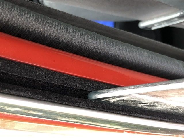

Like many of you, I have sluggish windows, especially when it’s cold. The original window glass runs in my doors were brittle after 30 years, and I’ve been trying to replace them for a while. A couple of weeks ago I finally got to it.
I tried an OEM replacement but it was poor quality. Genuine Toyota runs are either NLA or $$$, depending on who you ask. On a whim, I ordered this and was surprised at the great results, despite it being a generic product.
Unlike the original, this run is flocked, so the glass just glides beautifully in it. It presses right into the window frame but is a little more compact in cross section than the original run. Doesn’t seem to affect function, though.
Note that the original has a corner molded into it and this one does not. You will need to notch out two little bites with scissors to get it to bend in a sharp 90 degree corner, but that’s not difficult to do. The original was also two pieces - the up-and-over portion with the corner, plus a straight piece down the hinge side of the door. I just ran the replacement in one piece.
20’ will do both front doors with a little extra for corner-making practice. The rears need a bit less, but I haven’t tackled those yet.

how hard are the corners to do since they're not really molded?
Also what's flocked mean with these? I have new regulators but my windows are notoriously hard to roll down. Im interested in trying other things to fix the problem!
Flocked means that they have a fuzzy texture, unlike the smooth rubber of the original. The flocking helps the glass glide in the channel. Many modern cars have flocked window runs.
Getting a sharp 90 deg corner is really not as hard as it might seem. Order a couple extra feet and practice. You only need a sharp pair of scissors or nippers. If you bend a piece of the run into a right angle, you will see where the extra material bulges out - just need to snip that off. When you lay it flat again, it will look like 2 v-shaped notches opposite each other. Start feeding in the run at that corner, pushing it in with a narrow screwdriver. Done well, you won’t even see that it’s been notched.

@Super77 This is excellent! Have been looking for a good source for a while now. Are these glued in or just press in place? Were you able to pull the old ones out in one piece and use as a template?
Also for powered regulators I rebuilt my motors (24 V so hard to find and $$$).
Neither the originals nor the replacements are glued in. They just press-fit in place. And you don’t need a template. Just measure both ways from the window corner to locate the area to snip, and leave a couple inches to trim off at the bottom of the run. IIRC, the hinge side of the door can be left long, but the latch side has a hard stop.
You will need to remove the door cards and at least cut into the plastic sheet underneath it. That’s the only way to get at the bottom of the window run channel.
If anyone does the rears, post it up here. I’m curious whether they present any unique challenge. I imagine the corner-snips will need to be more precisely measured on the back doors since there will be two of them separated by a fixed distance. The front doors only have one snip, so locating it isn’t a big deal if you leave a little extra on both ends of the run.
I noticed that on Amazon you can buy 160’ for $339 shipped. That’s enough for all 4 doors on 4 cruisers with some to spare, at about $85 per truck. Even if you have to add extra for re-shipping cut lengths to your 3 friends, it’s a reasonable group buy. In fact, I’m in for 20’ if someone else is doing just 2 doors.
