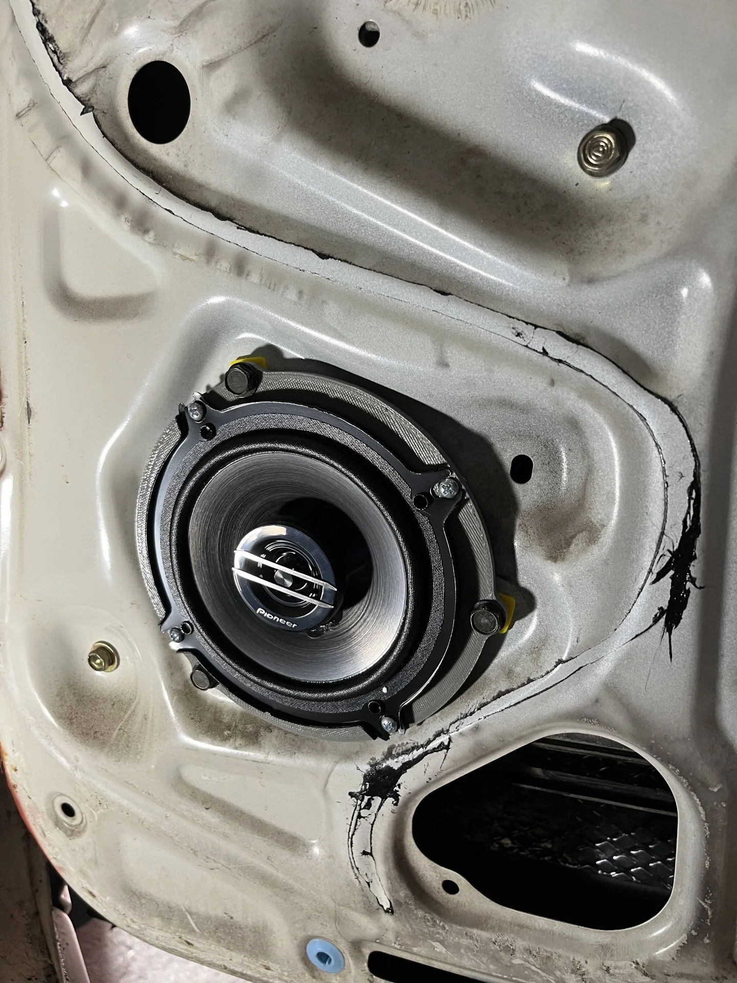

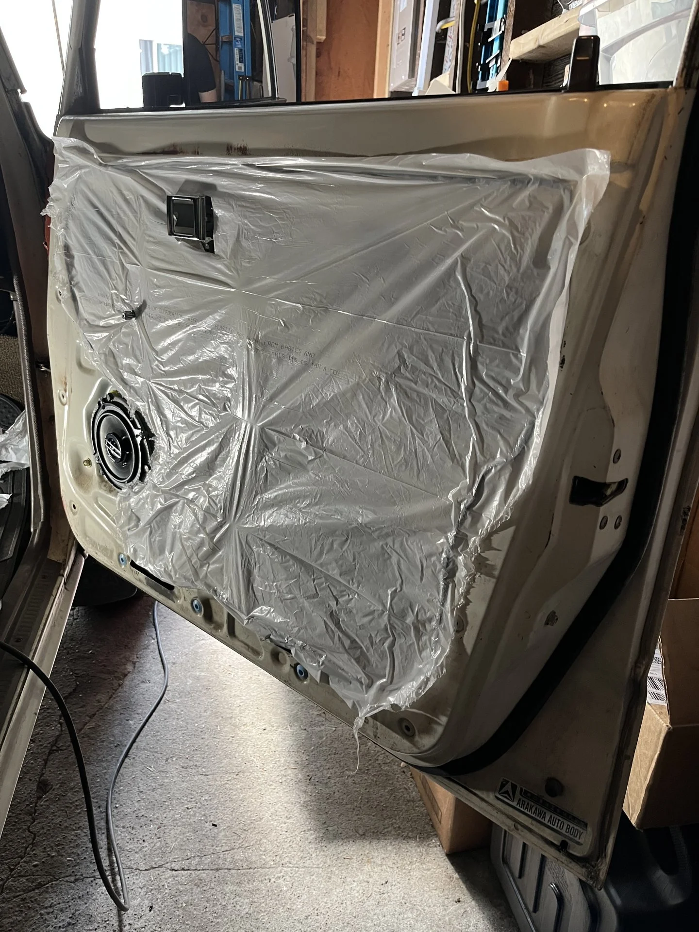

I finished up my front doors today! Installed new Pioneer TS-G1320F speakers today (with adapters from @TheNeek) and gave doing vapor barriers a shot. I'm decently happy with how they turned out. I dusted/cleaned with 91% alcohol (figured removing any oils wouldn't hurt), then laid down butyl rope I had lying around. Topped it off with some garbage bags cut to size.
The new speakers are so much better then the original ones that were hanging in the doors. It's not an amazing audio experience (would need a sub and lots of NVH work I think), but I'm very happy with this audio upgrade. Big upgrade from the previous Bluetooth speaker!
@kenavt What size are the speakers? I did new speakers in the tomato truck and I’m happy with them, but they use a spacer external to the door card. I’m getting some ideas together for what to do on Matilda…. Some different ideas…
They're 5.25". Feel like the perfect size for that spot with the adapter.
And they fit under the OEM speaker grilles?
Just an FYI if you haven’t put the door cards on yet, the Phillips screws and keep nuts are backwards. The head of the screw should sit in the recess on the adapters.
Oh I see that now... I saw the recess... and then didn't think of having the nuts facing outside to the door cards 🤦🏻‍♂️ I'll fix it the next time I'm in there.
It's not a giant deal, just wanted you to know and if anyone looks at your photo. I should probably make an instructional sheet to go with the adapters.

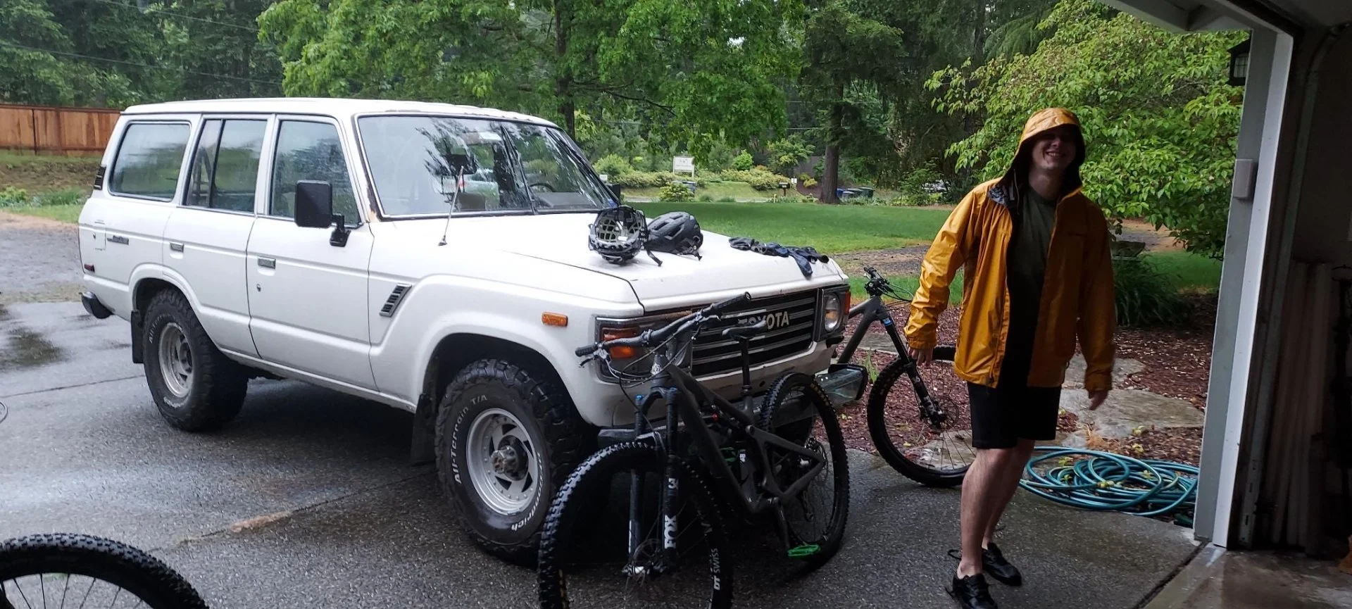

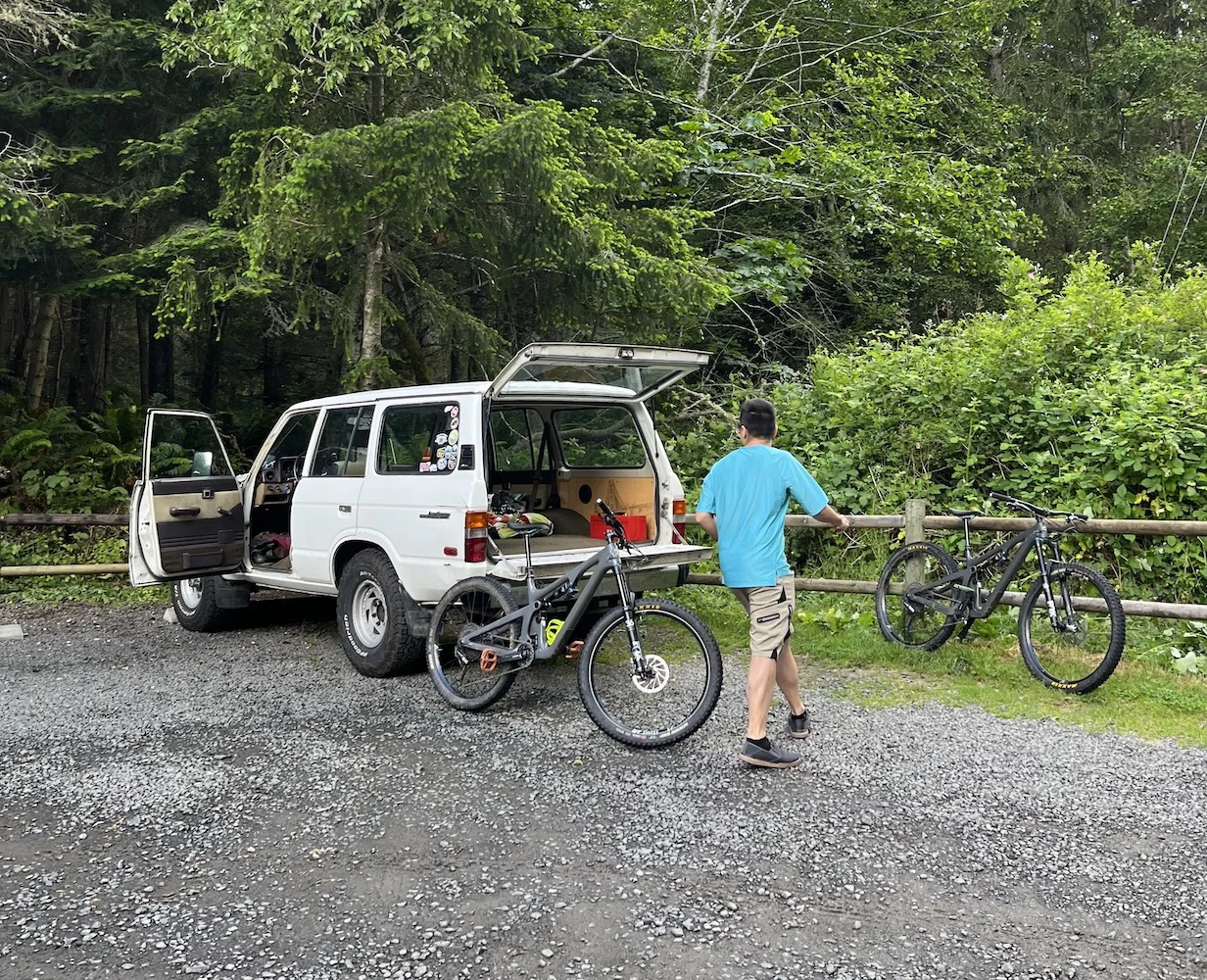

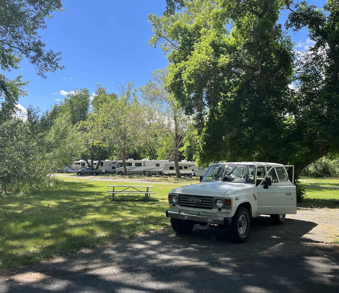

This past weekend saw a couple friends visit from out of town excited to do outdoorsy stuff, and we were determined not to let a historically cold and rainy Seattle spring stop us. So over four days, we drove over 500 miles in Cara across to the Kitsap Peninsula (just barely dry) to do some mountain biking, and over to Yakima (also just barely dry) for some camping and hiking. Cara and I's first times on a Washington state ferry and also crossing Snoqualmie Pass! Also the first time I've camped and slept in the truck since August 2020, on the fateful trip that led to the 2F swap. Been a long nearly-two-years.
The truck performed great, and I even hit 14mpg on one tank for the first time in a while. I fell to ~50mph in fourth gear climbing Snoqualmie Pass eastward, and some of the grades on I-82 along Manastash and Umtanum Ridges, with my smogged 2F and stock gearing and 33s. Which from asking around seems like a good result. The rubber overdrive also allowed me to do low 60s mph at ~2500rpm and even go up to 70 at 2800rpm which was great trying to do alright on I-90 and I-82.
Temperature wise I never got above 170F on the aftermarket gauge (when climbing); largely stayed in the 140F to 160F range. Got as low as 125F coming off Snoqualmie Pass westward. I have a feeling my thermostat is stuck open, or something else is going on. I can hear the fan running full blast somewhat frequently. I figure I can enjoy the truck and worry more about sorting that out when I have the opportunity and inclination for some downtime.
Yakima River Canyon is gorgeous and reminds me a lot of Livermore, CA and the East Bay Area (but forgot to take pictures). Camping with friends is always fun! With little left to do mechanically, looking forward to a fun summer.

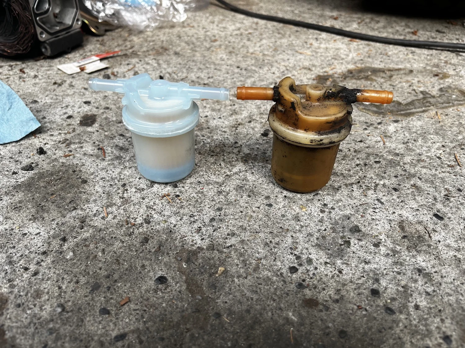

I have no idea when the fuel filter was last replaced, but the new one looks so pretty in comparison! $10 for 23300-38010 from my local Toyota dealer.

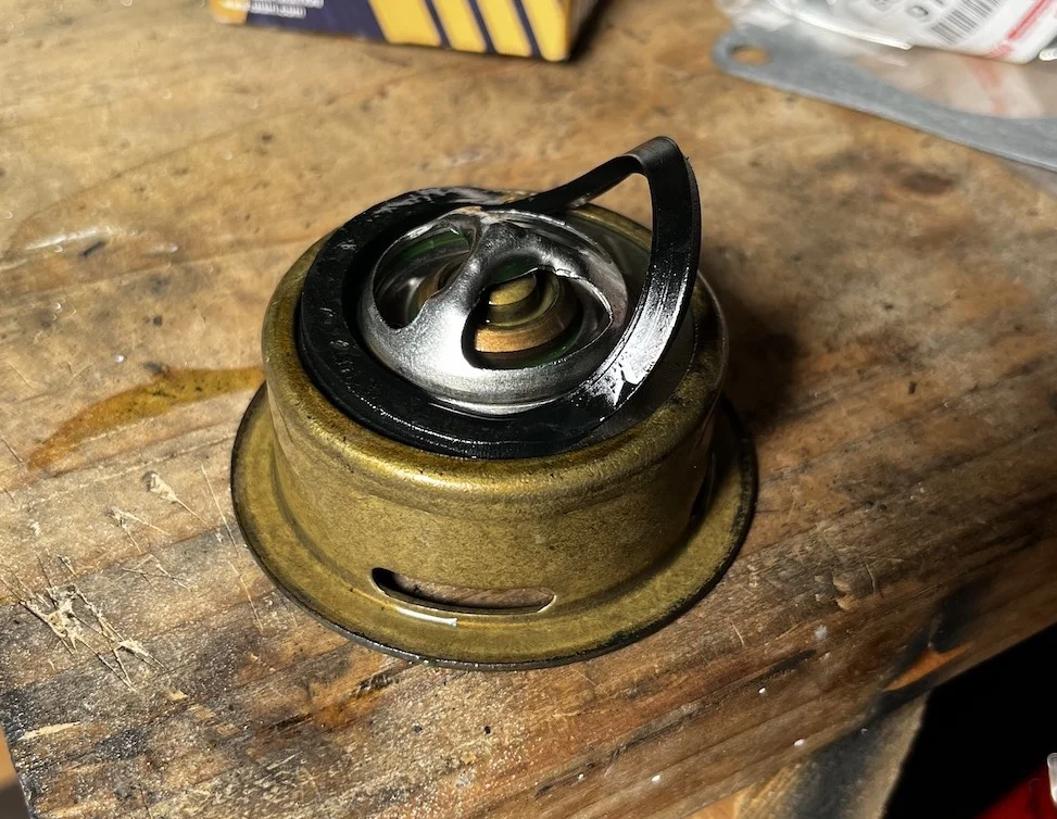

And I do think I found the cause. When I took the thermostat housing apart I found the upper gasket had been bent at this crazy angle; no idea how that happened. From reading on here it sounds like if that gasket is misplaced or doesn't have a good seal, then coolant will just rush by and the system behaves like the thermostat is allowing coolant to flow. Which I think would explain my system behavior well.

Do you notice any differences after replacing the fuel filter? Mine was barely dirty to my eyes but after replacing it, Falcor ran quite a bit better.
I haven't yet... but I haven't done any driving that I would really notice it... I tend to notice small power differences only on the highway. I'll report back. The gas did look very clear to my eyes, and I did just get that new fuel tank (which I know you did too, although not sure if that was before/after your fuel filter). I will say that I was worried I might have to prime the system or it might stumble until the fuel filter was full of fuel, but it started right up and didn't have any stumbling.

I replaced my fuel filter before the gas tank replacement and was surprised that it was so clogged up after possibly only 5000 miles.
Curious to hear if you have any noticeable drivability improvements.
