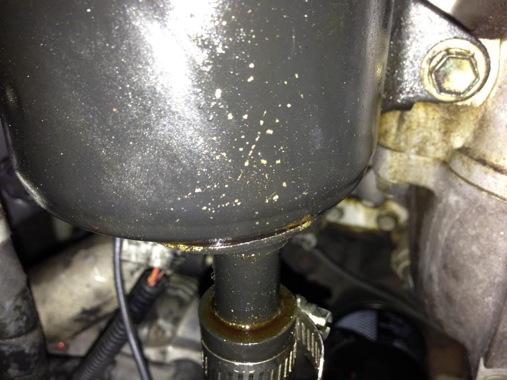

Here is a picture of what I am looking at. There is a small gap between the downpipe / nipple and the reservoir itself. Fluid appears to be leaking here and then accumulating on top of the hose. I am almost certain it is not leaking from the cap. The top of the reservoir canister is dry. Thanks for all the help.

I found the same leak. Started getting worse, so I drained reservoir (conveniently all over the engine compartment :mad: ) , cleaned the seam with brake cleaner and emery cloth, and am using jb weld. I'll let you know if it holds...

After a 1000 mile off road trip, the jb weld repair is holding nicely. I am still seeing fluid, only now outside the cap. Anyone replace the cap? Part #? or repair the seal?
Thanks
Try replacing the low pressure hose with a section of bulk tubing. Mine leaked at the nipple. PO had added a hose clamp and tightened it up, but the hose was old and stiff and the hose clamp just couldn't secure it well. New hose and spring clamp and leak is gone.
"IF" are doing the swap a hose out etc. and you still have a small leak; I used a 'stopper' leak that worked great on mine. Up to that point I'd some "fixen" and lots of variations in p/s stopper fluids via checkers/autozone all to no avail. The 'magic' bottle worked great. If you need info on it I can do find and post up
PS My issue was a junction box for a hydraulic winch
My reservoir was leaking from the underside of the metal "lid" part. I used pliers to open each tab enough to get it off, then cleaned it real well with solvent. I used FIPG on both sides of the rubber gasket that was in there and put it back together and used pliers to re-crimp the lid back down. No leaks since. I read how to fix it somewhere here on 'mud.
