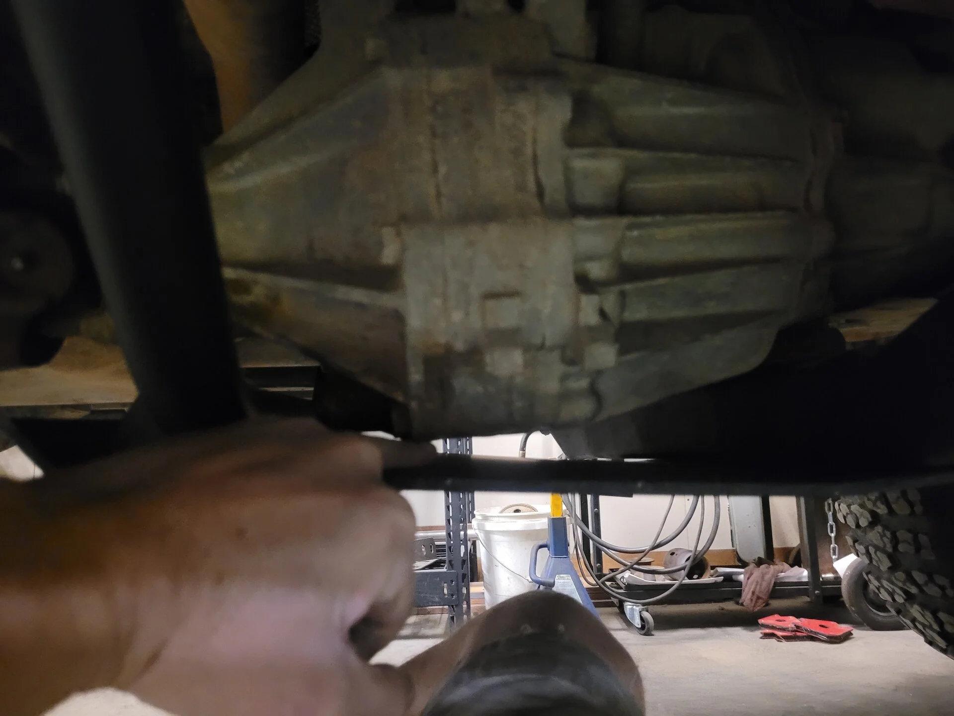

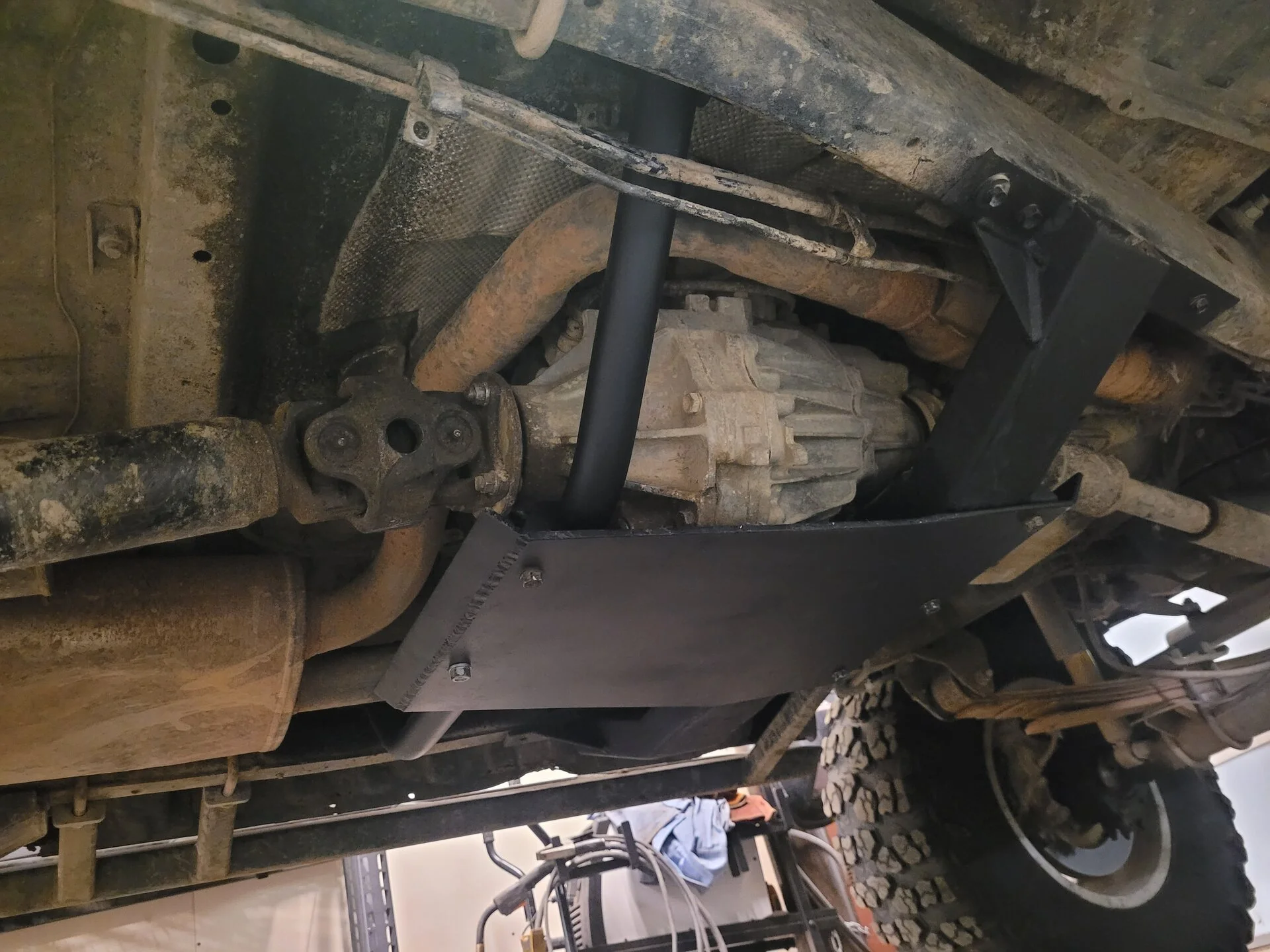

I put the transfer case on a rock for the last time. New armor is in.
Tight fit, but not too tight. Stout enough to jack the whole truck from. Time to wail on it at GSMTR.

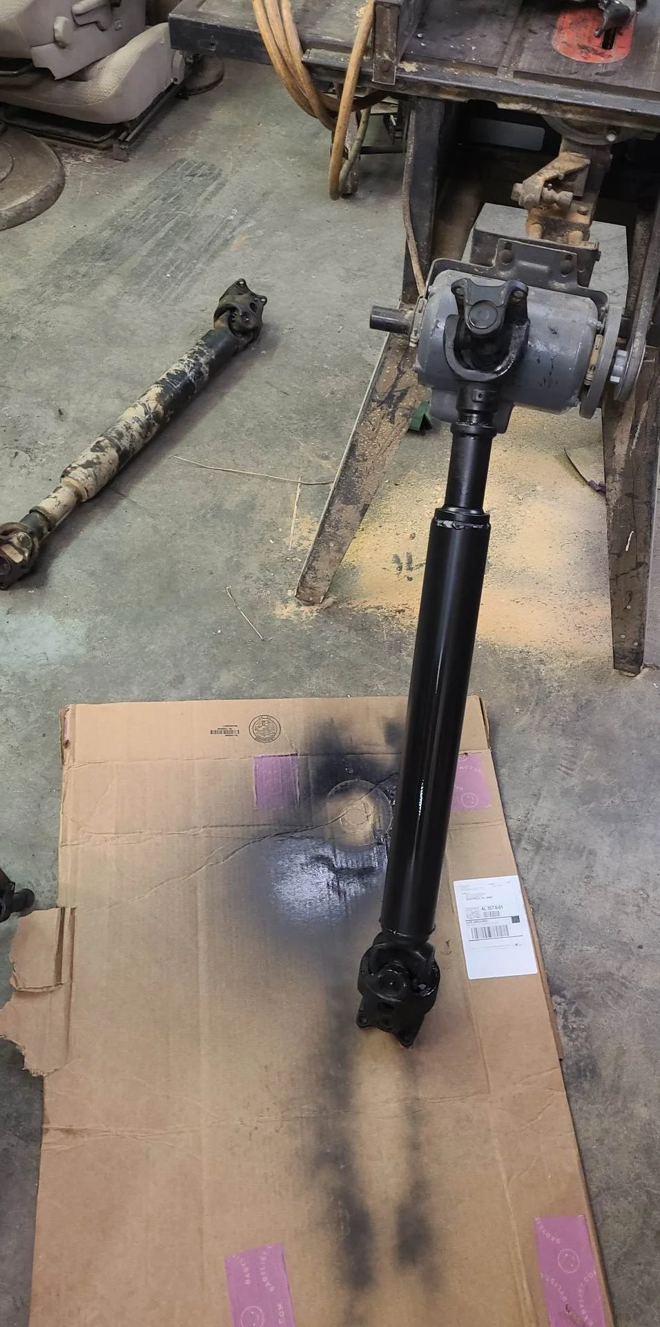

About time to have a spare rear DS. It's a twin of the other.. Toyota 4runner DC and 80-series diff-side joint mated up with sch40 pipe.

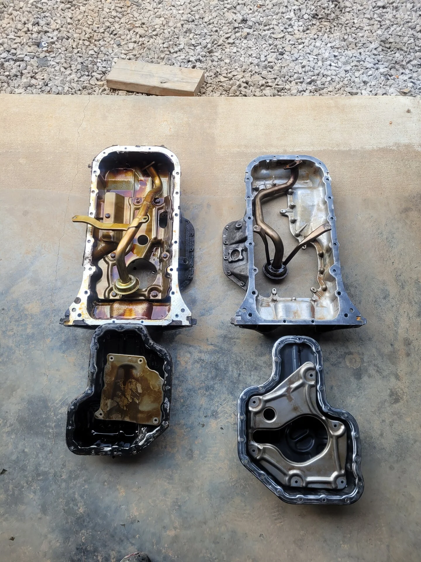

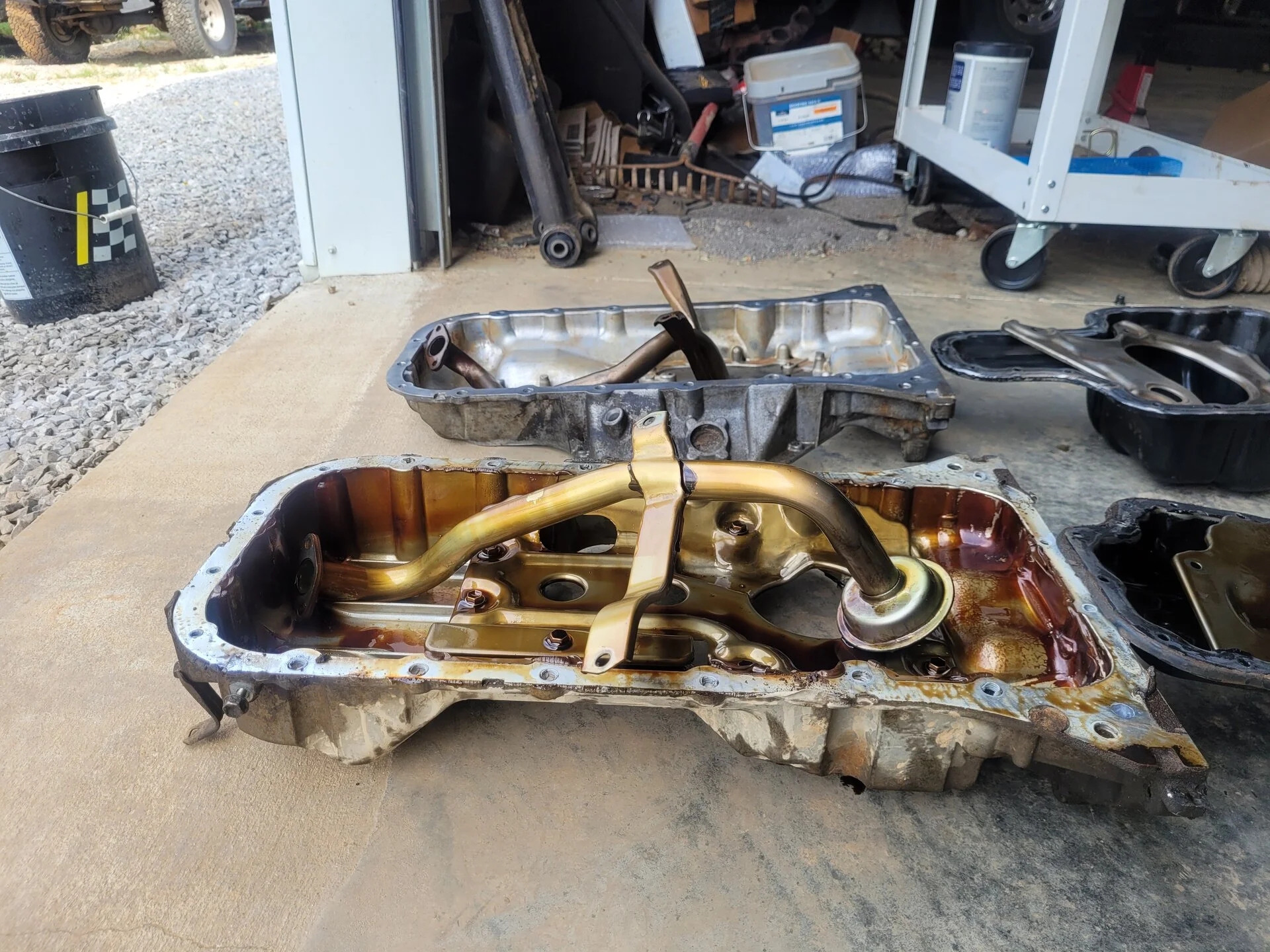

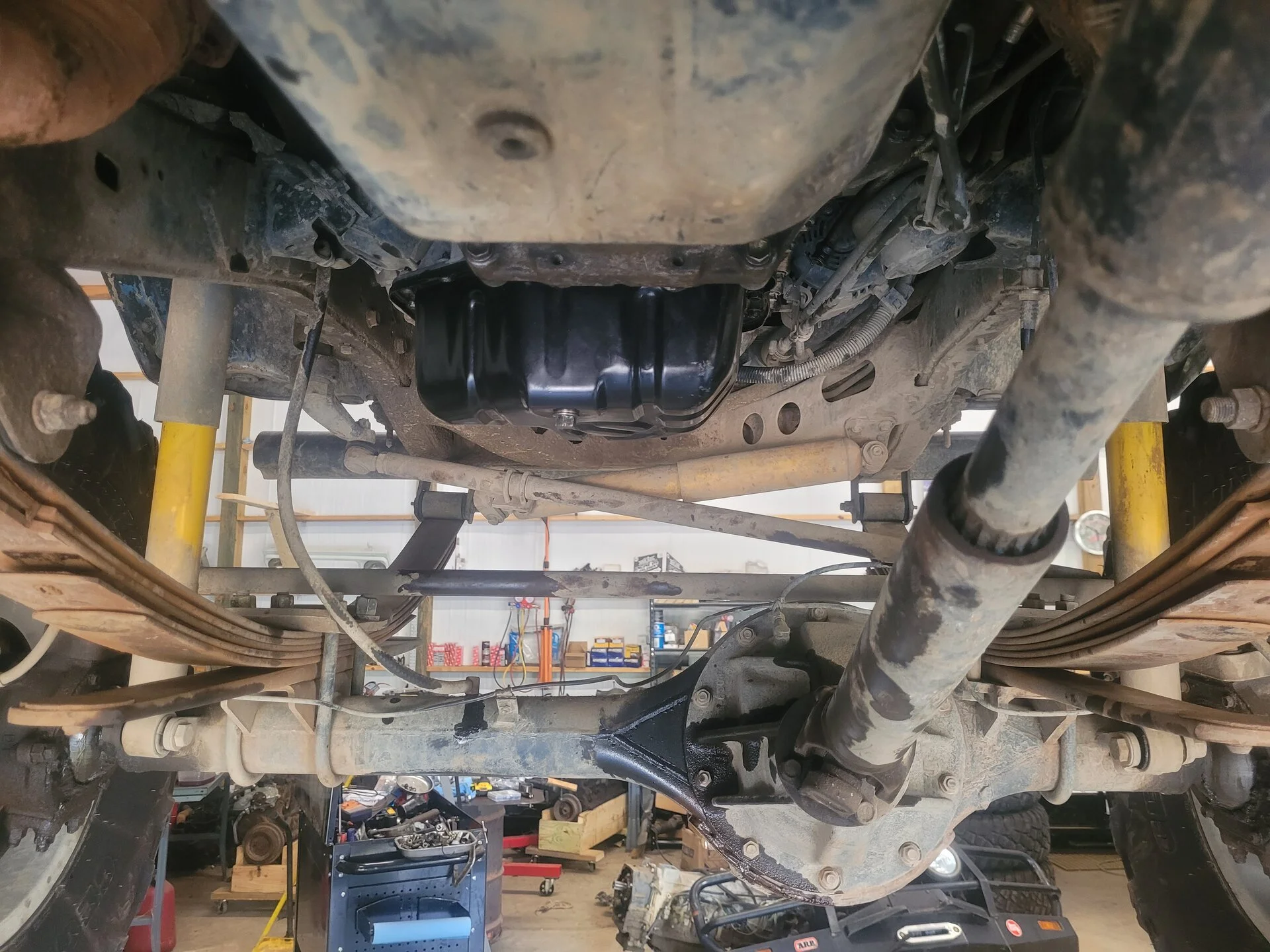

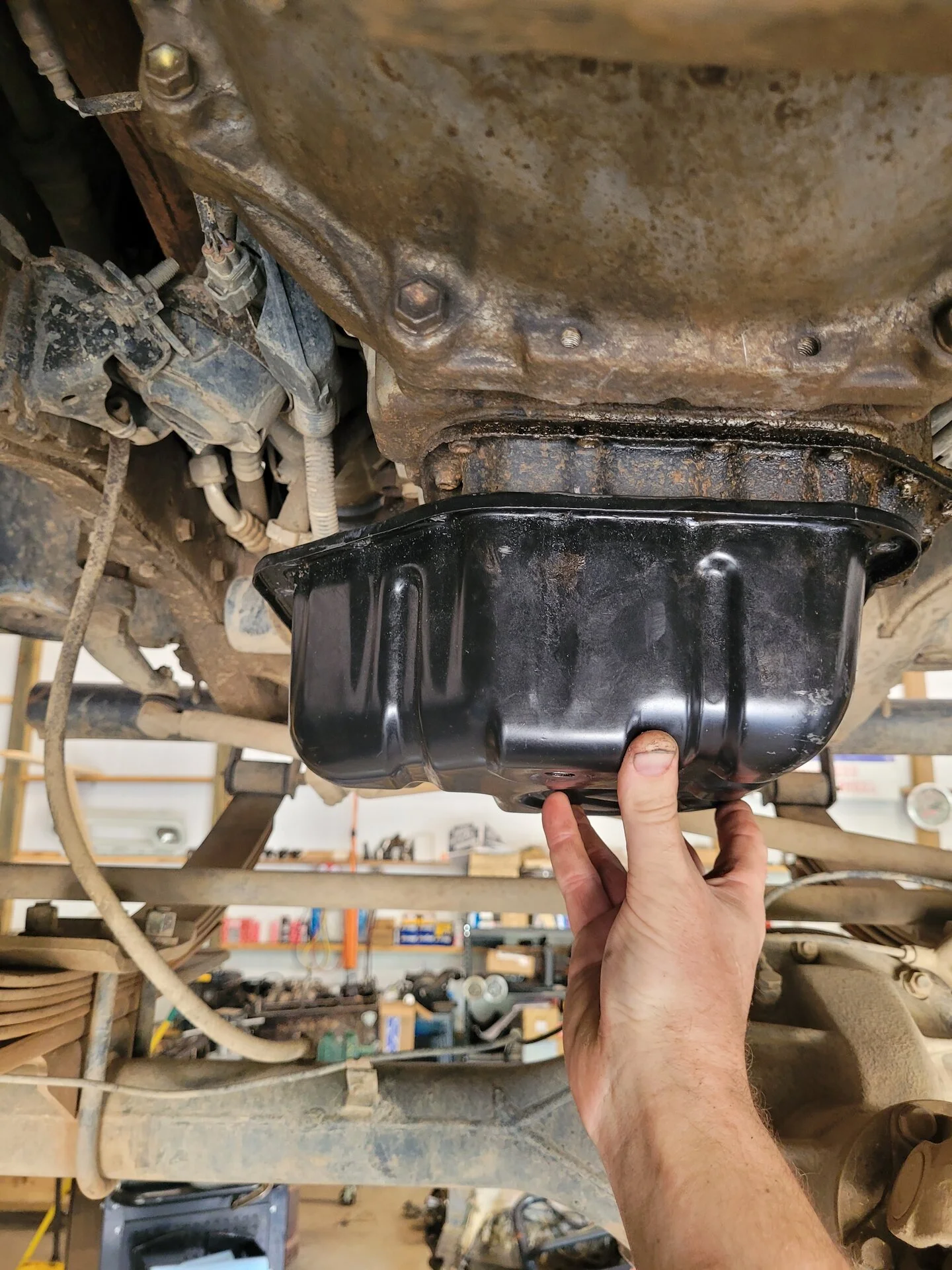

Made the move to a 100's oil pan. Thanks, George! A few pics for reference. So many little differences that add up to a drastically different lower assembly.
Gained 20% more oil capacity, removed any chance of the pinion ever getting into the pan, and got rid of a siphoning concern that has been nagging at me due to how much 4rnr lower pan had to be cut away.
Choppy choppy. No mas scrubby scrubby.

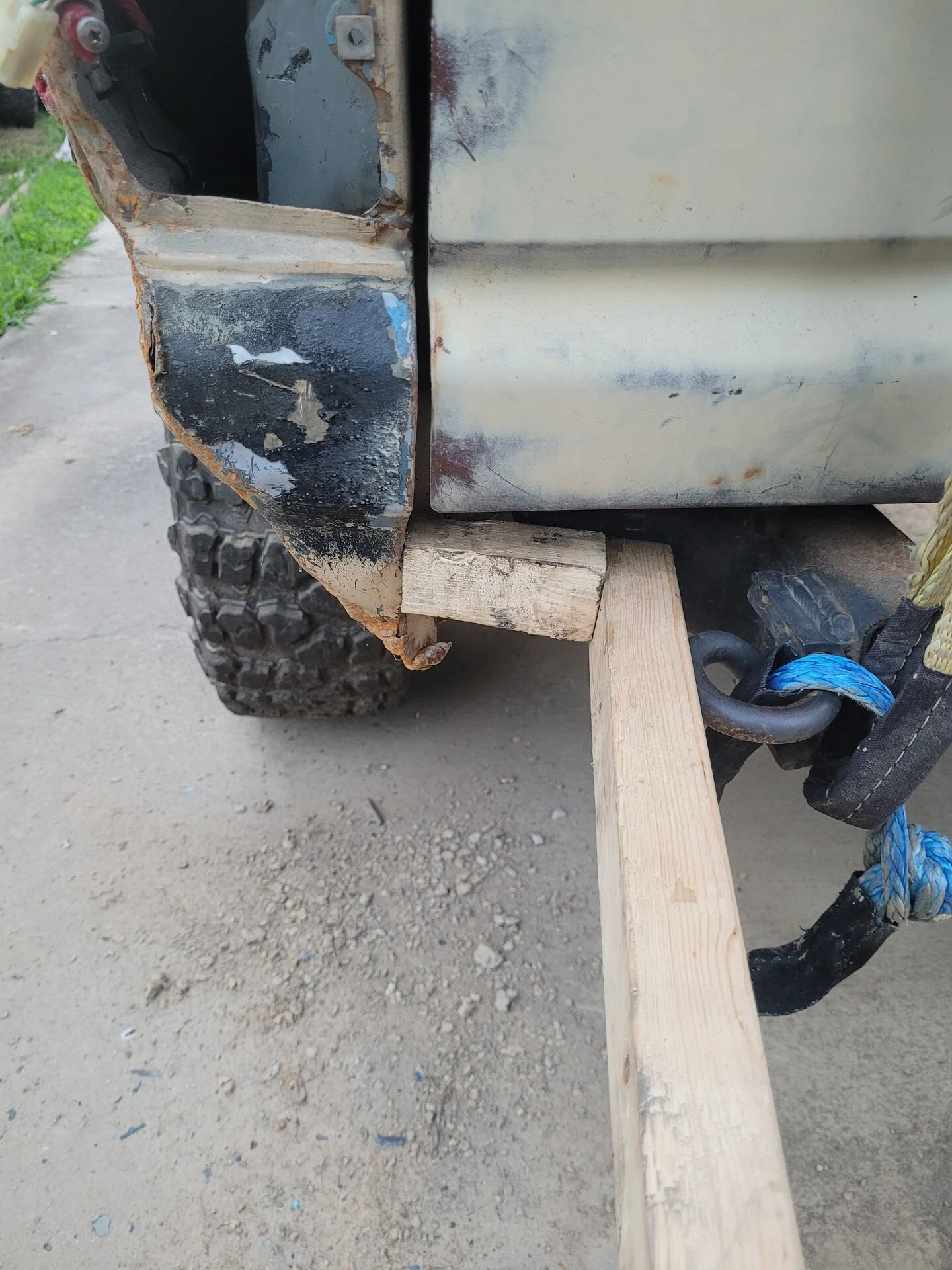

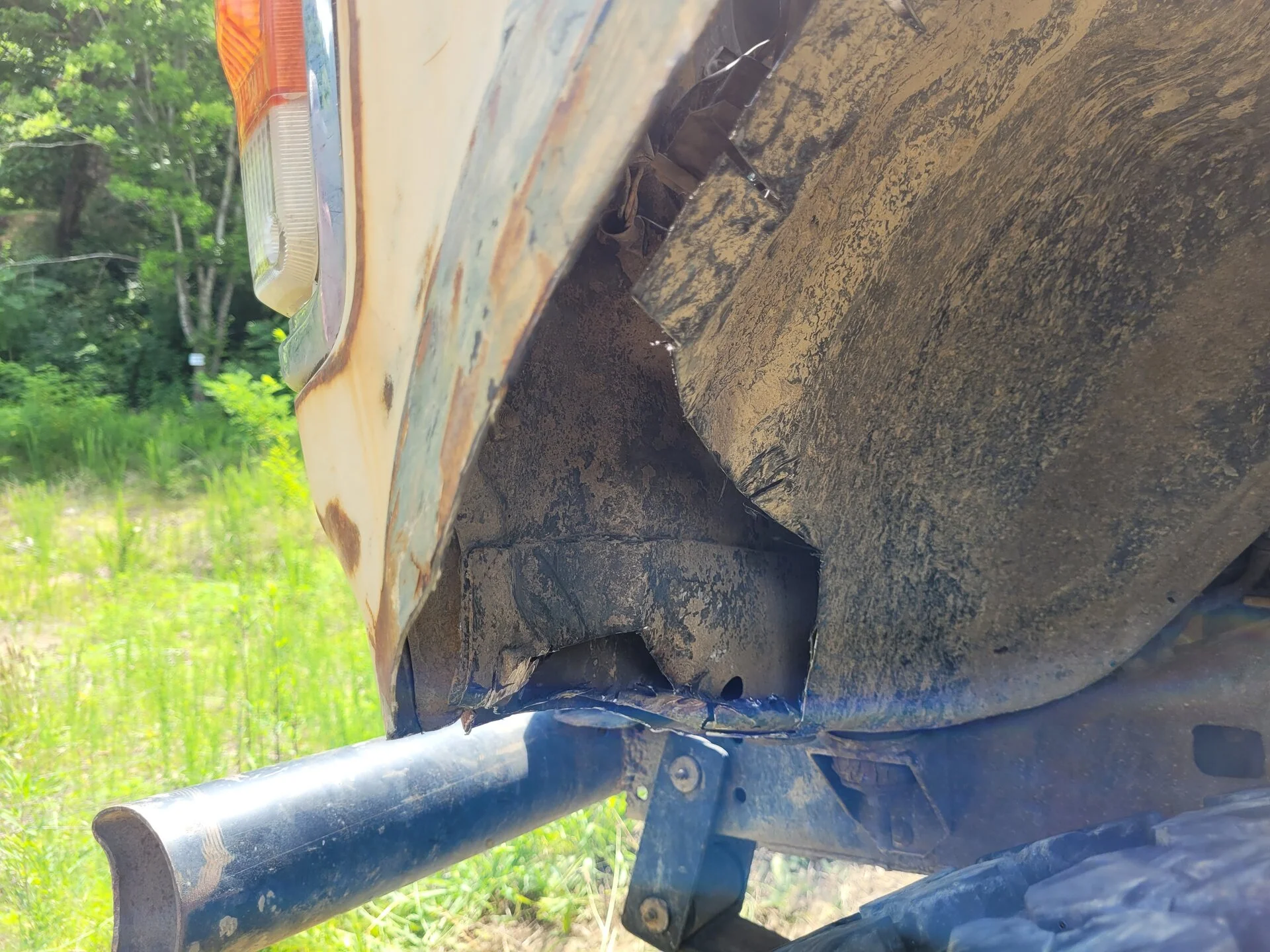

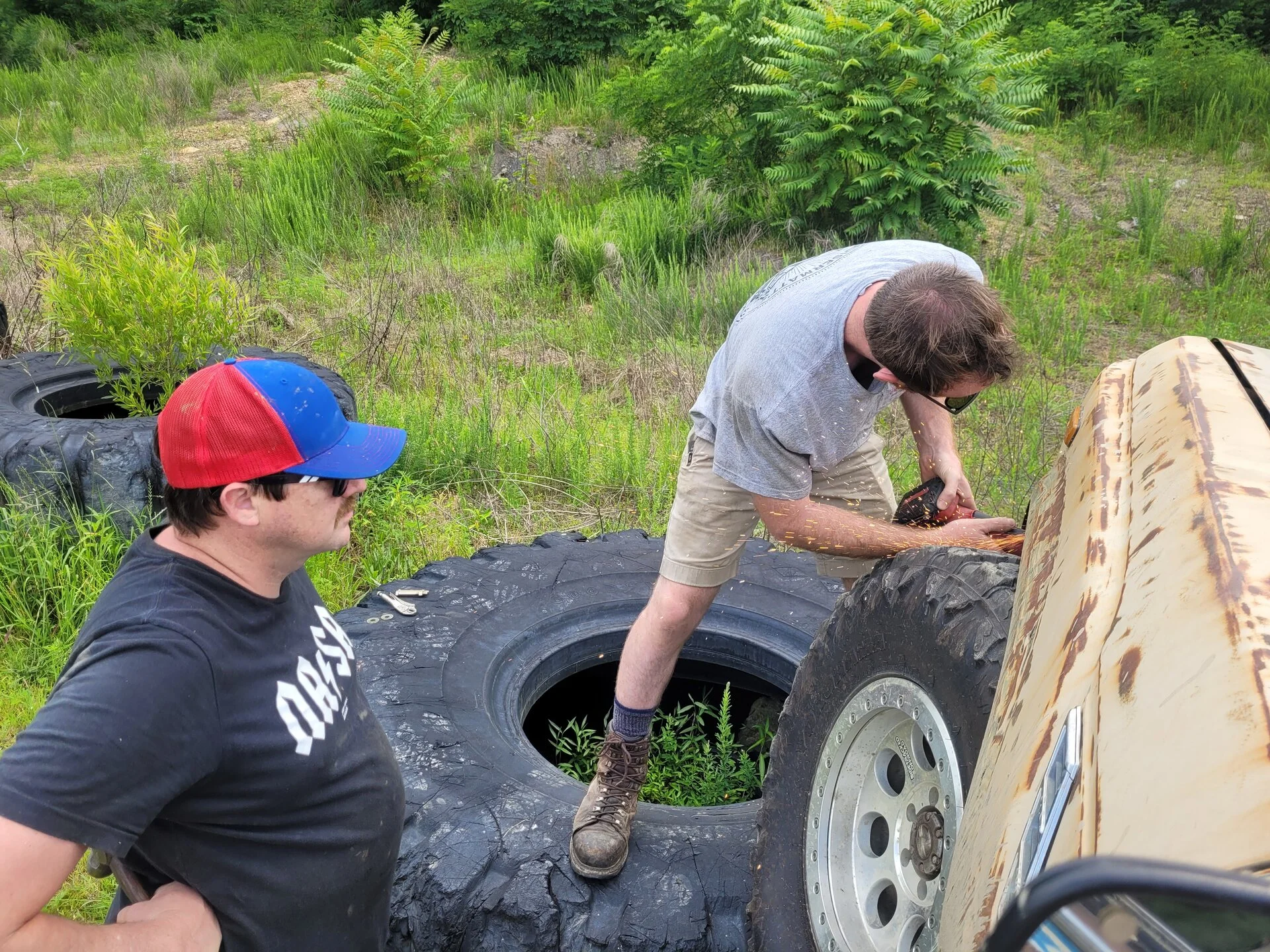

Got a little process down for qtr panel fixing. Rounded 2x2s and piece of tubing get it straightish in a hurry.
Bodywork school with wood is the way to go. Nice.

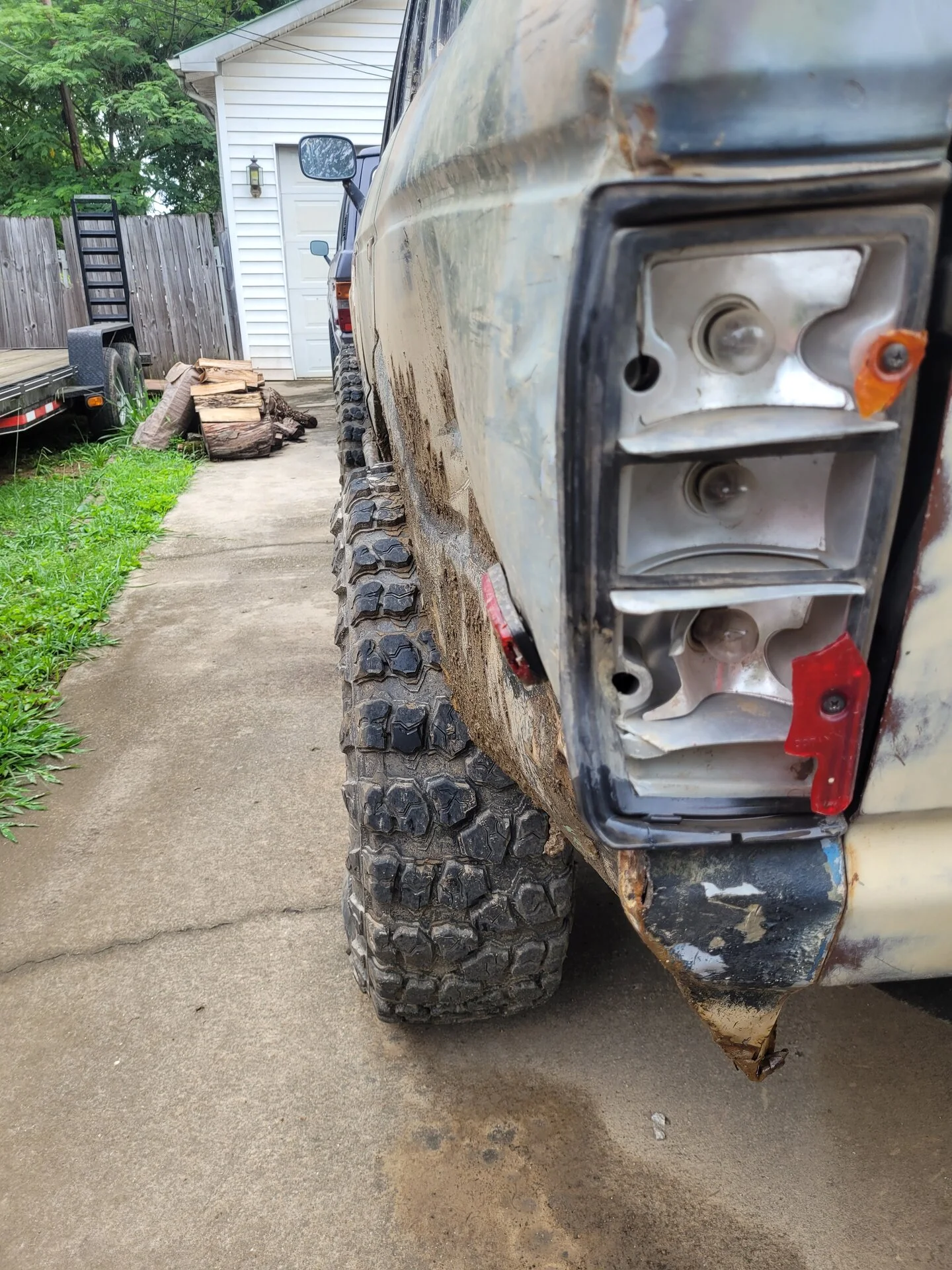

Time for some rear quarter panel protection it saved my bacon a few times on the last trip to the Rubicon😉
It's planned, steel is in the shop. Just need to find some this "free time" I hear about.

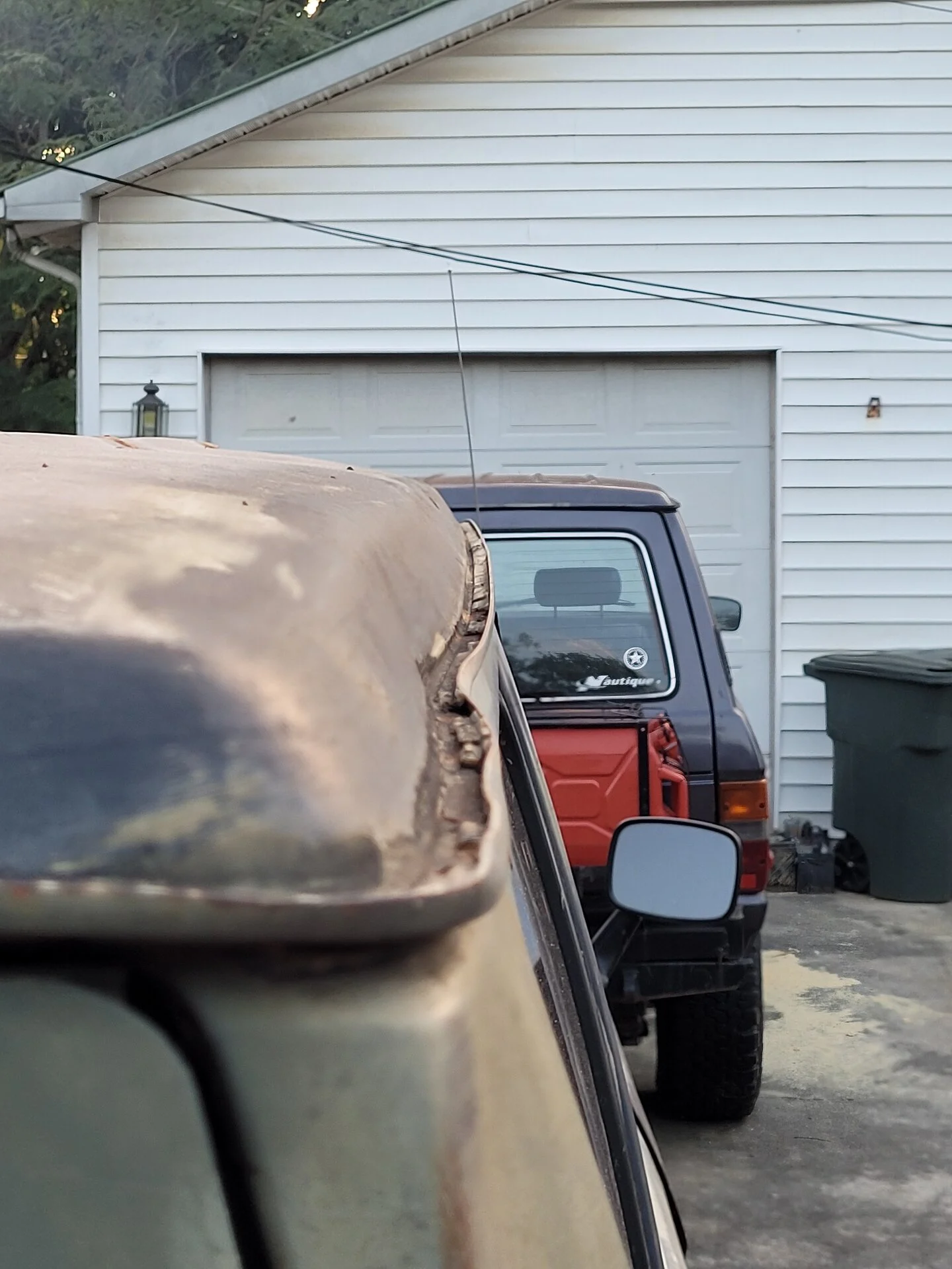

Got lucky and didn't kill the glass below this panel. It was hit before I got the truck, but I leaned the truck on that old damage pretty hard. Expand that bottom photo to check out the nice wave at the top of the glass...gotta pull that one and the fender out...can't open the hood at the moment.
That was close, @Zjohnsonua
Last time i saw @cruisermatt rig in person it was missing that glass (from wheeling?)
Yup, his was from a more aggressive whack up at windrock. I know where mine happened, and I really didnt expect any damage. There I go thinkin' again.
