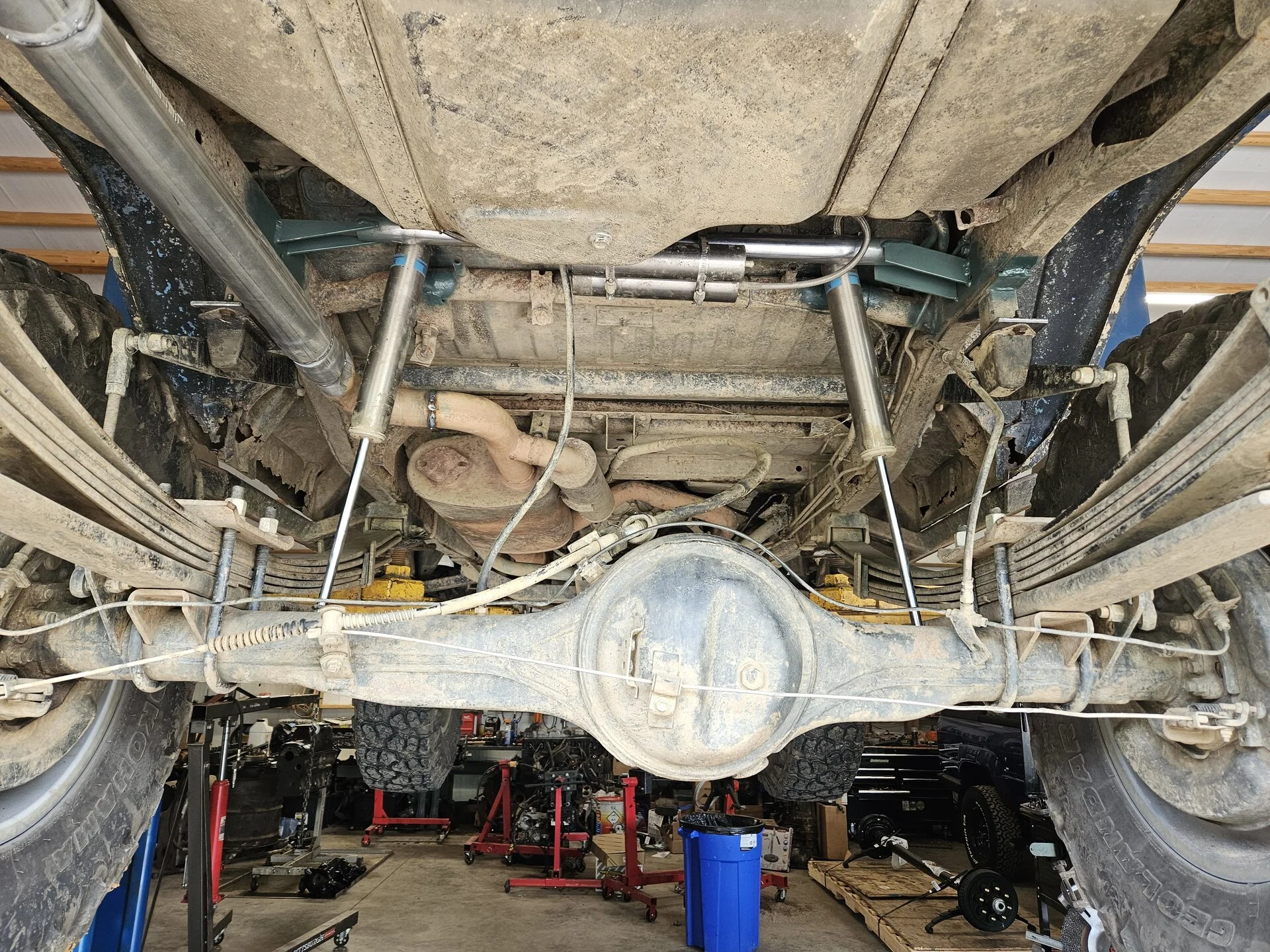

The rear suspension has been violent at full jounce since the get go. I'm also tired of leaving this truck behind because that behavior just isn't ok with a kid in the backseat. So I fixed it this week.
Moved the shock crossmember higher to let the shocks have all the up travel they can take. Shes at 4" up, 6" down now. Then added some leftover 60 and 80 rear bumpstops to soften things a bit when the crash hits.
Exhaust as-routed will most certainly hit the edges of the spring plate at full jounce, but it was free.99. I'll get a better tailpipe routed one day.

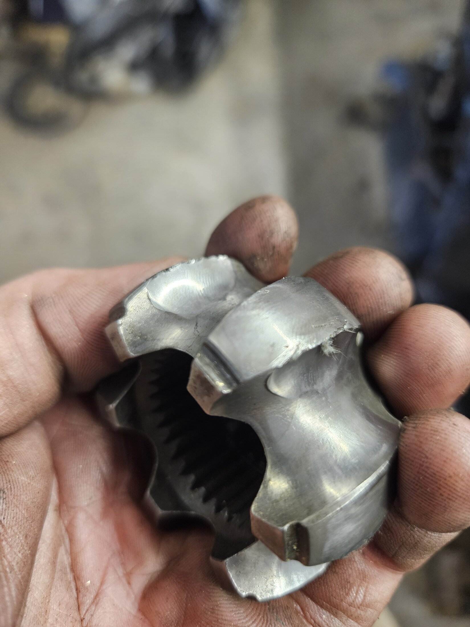

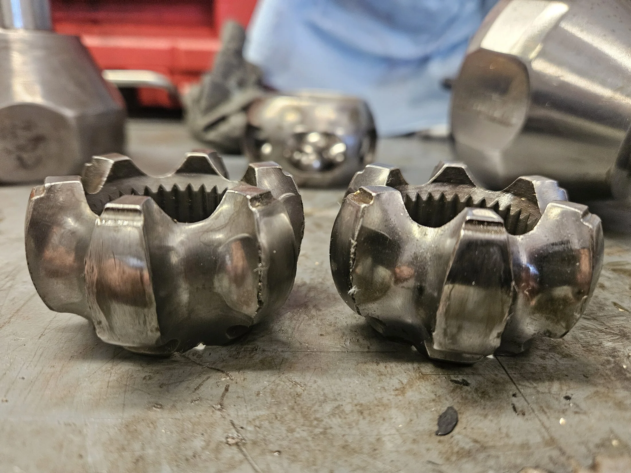

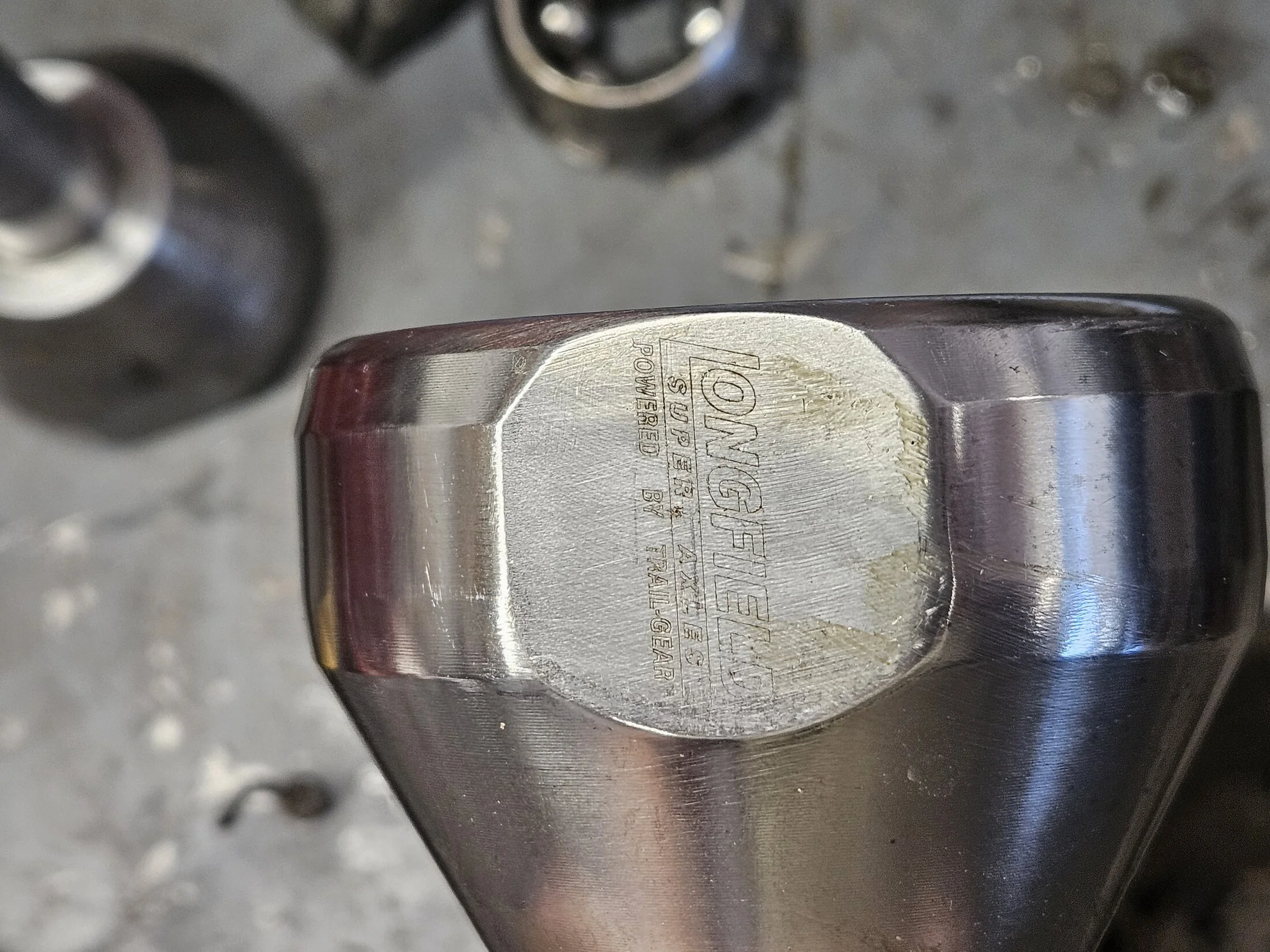

Bought these TG Longfields back in '21 when the truck was built as RCV was backordered into oblivion. They've been run in a part time truck the whole time and have a couple years of hard trail use. Still, they should've held up better than this.
Found the problem when I couldn't rotate the birfs while the knuckles were turned. Opened up the joints and found this crap. Both side of the inner race on each joint has displaced steel. Not worn, just pushed aside - not often you see steel smear like that. And both of these lived smothered in EP moly. They're garbage, soon to be desk art.

The original Bobby Longs would not have done that. IMO
Sadly this is more the norm these days.
Better that you found it now before they let go.
TBT my RCVs let go before they should have IMO but RVC stood behind them 100%
I wasn’t as luck they let go right in the middle of Fordyce trail. Made it a interesting exit 😂
