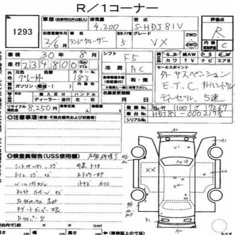

This vehicle is being advertised without disclosing the wreck/repair history noted on the auction sheet. Notes indicate accident/repair to left side, passenger door replaced, repair to front left a-pillar. I've noticed that this seller displays the auction sheet for vehicles that do not have damage history or odometer rollbacks but does not display the auction sheets for vehicles that do. They're also claiming highway mileage as "28", I'll go ahead and call that extremely dubious lol.
