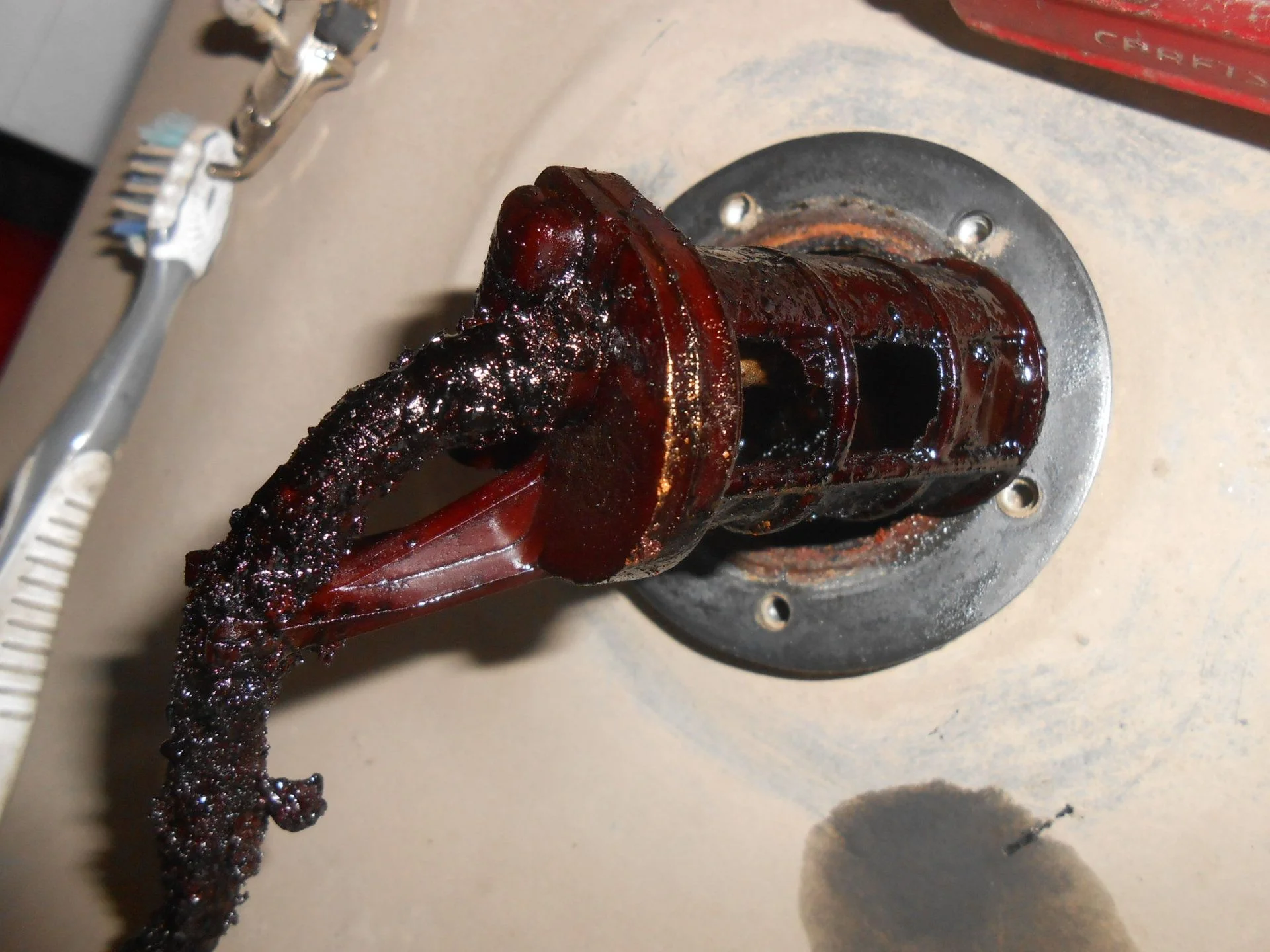

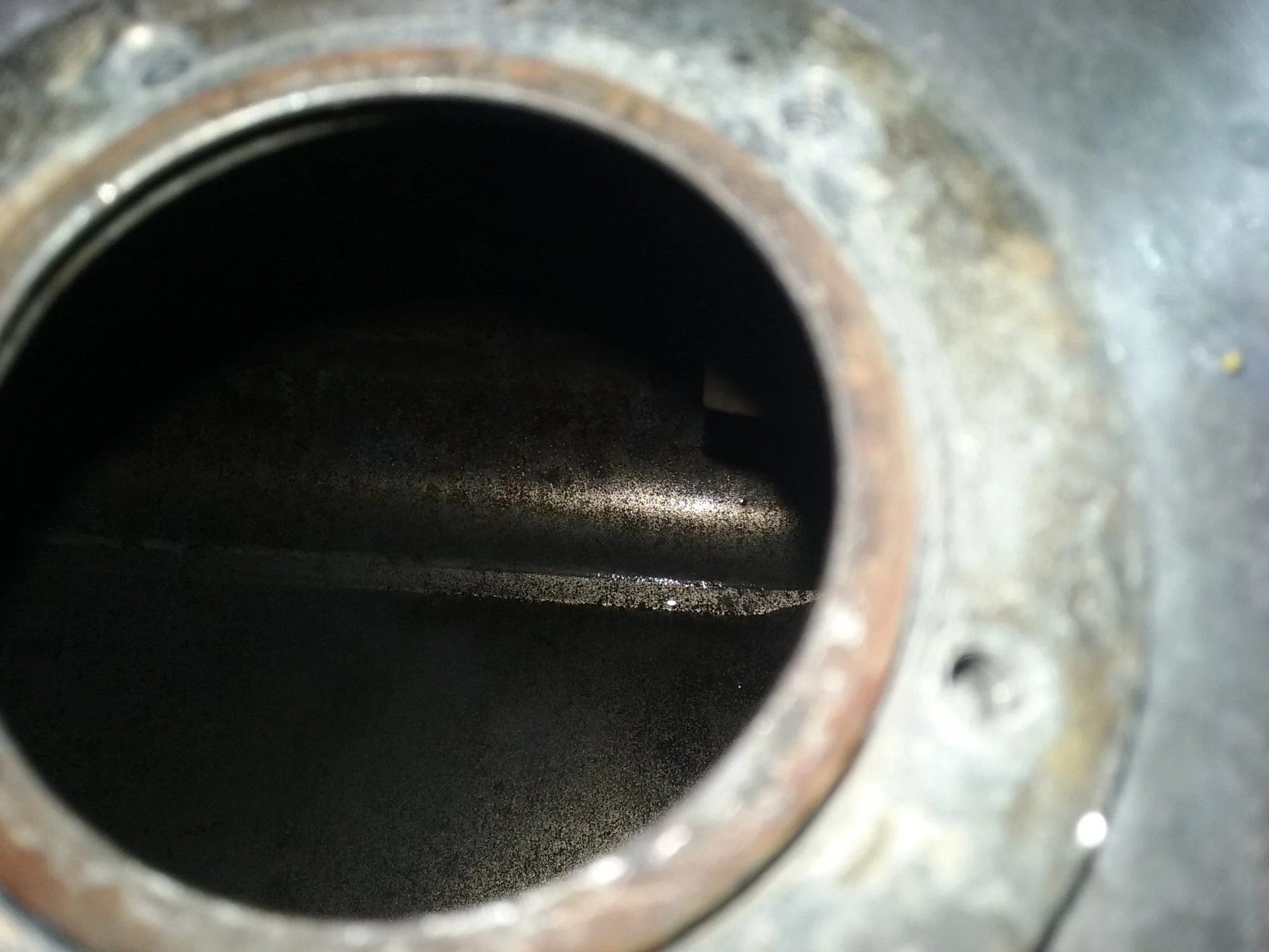

Since the gas tank passed no fuel to the carb, I yanked it and it was seriously sludged inside. No real rust, but 1/4" deep layer of chunky goo, due to sitting since roughly 2012 and rarely driven since 2004. Since y'all like photos - first one is the pickup tube (before - tank looked like this inside) and then one of the outside and inside of the tank. The inside is now as clean as the outside after a lye boilout and hot-tanking at a local radiator shop. I have a new fuel sending unit on order from Thailand (via eBay).
Tech tip - don't park your trucks undriven for 15 years with a half-full gas tank!

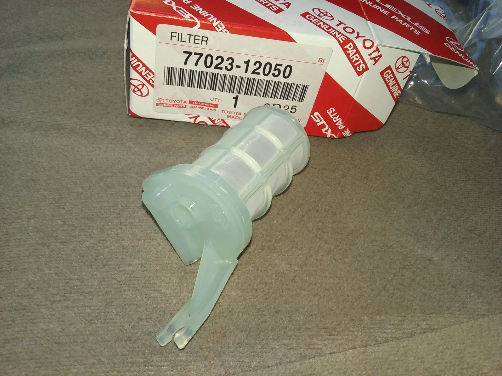

Cool news - Toyota still has the fuel pickup screen in stock - 5 in Calif., so I ordered one. This is for non-EFI, carb'ed trucks and clips to the end of the 'dip tube' that goes to the bottom of the gas tank

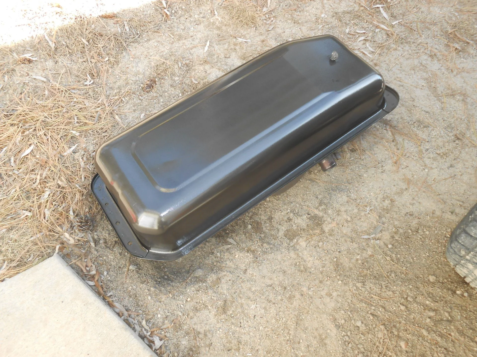

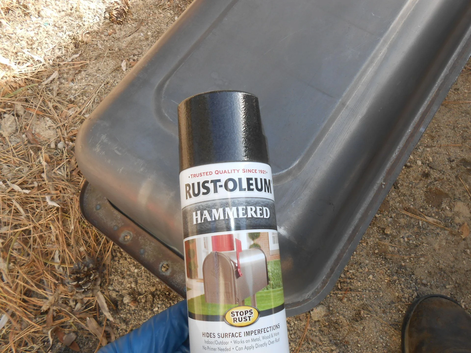

Painted the gas tank with 2 coats of Rustoleum 'Hammered' this past weekend, and hit the windshield wiper arms with the same. Crummy weather and other car projects got in the way of doing more.

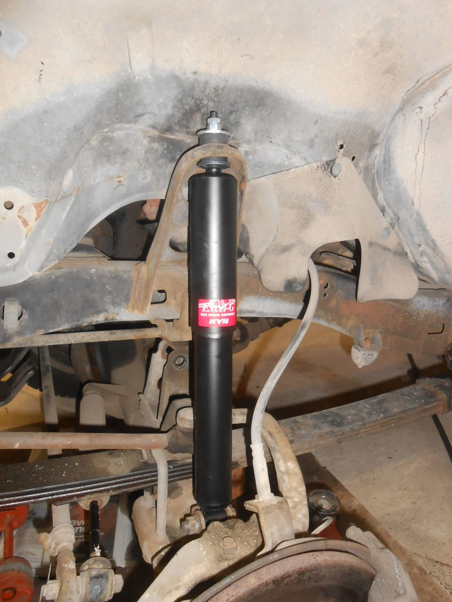

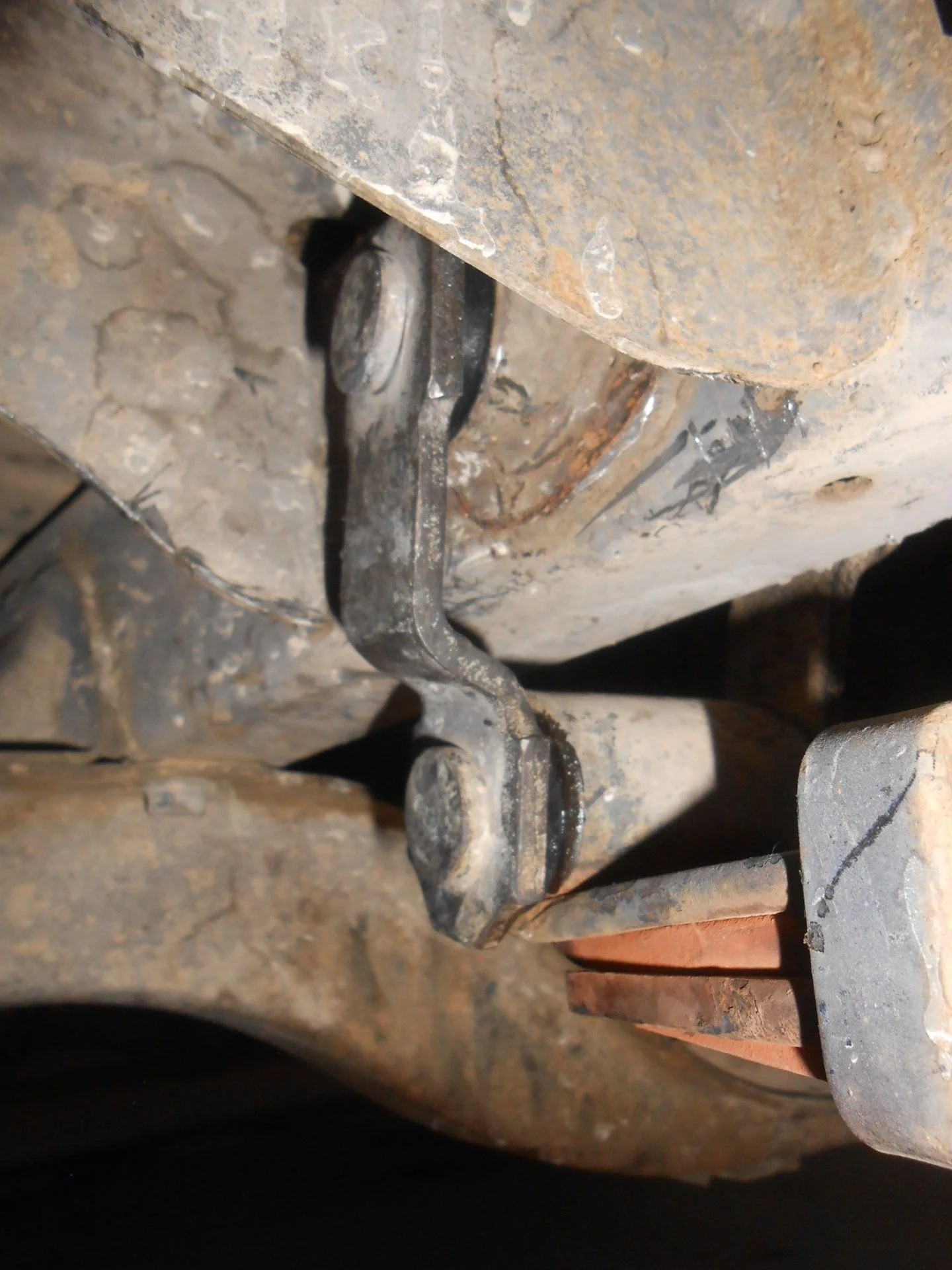

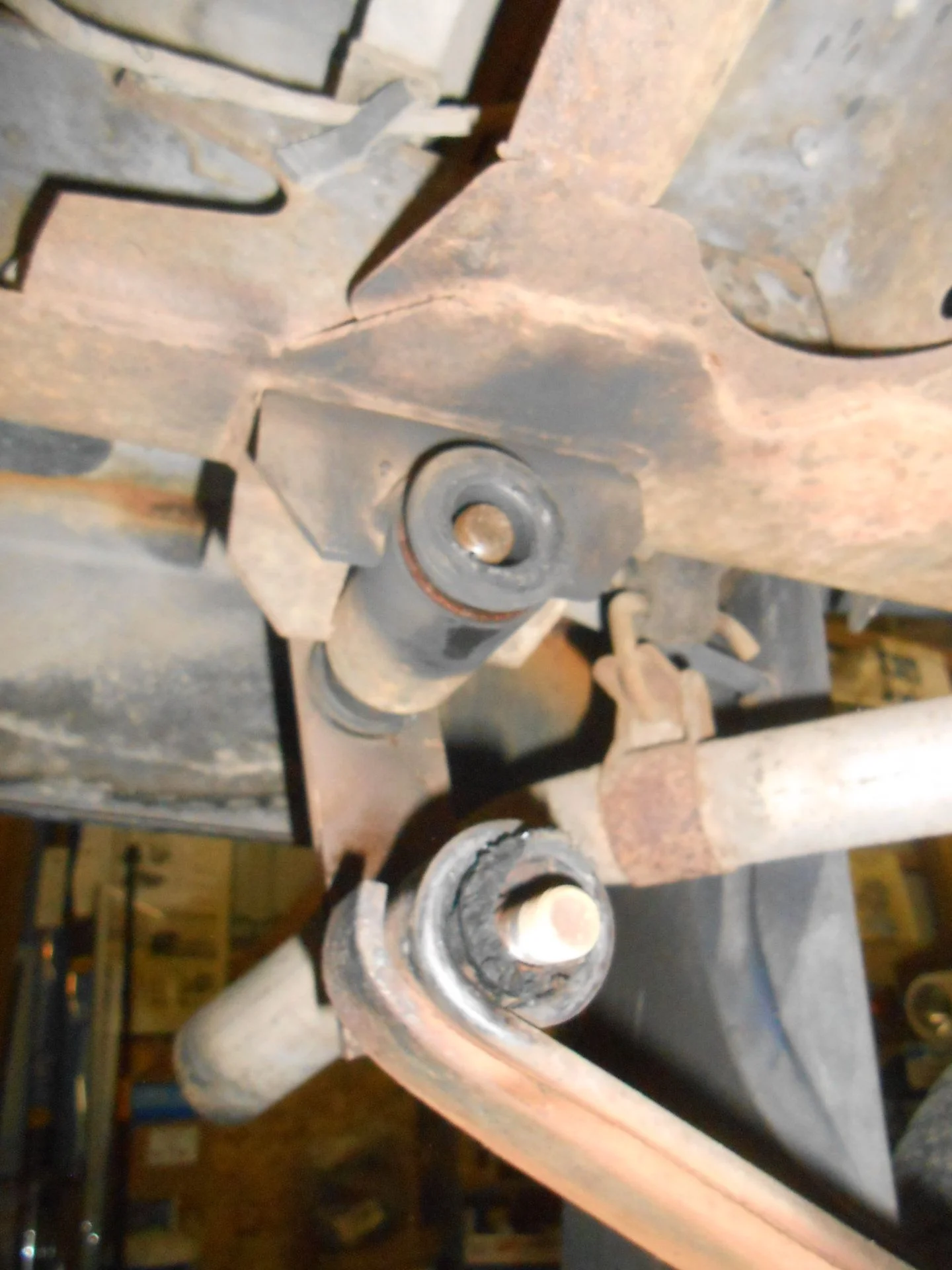

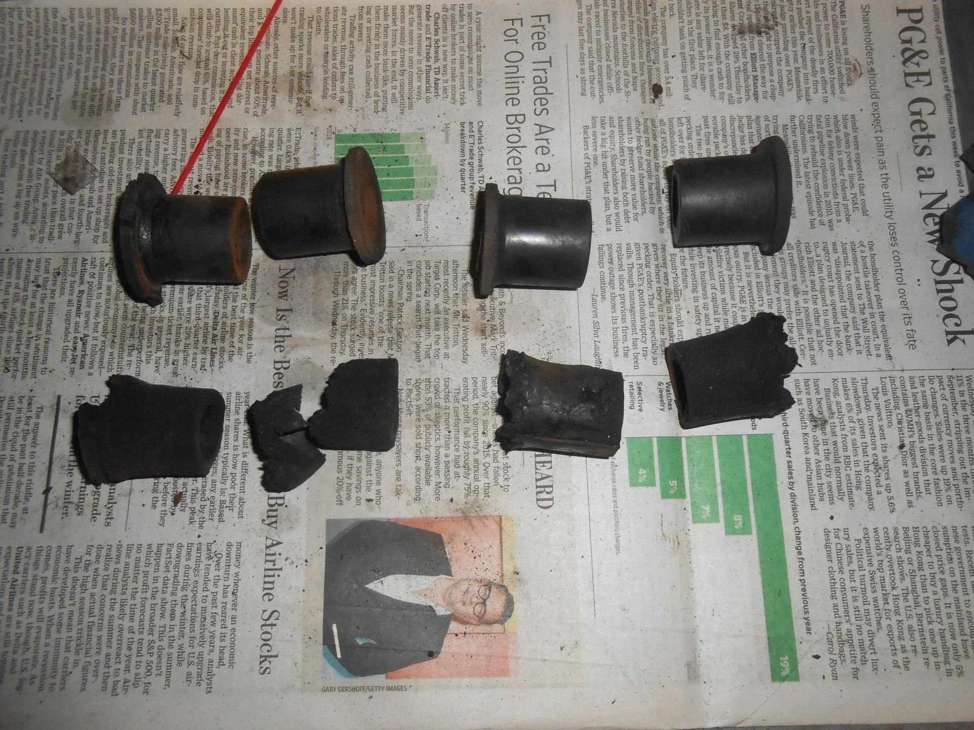

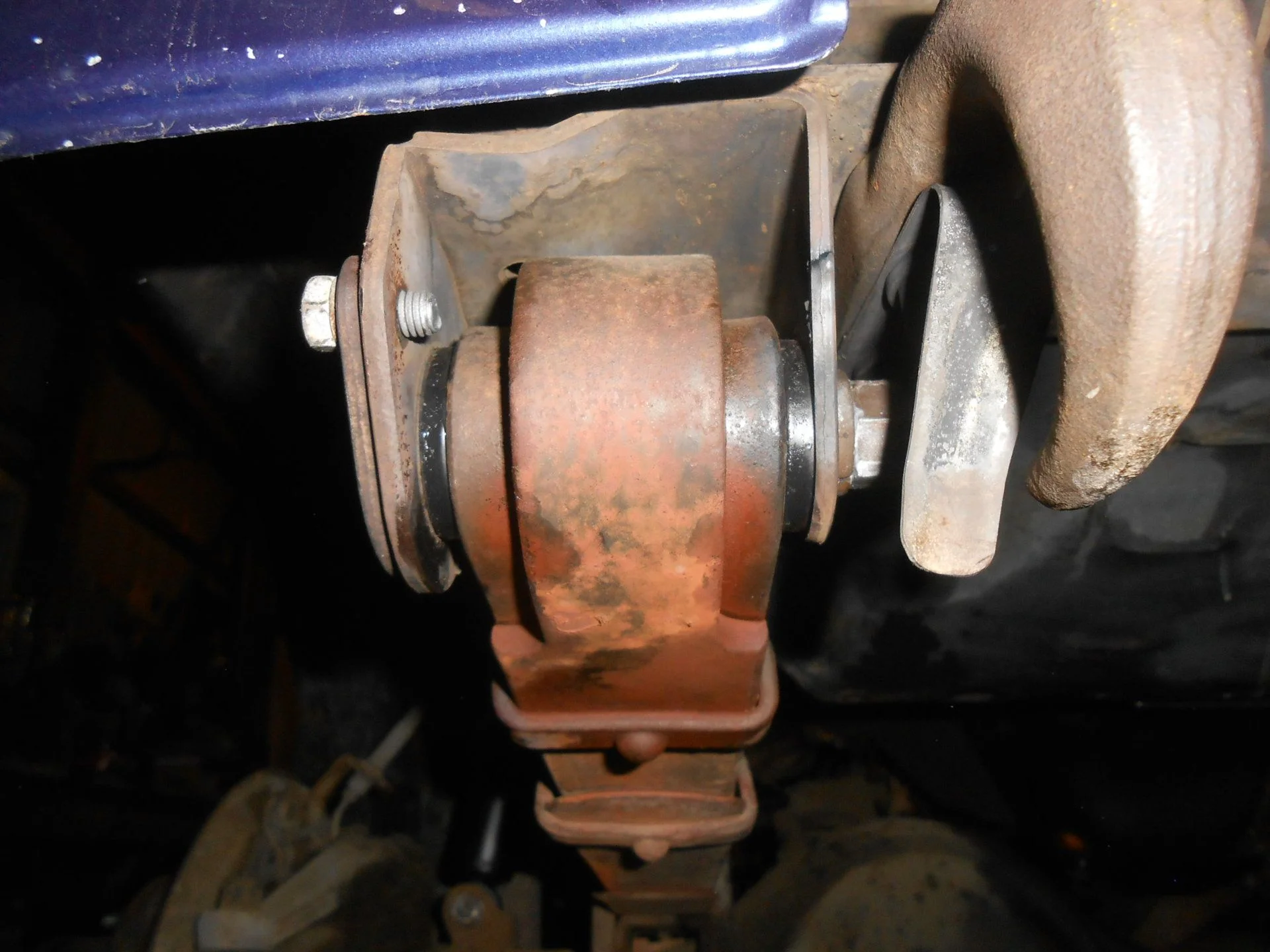

Slacking on the followup postings. Bought an entire set of Energy Suspension leaf spring bushings and installed them yesterday. Lots of torching and pounding, but not worse than an FJ40. Also installed 4 new shocks. The 'dog bone' was in great shape and the Energy Suspension bushings looked like they couldn't fit, so I just reinstalled it.

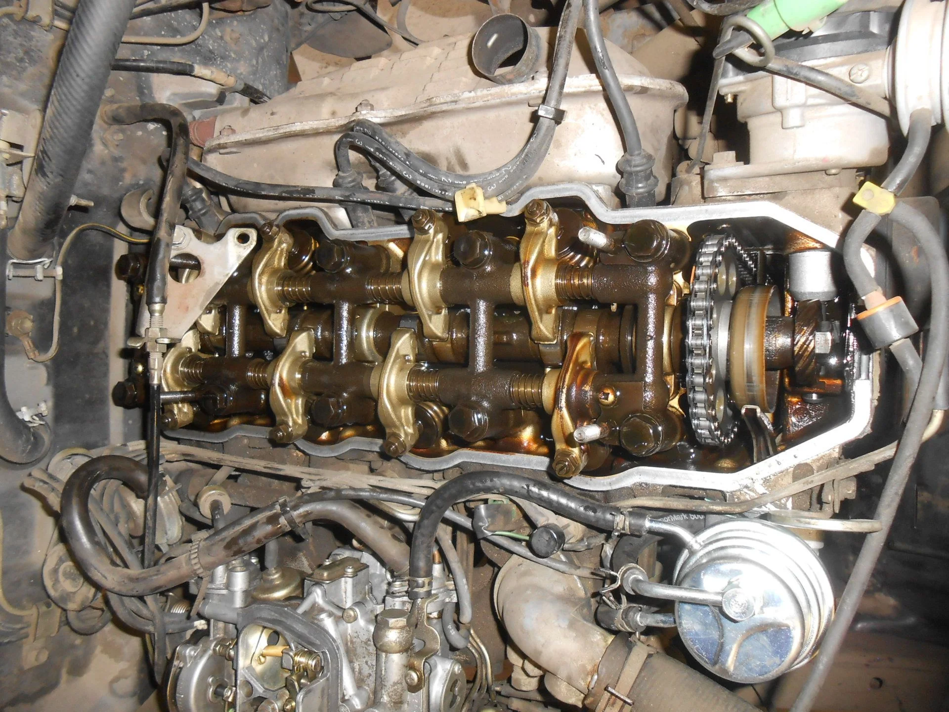

Also did a valve adjustment and checked compression. Pretty clean inside for being parked for many years. But, the PO did regular oil changes. At 7000' elevation, the compression was 136, 138, 130, 128 (dry).
Add 21% to each figure (for sea level) and you get: 165, 167, 157, 155.
In spite of the PO being charged for a 'major tuneup', the plug wires are dated '1982'!

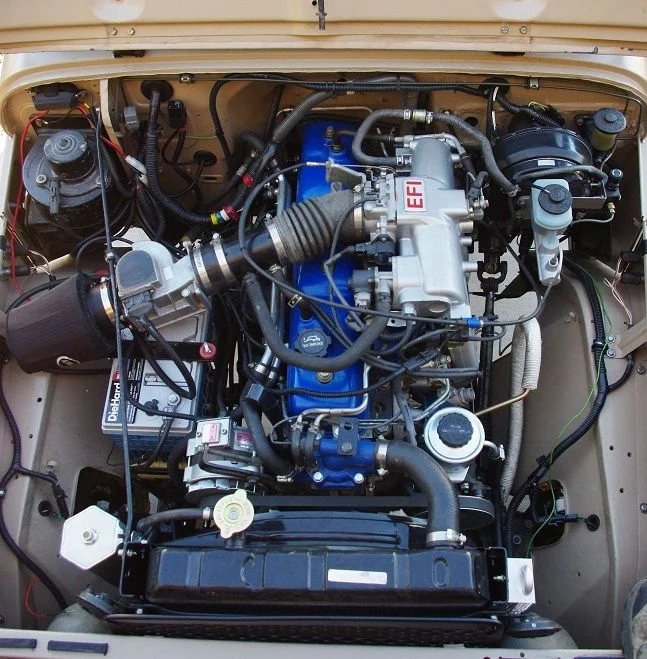

The 3F-E excels at turning fuel into waste heat...
BTW, I love my 3FE, but then, it isn't a normal 3FE.
Displacement: 4276cc
Compression: ~9:1
HP: 124rwhp@3250
Torque: 233rw lb-ft@1950
</derailment>
That's one hot looking 3F. You should show that off at a Cars and Coffee so that the unwashed can mumble 'never heard of a 3F-E - output sounds kinda low...' ;-). Congrats on a sexy build.
Pic was taken right after install. It isn't as pretty now.

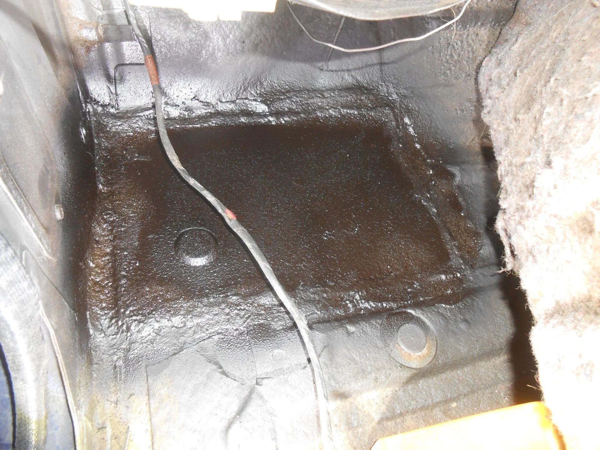

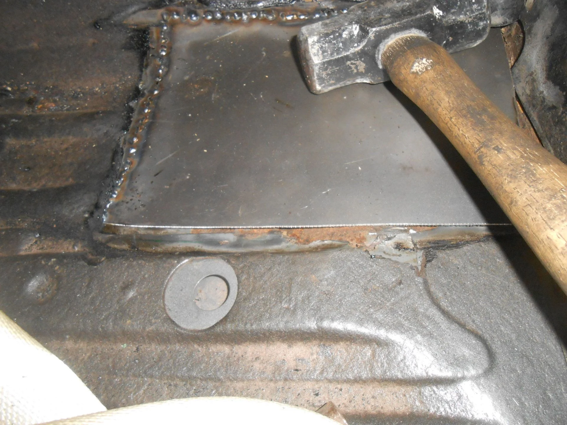

Floor pan repair fun. Not horrible, but needed patching - both sides. Welded, puttied, rust-treated. Will rustproof on the bottom side with axle grease after painting, and will spray grease around the body mount.
My approach was to cut a shape from 18ga metal, weld part of it in place, then beat with a hammer to get all the seams tight, and then weld those. Worked pretty well and plenty stout.
Driver's side:
Passenger's side underway:

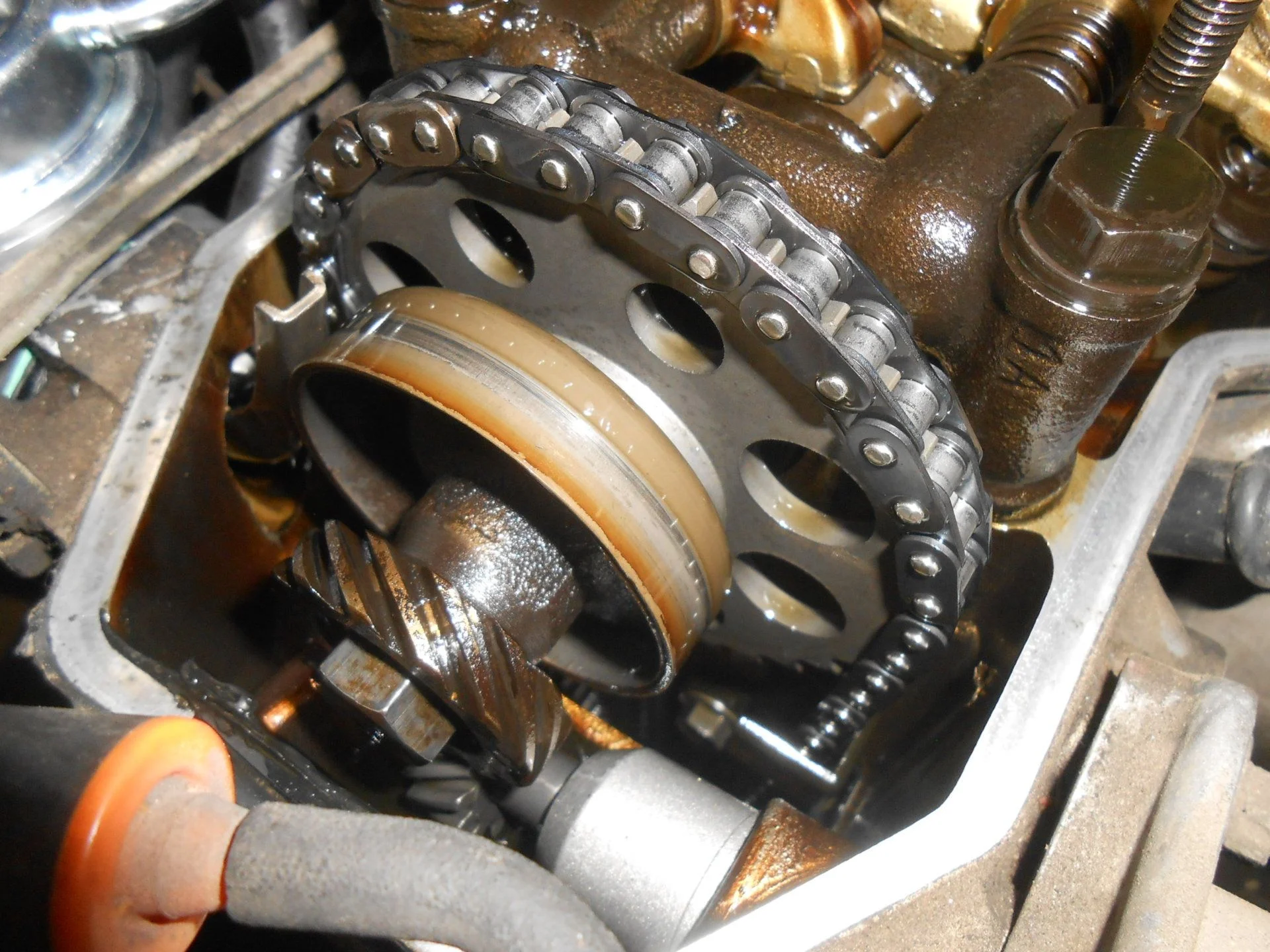

Looking at your rocker box post above - I got to thinking. From Wikipedia:
"Toyota swapped the dual-row timing chain used in older engines for a single-row chain with plastic guides in 1983."
So is that not the original engine? I've never had the valve cover off my 82.
Well, their conversion kit won't be of much use to me:
This unique kit was designed by LC Engineering to replace the factory single row timing chain on the 22R & 22RE (85-95) engines with a double row timing chain.
NOTE: Will not work on 81-84 22r engines.
