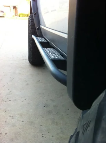

A recommendation is determine the width really necessitated, be it hardcore crawling with extra width, or general usage where wider may not be necessary.
Issue I have with mine is they're of the wider variety. Not wide enough to alt as a step, but wide enough to make entry and exit less than graceful.
I installed MetalTech's on another FJC, and the version was plenty of protection, without being a hindrance, so a possible option for mine, when and if I replace.
Pic of what I have, for reference.
